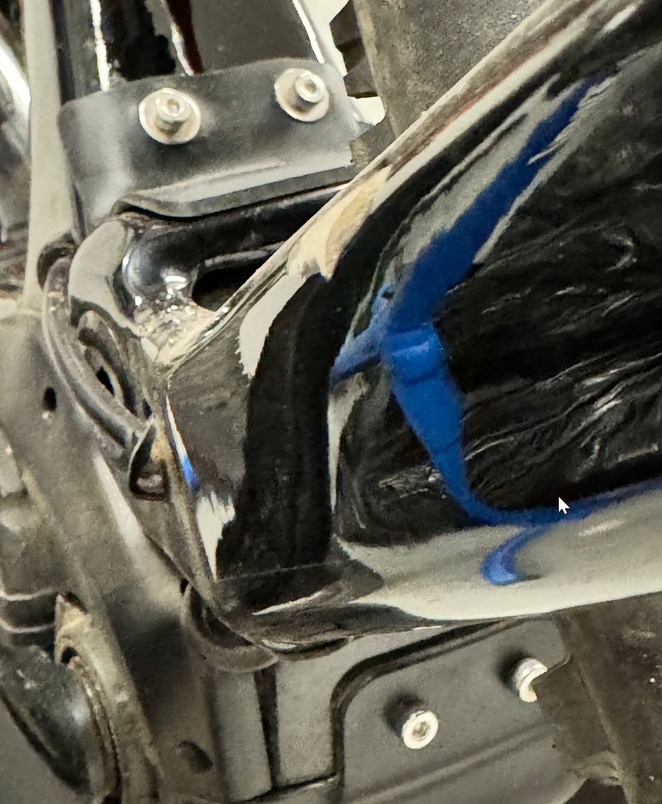

Anyone else having most of the small fasteners rusting? The ones on the rubber pivot flap and the ones that hold the cover on the bottom of the motor. They look really bad and will need replacing.

270
France
Same here, that looks awful

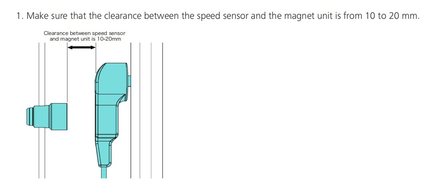

Hello
How far away should the speed sensor magnet be placed?
how you have it installed.
I have had to supplement the sensor and I still find it far away
greetings
robk
Jun 12, 2024
24
28
Hello
greetings
I see someone answered with the Bafang spec (10-20mm). My magnet is 16mm from the sensor and works perfectly.

24
28
Same. I saw them start to rust almost immediately. Replaced with better quality M4 x 6mm screws. Also noticed the Banfang motor bolts were developing rust in the hex heads. Cleaned with WD-40 and Q-Tip to remove rust, added a coat of grease with a Q-Tip (will see if that helps...).

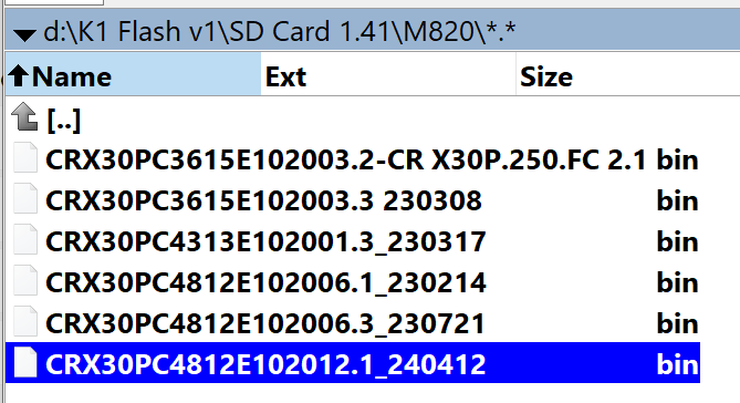

Building mine up next week!
Hello Rob,
Go for 43V or 48V battery.
Recently I saw Bafang started to ship 43V motors with reduced power to 10A. Dont know why. You can flash there then 43V and 13A firmware.
Or better to go for 48V and firmware v12.1 which is from April 2024. Can help you with this firmwares and settings.
4812E = 48V and 12A peak.
With DPC245 display (fw version 1.2) you will be able to connect to GO+ and set power levels. Unfortunately I have not seen yet on M820 possibility to set Assistance level %, like on M510 FC2.0. :(
