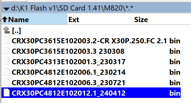

Go for 43V or 48V battery.
Recently I saw Bafang started to ship 43V motors with reduced power to 10A. Dont know why. You can flash there then 43V and 13A firmware.
Or better to go for 48V and firmware v12.1 which is from April 2024. Can help you with this firmwares and settings.
4812E = 48V and 12A peak.
With DPC245 display (fw version 1.2) you will be able to connect to GO+ and set power levels. Unfortunately I have not seen yet on M820 possibility to set Assistance level %, like on M510 FC2.0. :(
FYI I have the basic DP E181.CAN" display (lights and buttons with no text readout), and I can connect with the Go+ app.

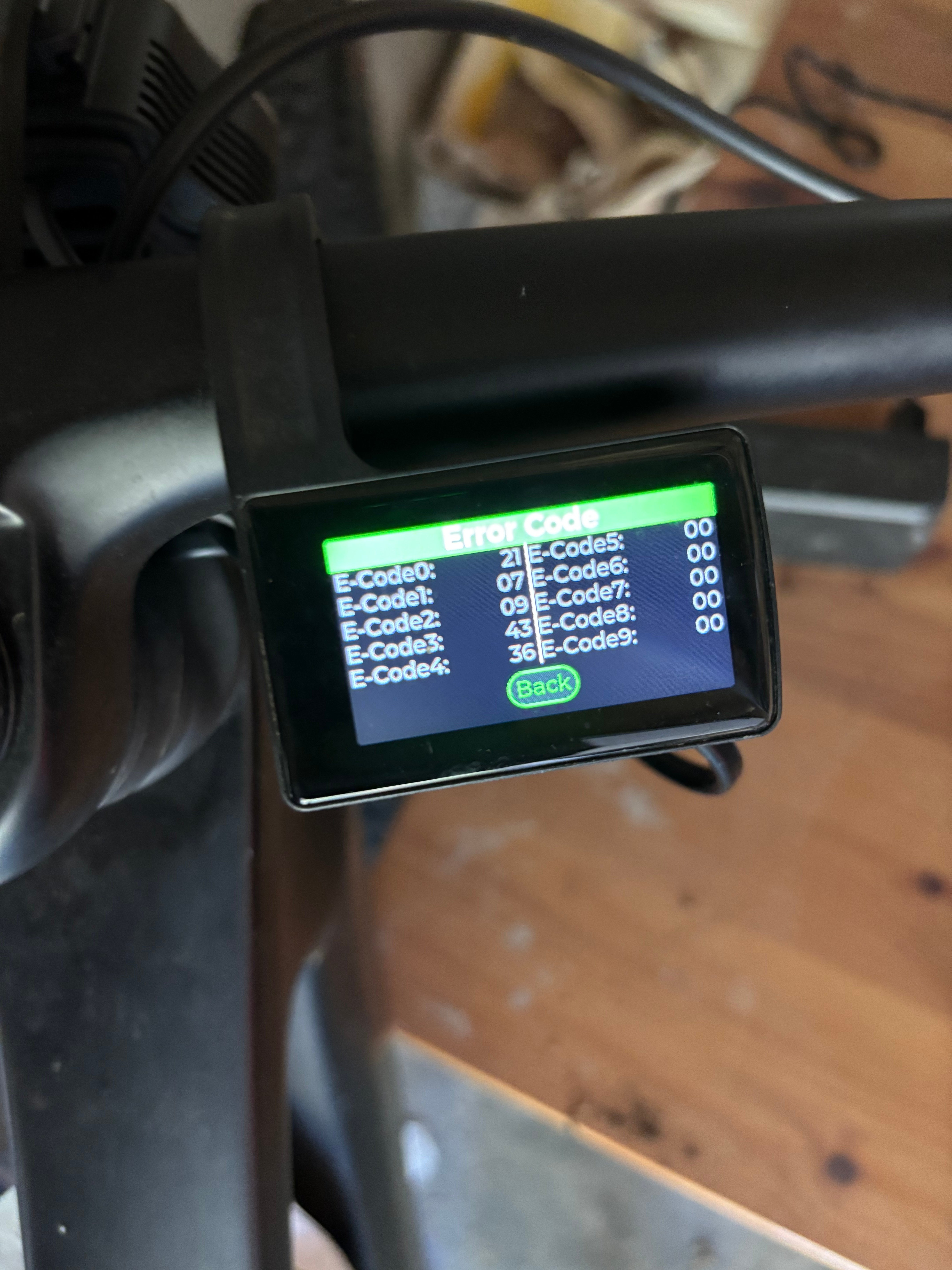

ok guys I need your help, 800 km here and motor is dead. I did not ride much the pasts months and I'm in holidays tonight, I was expecting to ride more the 3 coming weeks... I'm so disappointed.
Anyway, here is the video of the sound of the rattle and the error codes.
Any idea ?

Just open it up and look inside what is making the noises.
Is still good to have one spare motor. ;))
I'm afraid I'll loose the warranty and if it's an expensive failure...
What's your experience with Chinese dealers and warranty ?

I’m with dado - for the price of a new motor I’d just keep a spare on hand. If they require you to ship it back between shipping costs and time without a bike I’d rather spend ~$500 and buy a whole new motor.
Could maybe then try deal with getting it repaired/fixed and sell the replacement one if necessary.
Any idea ?
I've just checked Error 09 : change the motor ...
You're right, I'll probably get a spare, as my wife also has a M820 on his CEF50. Maybe in the meantime I'll steal hers... but no family ride during the holidays :(
