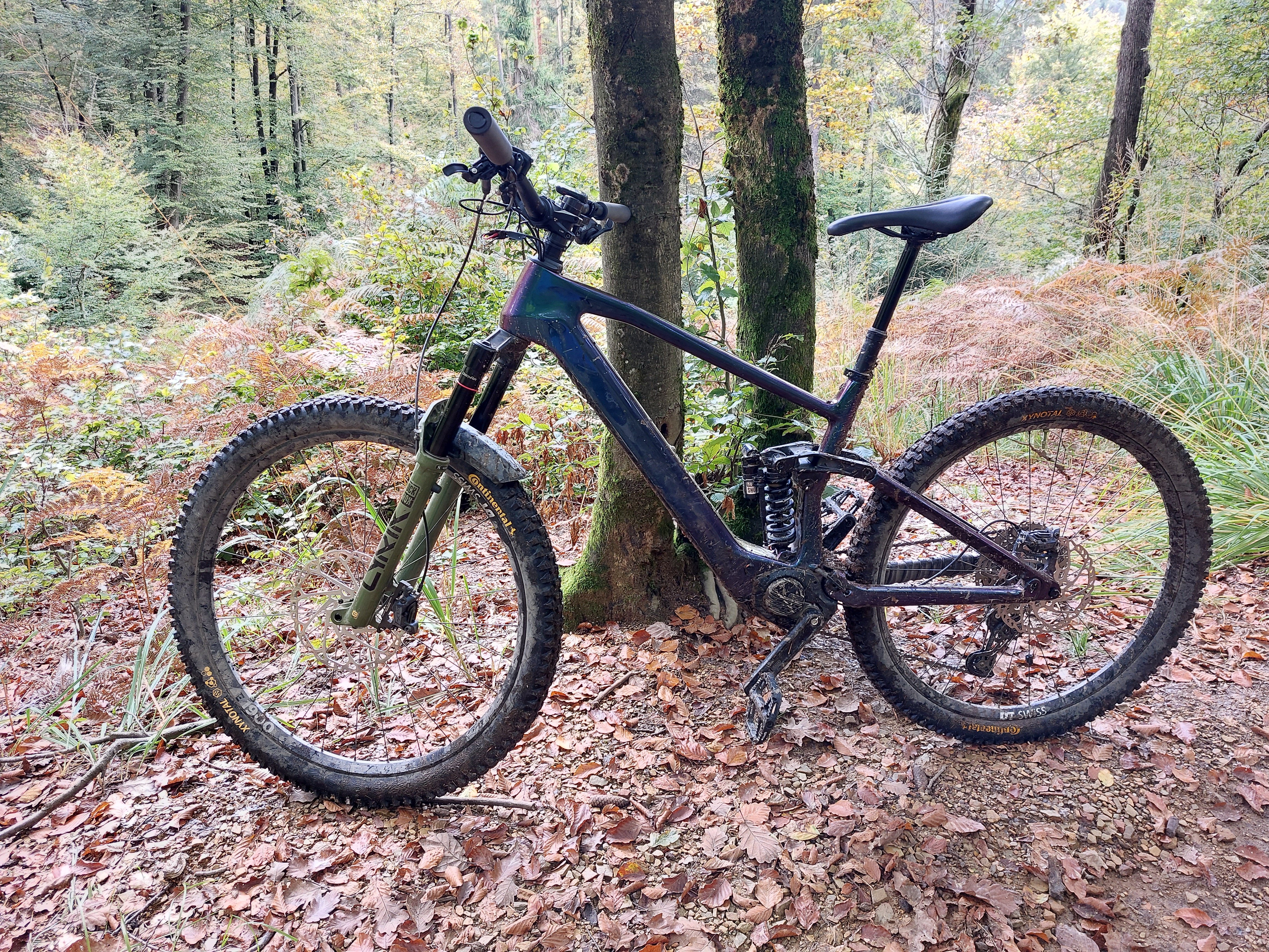

Wild beast in its natural habitat:

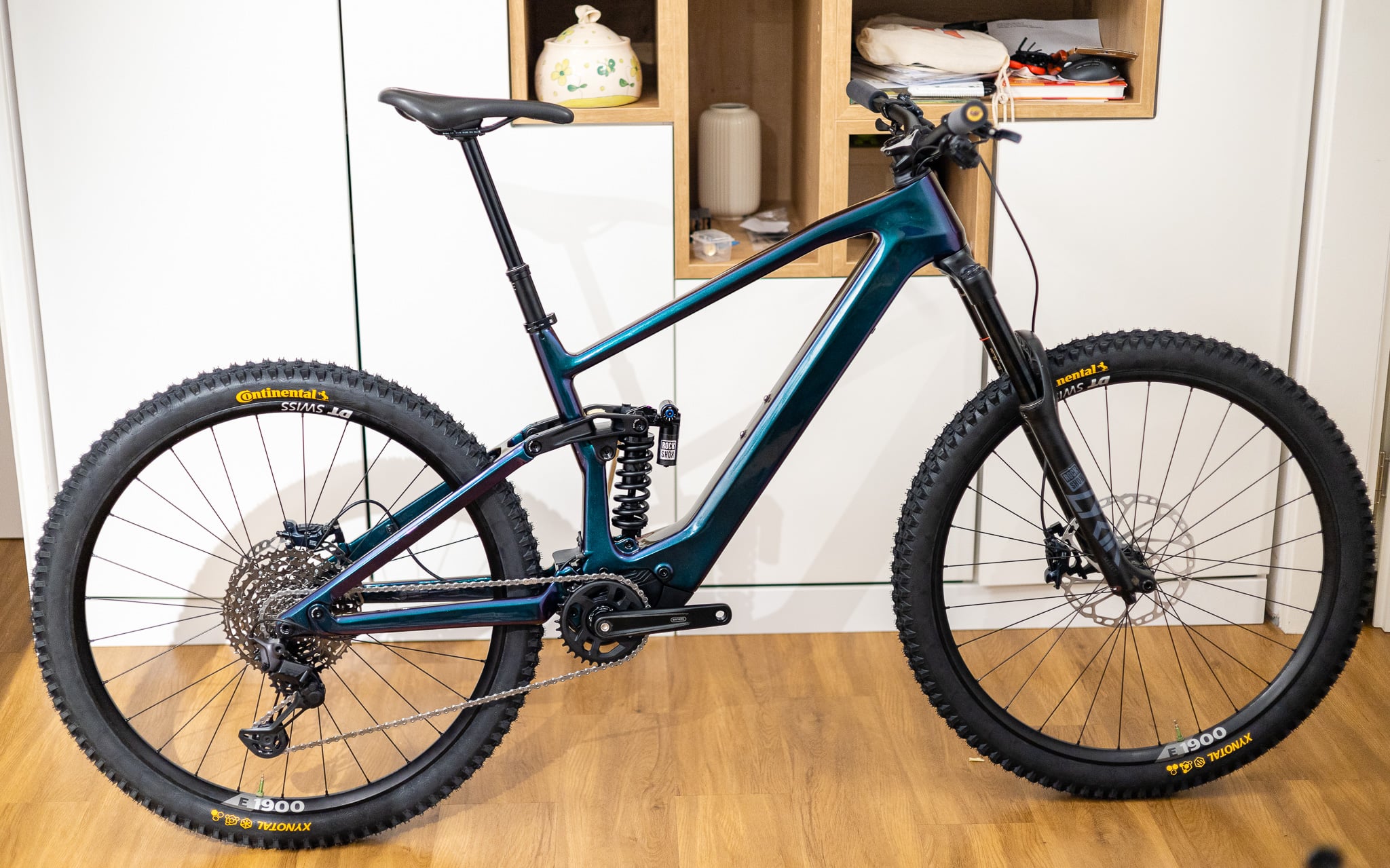

Preliminary test build is done:
Weigth is 17.6kg. It is without a battery, pedals and tubeless, without tyre sealant.
With battery, pedals and sealant it should be cca 20.8kg. Considering, it has heavy alu wheels, heavy tyres, heavy drivetrain, and coil shock I think it is good. Certanly good enough for me. :D

where in France are you using the bike, can you give your comments about the bike and the assembling process?
I’m near Clermont-Ferrand.
The assembling is easy besides the motor mounting with the spacers, but you do it once and that should be good.
Otherwise, it was quite easy and the last bike I assembled was at least 10 years ago!

hi, great job very nice, but do you have problems with the gear change? because I do a little. since the sheath makes a tight "S" between the front and rear triangle, the wire struggles to return
