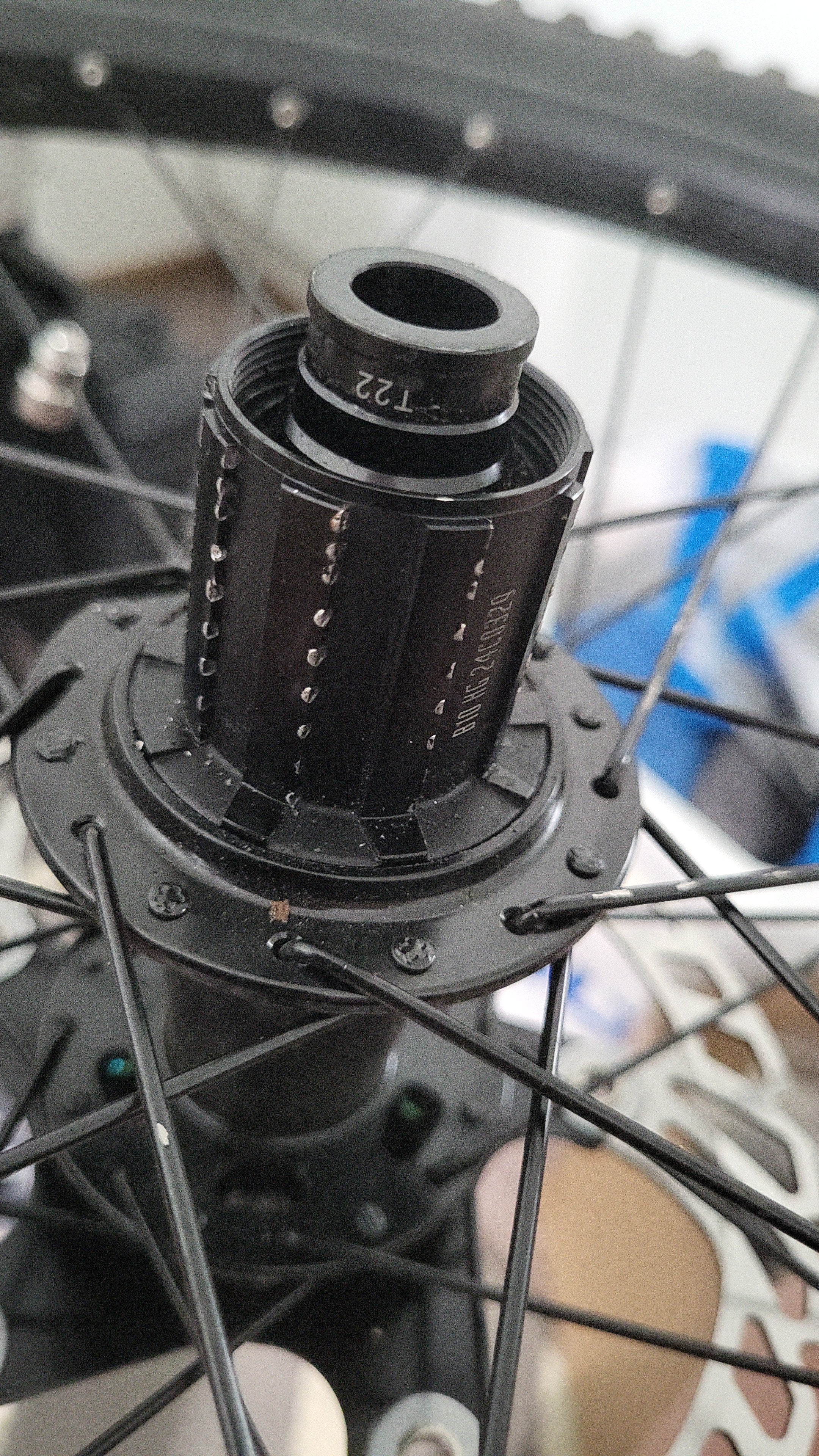

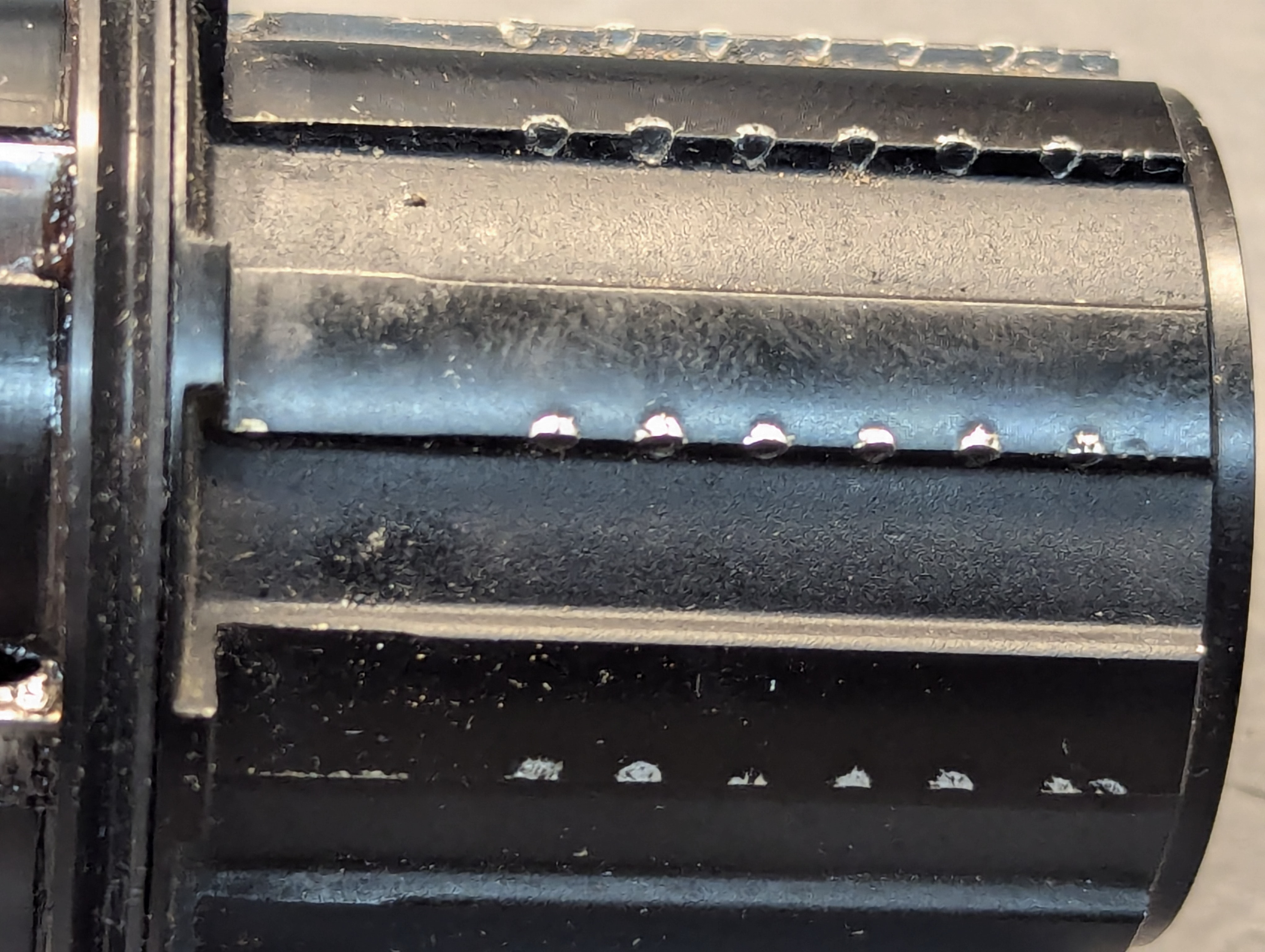

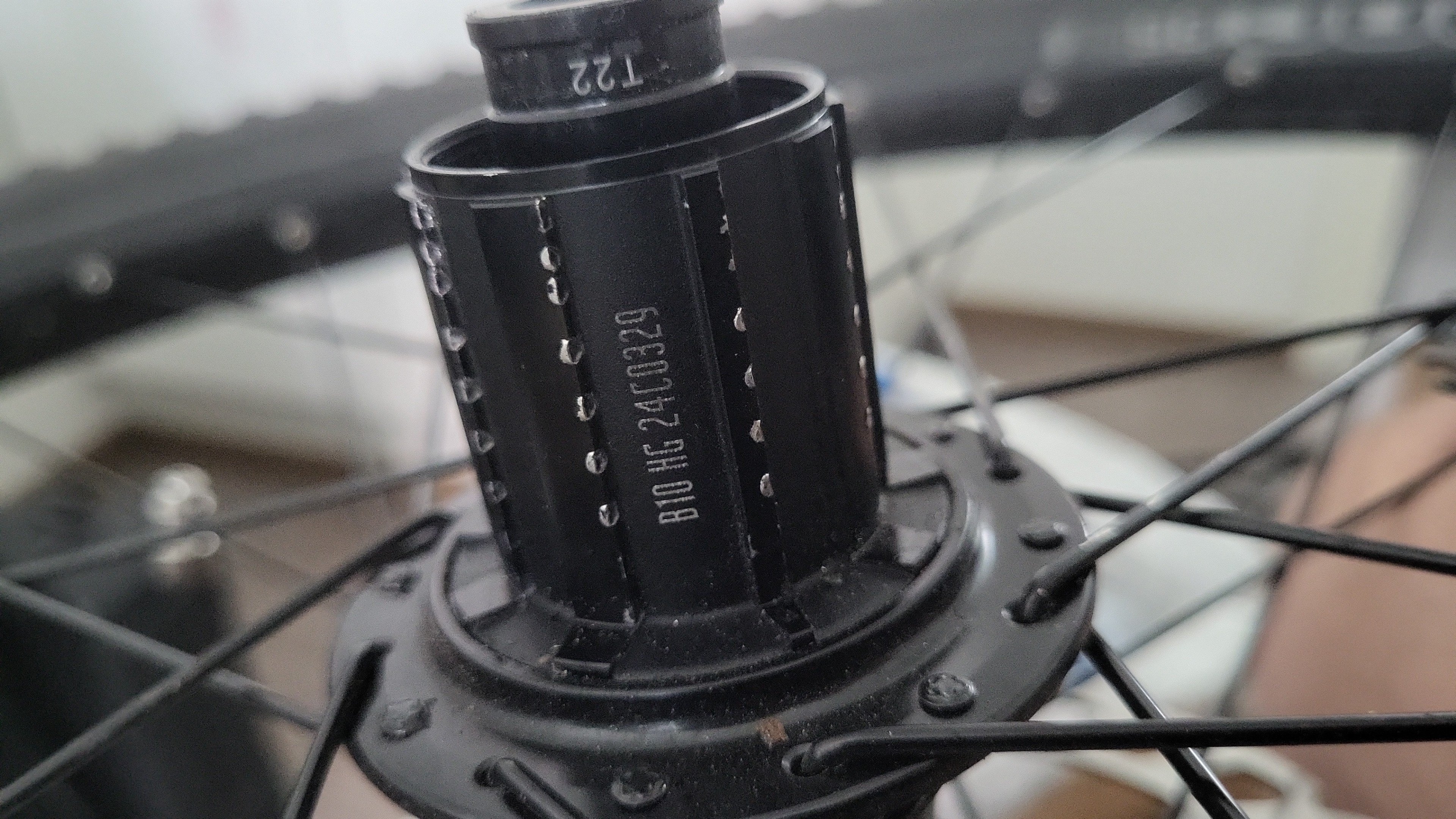

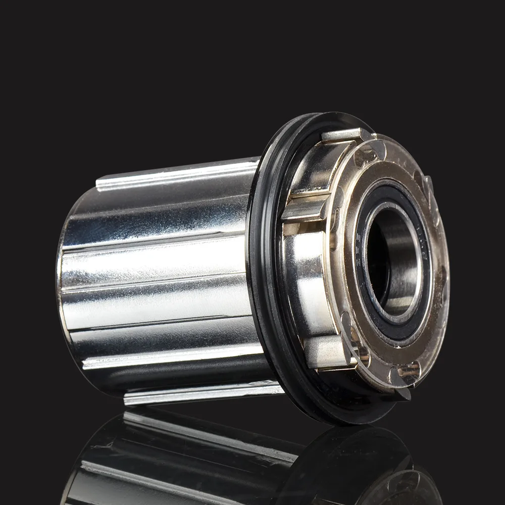

@sandnap have you removed your cassette since you started riding the bike? I found these marks on the freewheel. I guess it's made of aluminium. I hope koozer makes stainless steel freewheel housings... 😬
I haven't but perhaps I should, that doesn't look good. 😬
I wonder if the torque of the M560 is a bit too much for it.
Well could be but in my older bike I had barely any marks on my freewheel and I used it for over a year and other bike for 6 months before that. And those bikes had 10Nm more of torque. Now these marks have appeared in a month or two.
One of my friends told me that in the HG freewheel that I have they get these marks even if it's not an ebike if it's made out of aluminium and not stainless steel. He suggested that I should look if the hub manufacturer (Koozer?), in our case, makes them in stainless steel and replace it with that.
I'm just shocked how fast these marks appeared. I think both of old bikes had HG freewheel also but not sure if they were SS or aluminium..
Same marks in mine.
For now I plan to keep an eye on it. I suspect that the worst damage will occur in the first few hundred miles while the surfaces conform but time will tell. If you find an alternative let me know, I'll look into it too.

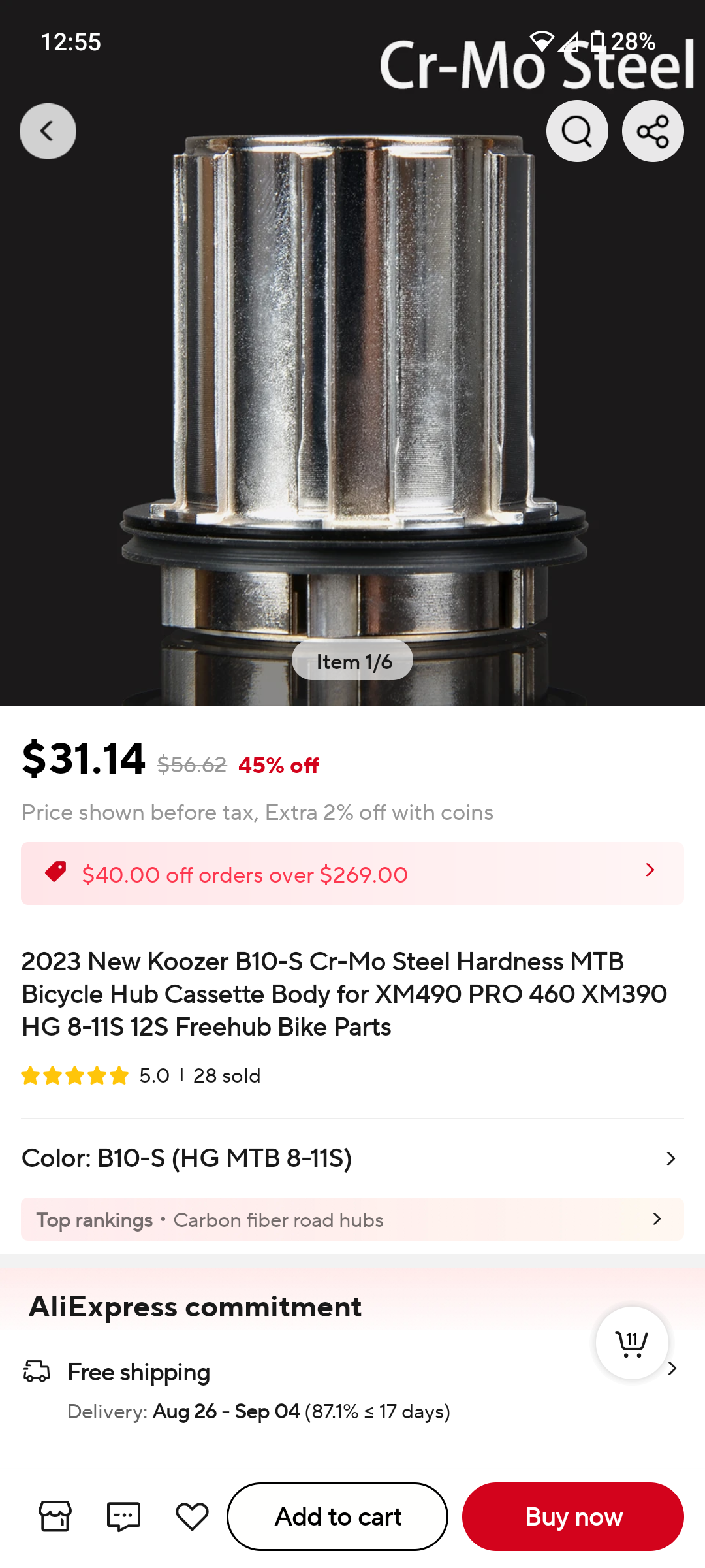

Update, looks like they make them 👍.
Update #2, I ordered one from aliexpress to have on hand. I think I'll keep the ALU one on for a while and see how it wears in the name of science.

Same marks in mine.
Great news that they make them then! Could you provide the link to it? 😁

@sandnap they pulled these also.. I guess they had them wrongly listed and they were out of stock... Aparently they will get more in 2 months.
I just fear my cassette will dig itself into freehub body by then and I won't get them apart 😅

Hi again mate 😁 Have you bled the calipers? I'm not sure if I somehow lost the correct bleed connector from the ezmb bleed kit or what has happened but I can't find a proper connector that would fit the caliper side... 😅 all of my fittings seem to be too big for the caliper bleed hole as it's much smaller.
Have you changed the rear hub cap for the steel one yet? They have been sold out this whole time.. last time they said they will get more at the start of this month and now they are saying end of this month..
Hello 👋 the brakes still feel solid so I haven't attempted to bleed the calipers yet. I also haven't installed the steel cassette body. The riding season is coming to an end here soon and I plan on tearing down and inspecting the entire bike at which point I will be taking care of these things. You'll have to let me know how the bleed goes if you can find the right fitting.
Enjoying the LCE971 & M560?
Sadly I wasn't able to find the proper bleed connector. I found something similar from a different bleed kit my friend had and I was able to do decent bleed but not a proper one. The connector did not seal like it should have.
I changed my hoses and olive+needle inserts all from bh59 to bh90. The hoses alone should make a huge difference.

Same marks in mine.
hey bud, i've seen all your DIY videos on YT :) amazing work :)
do you think the MS hub version would be better...thinking the "teeth" been more, can give a better traction and less usage? i have this dilemma too :)) i've seen many cases like this.

Somehow I missed your question. I don't know, it might be worth trying. If someone else has experience with aluminum MS hubs perhaps they can chime in.
