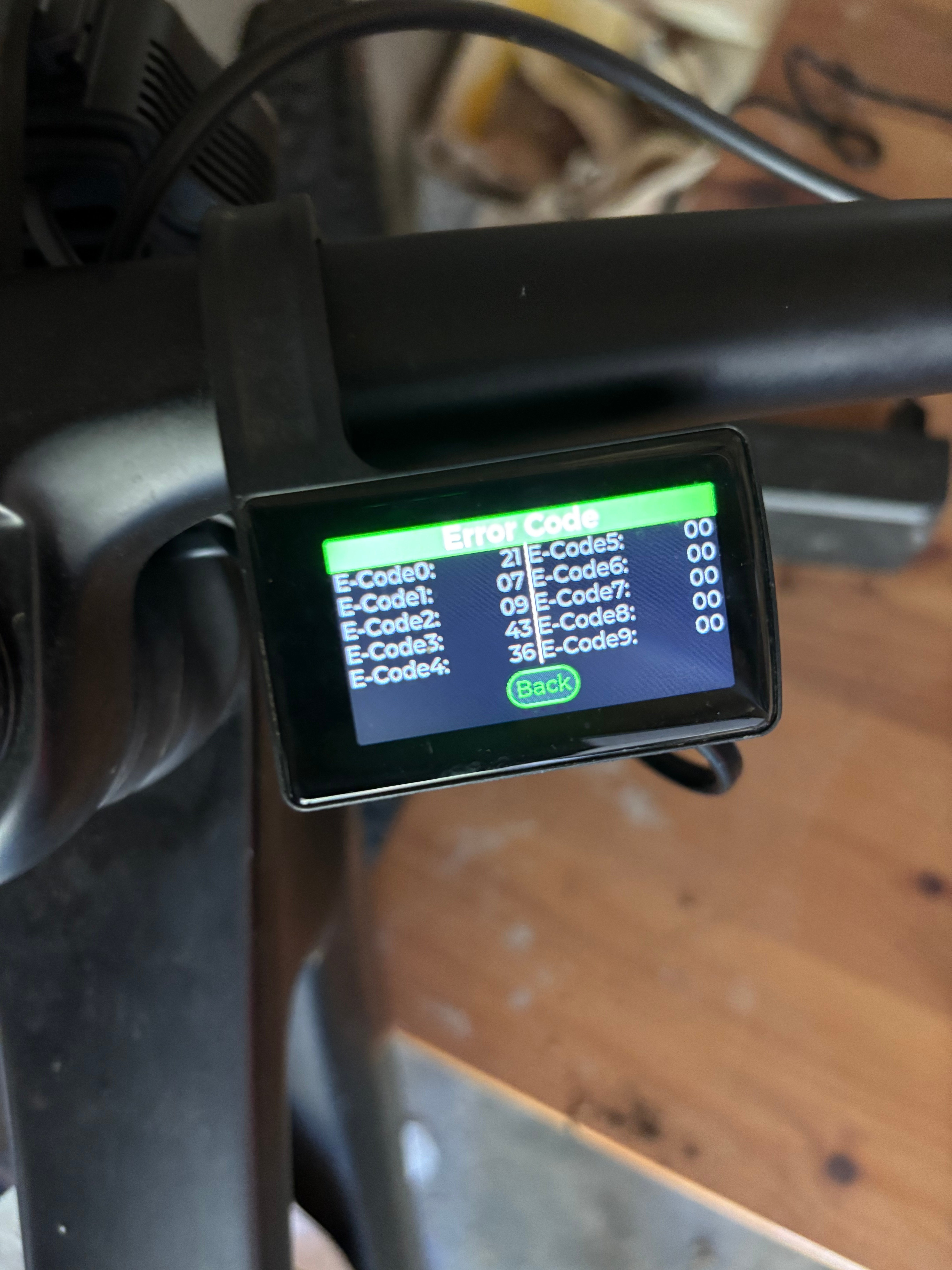

ok guys I need your help, 800 km here and motor is dead. I did not ride much the pasts months and I'm in holidays tonight, I was expecting to ride more the 3 coming weeks... I'm so disappointed.
Anyway, here is the video of the sound of the rattle and the error codes.
Any idea ?
Agreed open it up your self, I”m interested to know if it has water ingress.
It is so frustrating that opening up the motor affects the warranty.
Please share your findings

How do they even know you’ve opened it? I don’t remember seeing any anti-tamper stickers or anything on my M560.
I don’t Even know if they can see it has been opened. But yeah I will have to open it.
It‘s not only water ingress for sure, as the wheel does not turn when going backwards
Yeah those noises didn’t sound good, I bet you’ll find a completely dead needle bearing or a stripped/broken gear of some sort.

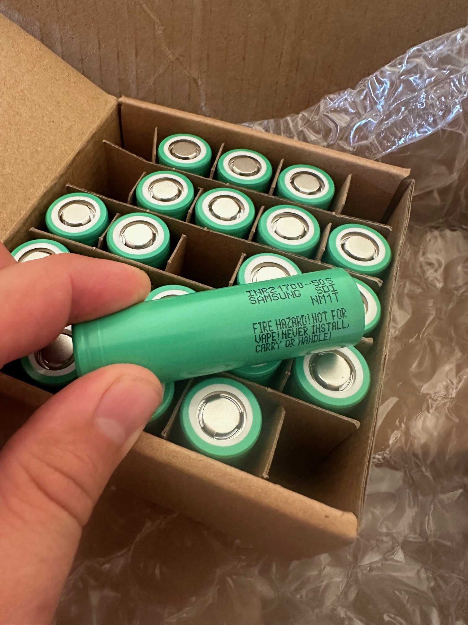

ive been reading and may of missed it as this forum is quite long now. Im building a 48v battery for my lce930 that is on its way and want to know about battery canbus. For those of you who made your own batteries... does it matter if you have canbus or not? from pictures it seems like most dont. will i still be able to see battery life from the display without it? Thanks!

No it doesn’t and yes you can still the battery level on the display and the app.
While it maybe possible to build a 48V battery to fit this frame it will take some time to configure the layout where as 36 & 43 volts is easy,. Are you thinking 39 18650 cells 3 x 13?
I bought 4 boxes of samsung 50s 21700 5000mah 25a battery to make either a 2ps13 @480wH or 3ps13 @720 wH in frame and then an external battery for longer weekend rides. I thought i saw 39 cell diy packs of 21700 that fit the frame, and figured id git it a try. a 720Wh 36v battery pack would take 40 cells, and i saw somewhere that people can take advantage of more voltage at the end of a 48v pack on 43v firmware or something like that... I want the internal battery pack to be good for 1.5-2.5 hours, and be able to get double that for weekend adventures.
for bms i bought a daly 60A 48V
also i speced my m820 out as 48v... but what does that mean? Is it a physical comopnent configuration or just firmware. If i abandon the 48v can i flash with besst and change to 43 or 36?
thanks

Ok if you need to read the guys on this forum who built 21700 batteries, you will need to get the layout sorted, but ultimately you need to wait until you get the frame as it’s really tight. My build was 36V with 18650 cells 3 x 10 so it was easy. Worst case you can change the firmware..
I wanted to keep the weight low, more wh = more weight and I have a full powered bike for big rides, I love my ride at 19kg full enduro.
thanks

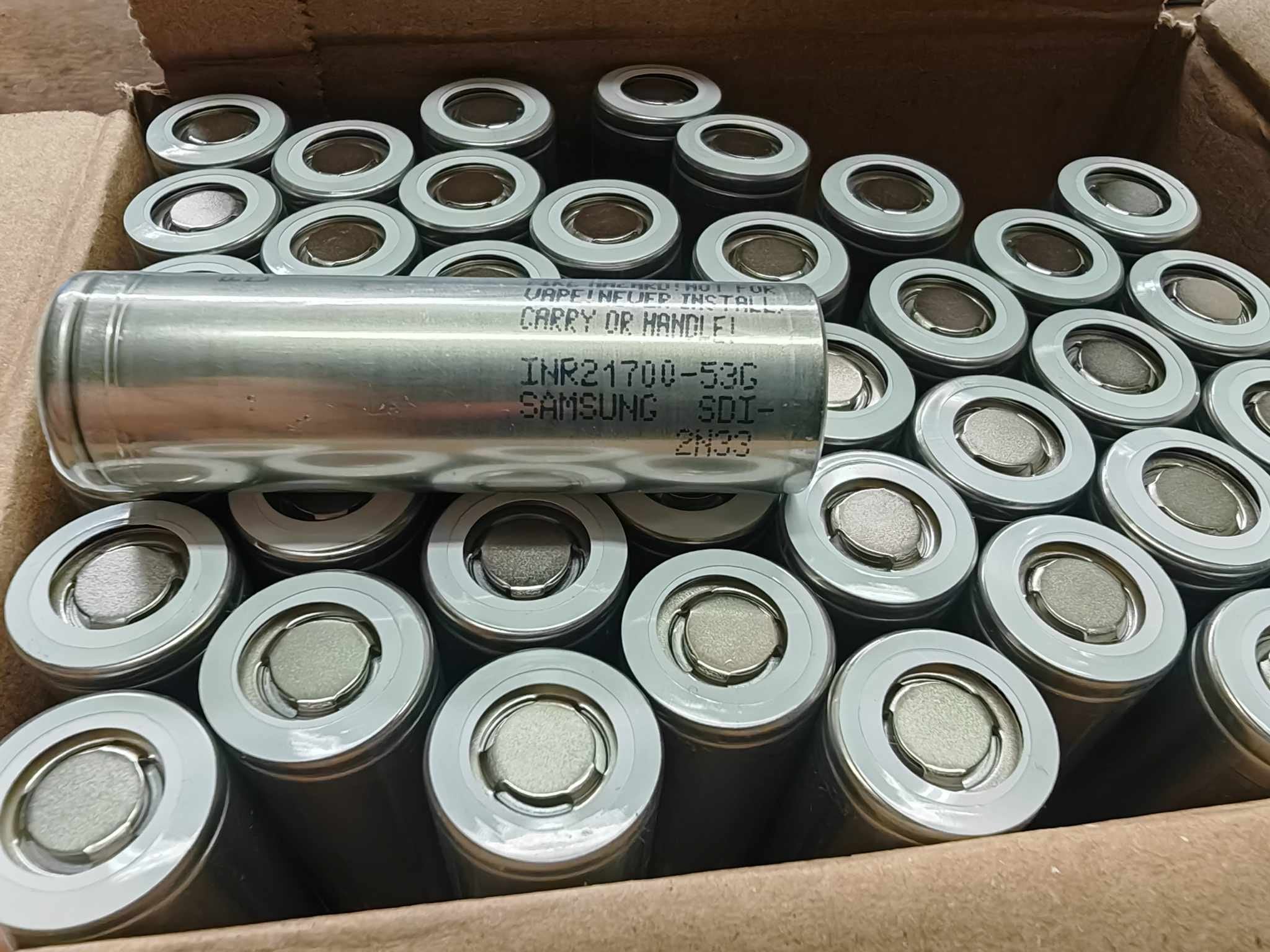

Another DIY battery on the way :D
559K
