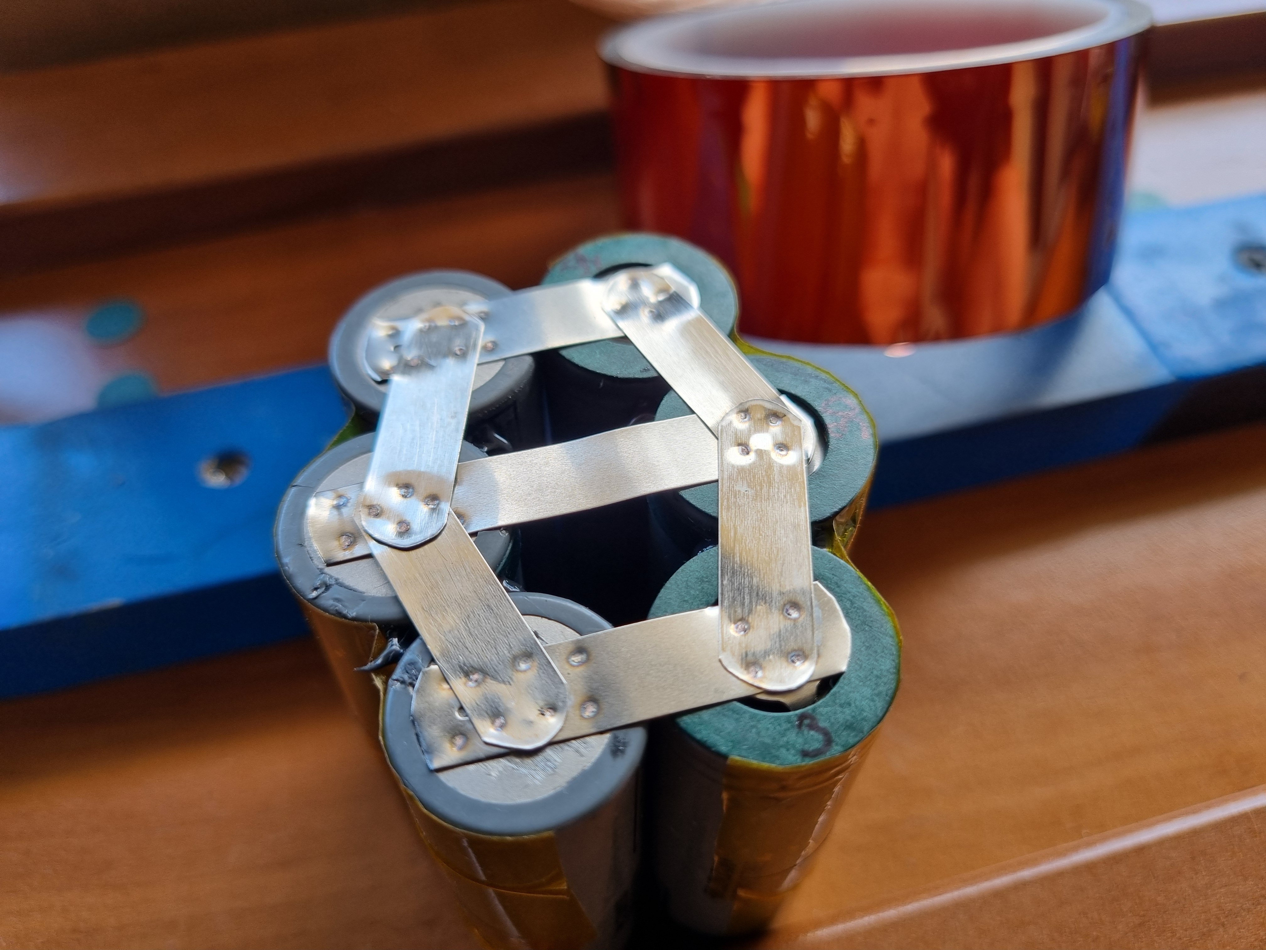

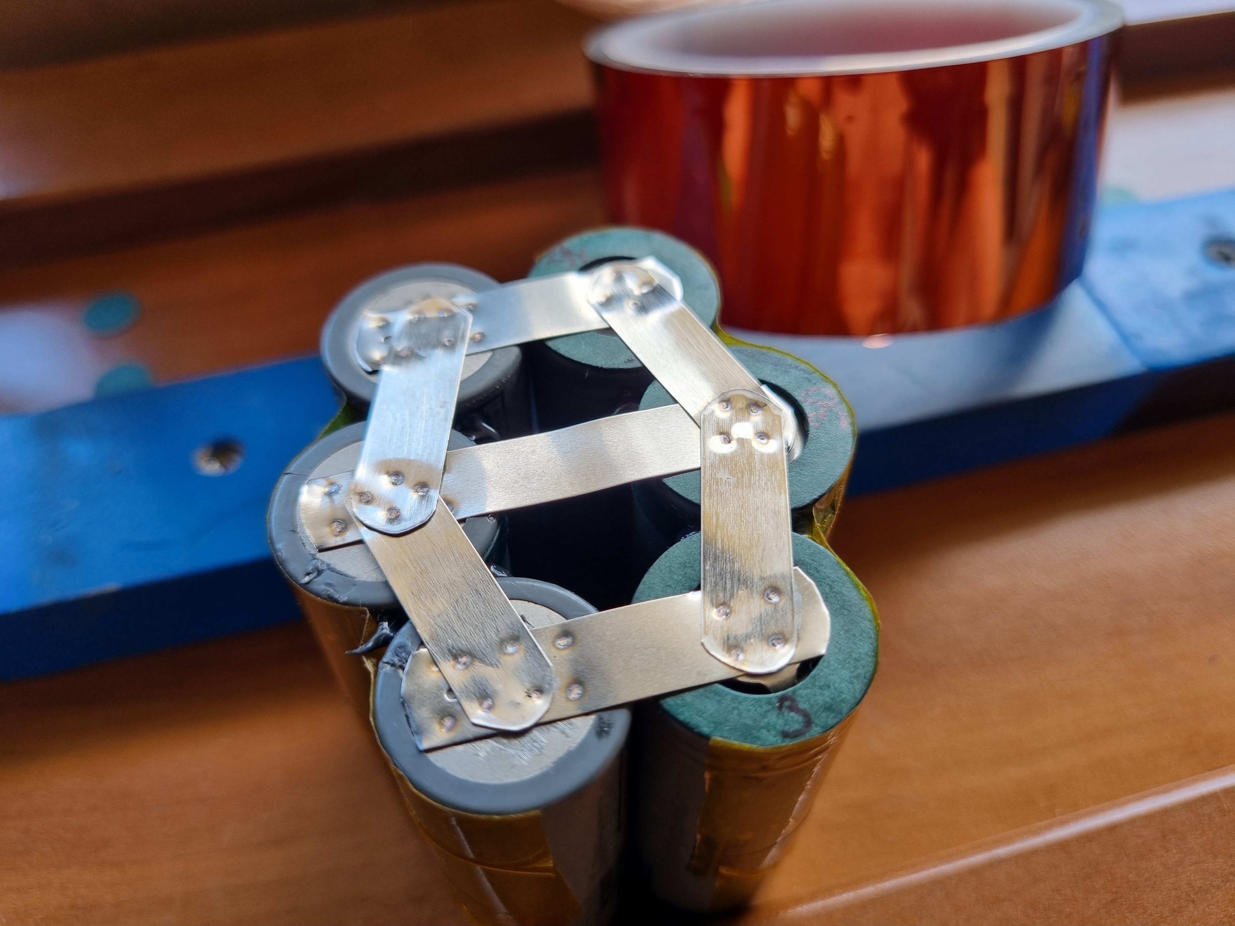

I have soldered 0,2 nikel strips at the + side (easy to solder), the negative side is spot welded.
Thank You very much for the photos, they make it a lot easier because why have to force open the door :)
Great job! why did You solder the positive pole and not weld it? if this is a more reasonable solution, maybe I will also go this route - I have some Chinese one, but it is sufficient for my needs and I will probably be able to handle it - what kind of soldering acid did you use?

I soldered positive side because it has lower thermal capacity and it is easy to solder, not much heat is been transferred to the cell itself, which is harder to do at the negative side of the cell.

Or, solder power lead onto the tab before spot welding to the cell :)

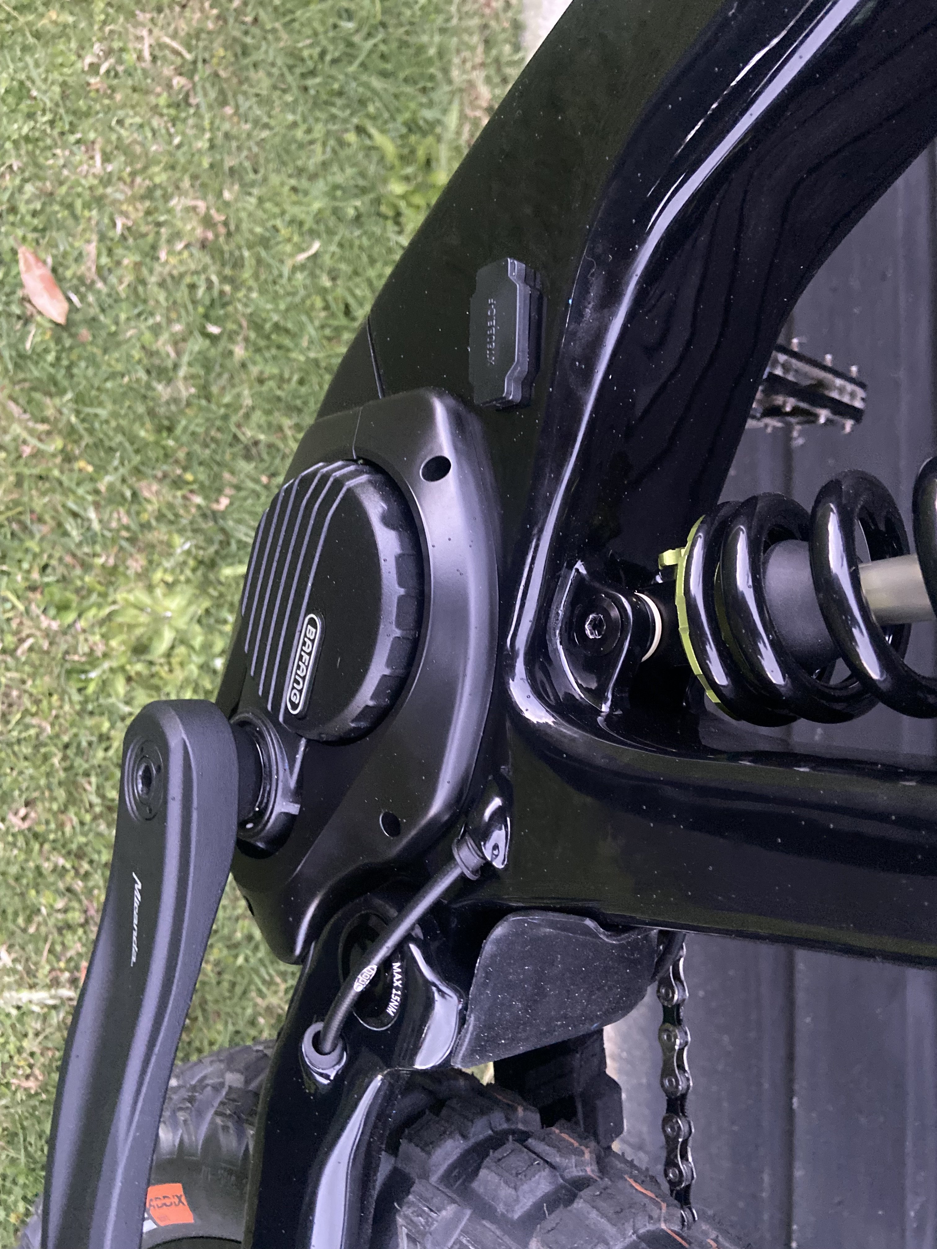

I have been riding my LCE930 for a few weeks now with great pleasure. However, I find the frame has a lot more pedal bob than the LCES0004 I had before with the same Fox DPX2 EVOL Performance damper. Anyone else notice this too?
Can’t say notice more peddle bob than my other ebike , I run a Dvo coil shock.

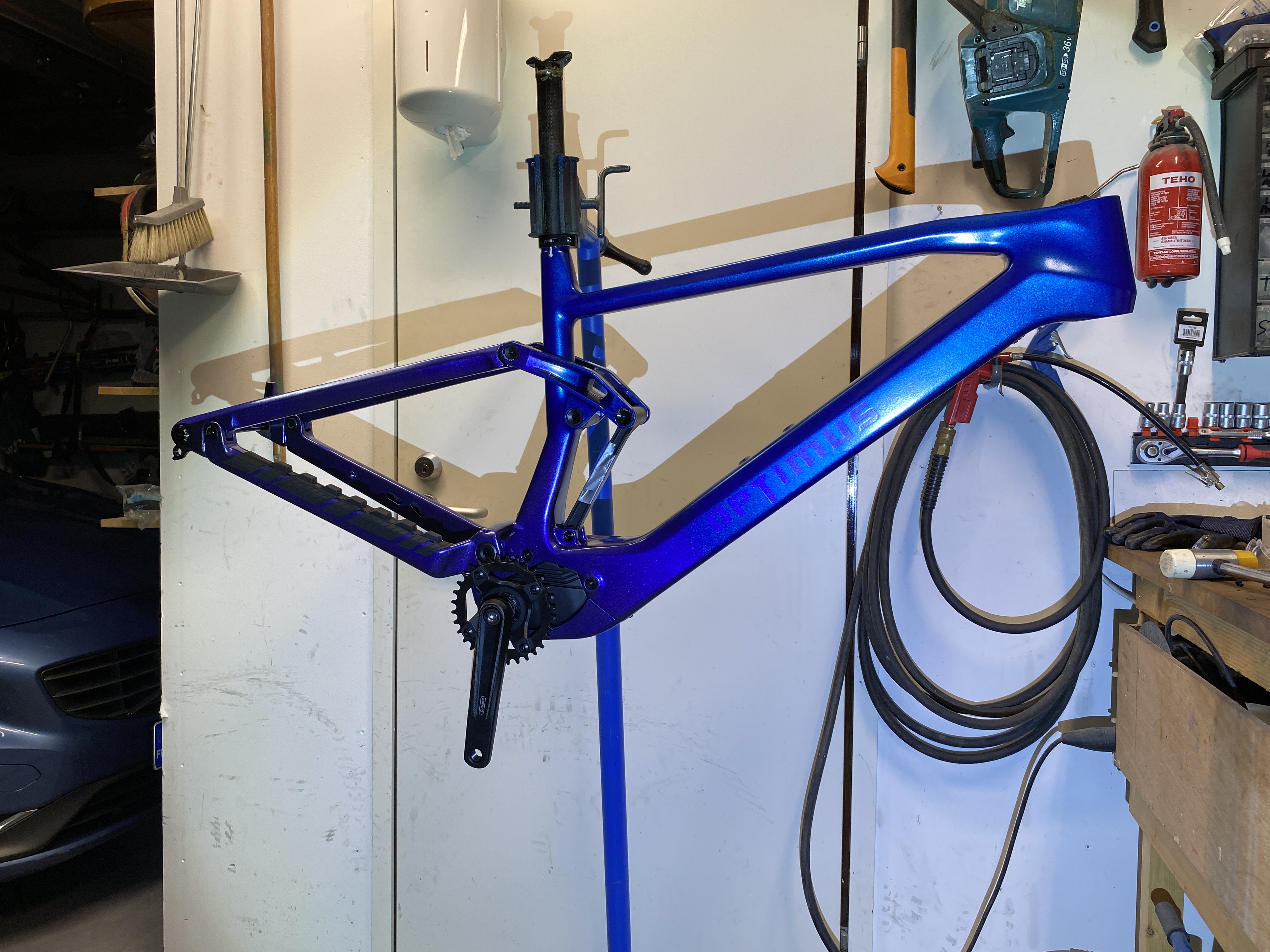

Does anyone know what frame this is?
It looks like a Light Carbon design

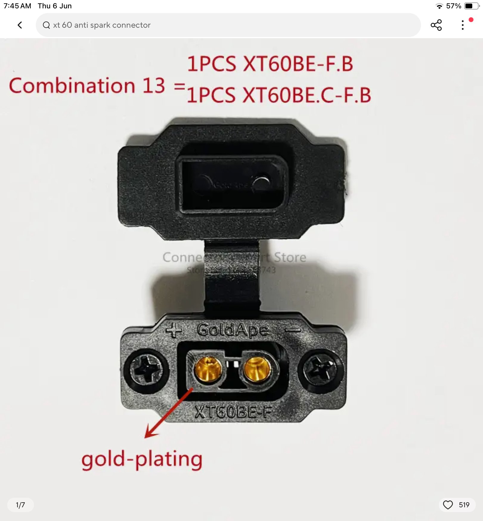

Hi everyone, I'm asking for your help. I'm making an LCE930 and I have practically all the pieces but I'm missing some and I'm having trouble finding them. in the engine kit, there was no charging socket for the battery. secondly I can't find the SR SD071.02 brake rotor speed sensor.

As for the charging port - I'm looking for a good solution - but I will make the battery myself.
Maybe someone can tell me what is good and waterproof?
no thanks, the sensor you put in is already there
I would need this:

I build the battery myself, so I need to buy a charging port that we attach to the bicycle frame. Please tell us what non-standard port You bought, and the photo of what it looks like was great :)

Cool. This type of connector appeals to me! I'll install one too ;-) Apart from the topic, are you satisfied with the engine? does it heat up a lot? is it noisy? I'm planning to leave by the end of next week and what I'm most afraid of is the engine - it won't meet my expectations.

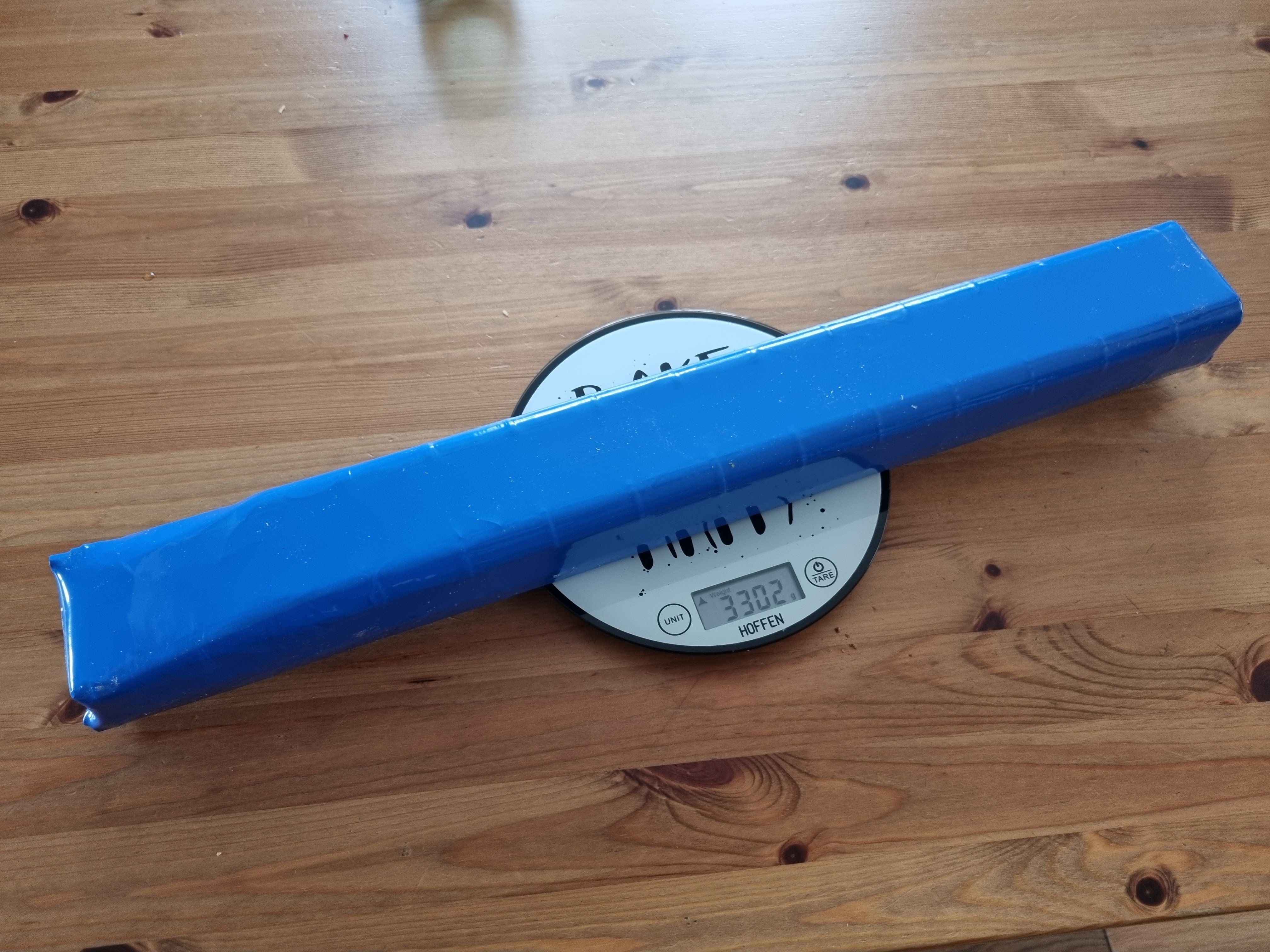

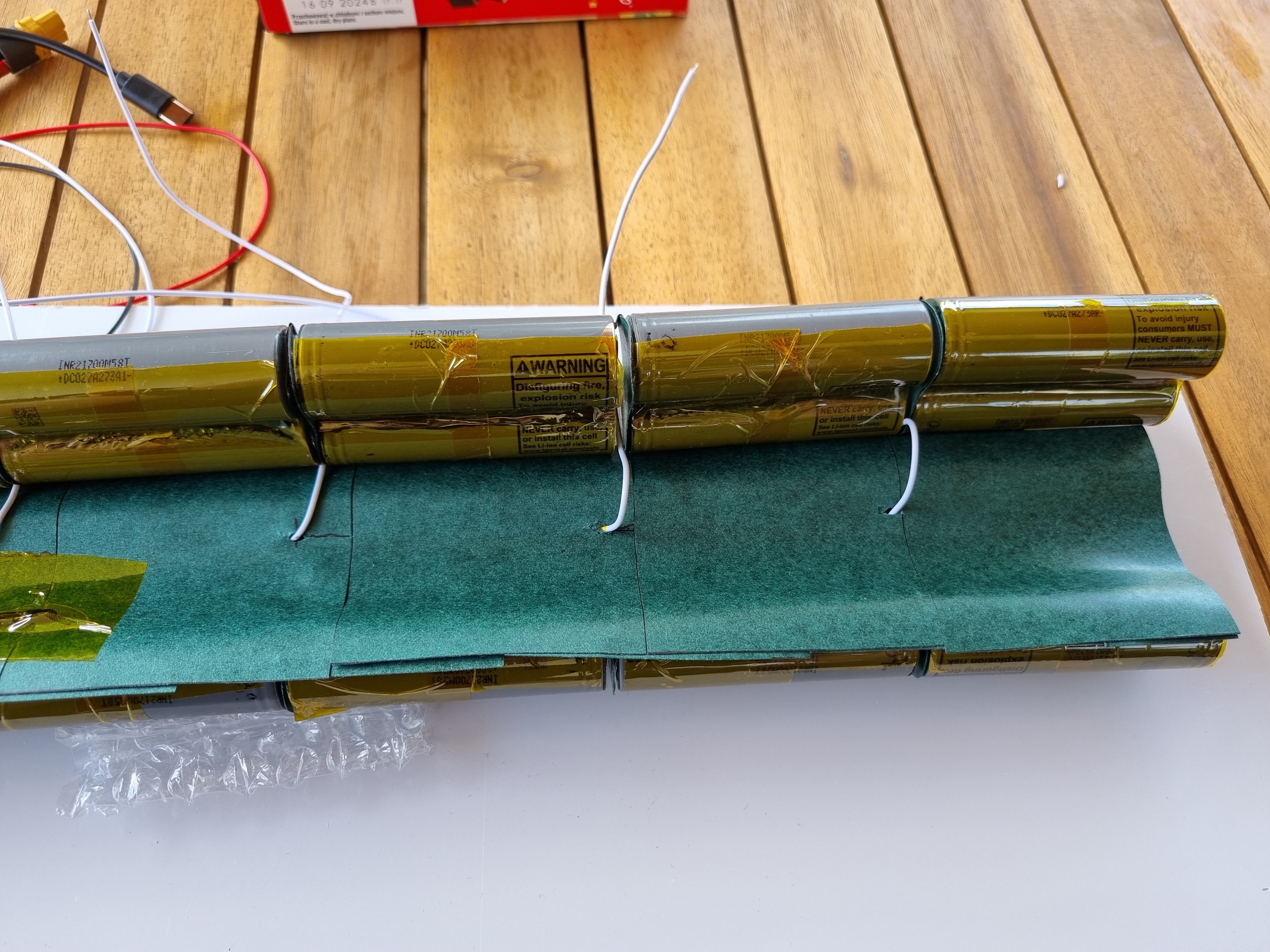

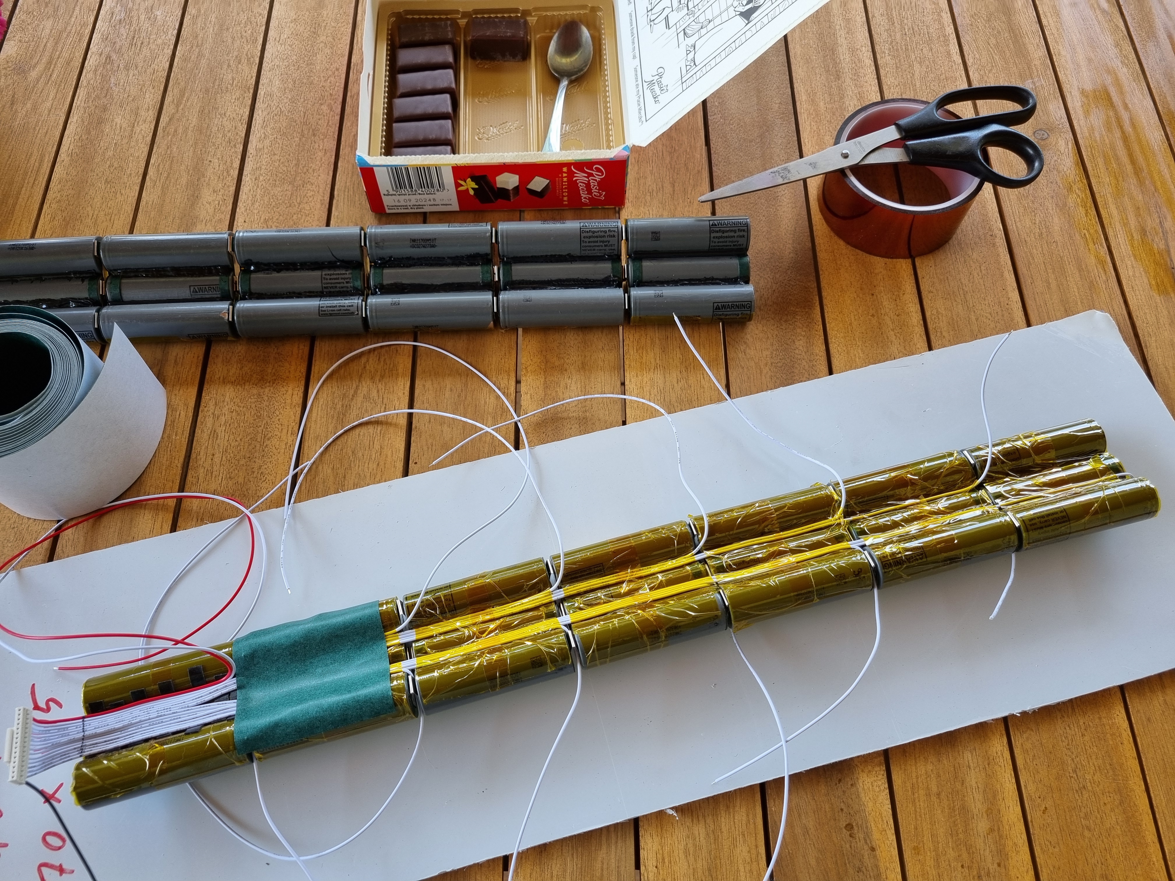

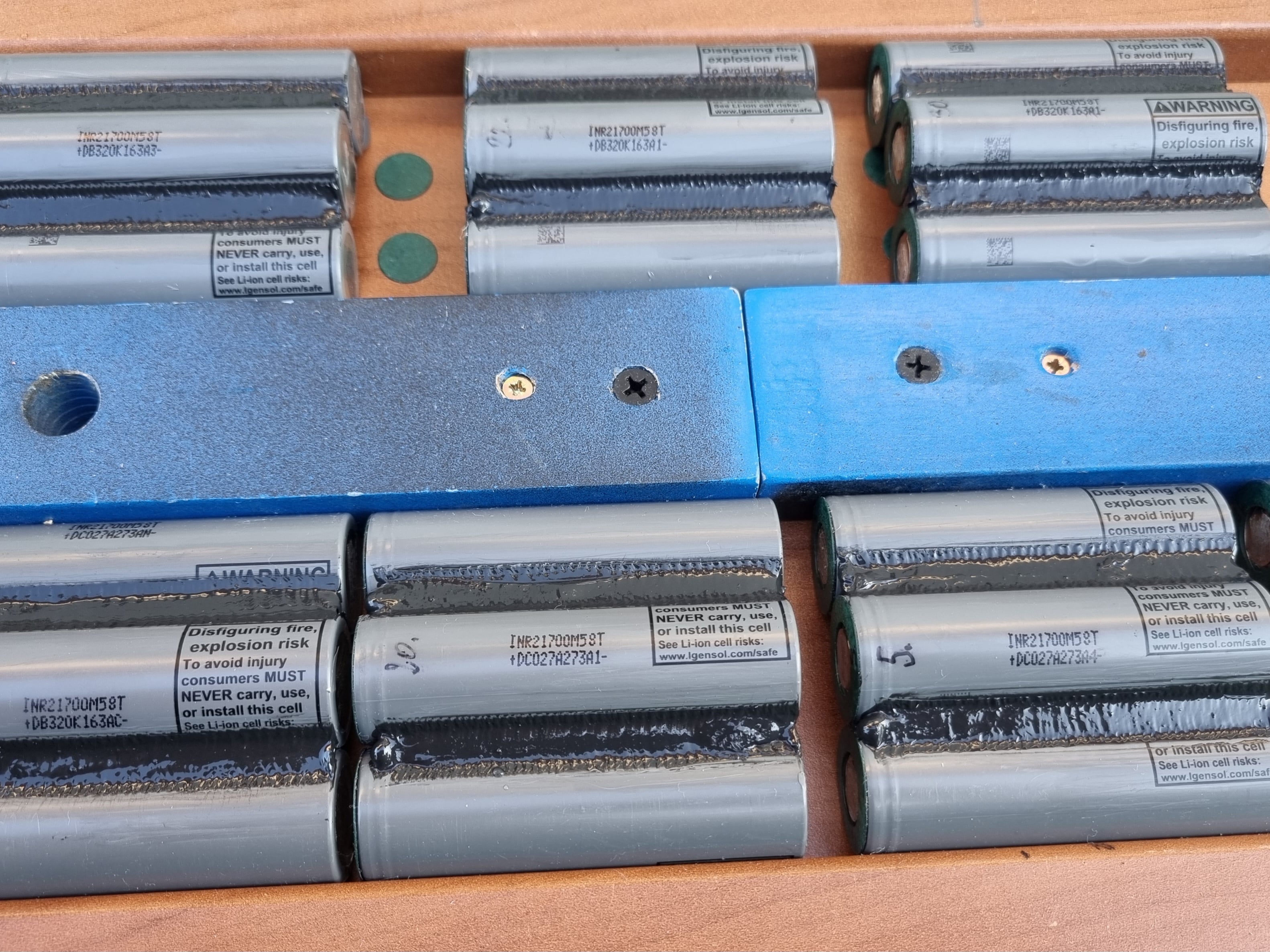

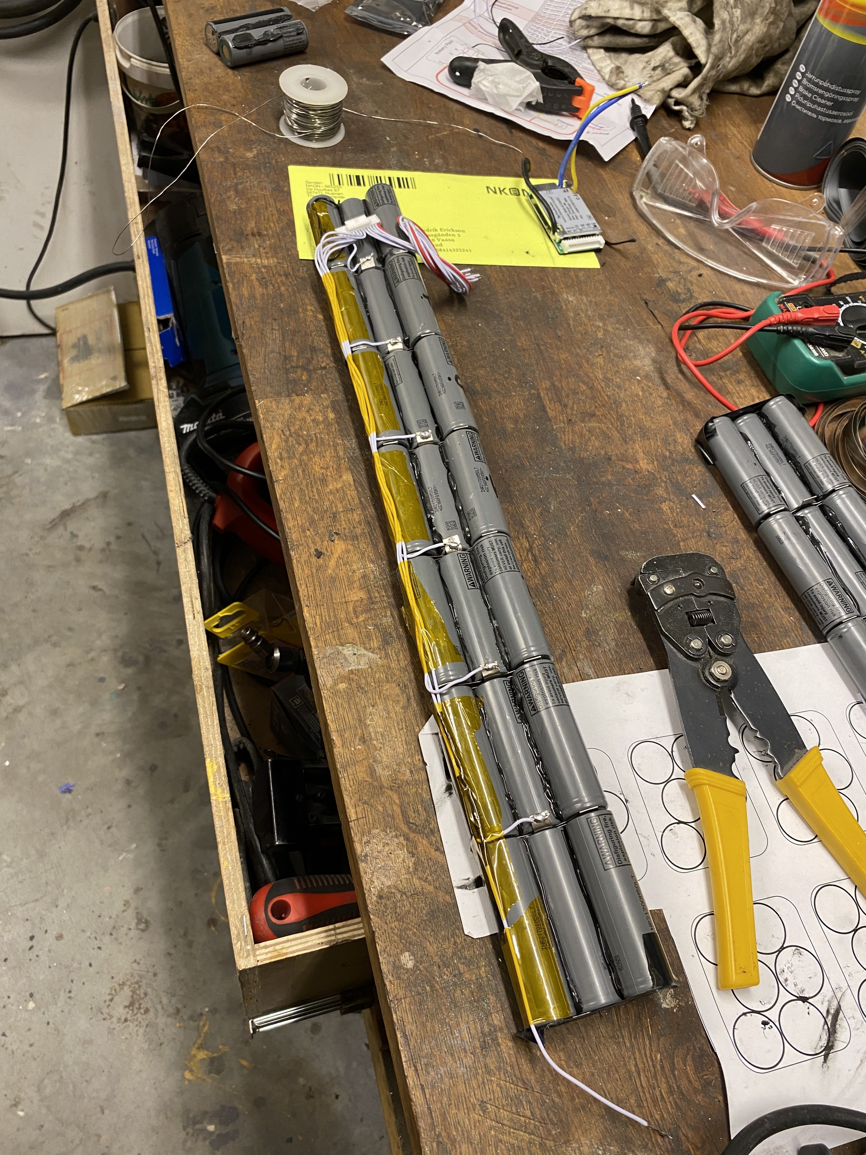

HI, sorry but how did you make the connections between the cells?
Hello, I made a package that looks the same, I glued the cells together with Loctite 5970 sealant (resistant to vibrations and very adhesive), I welded it with 0.2 mm plates made of pure nickel, I bent the middle plate into the shape of the letter "W", if you use 21700 cells, I think that the maximum width of the finished package should not exceed 64 mm (I made the cells themselves 63 mm wide, but 62 mm would be better). The base for the cells is made of a 5 mm thick solid polycarbonate plate in which I installed slightly modified M5 claw nuts. I glued the finished cell package to a polycarbonate plate using Loctite and wrapped it with fiber-reinforced tape and a heat-shrinkable sleeve...
View attachment 142061 View attachment 142062 View attachment 142063 View attachment 142064 View attachment 142065 View attachment 142066
ah ok thank you.

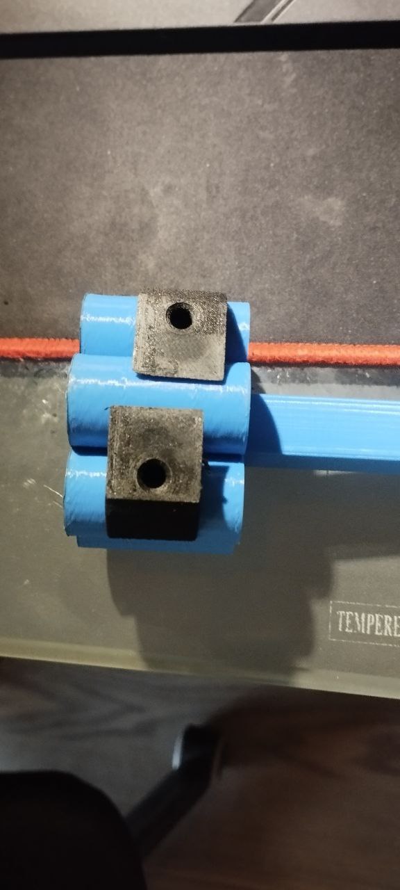

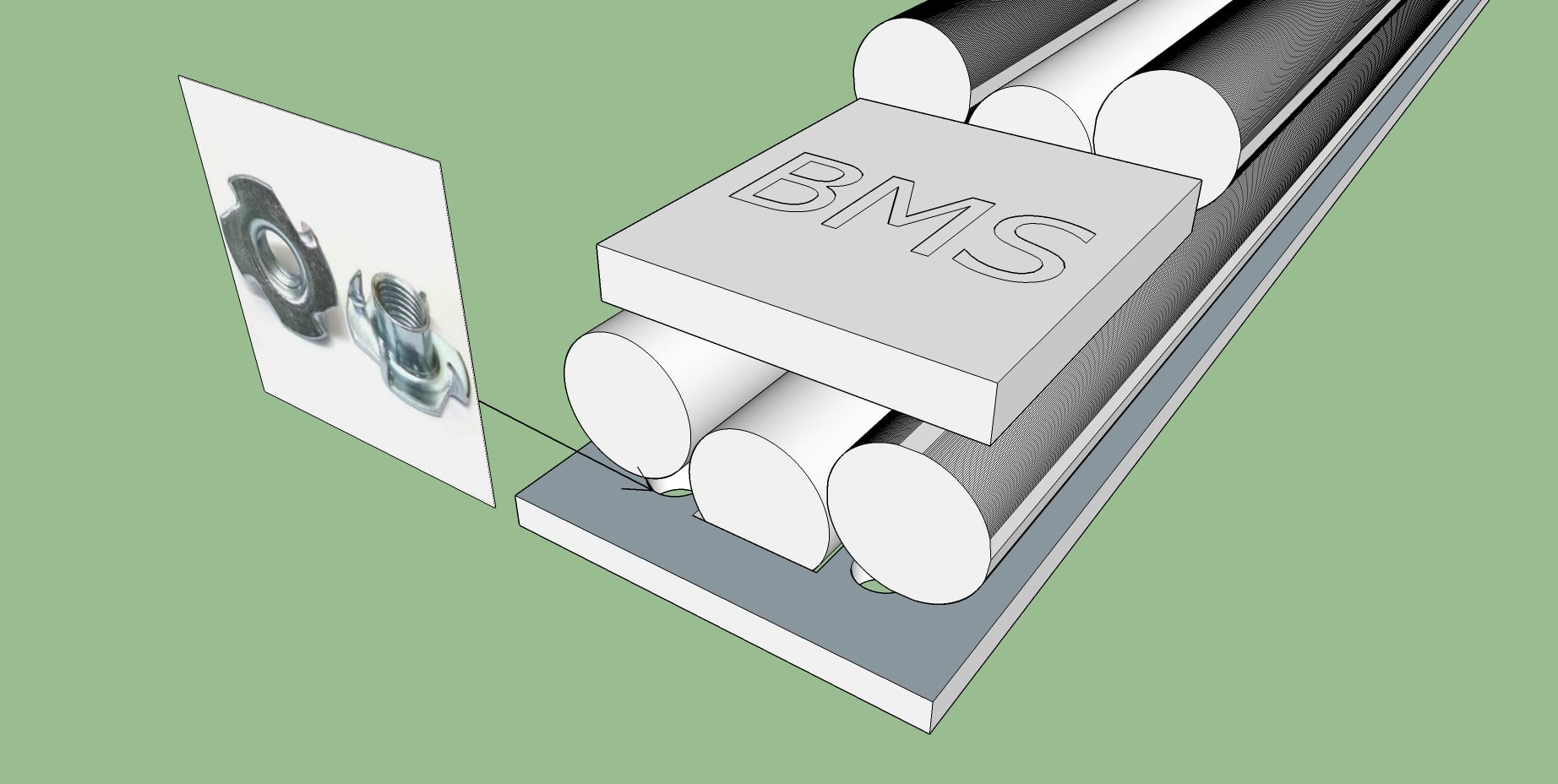

I would like to do as in the photo instead. with small but very resistant 3D printed blocks (pa12 cf 20/25) and then closing everything in heat shrink and reinforcing the holes with American or carbon cloth tape. but I was actually interested in knowing the electrical connections if possible. because I make 13 small packs of 3 cells in parallel to already have the 15 AH, then connect all 13 in series to bring everything to 48V and therefore have 48V for 15AH = approximately 720.
among small packages you certainly need to insulate them, can I do this with insulating tape?

ah ok thank you.
Somehow I'm afraid whether single mounting points will be enough!? - personally, I think that the entire length of the pack must be rigidly fastened because when driving off-road, any small movements of the cells can result in broken connections, abrasions in the insulation, and in the worst case, a short circuit! That's why I used gluing between the battery cells, a thick spacer between the two rows (I also used glue) and wrapped the whole thing solidly with fiberglass filament tapes, and the heat-shrinkable sleeve is only a rough protection against moisture/water.
As for the electrical connections, I think that the attached photos clearly show how I did it, and you can guess the rest - and your package is exactly what I did, i.e. 13S3P, the most important thing is the insulation between the first and second layer of cells and at the poles positive links.
ok thank tou to much

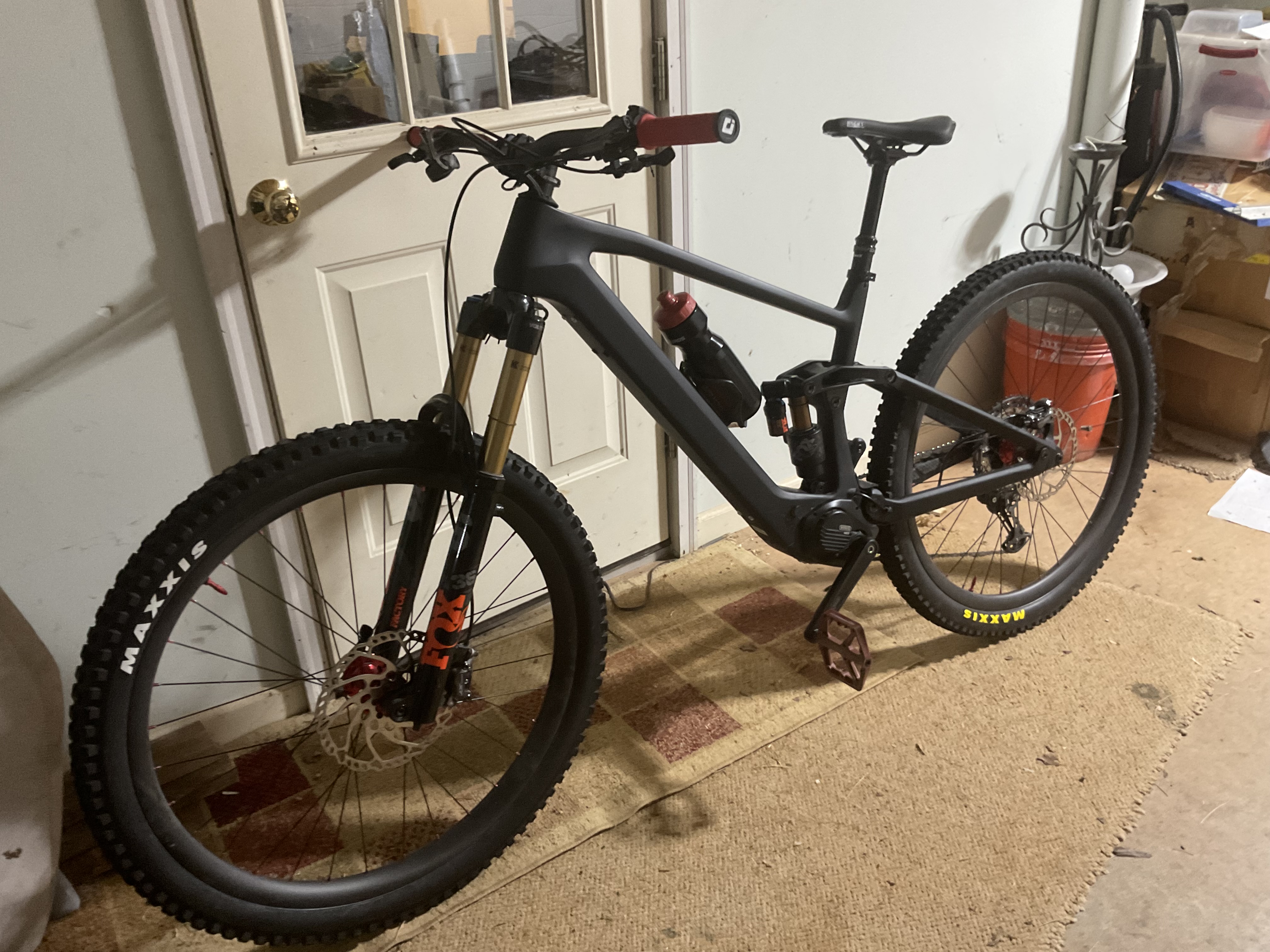

Question for the ones riding this frame with a coil shock, are you easily blowing through the travel? With an airshock I find I need lots of tokens to make it more progressive. I like to have a coil shock but I am afraid the leverage curve is not progressive enough..
clix
Jul 24, 2022
186
209
EU
I am 71kg + gear. I have 2023 super deluxe ultimete with 450lbs spring. I have lsc and hsc closed and it still feels very plush. But it is still quite easy to bottom it out. Even with the HBO. My shock does have L(ligth) compression tune and considering the levrage rate, it would probably benifit from M or H.
I just recieved 500lbs spring, and will try it in folowing weeks, to see if it would be any better regarding bottoming out.
