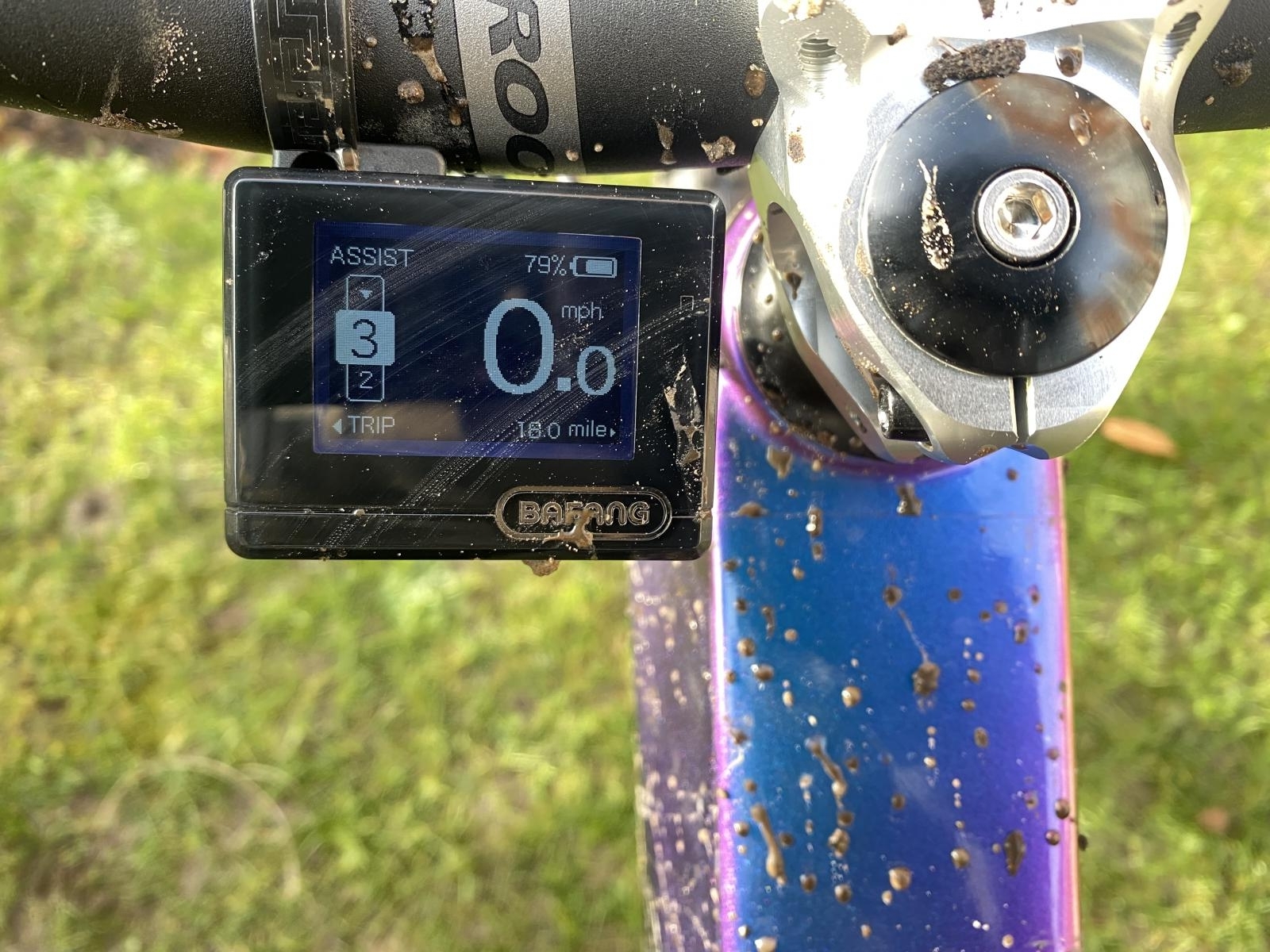

There's talk of the screen settings being able to give 5 and 9 levels, are you sure that on the other settings, say the 9th setting, will not get more assist ? Certainly other riders are saying that the M500 is comparable to the Bosch and Bafung claim 85Nm of torque for the M500 and 120Nm for the M600, which should be comparible ?
I tried levels 5 and 9 also ?
With a setting of 3/3 - Level 3 is the equivalent of level 9 (it just removes all the in between marginal assist levels, so 3/3 = 9/9)

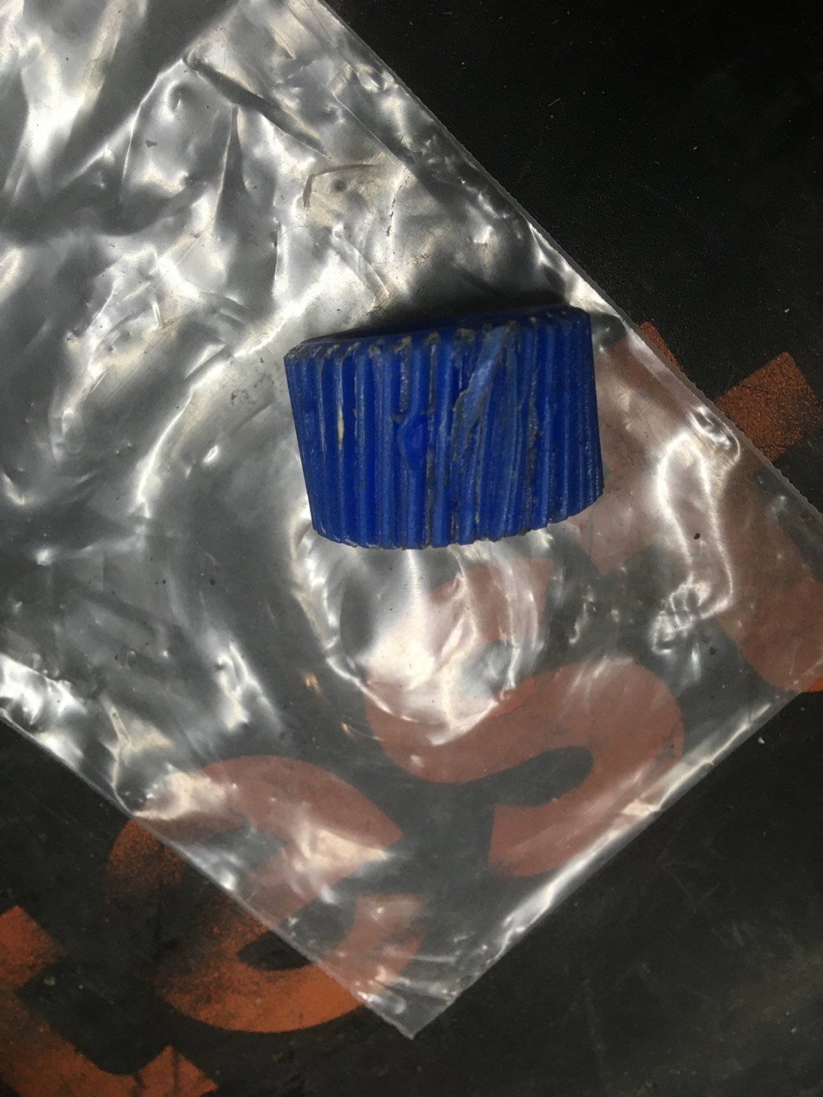

You'll probably find that the m600 has one metal gear inside along with the nylon ones to help take the extra load and to stop the gears turning into peanut butter when run at higher amperage. Which in turn will make the motor a lot more audible.

Are you underestimating the max output perhaps if the acceleration has been wound back ( the M600 had the same plastic main drive gear but in its early production run, the motor power stripped it and they went over to a metal gear ) and the engine is quiet with a slow kick in to prevent damage to the plastic gear on intial drive. We've all been in super quiet and super smooth cars that just outpace the V8 next door.
