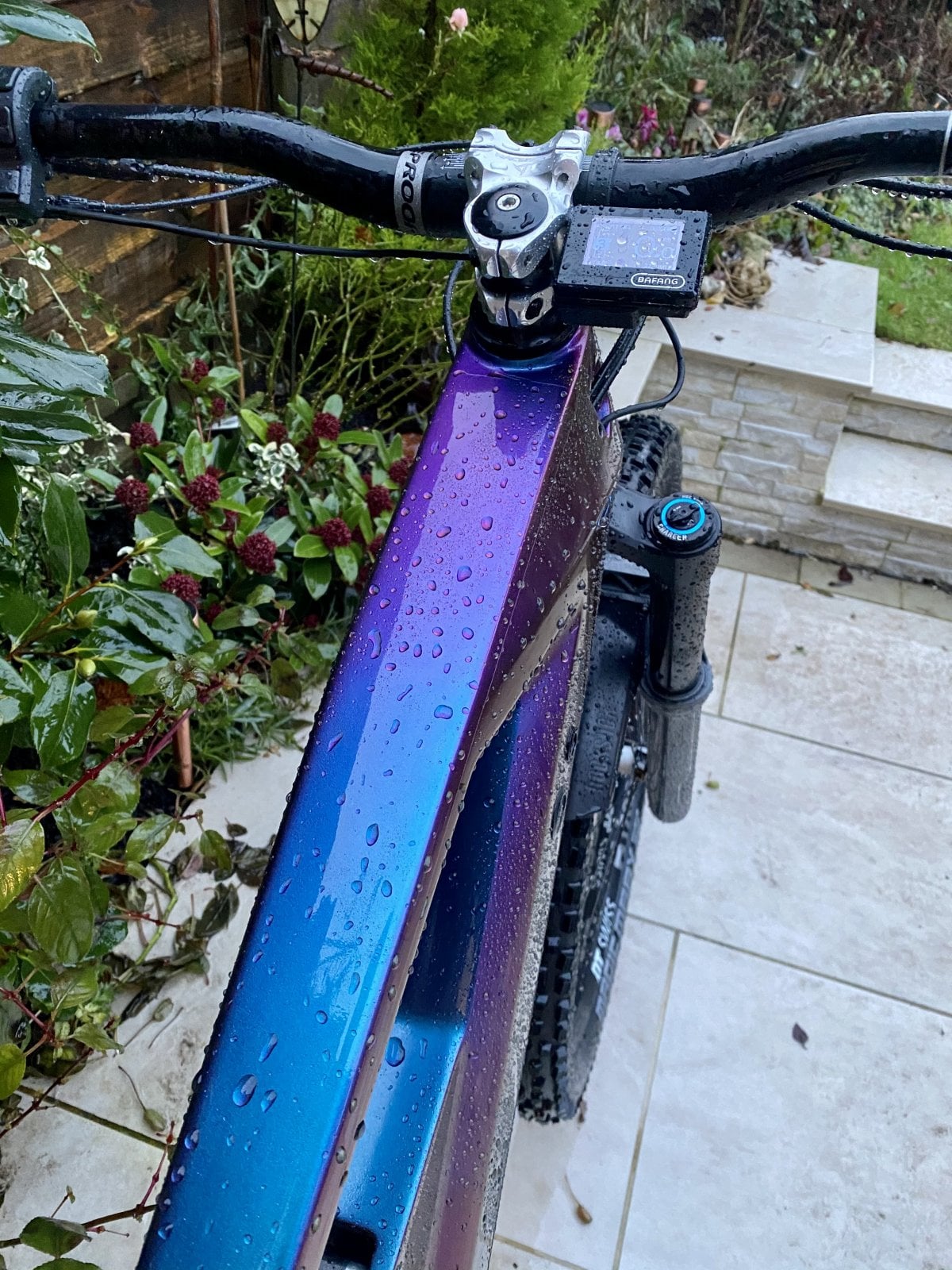

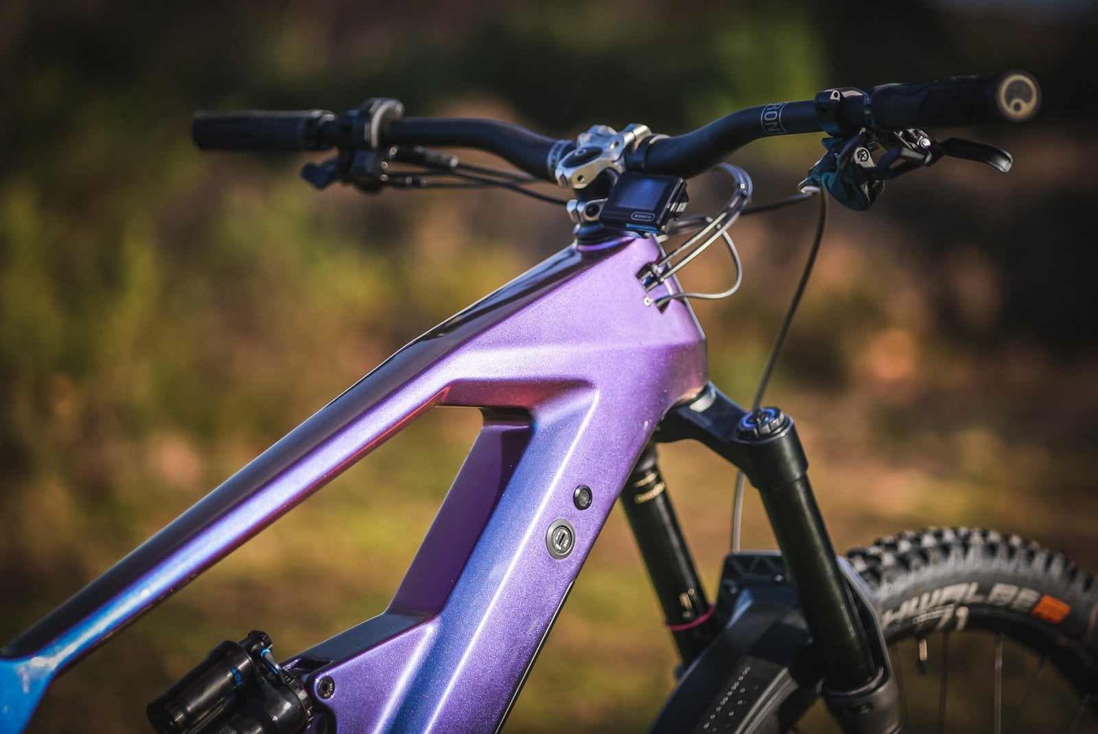

Thanks. Not too bad then. Most of my projects end up rather more expensive than anticipated...
Thats some expensive paint! Worth it though. Looks ace.
I wasted a lot of the paint as my technique was bad. Also the flip colour paint is super expensive. Half the paint costs for a flat colour and a better technique!

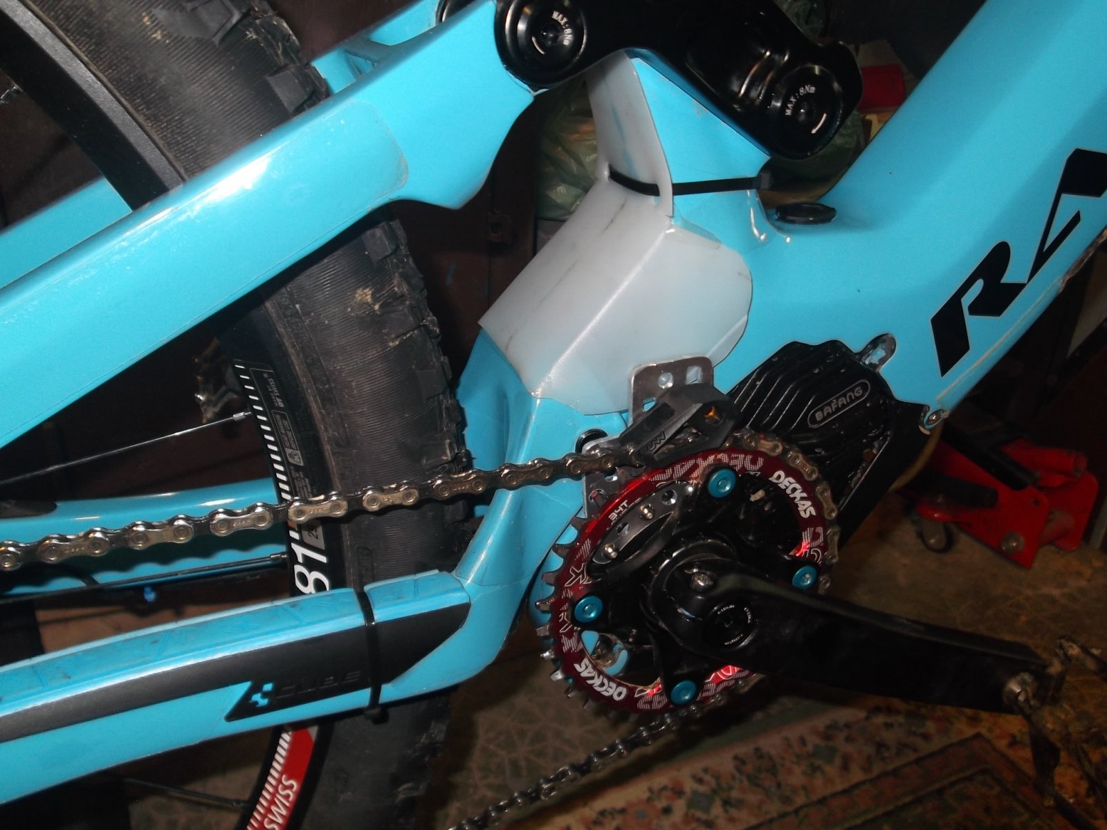

Fabricate a custom mount to lower the motor and hence bottom bracket by 20mm.
A bit of steel plate and a drill should do the job
I’m using these:
Easy and pretty cheap.

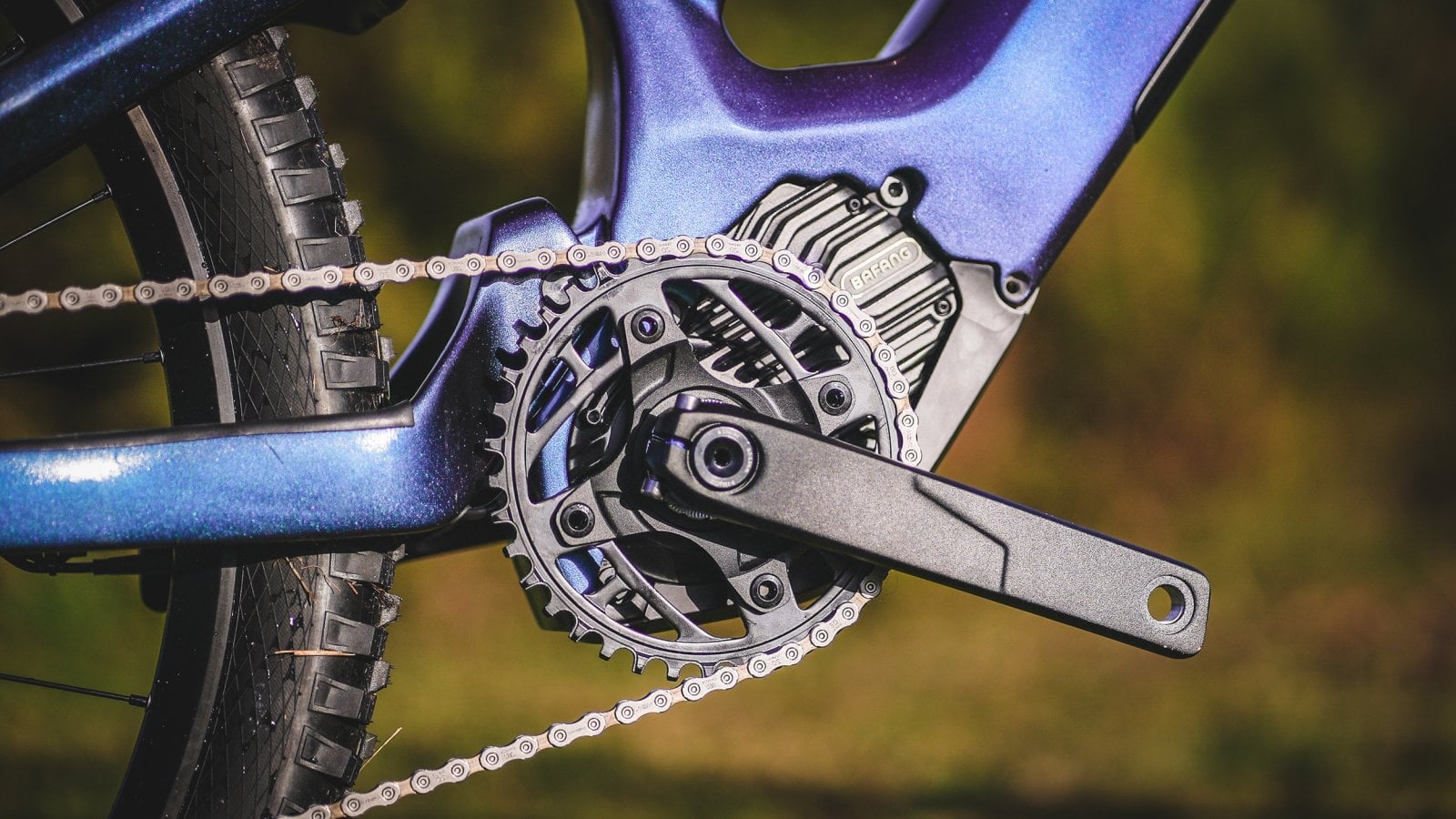

No idea! I’m waiting for a Bafang chainring lock nut ?
Nope. No tools (or any instructions) are supplied with the frame / motor / battery packages.
So just to clarify...
You didn't get a chainring locknut with the motor, or the tool to tighten it?
Tbh I didn't expect them to supply a tool, but would have thought the locknut would be included.
Where did you order the locknut and what was the cost?
Sorry - to clarify. Locknut included but tool to tighten not included.

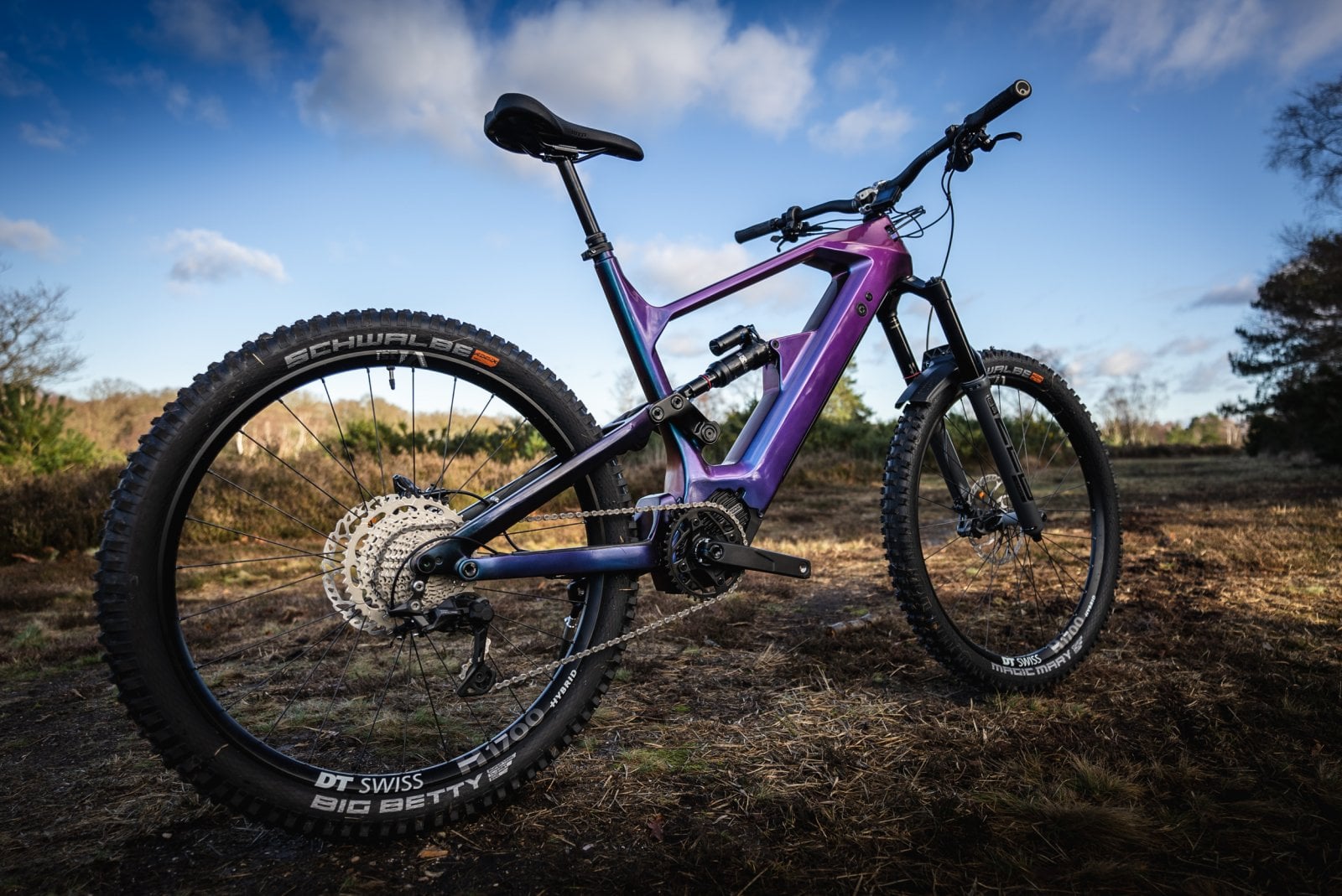

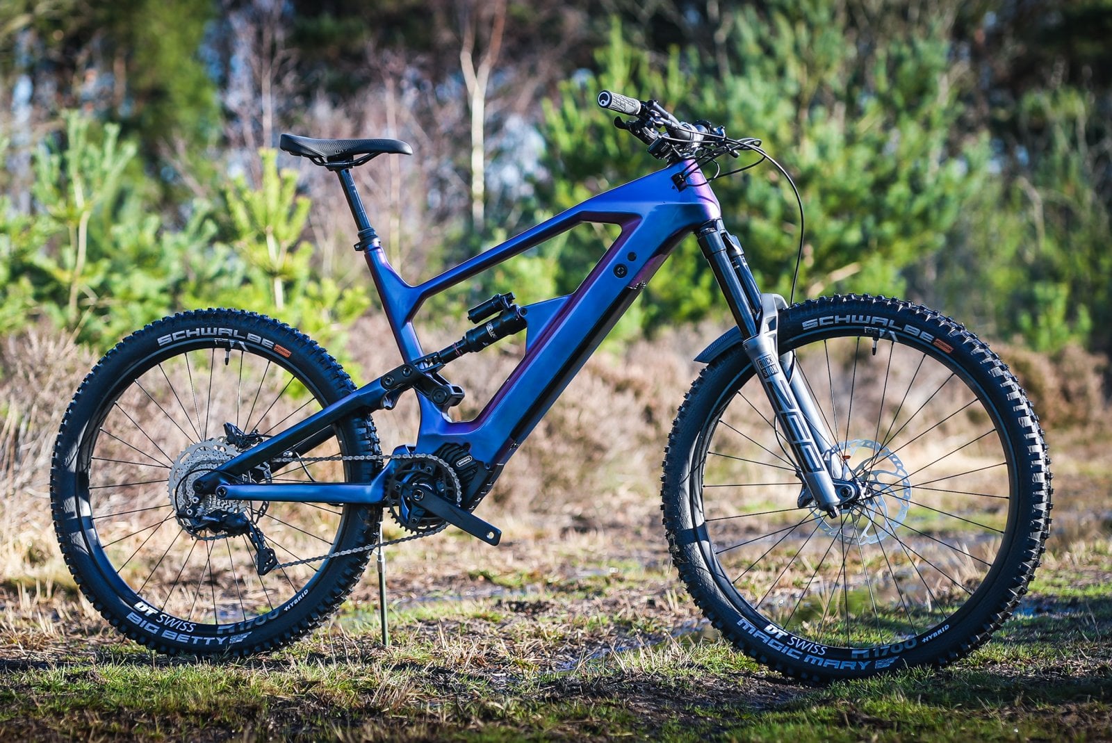

Another quick ride today. Only 15 mins, nothing technical.
Bafang M500 Motor
So far its pretty impressive:
  • Motor is smooth and progressive in delivering the power, pretty instantly engaging and assisting
  • Seems like there's not as much 'instant kick' power as Bosch, takes a couple of revolutions to really punch, perhaps having a more natural feeling
  • Once you get going it feels like a nice chunk of power, between 5-15 mph it really pulls
  • Very very quiet on load under full power. Not tested on rough stuff yet to see what its like under coasting / unloaded noise
  • Instant engagement from the motor / zero crank play before engagement
Dengfu E10 Frame
Feels pretty good so far but early days. At the moment I'm just making sure it is set up correctly rather than focussing on performance aspect. With the 170mm travel / 155mm rear its super plush as you'd expect.
Again, frame is totally silent, no creaks, knocking or noises. I already added some really thin (1mm) 3M rubber tape on each side of the battery compartment to reduce any battery rattles, as well as on the underside of the battery cover itself. I also filled some parts of the frame with bubble wrap to reduce any cable slap inside.
Some Stats / Geometry on my setup
  • 505mm Reach
  • 63.8 degree head angle with the RockShox 170mm Zeb
  • 29er front, 27.5 rear
  • 455mm chain stay
  • 348mm BB height
  • 24.5KG
Got to say so far I'm pretty impressed. Although I have only been riding around paved stuff. But I have a feeling it's going to be a proper capable enduro ebike.
Things to do:

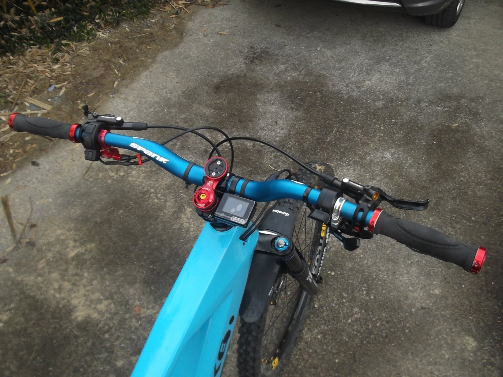

  • Fix display to the 35mm bar. Bafang display is setup for a 31.8mm bar, clamp is too small
  • Get a longer cable between the remote control and display. Its too short
  • Find 2x bolts to fix the bash guard
  • Sort out chain length. 116 link chain seems to short (I think its a 40t chain ring)
  • Try with 29er wheels front and rear and 160mm fork, offset bushings in the RockShox Super Deluxe to drop BB
  • Ride some actual trails

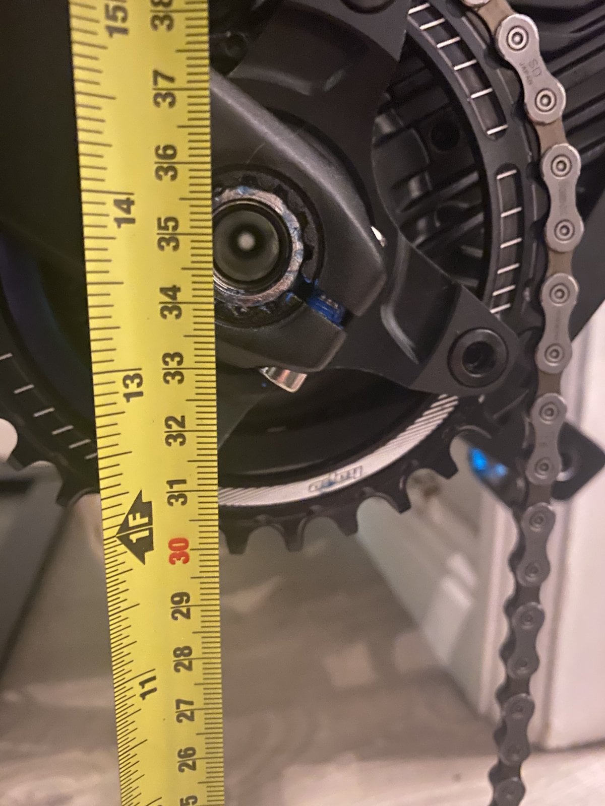

Yes it came stock with a 40t - these Bafang motors usually are paired with crazy high speed derestricted bikes with 1000-1500w power. So assuming a 40t works well on those.
only thing I have is a 32t so that’s going on for the time being.
also I managed to correctly get BB height -I’d say more like 348mm looking down the barrel of the bottom bracket

Another short ride today on some actual trails.
Bafang M500 Motor:
  • Power delivery feels stronger than the Shimano EP8 / E8000, but less than the Bosch / Brose. The display registered a peak of 580 watts on a short climb
  • Motor software is good - no spikes / surges, feels good from a stop
  • Characteristics feel more like the Yamaha PWX-2 (no power surges, just linear power)
  • Super super quiet. I'd say its slightly louder on power than the EP8 and significantly quieter than the Bosch Gen4 and Brose
  • I didn't notice any clunking / rattling from the motor
  • I'd think this will be a mile monster, with the 840Wh battery, depending on motor efficiency I think it'll out last most ebike systems (all other things being fairly equal)
Dengfu E10 Frame
  • I want to find something I don't like but at the moment its pretty faultless
  • Feels stiff, very quiet. I think the only thing I may find is the frame is too stiff (will see as soon as I get to Surrey Hills)
  • Was soaking wet today. I've already applied some ACF50 to the internal electrics areas. Will see how I get along with water ingress

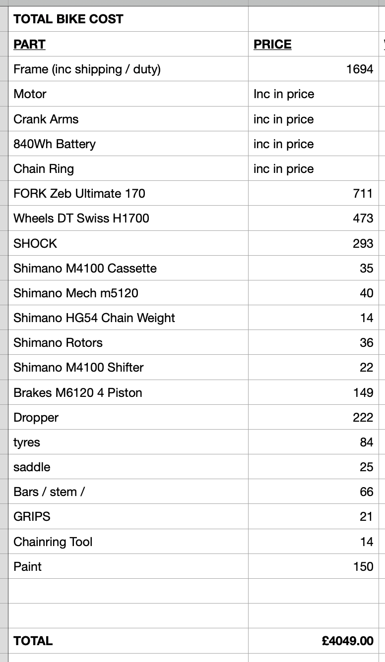

Interesting! That is actually much more then I would have thought considering I got my X1 for 4K U.S. with options and the 600 motor. Still looks like a great deal overall though.
Sure - Could have built it for a lot less. Fork / shock and wheelset cost £1500 on this bike.
Luna buy the frames and motors in bulk and will get a much better price than a single consumer purchase.Luna spec a Yari, Monarch shock and budget wheelset - big saving there too ?
You have a good point.......I did put Carbon wheels with DTSwiss 350 hubs and a Rockshox Vivid RC2 coil on mine (and an air spring upgrade on my Yari) so my total would be about 5200 US, lol;) That Monarch shock was a piece of junk, haha. The coil shock made a HUGE difference.
