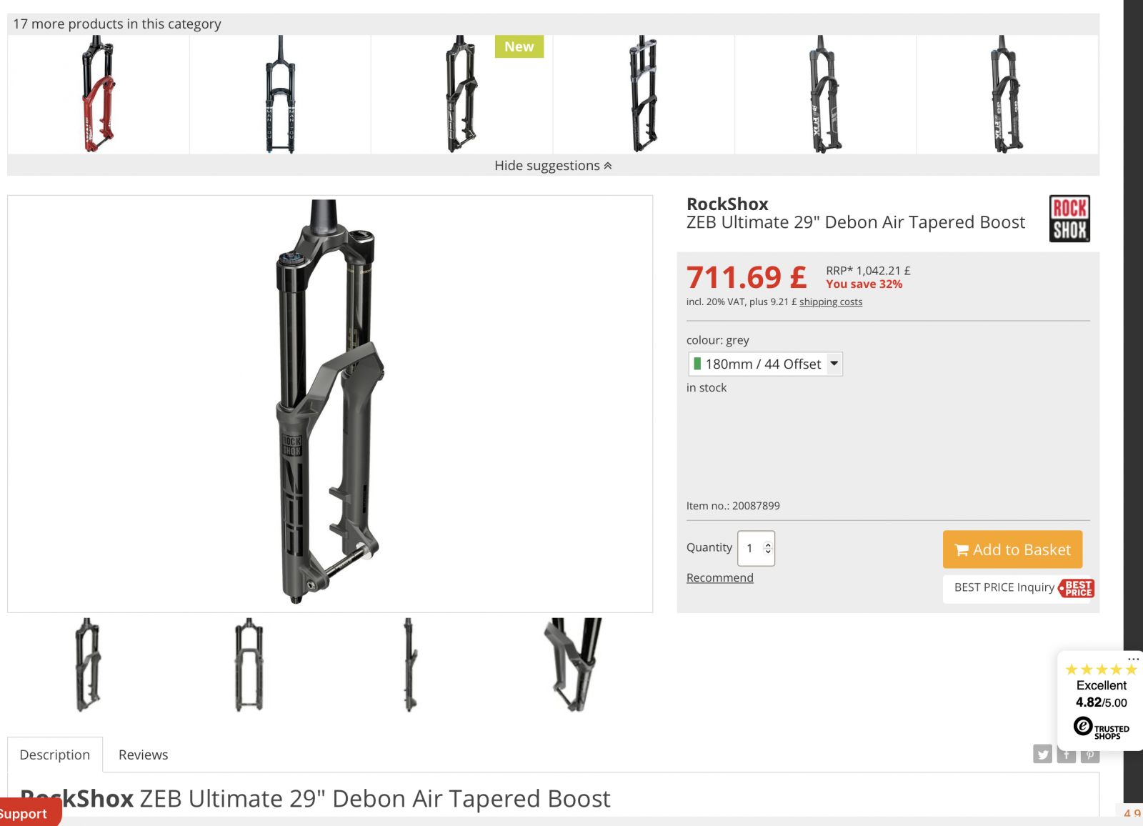

@Rob Rides EMTB really cool project dude. Where did you manage to get Zeb Ultimate's for that price?
Bike-Discount.de - I noticed the price fluctuates a lot. I had time waiting for the frame to get the best prices.

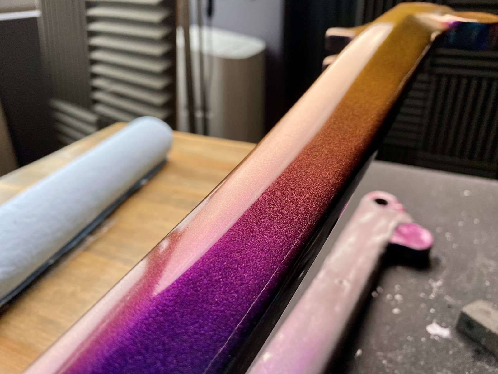

polish to finish after final coat bud. build up as much as you can, it will give you the best chance of not polishing or sanding through
3 coats of clear coat so will give gentle wet sand 1000 grit then polish. I’m not super fussed about 100% perfection as fist DIY attempt, but if I can improve it will be happy b
dobbyhasfriends
🌹Old Bloke 🎸
Sep 19, 2019
3,261
4,649
Llandovery, Wales
do you have a polishing compound ? I used to go through polishing compounds from heavy to light (all relative of course, they were not heavy at all) on a wheel, a rotary sander or by hand. if you mop it with a sander and bonnet, be careful of edges, otherwise just follow the same route around the frame as you did when you sanded. the best thing I found once it was off the polishing wheel was using 3M's 'finesse it' - however, it shows every little bit that you missed :D so may be overkill on a MTB frame but was essential for what I was doing.
I do have a DAS6 sander and polish - maybe I can use this

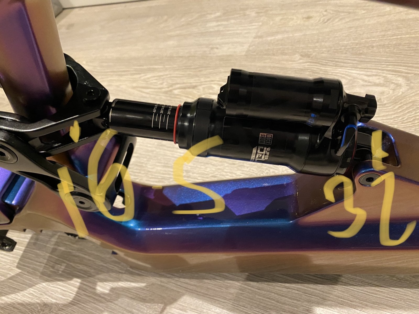

hi rob. mine is assembled, i just waiting rear brake hose to test it. I am impressed by the quality of the frame, all adjusts perfectely. however i needed to increase length of wire of remote and the power supply, too short. another recomandations, rear hydraulic hose and derailleur pass through the hole behind the lower swing arm. I will test before with 2x29" . With the 315x60 rear shock i have 163mm travel and i have mounted 160 fork, that gave 360mm of bb hight. i test 27.5 more later

what shock mounting did you use? Did you need to order custom fit?

Thanks for all the tips. I agree the frame seems very good so far.
for the moment i have mounted an RP2 air in 215x60 to try "light" (23 kg), after i will ride with the van spring shock visible in upper pics. i have reduced a few the width of yoke (i have purchased one more in prevision)
Thanks. Did you receive any mounting kits with your frame to fit the shock? I need to order some to fit.
