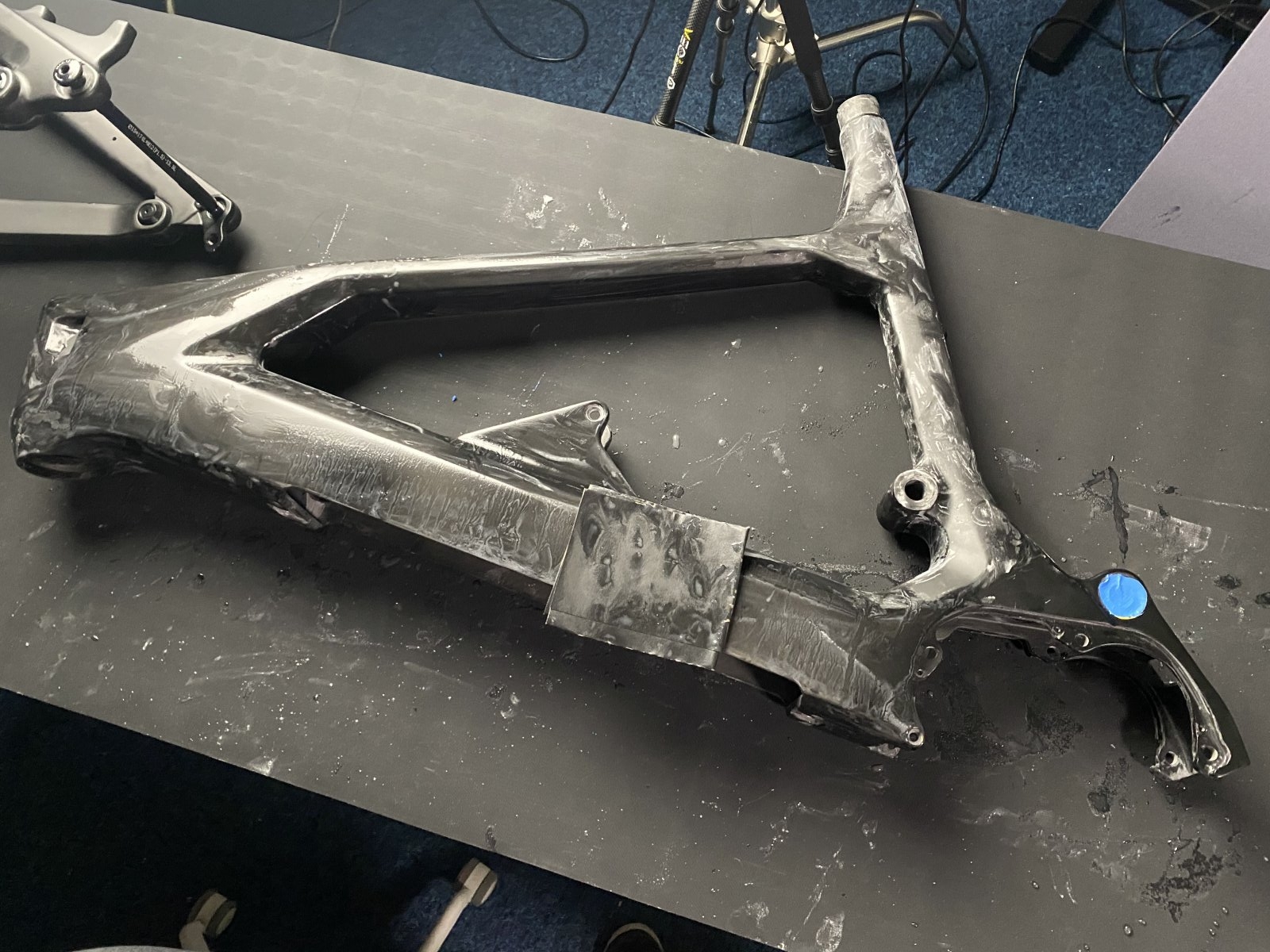

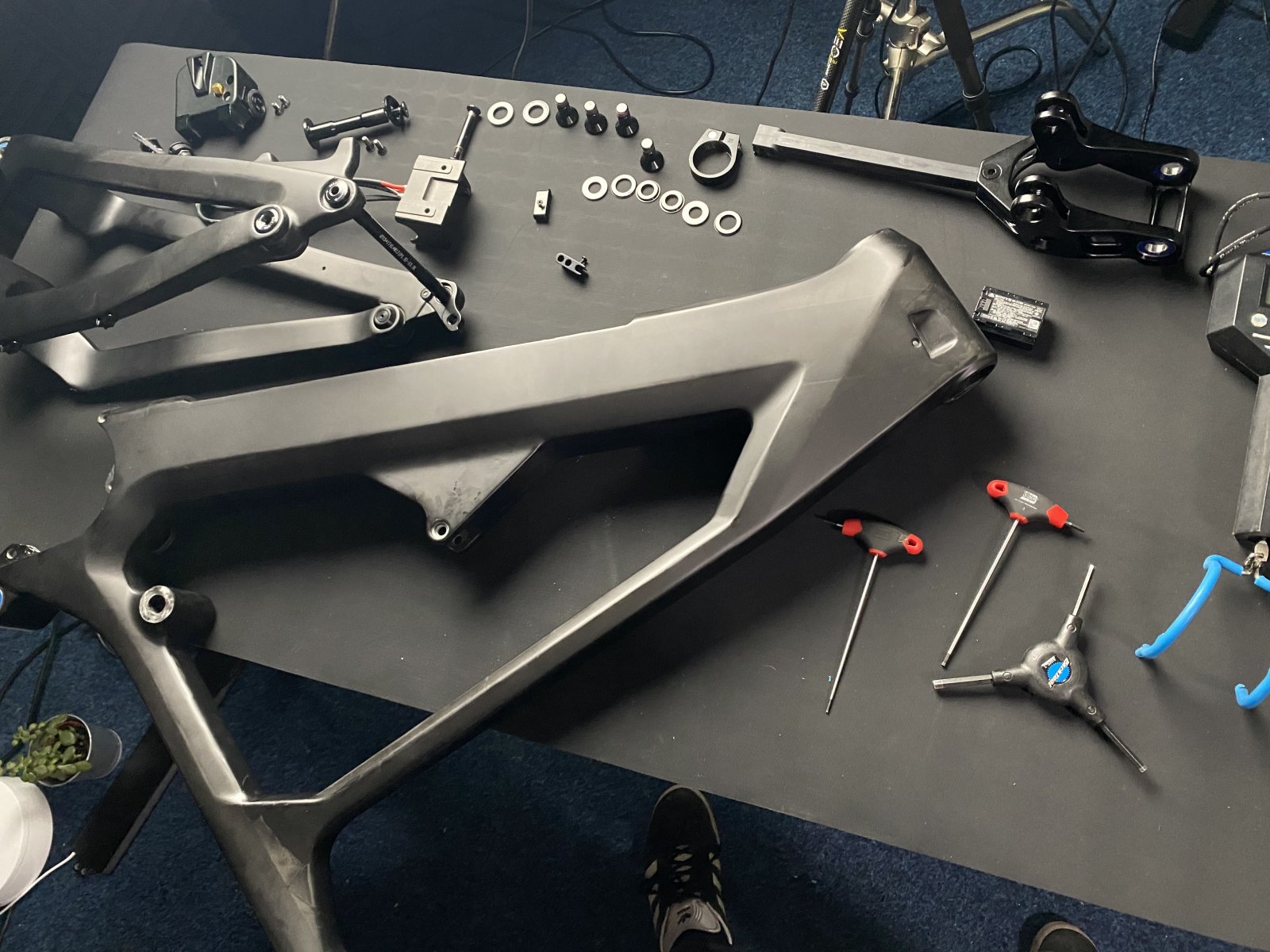

Bit of deconstruction today.

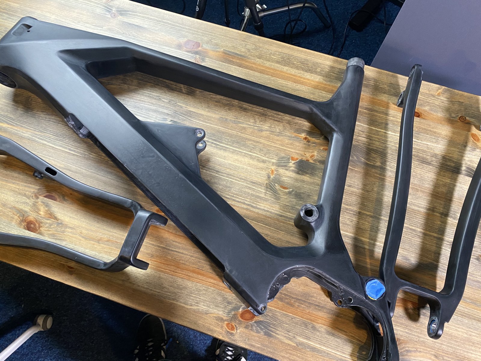

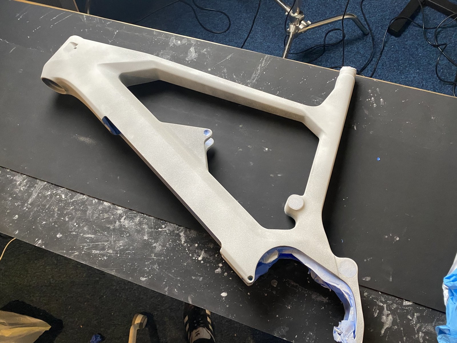

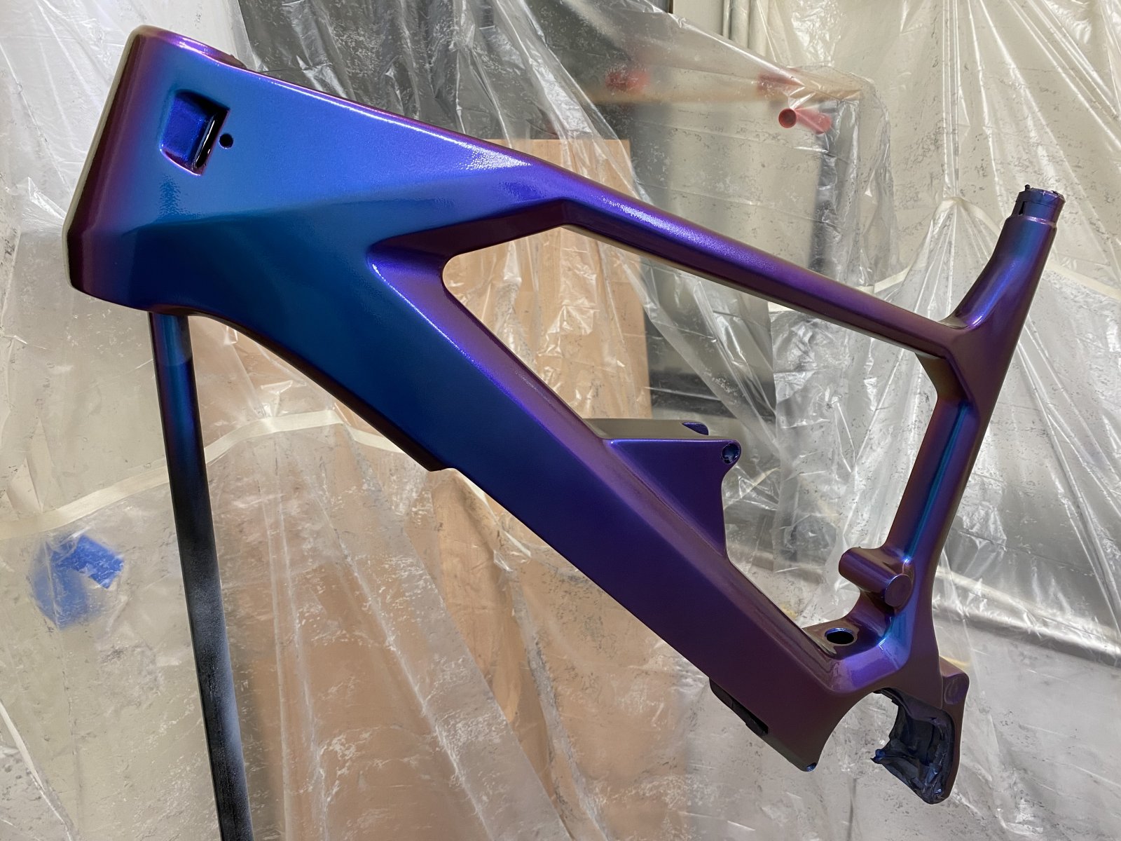

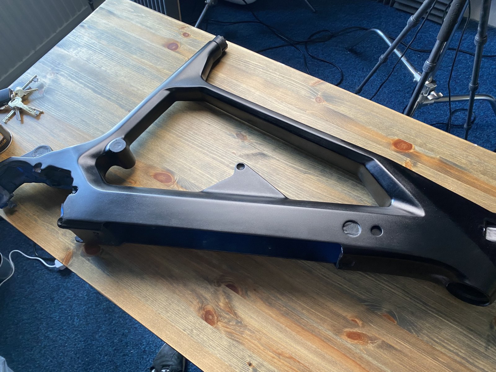

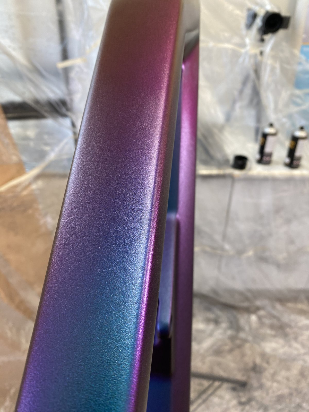

This 100%. Check your sanding job with a solvent wipe before you put any paint down. Here in the states there's a product called Bulldog that really helps with adhesion if you're not using primer. I've done a lot of these color shift paints and I think the black carbon will do a great job of popping the color shift. Bulldog, the color shift and clear are nearly completely see through, so you should see a lot of the weave underneath.
Nasty Nick
Dec 4, 2018
244
176
Ventura, CA US
Just buy the " Glossy" version from the factory, looks stunning in the flesh and shows just how good the layup of the carbon is. The Gloss also acts as a filler and protective barrier to the softer carbon and if you want to tart it up, then get it wrapped, cheaper and when you tire with the scheme, change it.
We ordered ours back in the summer and it arrived hassle free in about 5 weeks from order ( I was expecting months ). Bit scary though sending funds off to some private Paypal account. You can save considerable funds if you ask for it to be sent via train and pre tax's paid, saved nearly £ 150.00 for the loss of about 2 weeks.
That's all very cool. I've seen some amazing vinyl wraps. But I have never been able to do a satisfactory job on a bike myself. On the other hand, a cheap hvlp gun and waterborne paints are very satisfying and easy to do at home.

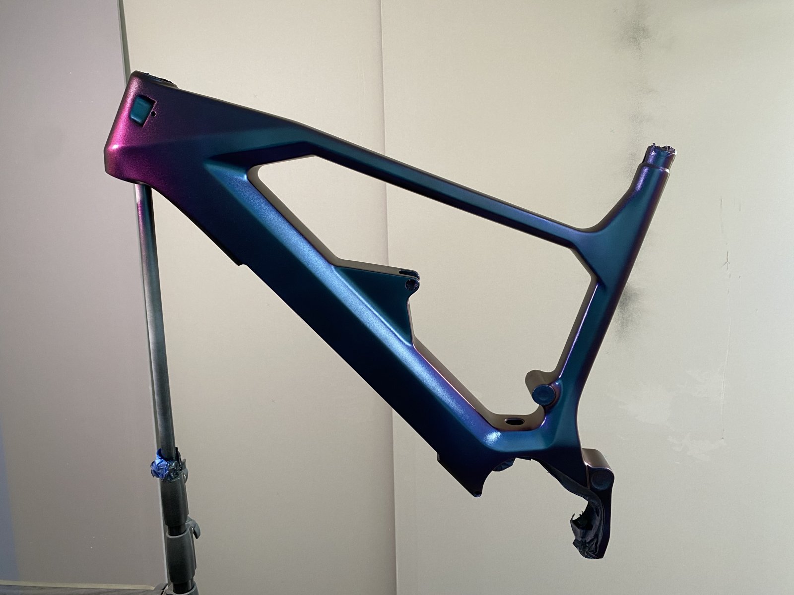

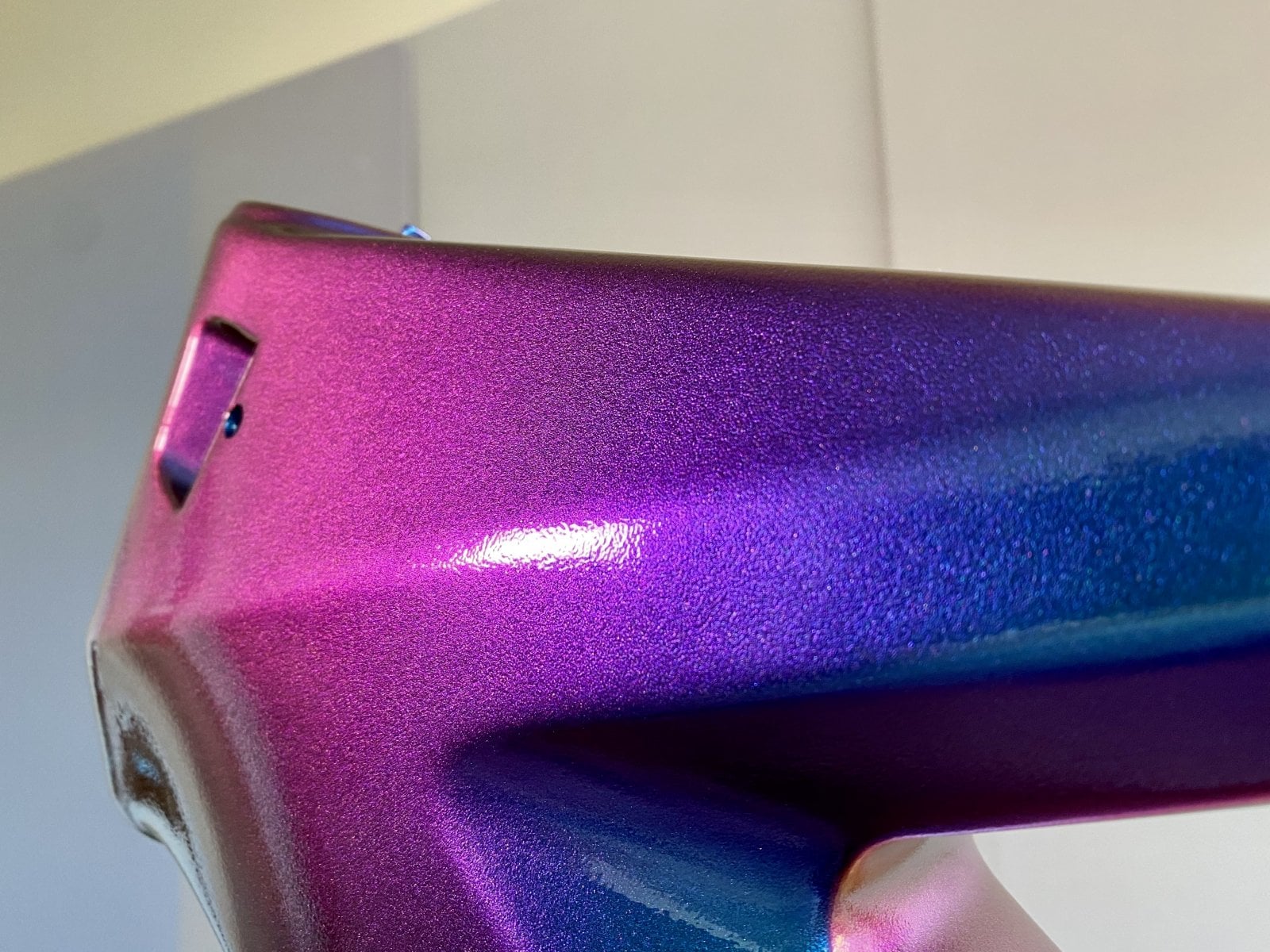

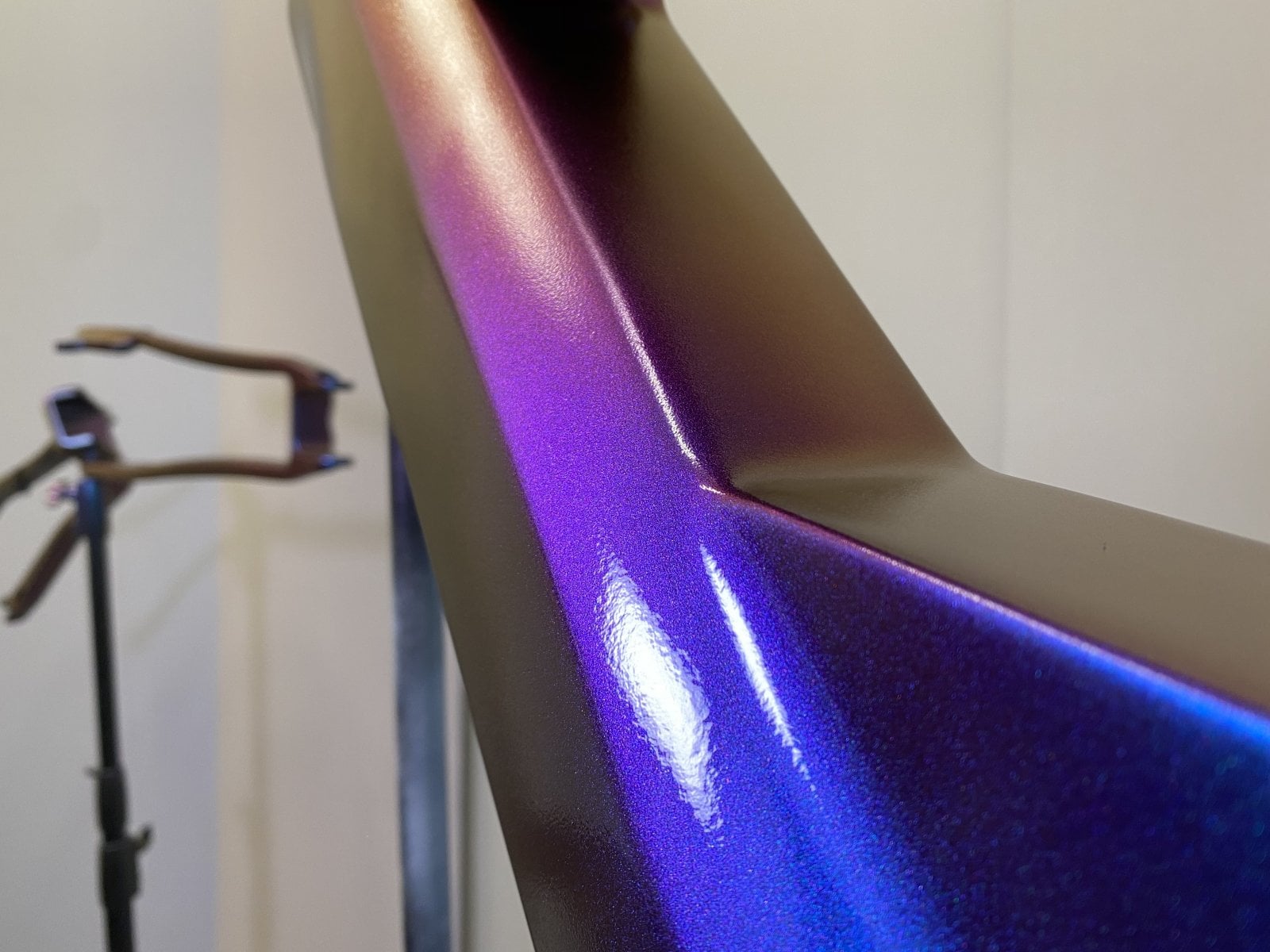

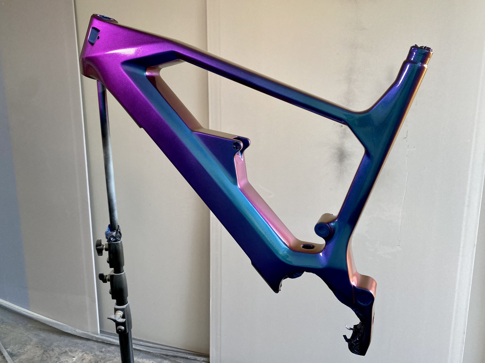

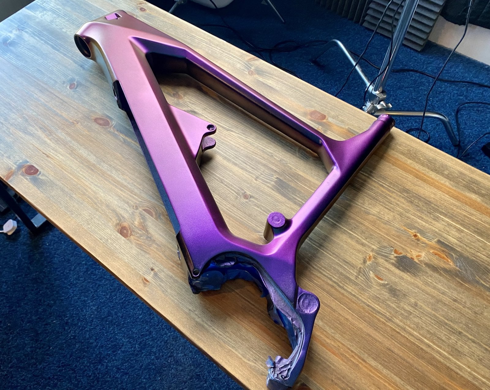

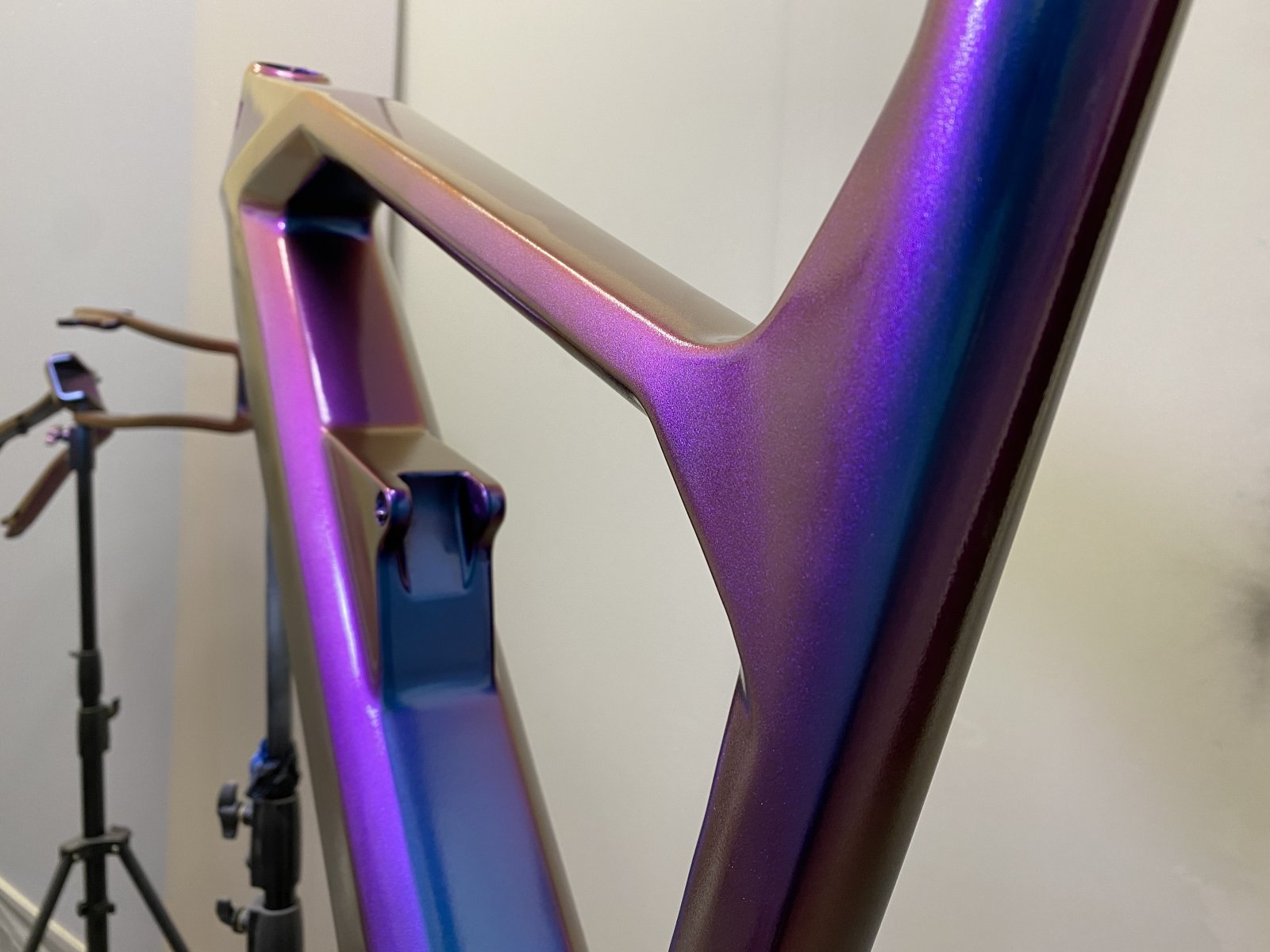

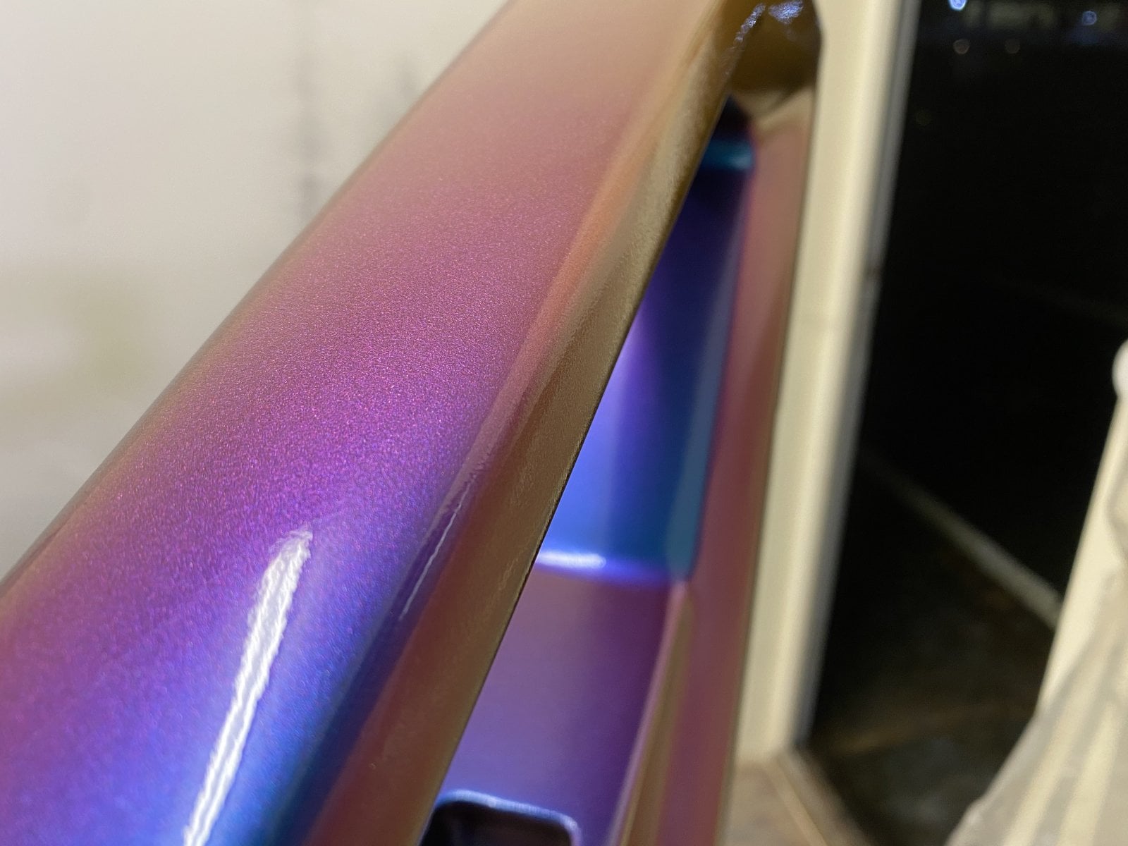

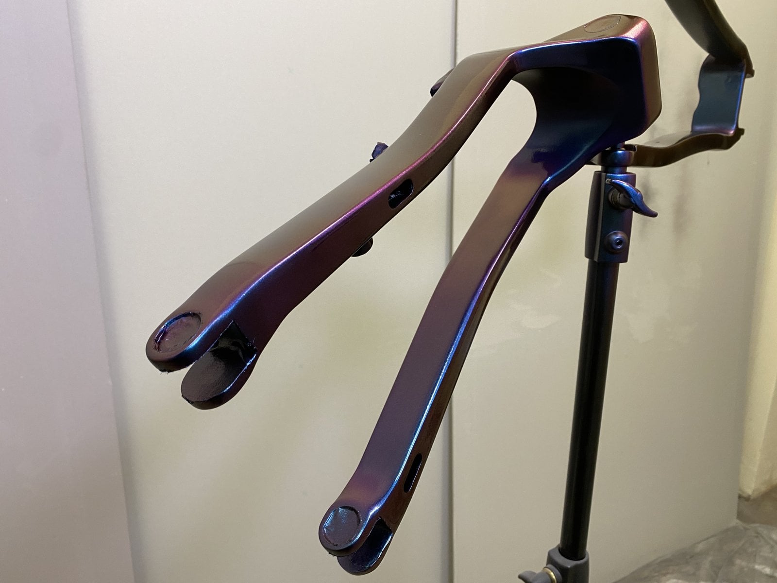

Pretty much done
might give it a final polish and clear coat will see how it dries
Cyan / Purple colour shift. AKA Chav Vauxhall Nova ?
you probably know this already but when you are doing your final wet sanding, put a little bit of fairy liquid (other detergents are available) in the water, it will make a significant difference to the feel and general slipperyness. also, when im finish sanding something like this, I have some pieces of hard neoprene style packaging that i cut into relevant sizes. try to use these as pads and then you will have a flatter finish, if you persist with wet n dry with fingers, you can easily wear grooves into the finish that will be seen in the light, the process is much easier if you have a striplight that you can use for reflection to see where you need to sand next etc.
Great tip thanks. I’ll definitely do this.
