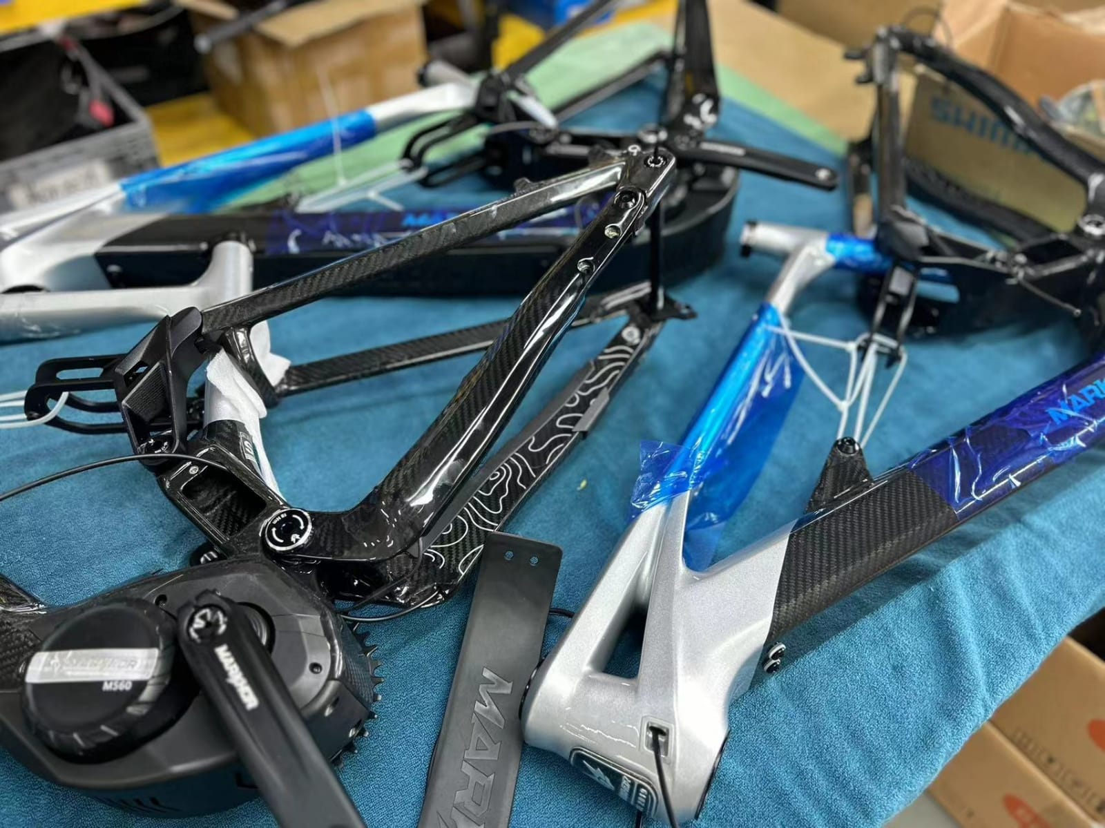

Nice I should be getting mine in the next few weeks been about two months lol some of the parts I had put on my Kunlun build had to be ordered so there was a little delay now just waiting on customs and then whatever truck company is delivering it.
same had a special paint job on the kunlun with a very high spec parts
did the same with the rocket to

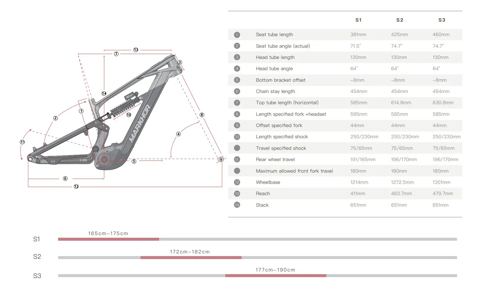

Any more info. to share about this frame? It looks very interesting, but some of the geometry confuses me. The effective seat angle shows to be a slack 71.5 degrees, but in the pictures it looks to be closer to 77 and that appears to be with a mullet setup. The reach for a Large looks very short at 460mm. Can anyone vouch for the accuracy of the numbers in the geometry chart?

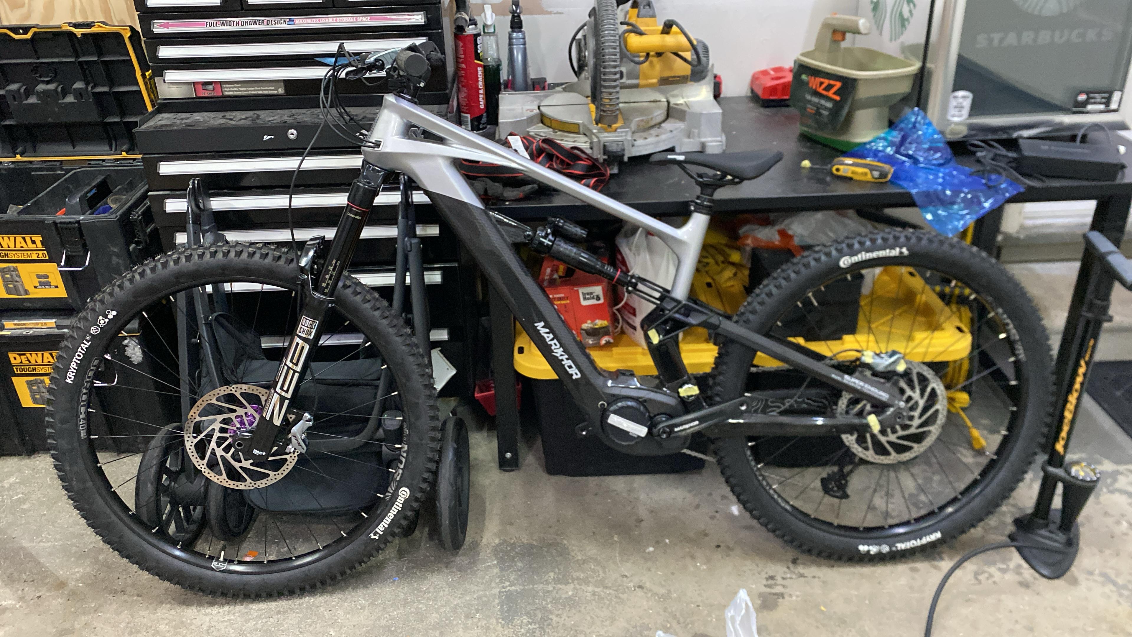

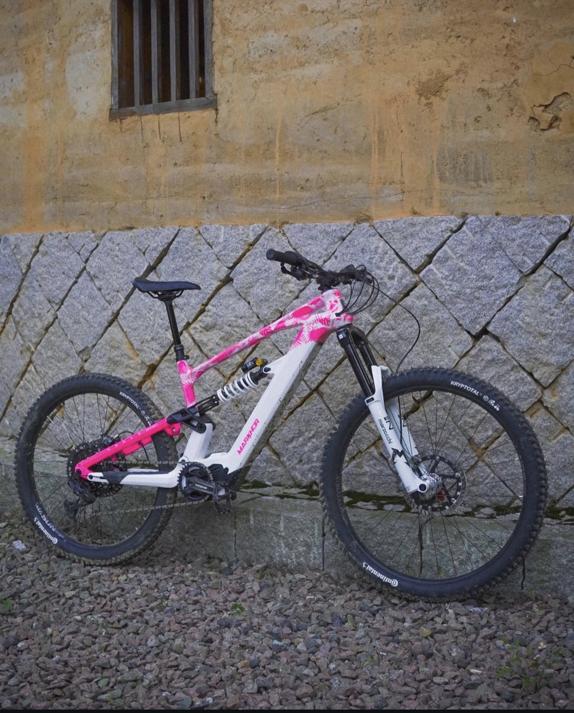

I got a complete Bike from Alibaba. I can say that yes it comes as a mullet setup. 29 in the front 27.5 in the rear. I think it’s a great EMTB I got the size medium (S2) pro spec build because I prefer Rockshox because that’s what I’m used to. If you want to see any pics of my bike let me know. I’ll attach one below. I only upgraded I’ve made is adding Deity pedals and a Deity 80mm rise handlebar. I think it’s a great lightweight EMTB I think it’s like 21KG or something like that. I had a commencal meta power SX race and that thing was heavy af.

This frames geo in pictures looked quite modern... but the geo chart looked way off the s3 was 480 reach with a top tube of 655 wtf ? so it get the better of me and i contacted them about it and sure enough they made a boo boo with there geo numbers here's the updated chart (y)

Which leads to the question how they designed the frame. Normally You design it around a given horizontal top tube length or reach value. Both values are not a straight figure, so it looks like everything just happened by chance 😂

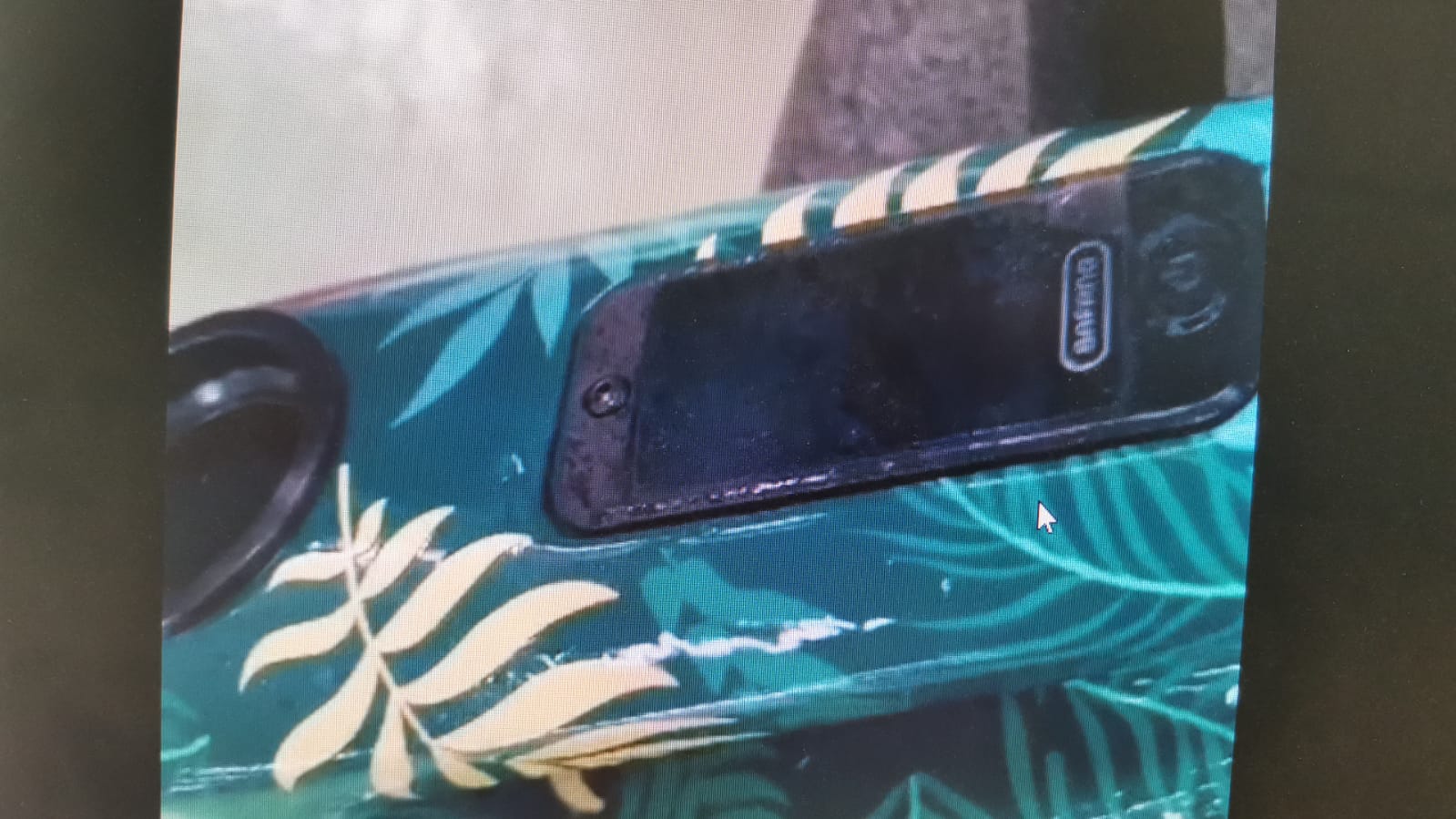

I talked to Sam from Kunlun. The frame weighs 3.1kg. The battery is not removable. The battery can be ordered 720W. They have a new screen on the frame and wireless buttons on the steering wheel. They have exclusive software for the M560. The suspension stroke can be changed to 170 or 190mm. I haven't figured out how it's changing yet. The channels for cables and hydraulic lines are very well thought out.
WhatsApp Image 2024-10-15 at 08.59.08.jpeg WhatsApp Image 2024-10-15 at 08.59.10 (1).jpeg
