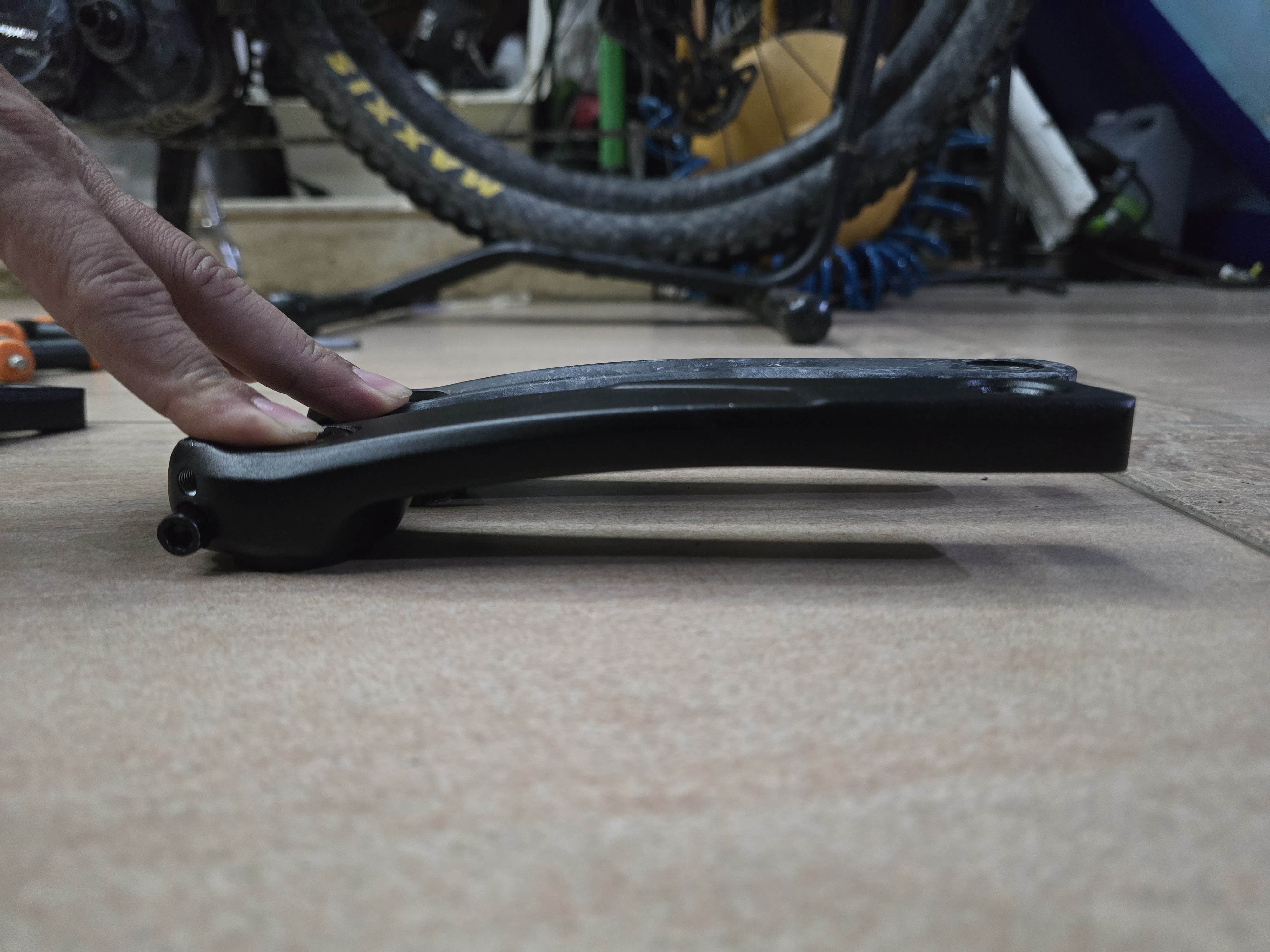

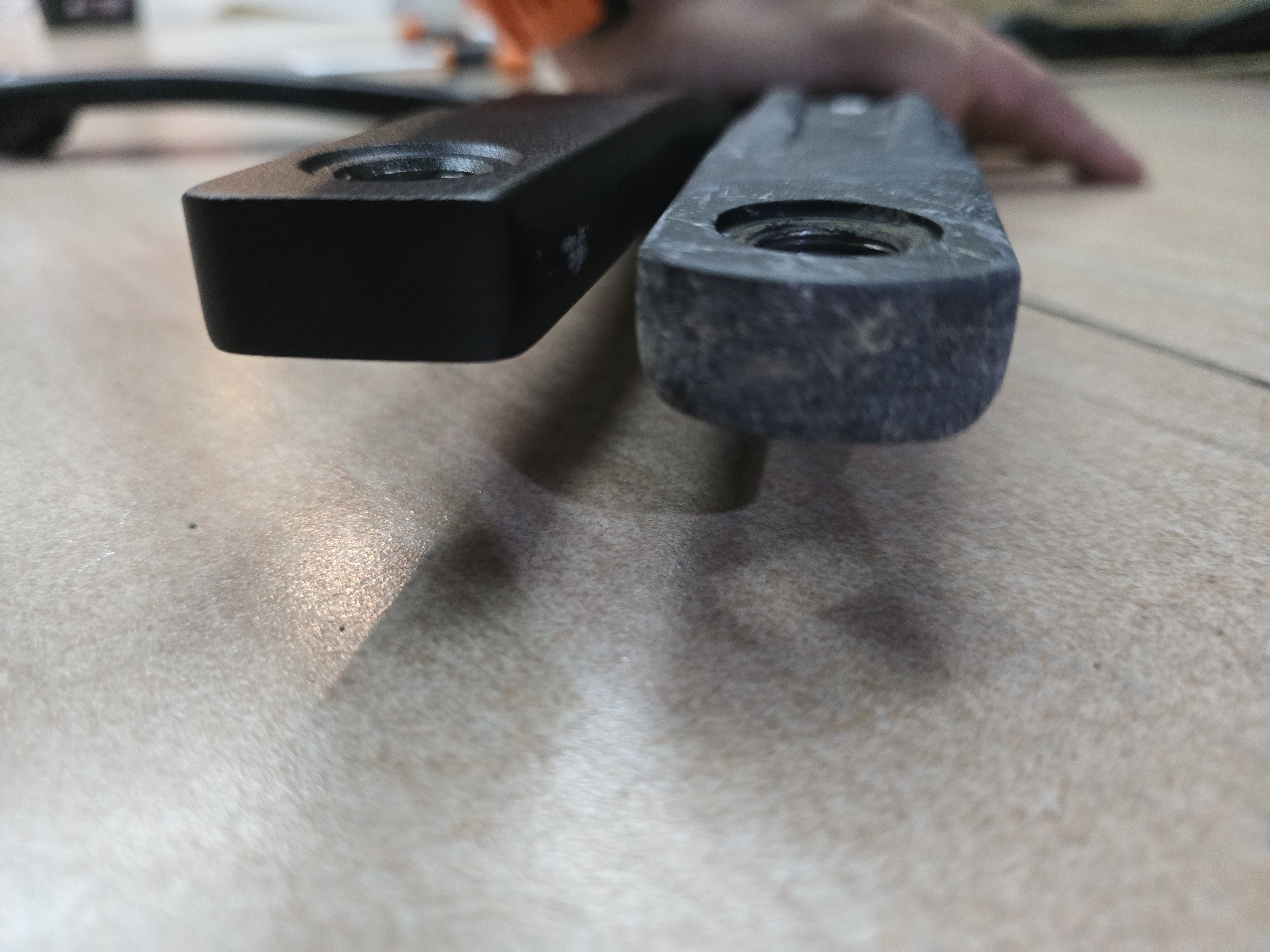

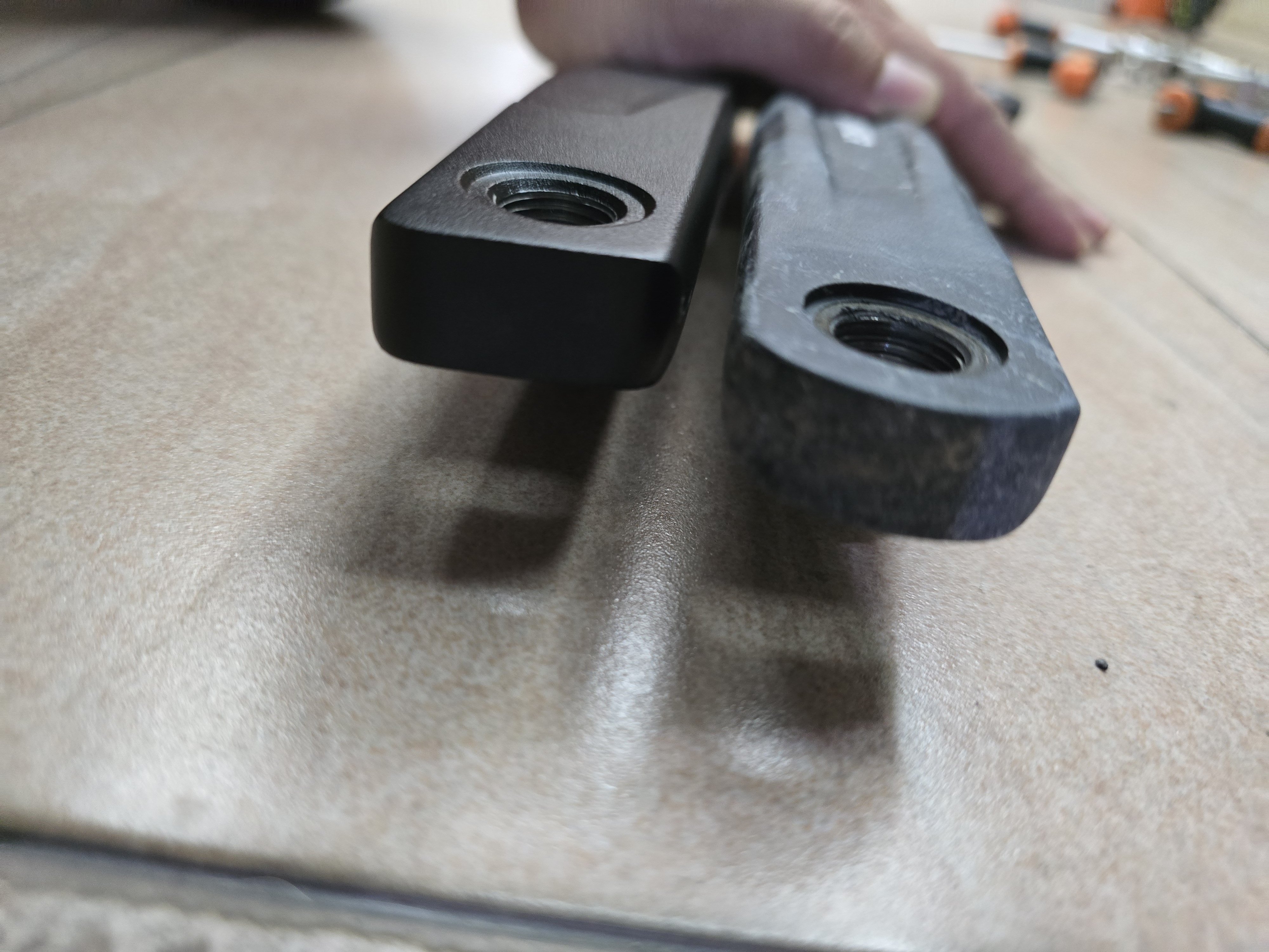

My original markhor crank Vs new aliexpress 152mm.
calvintys
Sep 12, 2023
276
272
Malaysia
Can you explain to me the reason for changing the cranks? Are the originals no good or do they have problems?
I just change for my own experiment before I buy an expensive crank arm. I actually feel lot better then original 160mm. Plus now I have less pedal strike .

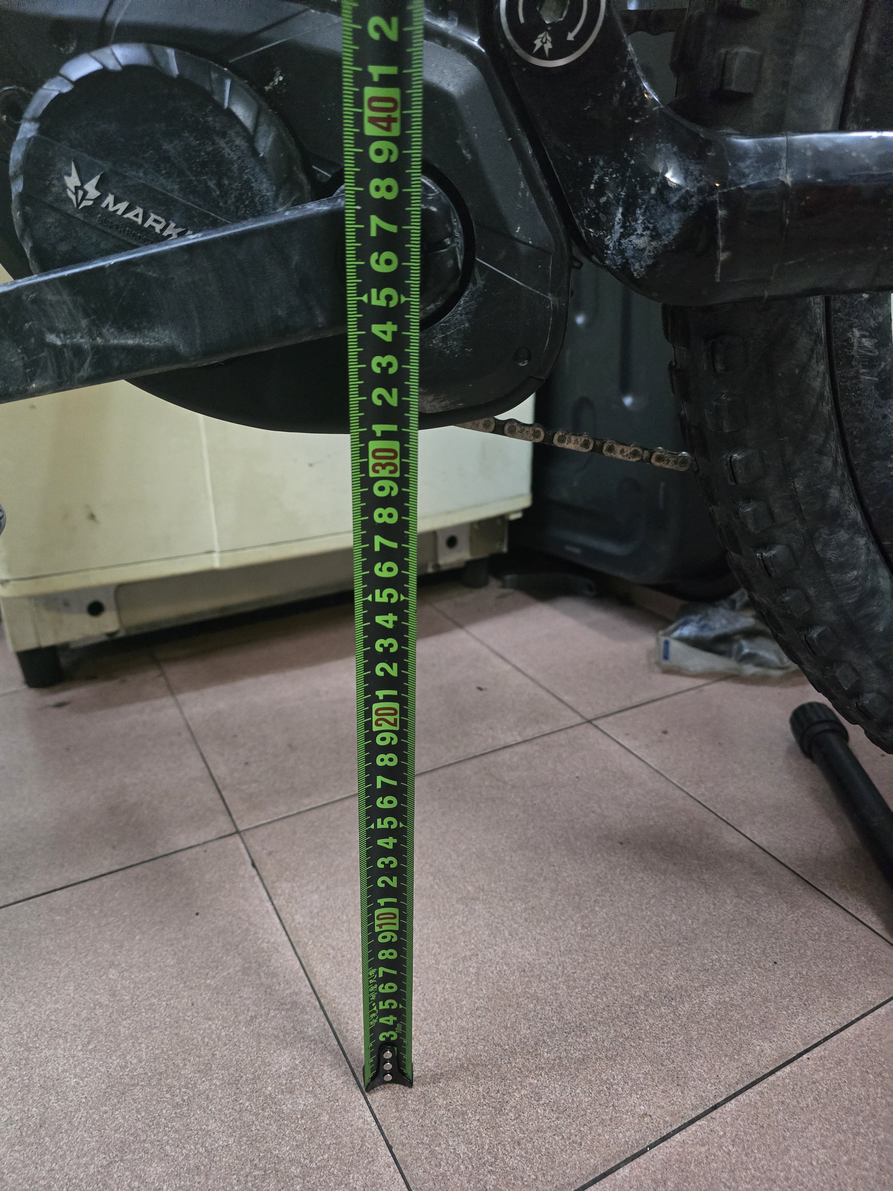

Stunning build. I'm inspired to do something similar and build a super enduro. What is the BB height?
I found it low. My weight it's 67kg , using ohlins 434 lbs with 230mm shock. Fork it's 180mm. Motor cover break easily, pls remember to buy extra cover since it dirt cheap. I am thinking of buying another 10pc.

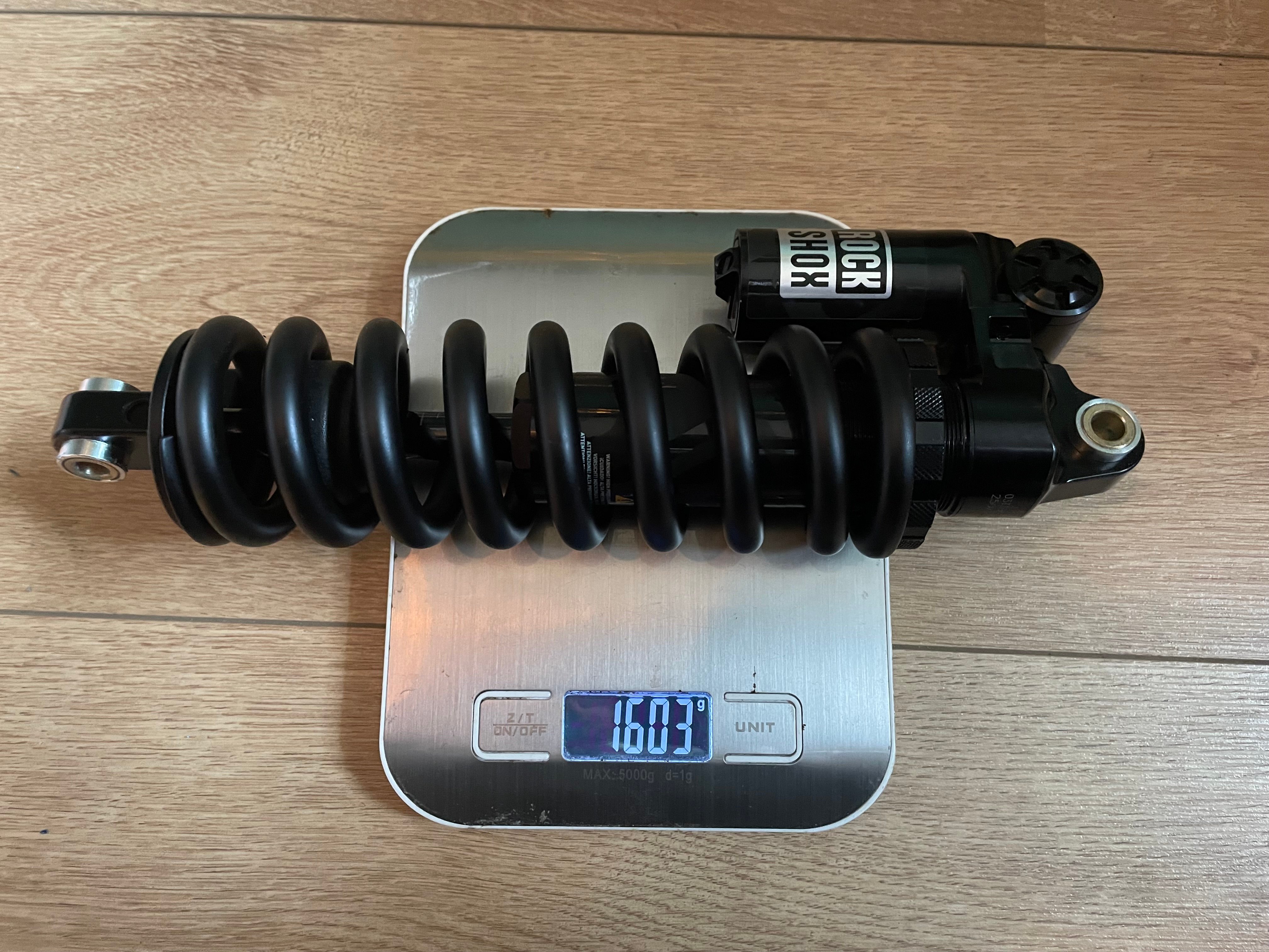

Where di you find this shock? The weight is really 700g more than a standard shaft?!
it really is. did you see the pic of the shock on the scale ? i was surprised by its weight. the heavy 500lbs coil also weighs a ton..
it is 250x75 which is also the longest rear shock i could find for ANY emtb
but i really think you should get a steel shaft model when looking at longer yoke frames..
i got the shock new but second hand from bikemarkt.de
i couldnt source a new one from shop, as the B1 model with steel shaft needs to be ordered thru a rockshox dealership as it not a shock thats sold a lot

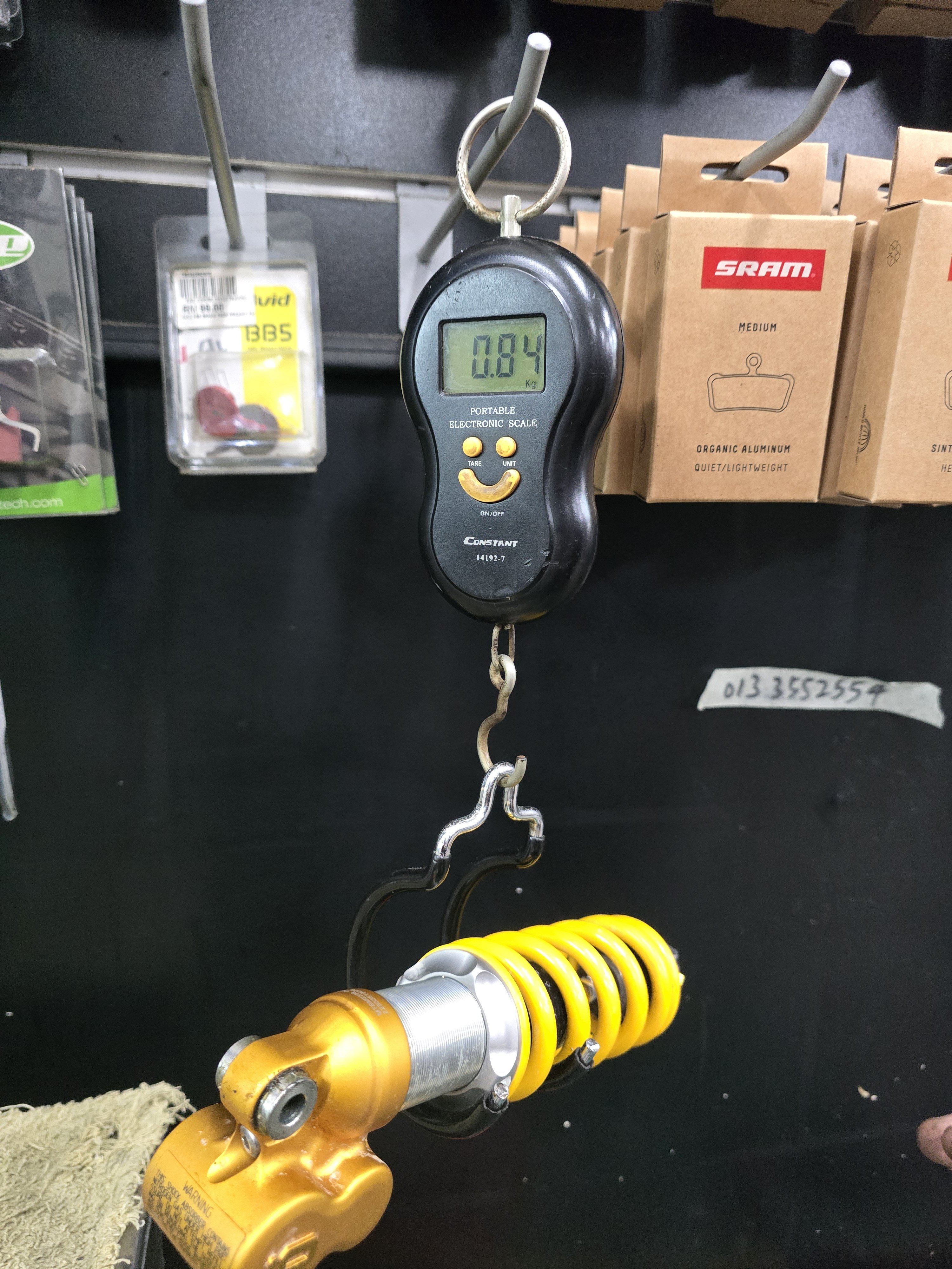

My ohlins weight 230x65 with 434 coil weight 840 gram and ohlins 210x60 weight around 720gram so therefore if 250 should be somewhere 900 gram.

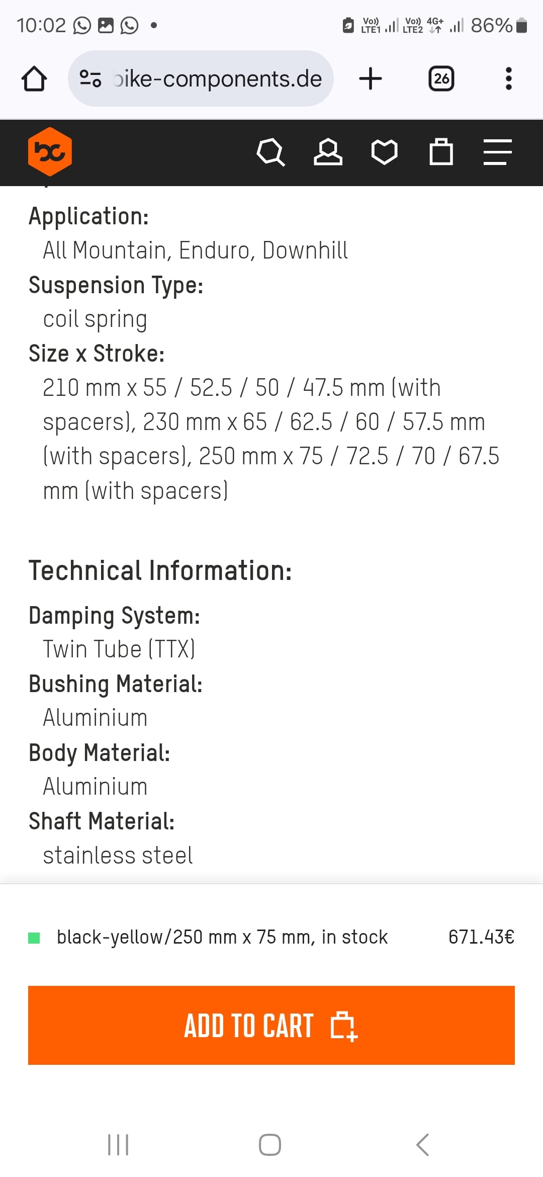

sorry but your shock does not compare
this shock has steel shaft,
HBO, rebound preload hsc lsc and a heavier spring and a different length.
your scale might also not be acurate enough to measure such a small weight ?
its s shock of a trail bike comparing to a DH specced shock

Bro it's Ohlins shock and it's has a stainless steel shaft n urs its only steel , are you sure ohlins it's a trail shock ? The scare it's just an estimate guide , i am not a weight winnie person.
