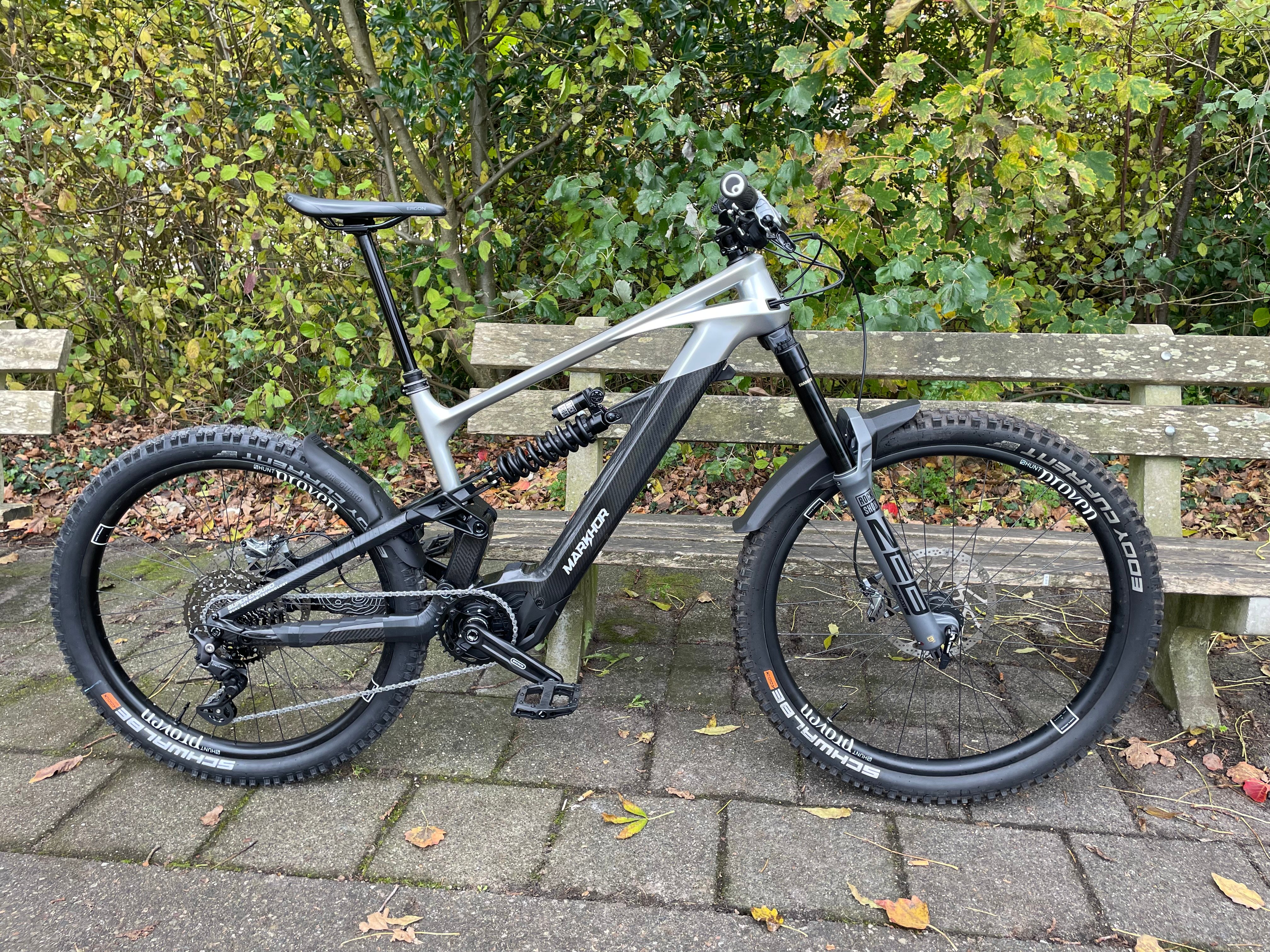

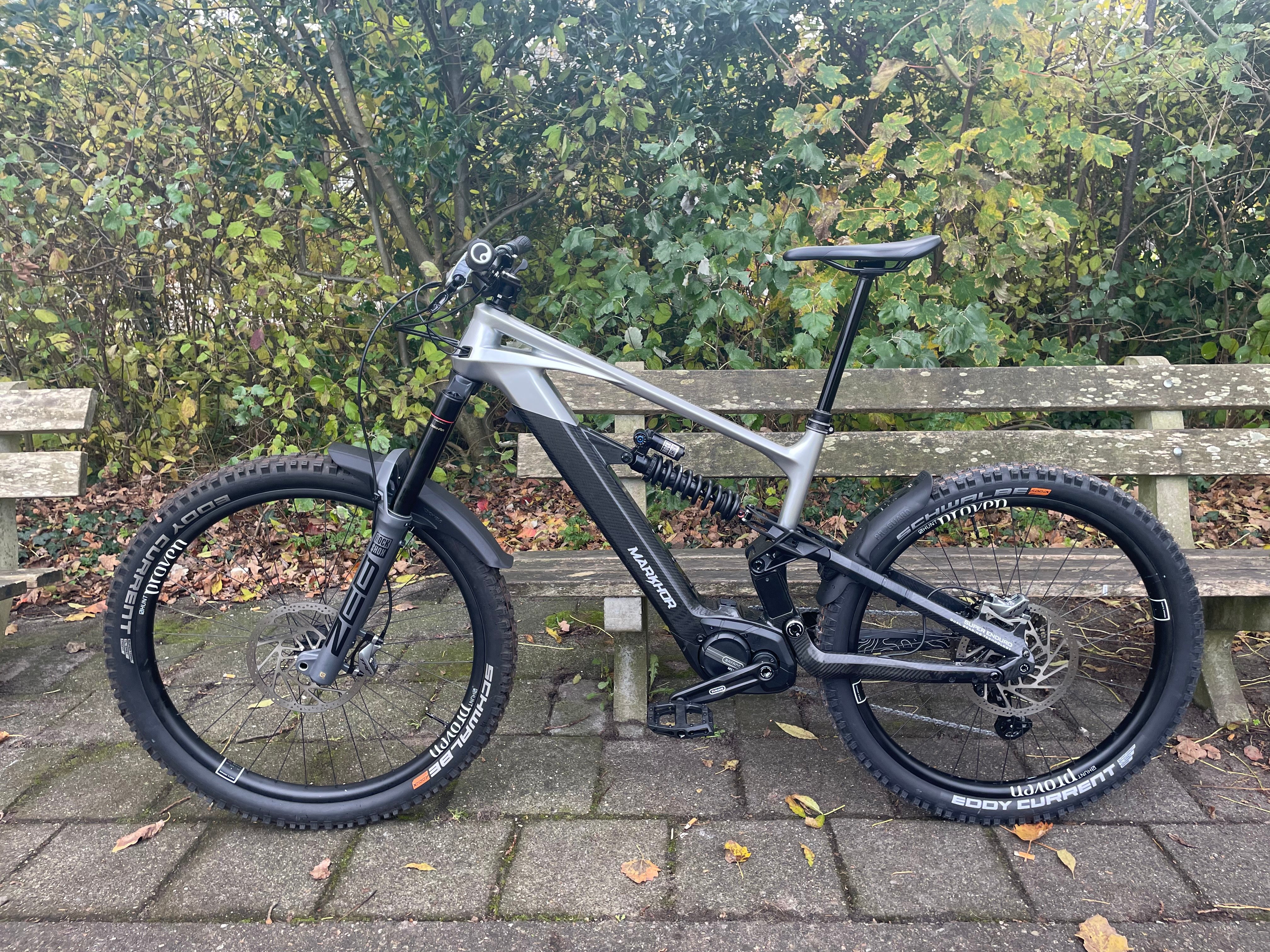

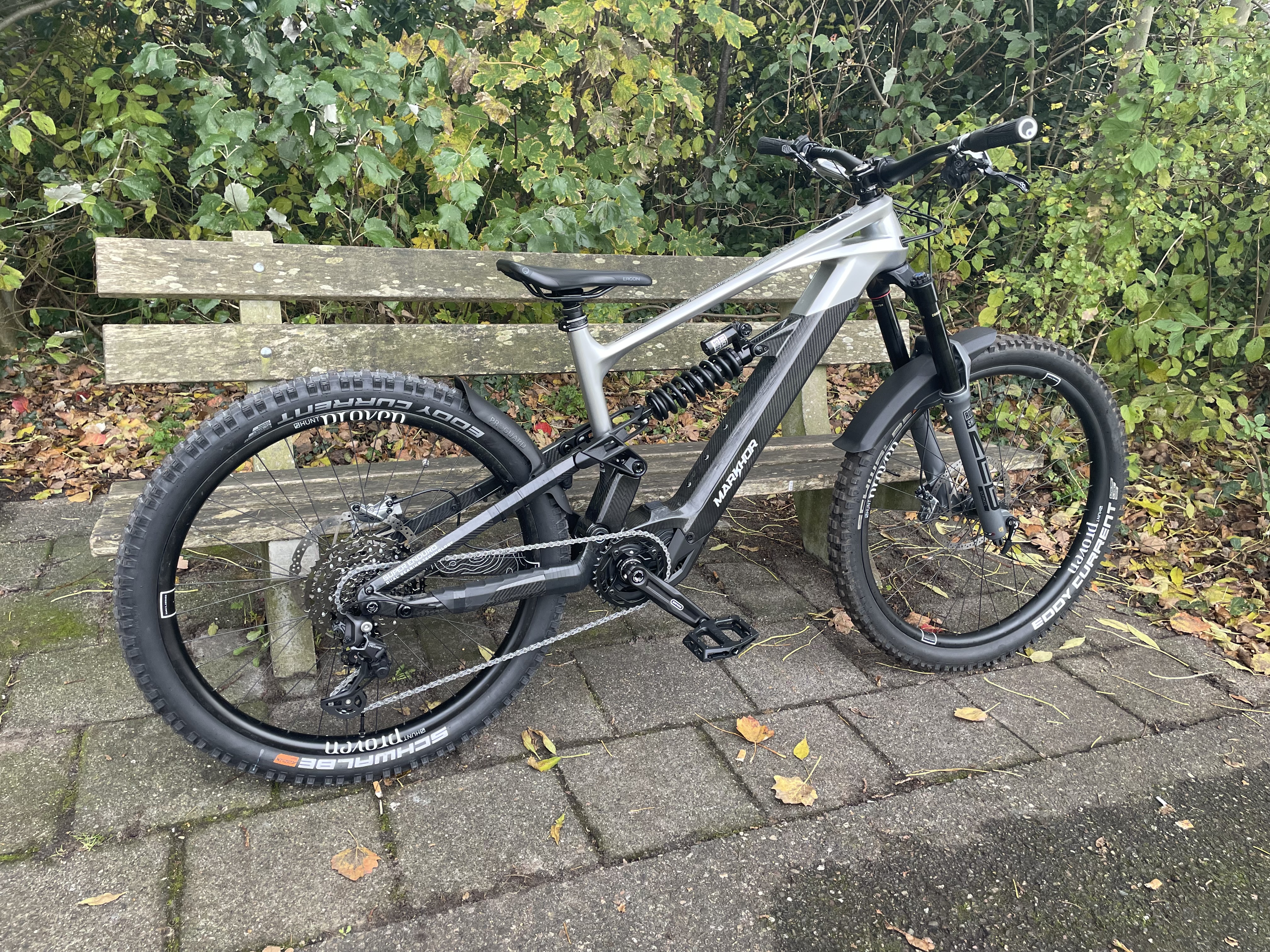

-Mullet - S3 size
-240 oneup all in
-190 front /196 rear (250x75 shock)
-25 kg with gravity tires and cushcores
-headangle is now 63*
-seattube 74* measured
720wh bafang made battery

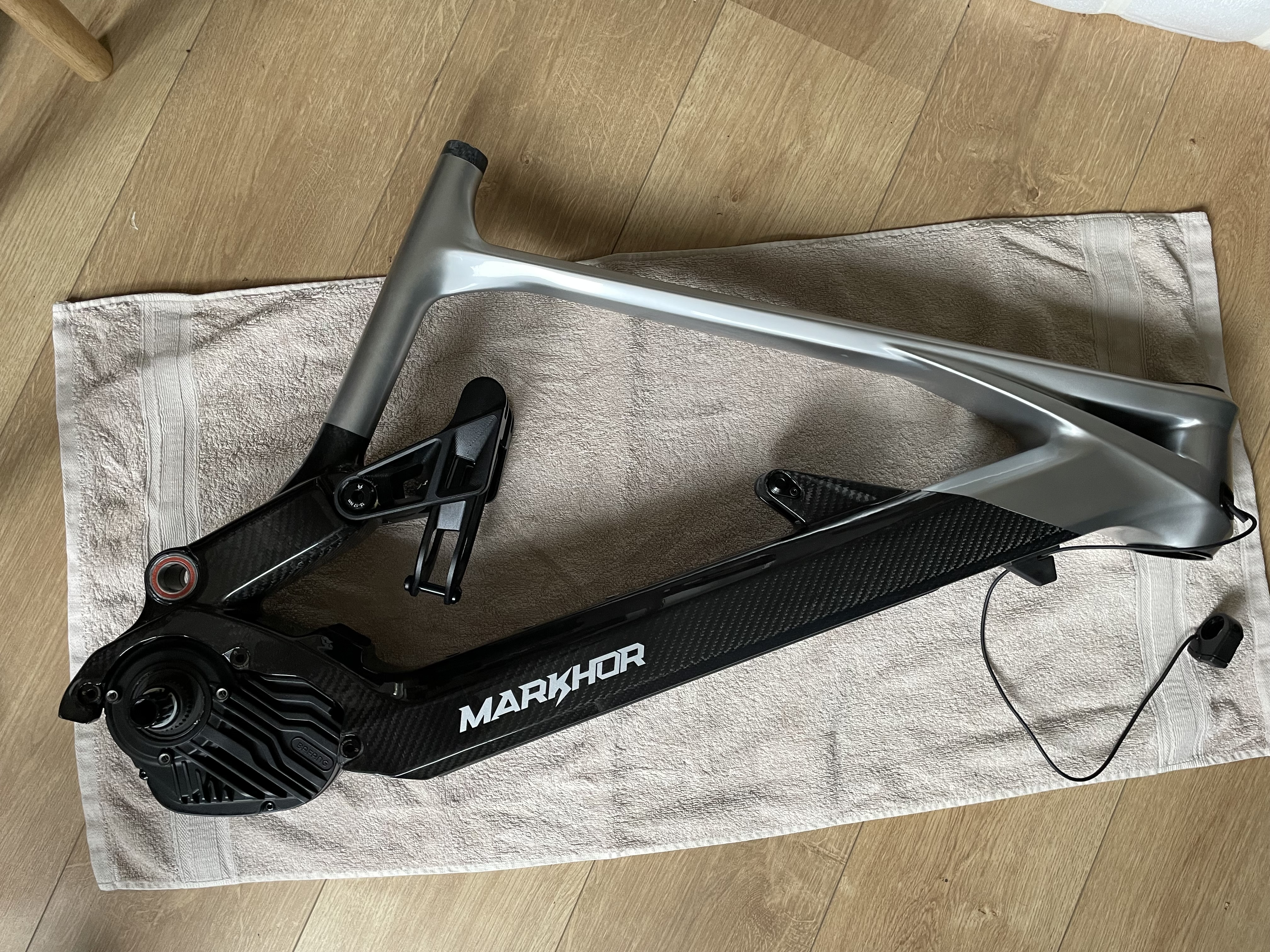

I talked to Sam from Kunlun. The frame weighs 3.1kg. The battery is not removable. The battery can be ordered 720W. They have a new screen on the frame and wireless buttons on the steering wheel.

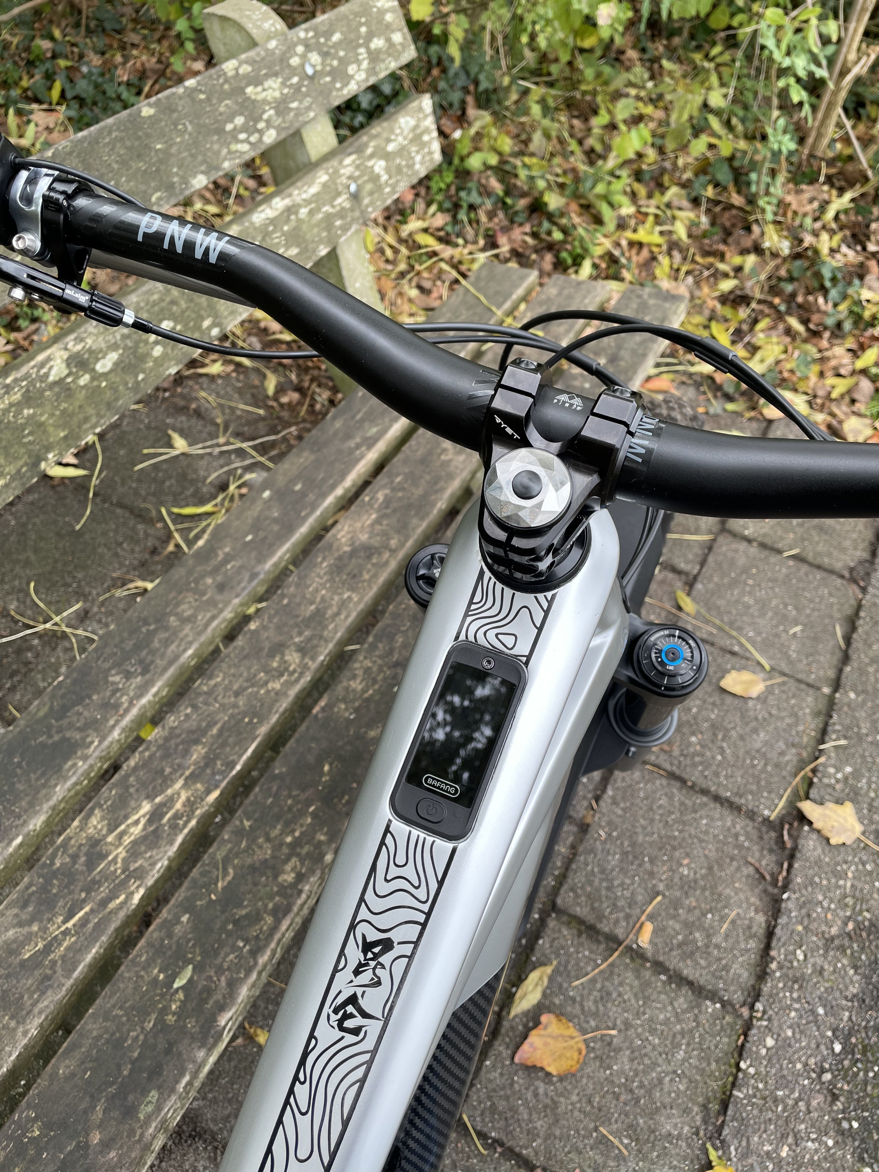

why a cable for the controller? isn't this wireless?
is this the controller?
Can I increase or decrease the power of the available levels?

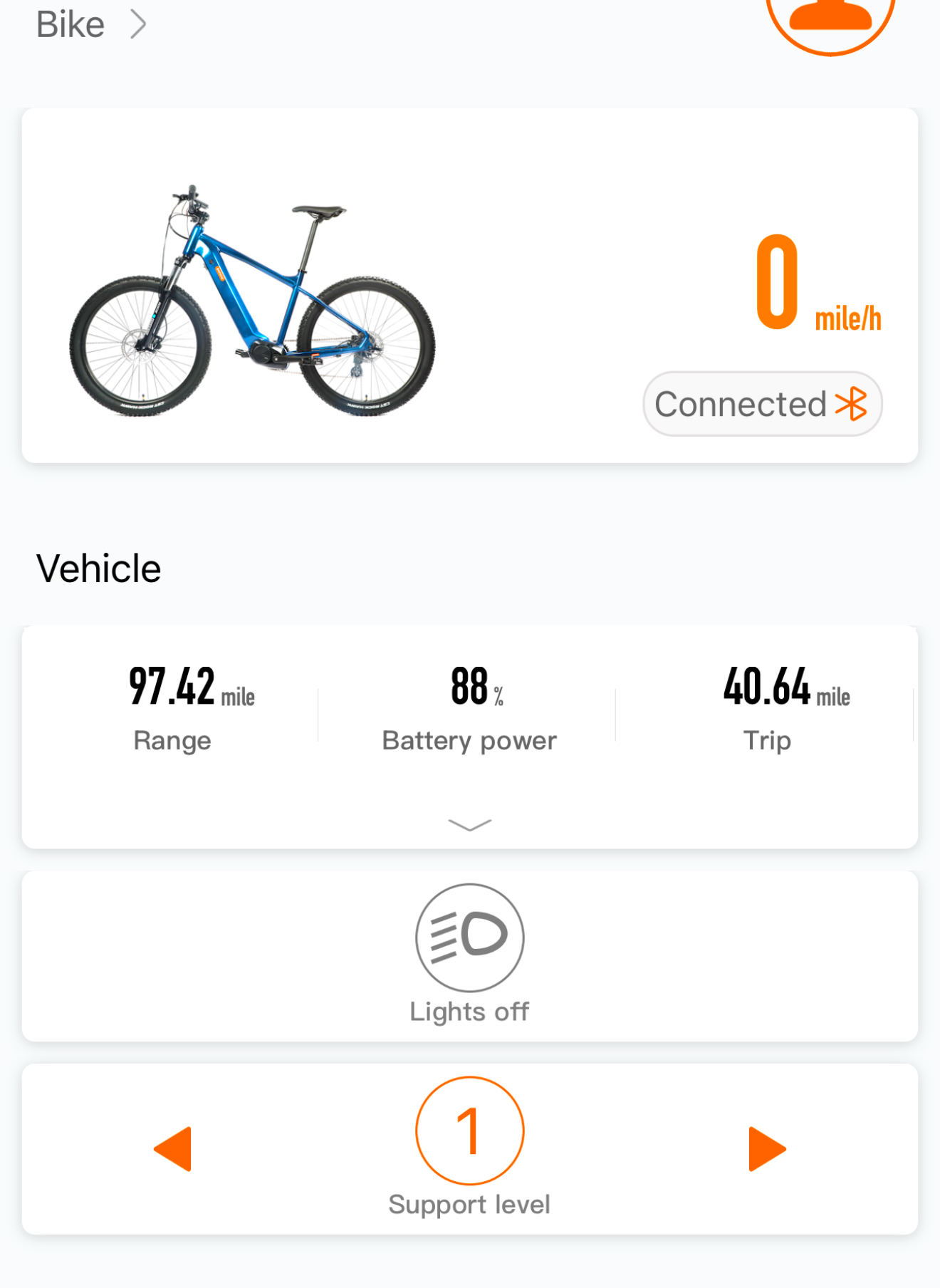

No, that is not wireless as far as I’ve seen, that has a cable that just goes to the display, not all the way back to the motor.
The wireless part is from the display to your phone for the Bafang Go+ app connectivity.

The button controller on the handle bars had a wire the controller on the frame with the display and button is Bluetooth and can connect to the bafang go+ app and you can turn the bike on with that button too (y) haven't tried to switch modes with that controller but you maybe able to ill check next time I'm riding it...

as you can see no throttle on my bike because of local laws. i disconnected it and taped the plug to waterproof it
display controller and throtle
both plug into display. - no wireless ness. unfortunately
Didn’t realize the little screen in the frame has a power button too. Maybe it would be possible to go without it then, not sure.
xtraman122
Mar 2, 2024
277
220
this makes the controller button useless, only need phone or toptube display to switch modes
not sure yet if this display connects to go tho
Yeah, it definitely should, I believe the document someone sent showed it. Assuming you're referring to the C030 display anyway.

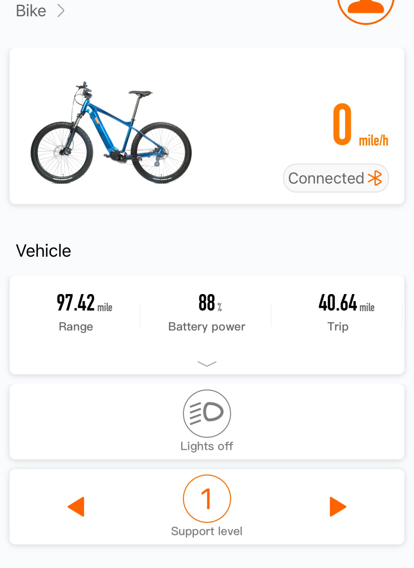

Yes, I can change the support levels, but can I customize them in any way? If Eco is too strong for me, can I turn it down? If trail is too weak can I increase it?
xtraman122
Mar 2, 2024
277
220
Yes, you can change a few parameters for each of the 5 support levels in the app. It's not as fine-tuned as what is in BESST, but you can set percentage of max assist (Max current essentially) and acceleration.

the important setting for torque sensor sensitivity is not there tho, so you still need besst for any decent tune
I have a BESST but haven’t even tried messing with anything other than the speed limiter and setting the tire diameter (It’s ridiculous you need the tool to set the diameter). Are there any must-do settings in BESST Pro that make it feel much better?

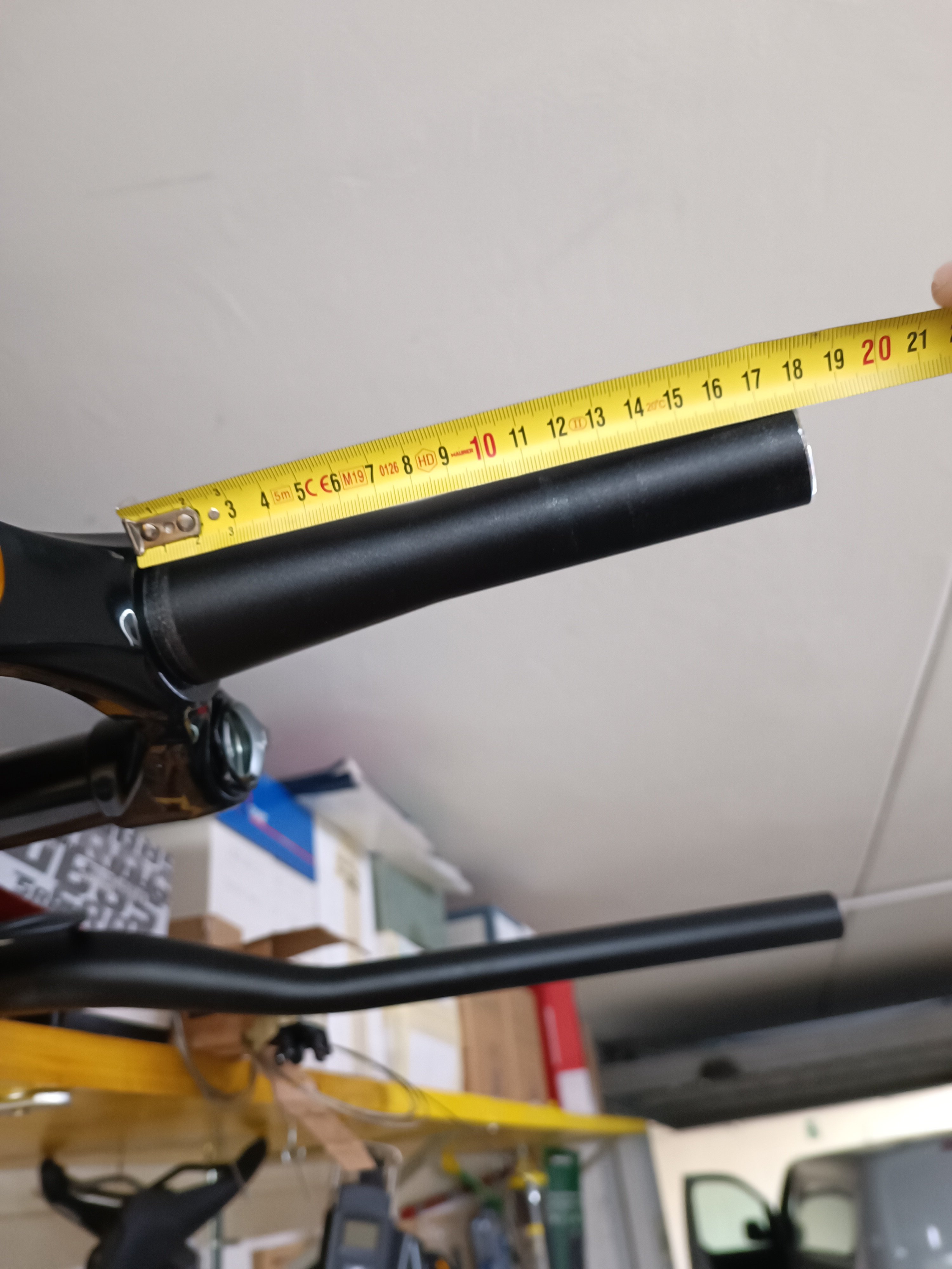

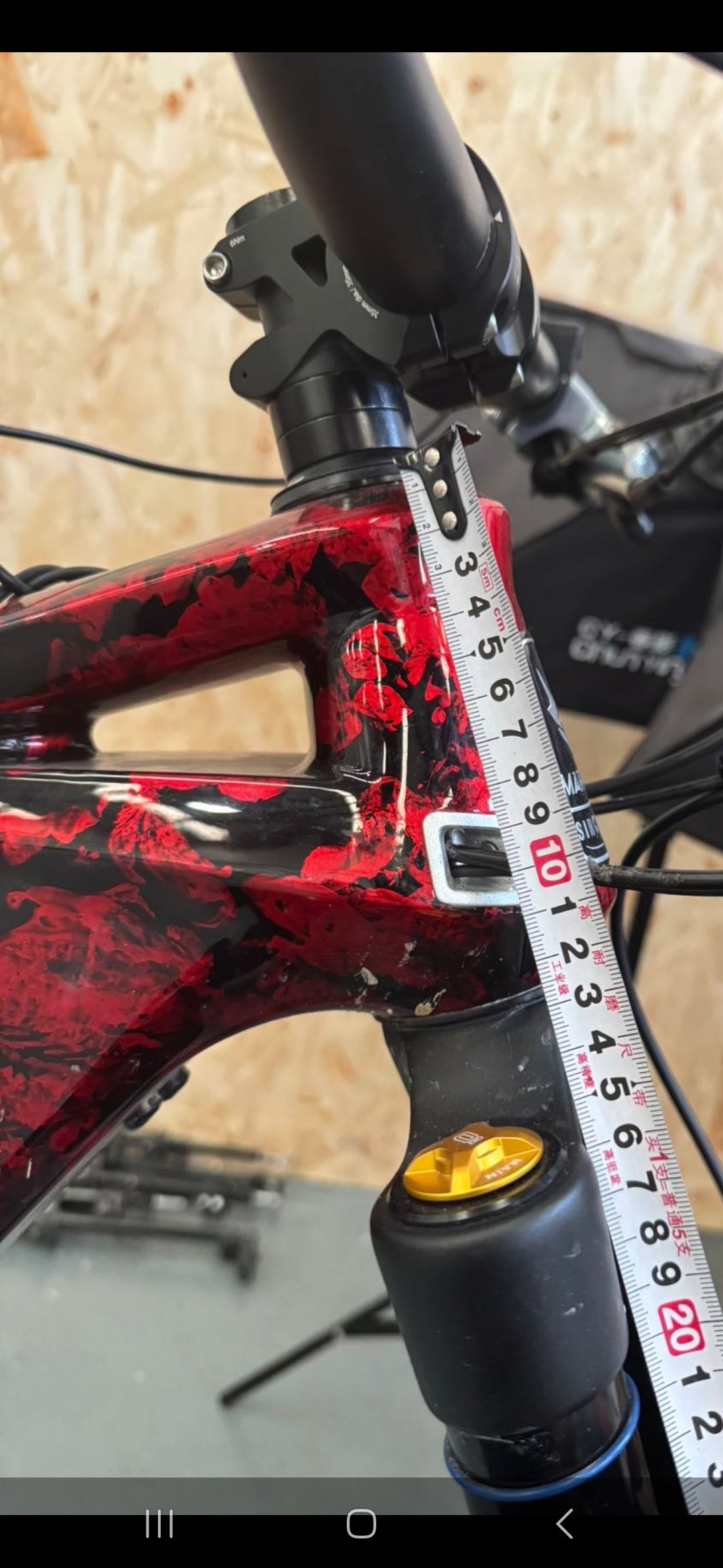

Head tube lenght 130mm + 40mm stem :rolleyes:
Is It your bike? I likes that Red very much but 700€ is too much
