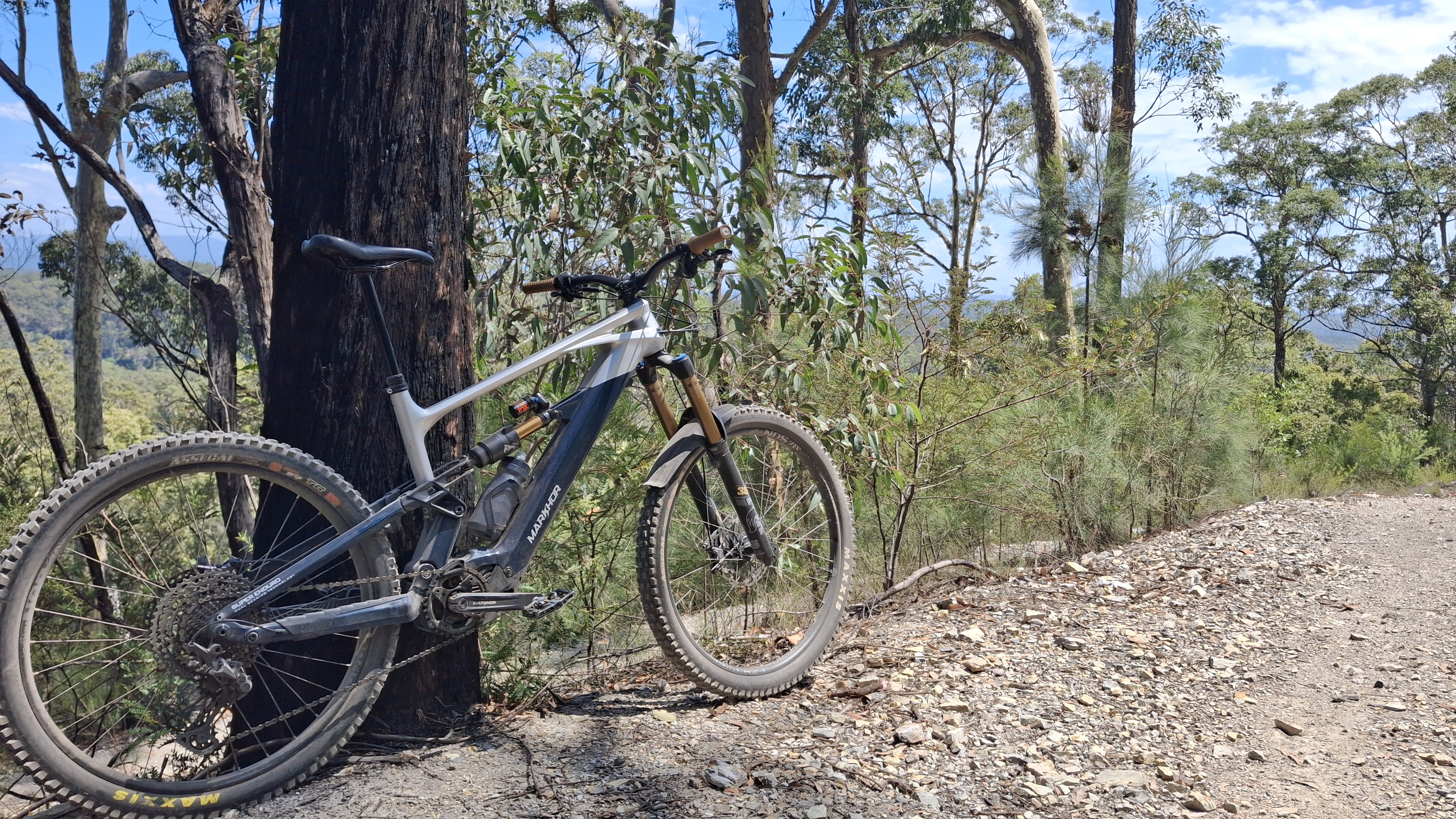

I just got back from a 4 day mounting biking holiday at Narooma and Eden trails in Australia, putting the Kunlun though some punishment... from fast flow trails to double black janky lines to big jumps lines I've put the bike it though it all and it hasn't missed a beat. My bike is set up with an 180mm fox 38 and a fox x2 at 175mm rear which is perfect for my riding, I'm 5 11" tall on an S3 frame size and can fit a oneup 210mm dropper, the suspension has an sensitive bottomless feel about it no harsh bottom outs good support in berms, I find you need to weight the front wheel in switch backs when climbing but other than that its a pretty competent climber . bike weights 24kg but rides a lot lighter and is quite nimble at speed easy to change direction, it's a long beast at 1300mm and very stable at speed but the trade off with the longish chain stays is a little more effort to manual the front up, bafang m510 motor has been good, I've only ridden the shimano ep8 to compare it to. but the bafang is a lot more powerful at 95nm and feels smooth, has a lot of adjustment in the app with 4 parameters adjustable, but lacks the adjustment of the torque sensor sensitively in lower power modes, I have ordered a k1 programing tool to fix this issue ? it comes with a 48v 720wh battery which when ran in s+ mode lasts 35 to 45km 1000+ elevation on most of my rides away, you could get a lot more km in lower power modes... haven't in counted any issues with the bike as yet ? broke the plastic motor cover on a rock so order a few spare's when ordering your frame and Loctite the suspension pivot bolts as had one come loose and unscrewed, hope this helps...
I'm pretty happy with my purchase get ordering 👍

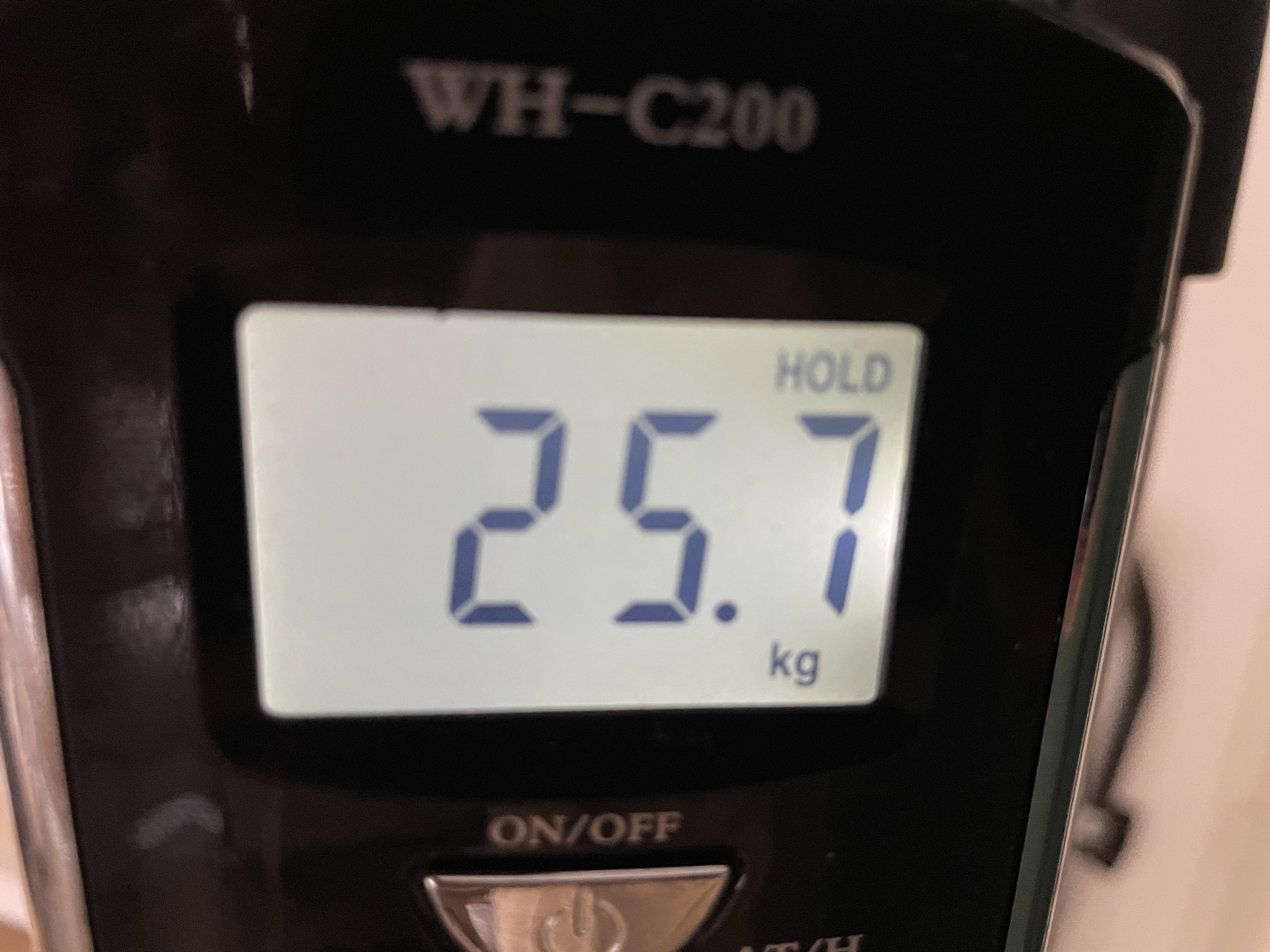

bleeding of the brakes was the easiest i ever did! well done TRP! took me 3 min each
also adjusted the shifter and installed the dropper
i threw all the parts on the bike quickly and weigh it. this i was the most curious at.
because of bad weather i didnt testride it yet or took any pics...
still acceptable weight i think, mind it is basicly a DH bike at this point
my E10 with smashpot and same rims was heavier in the end at 26.9kg
what do you guys think?
Identical weight to my Markhor Rocket bike, where I didn't take care about kg's...

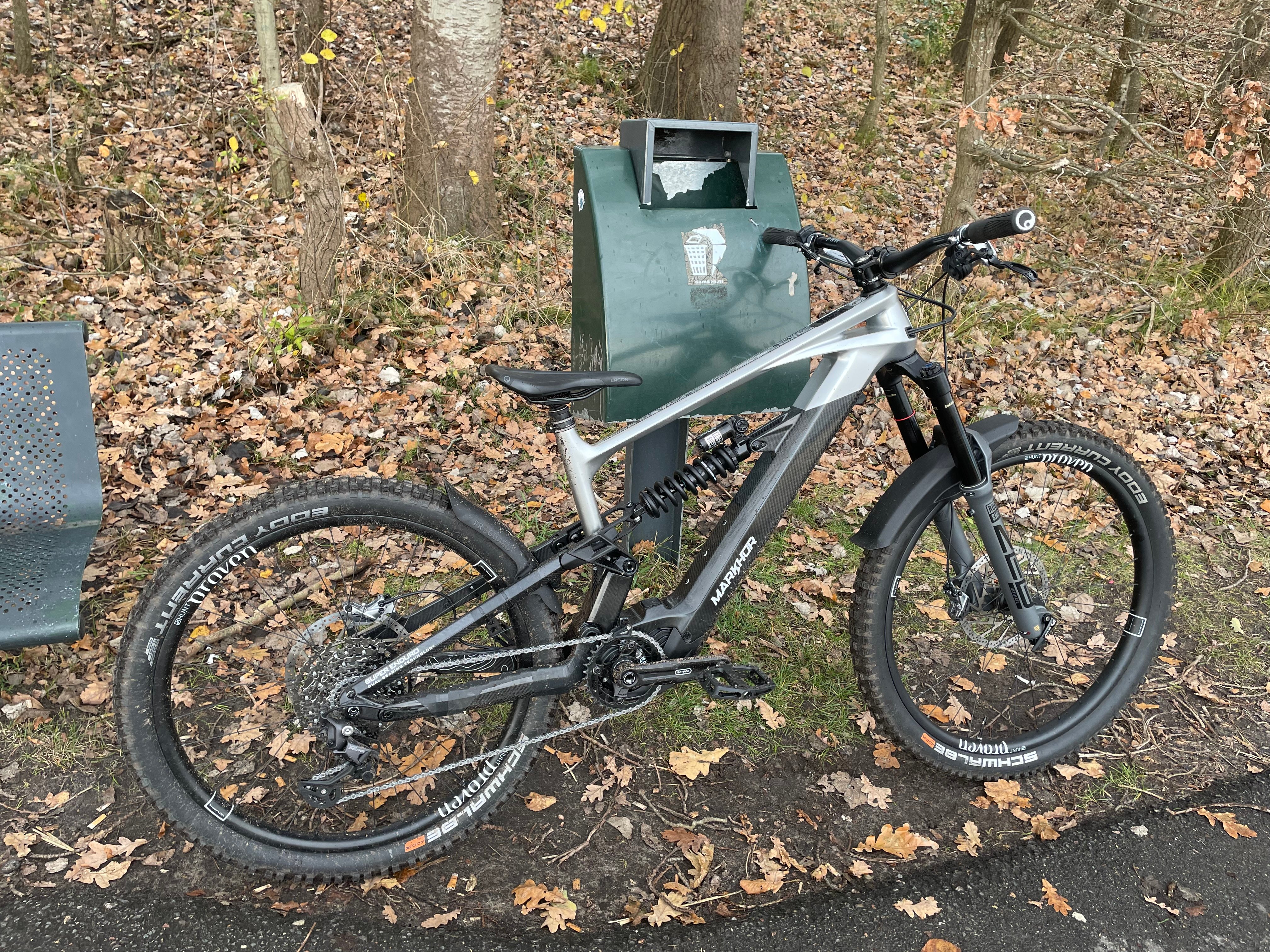

so after 500km im still happy
some things i found
DH is absolute king with this bike.. it handles anything
climbing is solid but it requires some getting used to due to the 63.5* headangle
tight switchbacks feels kinda weird because of 1300mm wheelbase but still doable but it needs more preparing and focus.

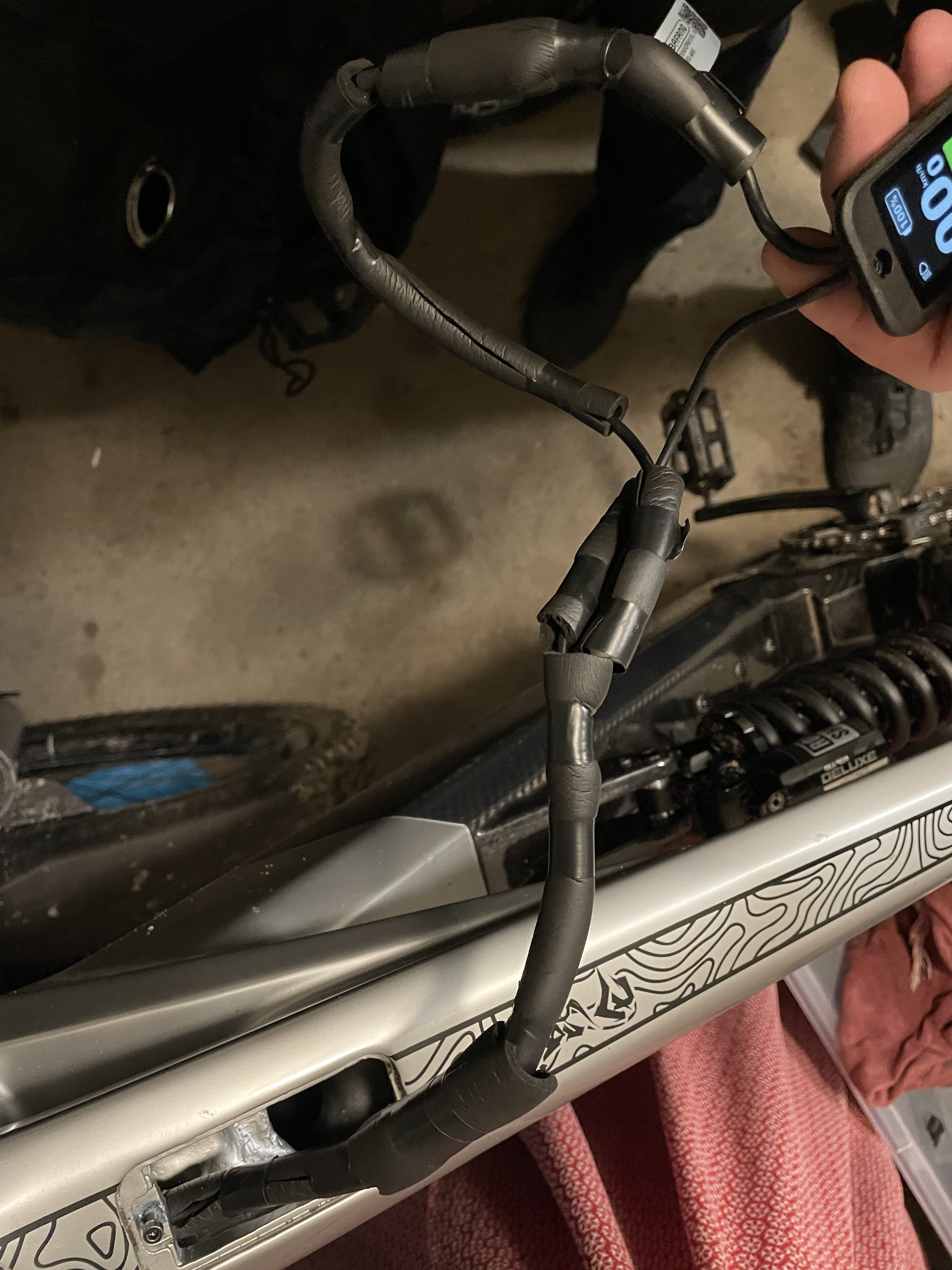

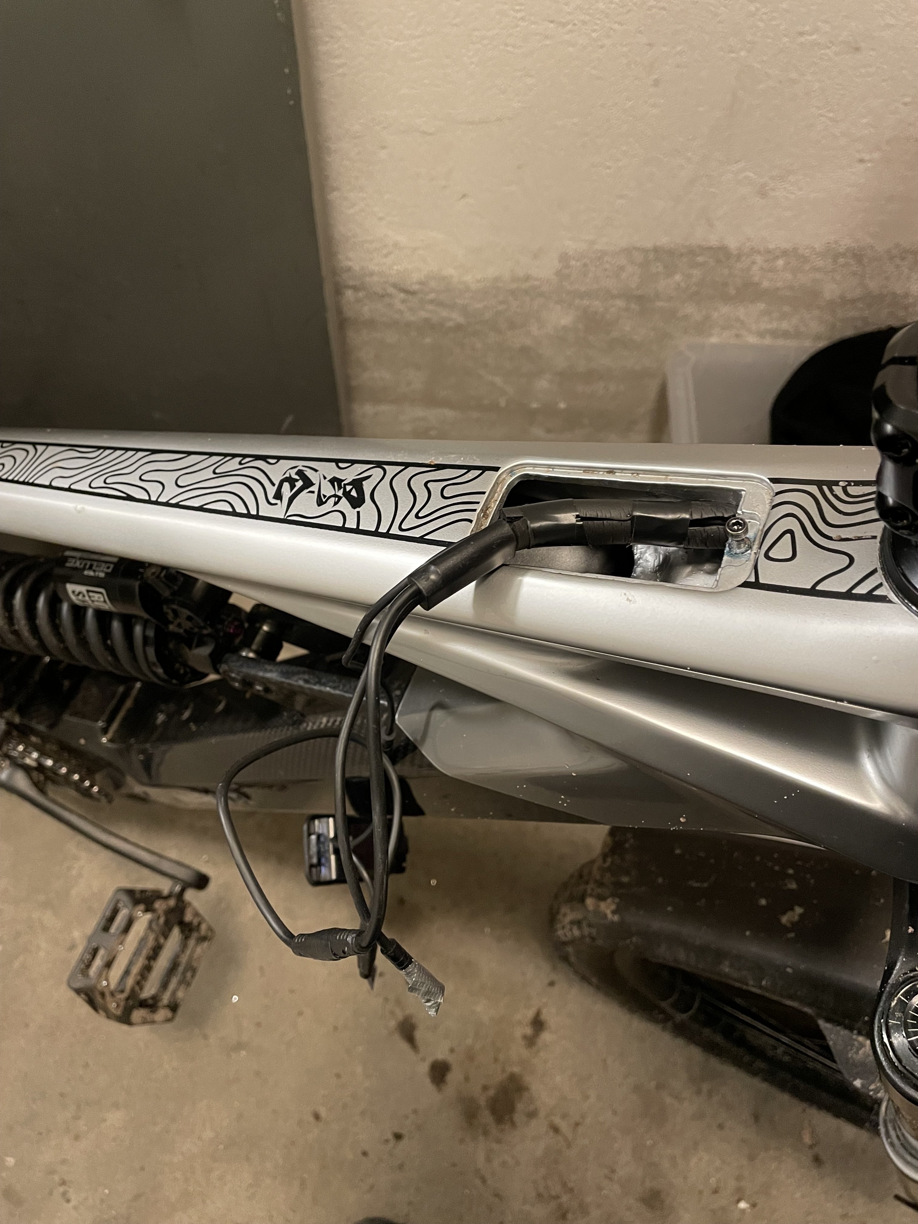

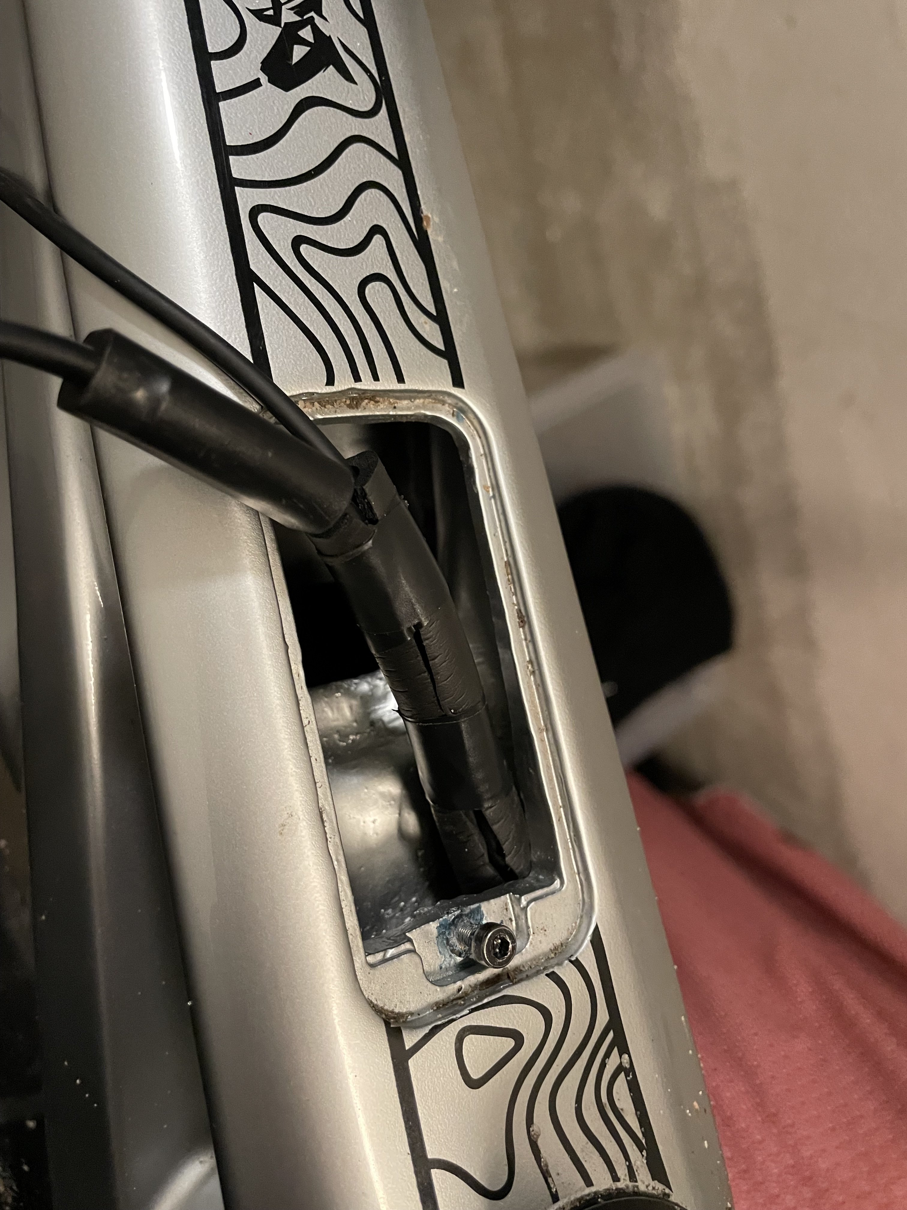

also the bike developed a kindof clunking sound from the toptube everytime i hit some bumpy piece of trail. my guess was that its the cables and connectors from the toptube display. as there are many cables and extra connectors
i taped them all with foam tube slid in half and stuffed them in the toptube, after this mod the frame is fully silent

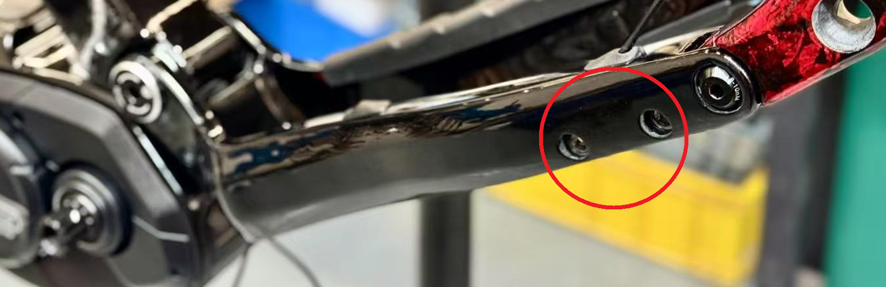

@kaaskopf What are these holes for?
PS do you remember how many links your chain has? I would have a new 116 liks but I don't know if it's short

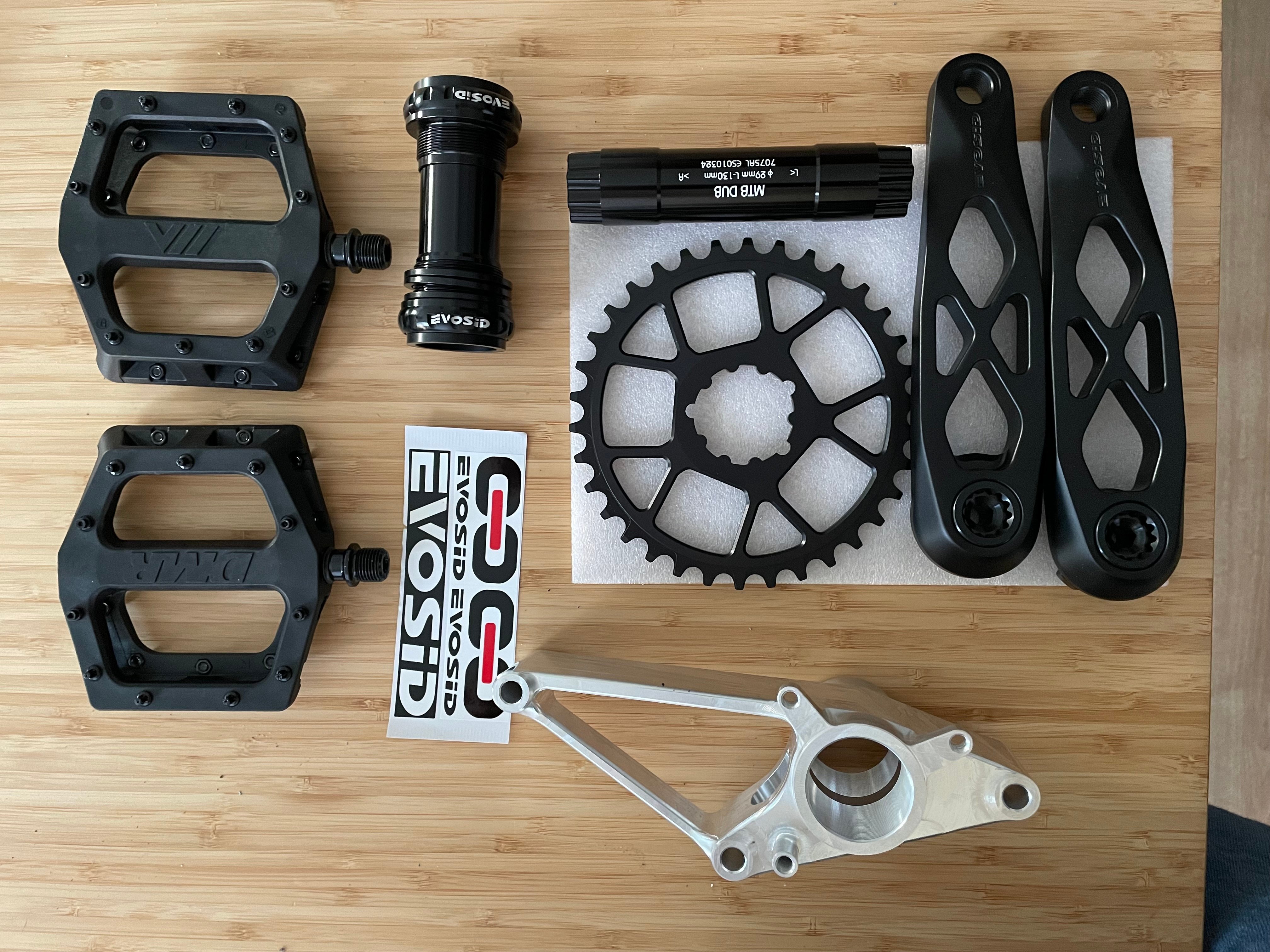

ordered a chainring spider of greenbikekit to see if that fixes my chainguide fitment issue
in the meantime new parts came in
evosid crankset 165
34T chainring
dmr v11 pedals
Hybridiser bb bracket 'motor mount'
seems to make sense for those days i just do uplifts in the Alps, it was cheap enough to try it anyways
