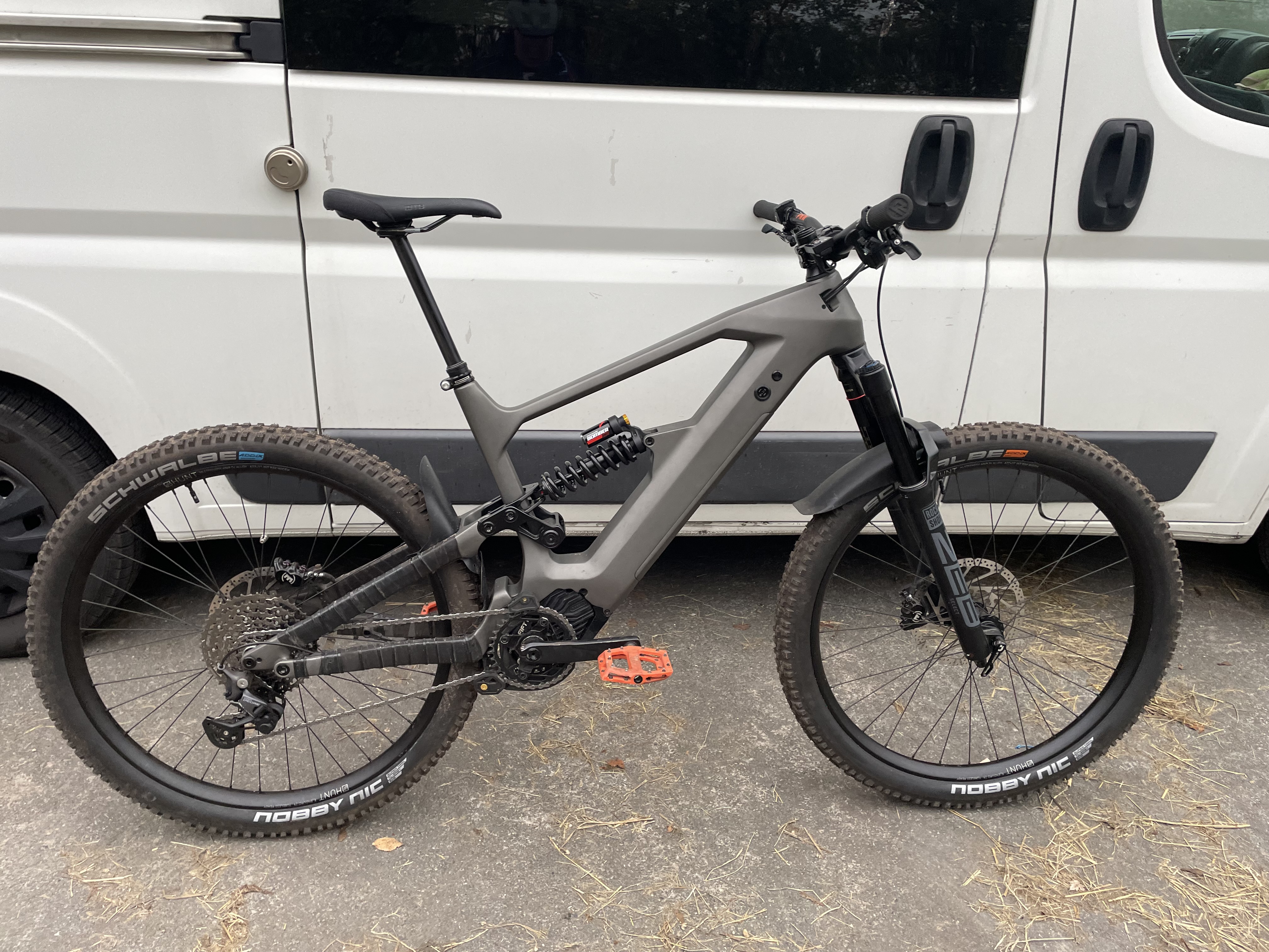

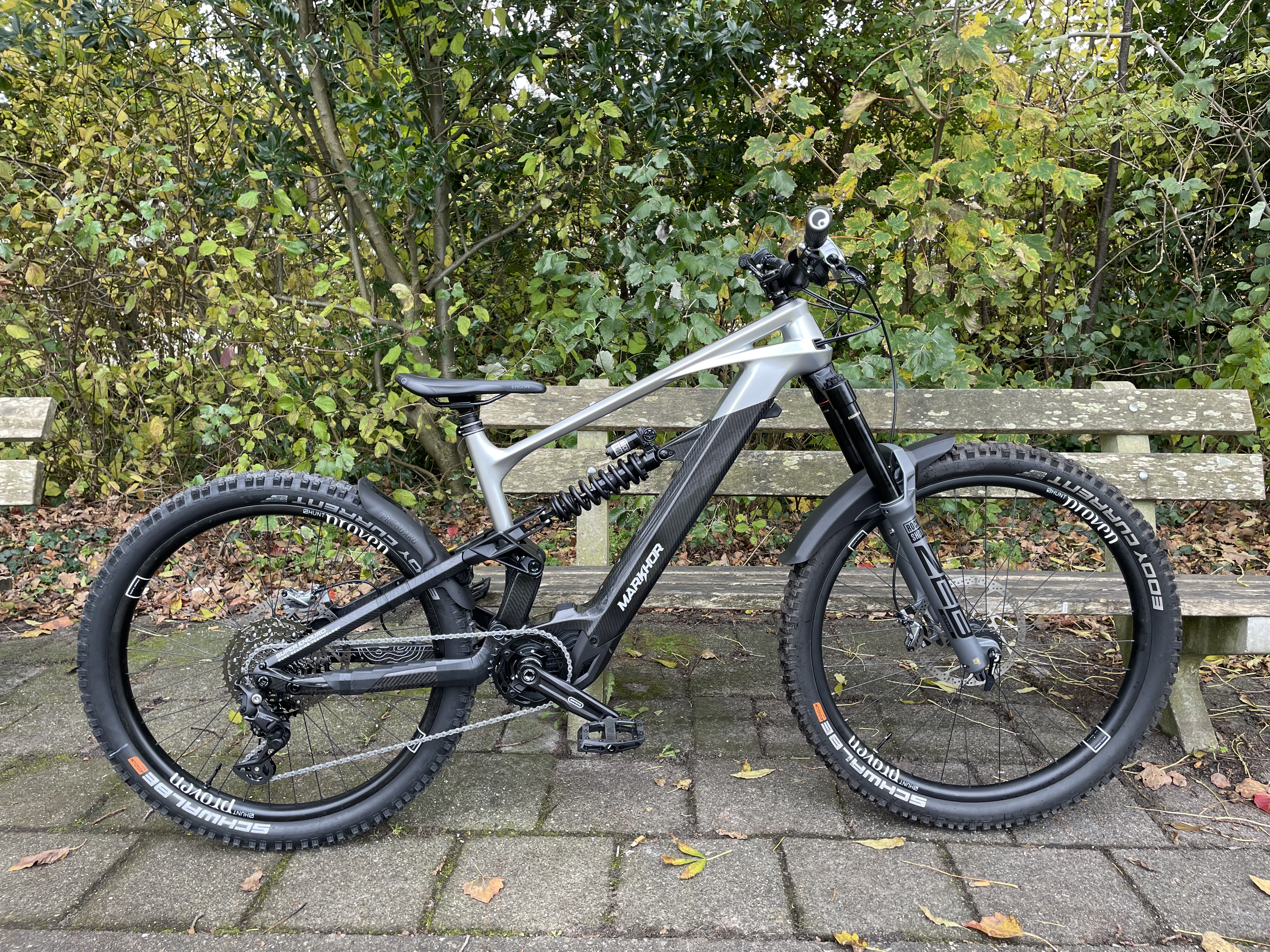

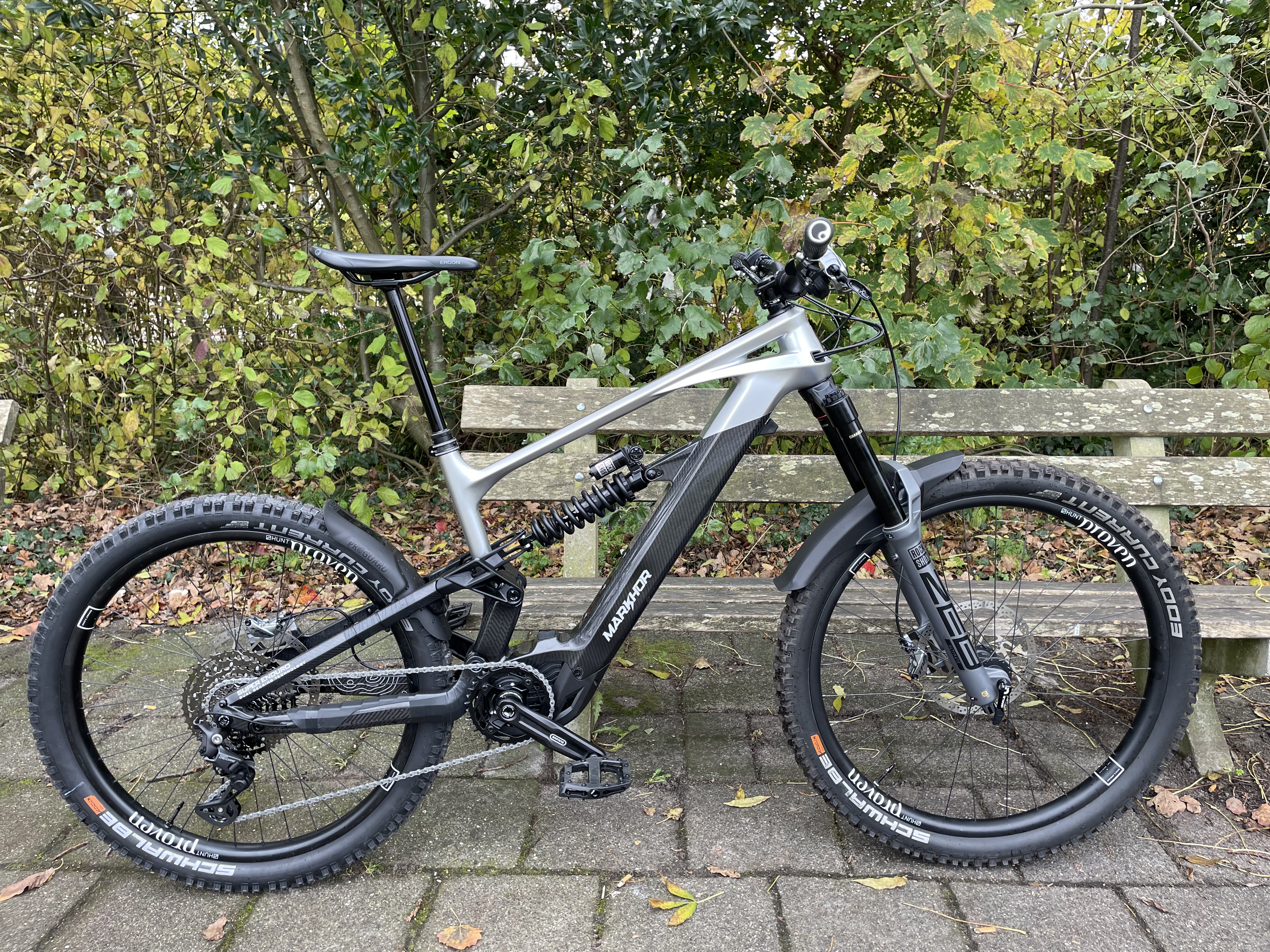

this is how it stands right now
i got an inclinometer from work to measure the angles, headtube is right at 63* and seattube is 74

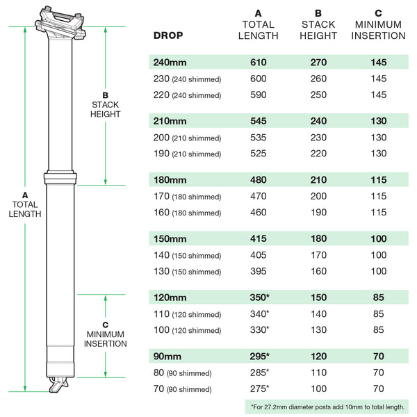

seatpost from rails to seatpost clamp is 270mm and a max insertion depth of 340mm shows it fits a Oneup 240mm dropper. I'm 182cm btw
frame is comfortable to sit. toptube is slightly less long compared to e10 and i will say this is better fit compared to my slightly to large 19.5" e10.
wheelbase is right at 1300mm, Yes that is very long but for gravity riding just perfect 👌
I'm very happy with the angles. center of seat is right on the front part of the rear tire
(on e10 it was almost center of rear axle which for climbing sucked donkey balls)

i did measure my current e10 build as well
some info
full 29"
oneup 210 dropper
216x63 rear shock with 1 offset bush(170mm rear)
160mm 29" front
2.6" tire size
headtube angle 65-*
seatpost angle 68.5*
attempt to measure stack height( bottom stem bolt to ground) 102.5cm
the stack height i didnt want to make bigger compared to e10 for trail handling and climbing ect. i have found front washes out quickly if i go any higher on e10.
currently the stack height is same on the 2 bikes, because on the kunlun i made the stem as low as possible with 1 3mm stem
spacer

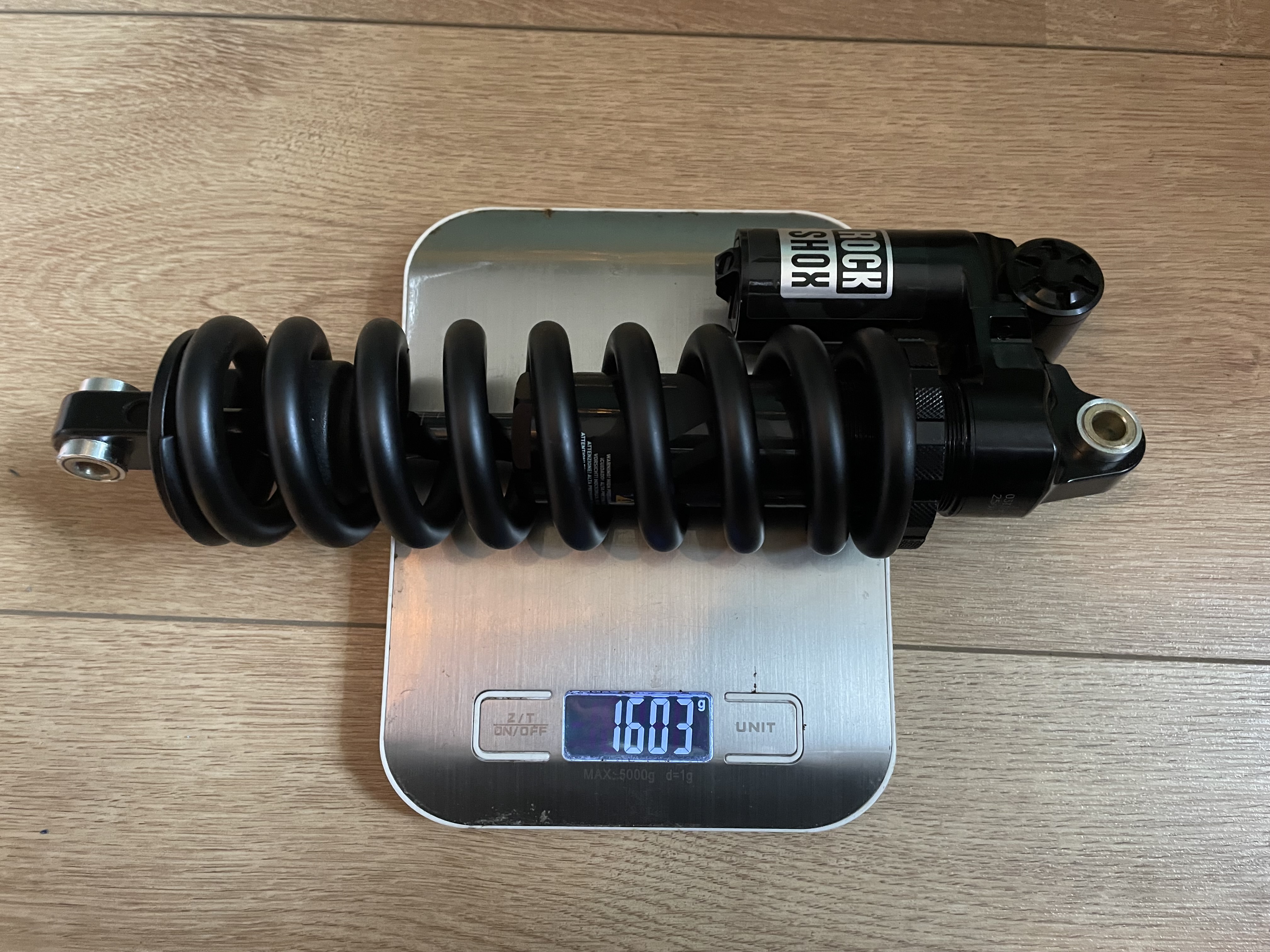

Rockshox Deluxe Ultimate DH B1 (steel shaft) coil shock in 250x75 with 500lbs coil
Found a deal on an Oneup v2 240mm dropper, so now the project is on hold till i get the dropper and some more free time... :)

My frame arrived a few days ago too... that is one heavy ass shock isn't it :oops: I'm building mine up with a fox x2 230 x 65 and a fox 38 180mm fork but still waiting on the shock hardware to arrive... I'm going to do an unboxing video for YouTube once I get all the bits to fit the shock to the frame... keep us posted on your first ride and finale build weight (y)

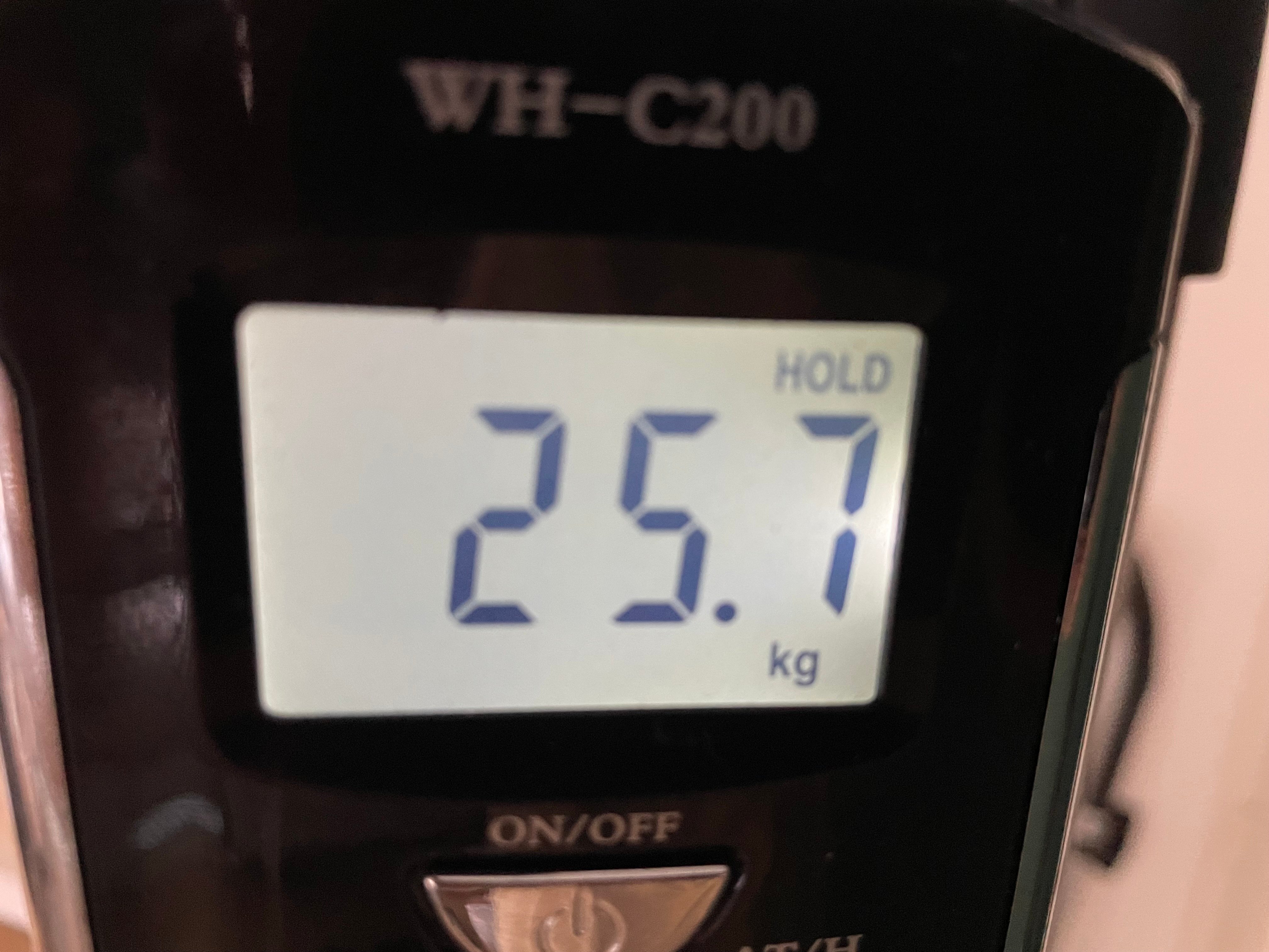

bleeding of the brakes was the easiest i ever did! well done TRP! took me 3 min each
also adjusted the shifter and installed the dropper
i threw all the parts on the bike quickly and weigh it. this i was the most curious at.
because of bad weather i didnt testride it yet or took any pics...
still acceptable weight i think, mind it is basicly a DH bike at this point
my E10 with smashpot and same rims was heavier in the end at 26.9kg
what do you guys think?
Tilt
Dec 12, 2022
112
52
France
battery size is 500x75x60 mm
for an enduro the weight is not that heavy nice construction

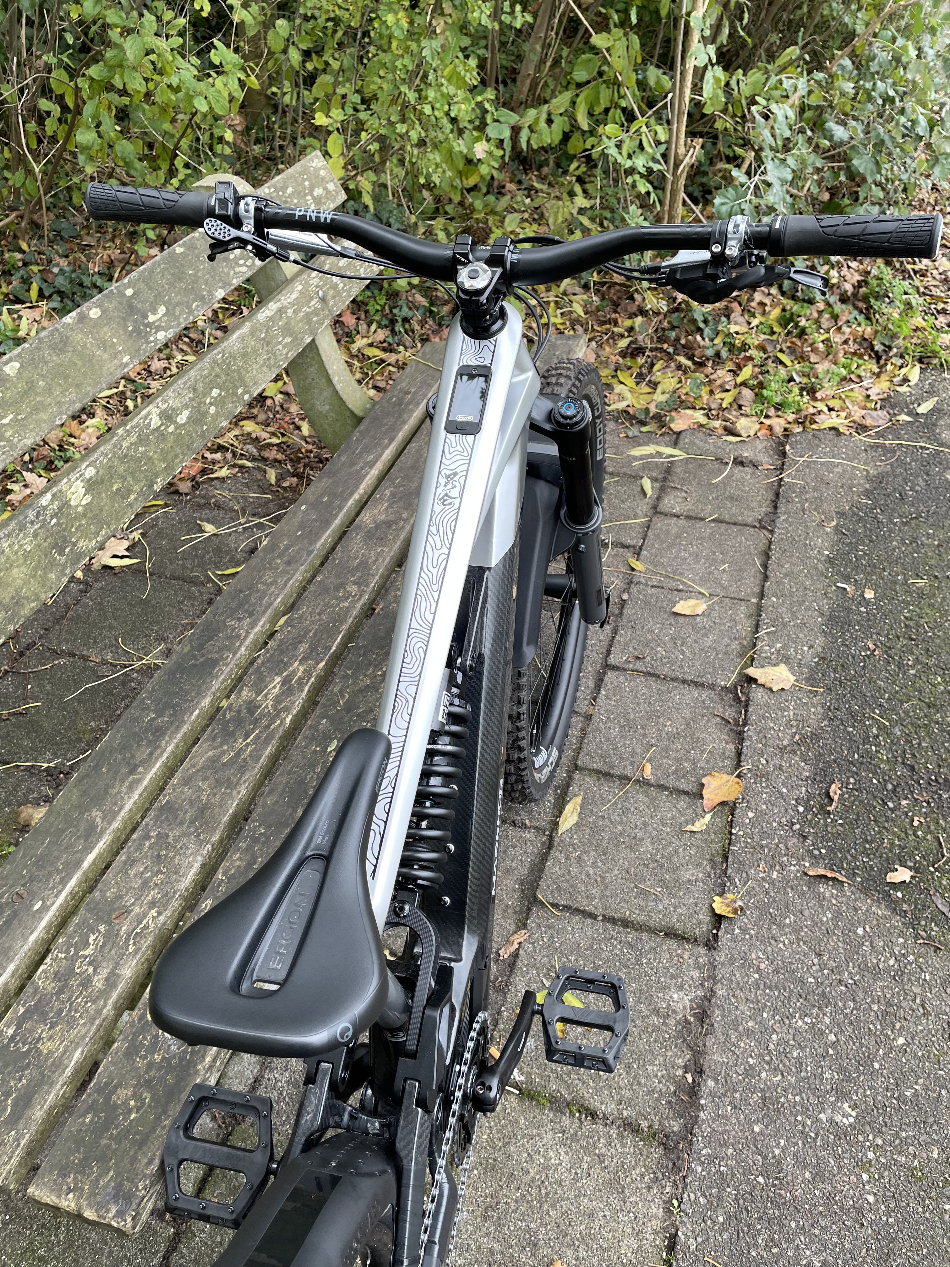

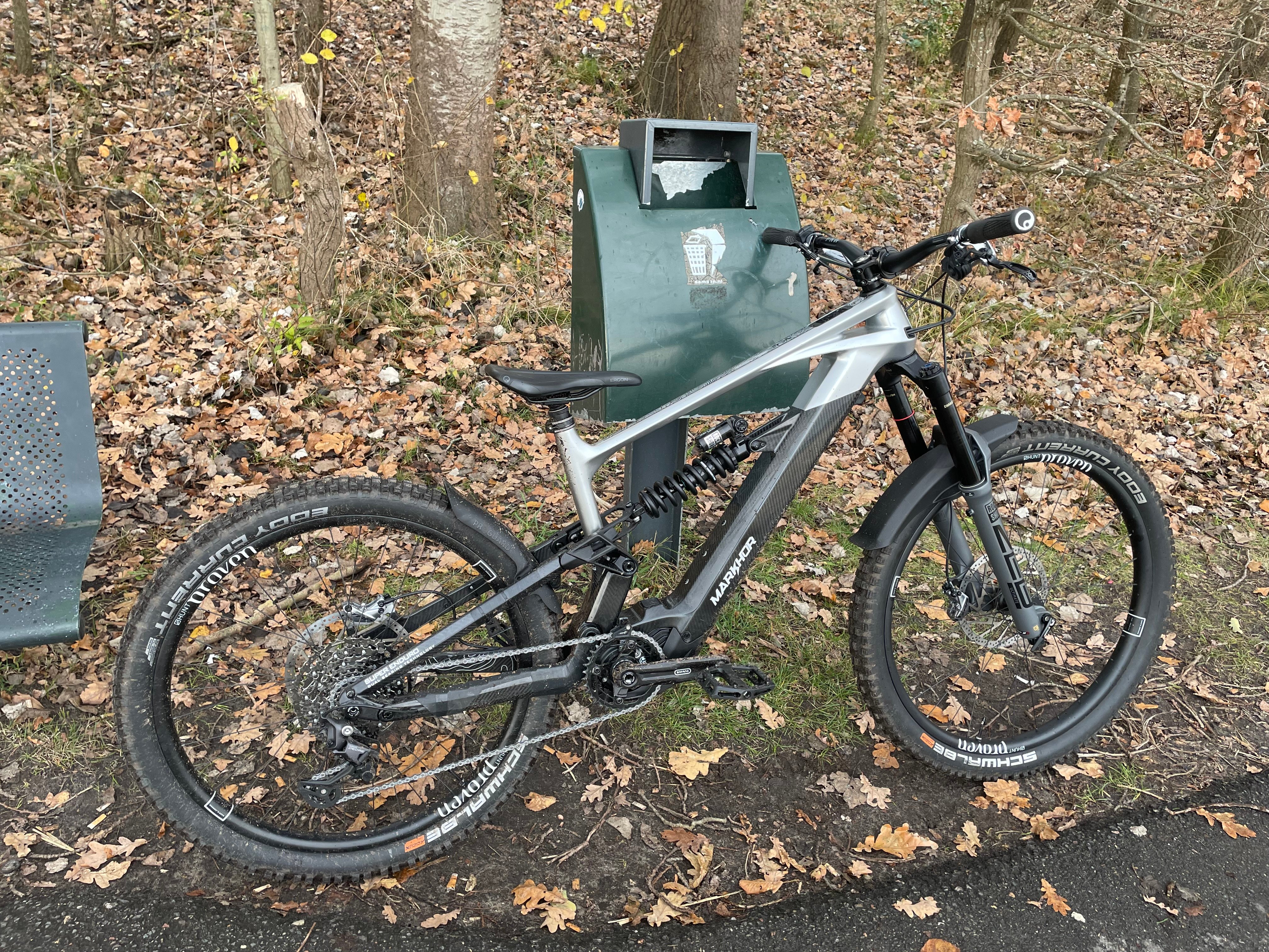

this is how the oneup 240 v2 ended up fitting.
not great but not that bad either..
dropping action is smooth
i run the dropper flush with seat collar for the most drop. standover
height is now almost 2cm lower compared to e10

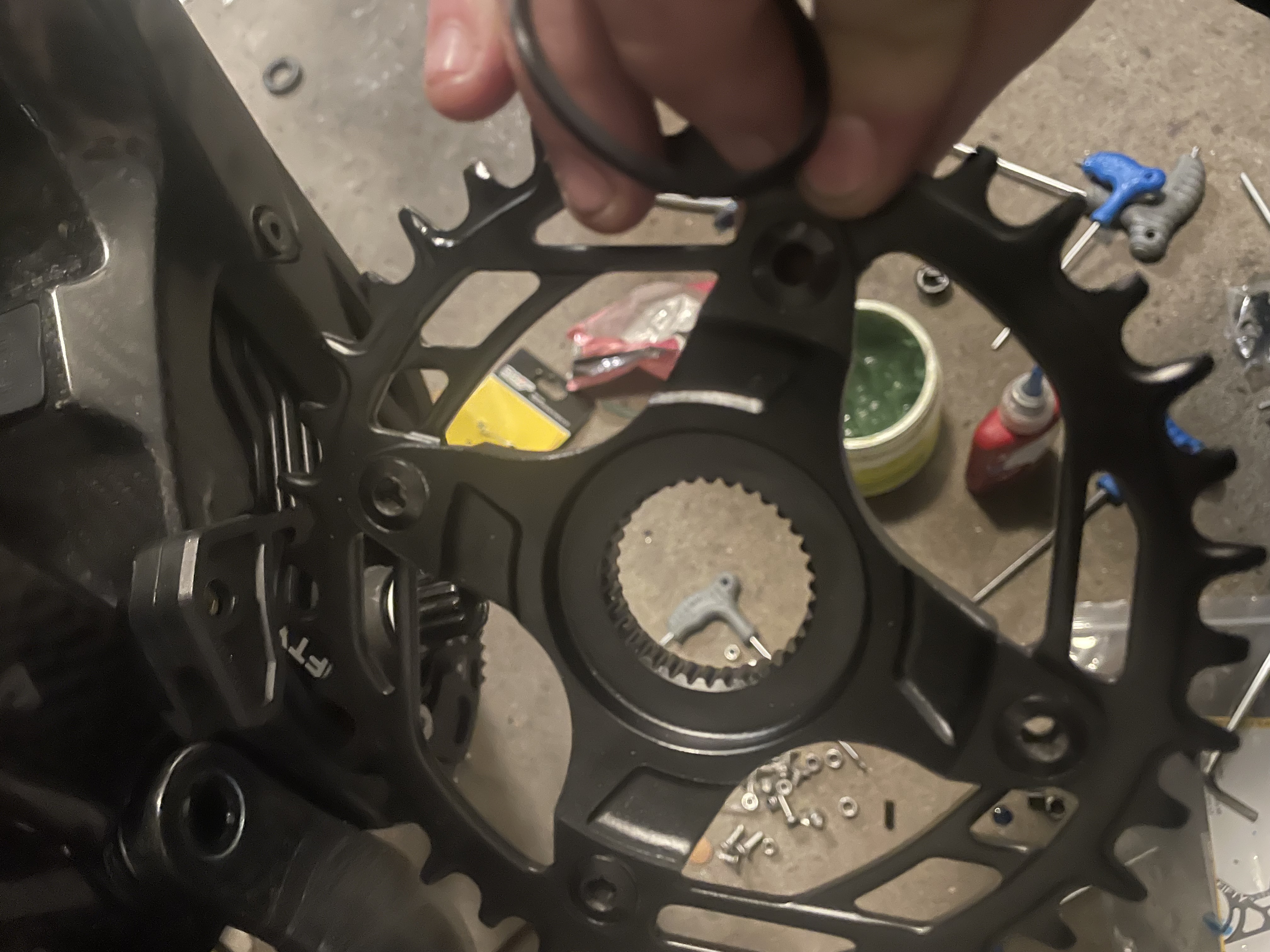

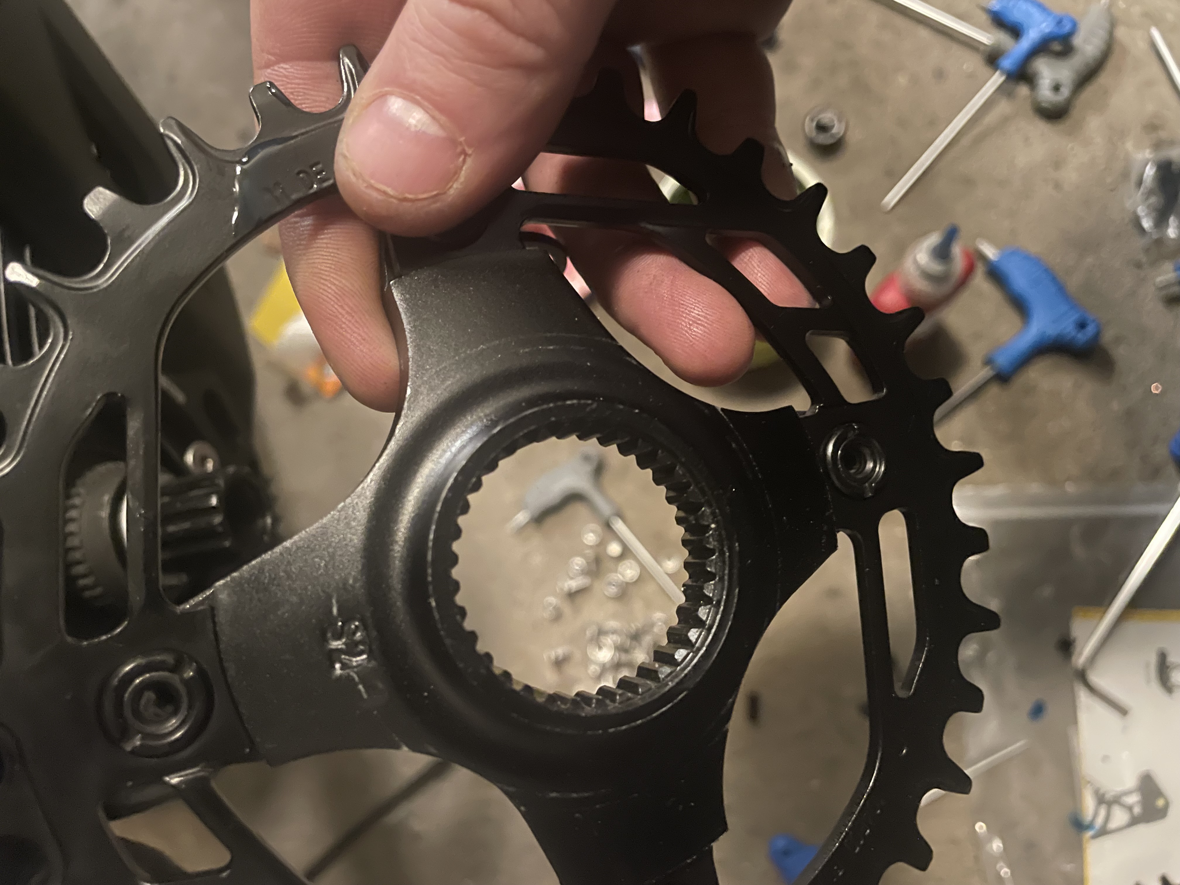

i was not able to fit any of my chainguards. bafang gave me the wrong spider i think
what spider should i get ? this one grinds on 3 different iscg05 chainguards..
xtraman122
Mar 2, 2024
279
221
Awesome build, I love that the frame is actually well finished and looks much higher quality than the Dengfu junk I got 😂. The integrated display is a great finish as well, I’m jealous. Really like that it uses an actual Bafang battery too, I don’t trust the no-name batteries even though they’re still using good cells and aren’t cheap, something about it being from a big brand makes me feel safer.
If it hadn’t been a mullet only frame it would have interested me when I had to switch frames part of the way through my build plan. I think my next build will have more travel, not because I ride super hard but because I’m a heavy dude and I tend to use up travel easily. I’m surprised with your battery being so light and carbon wheels that it still weighed as much as it did, but I guess that shock is a beast as well as a pretty big fork. The final weight on my E82 with 160/160 travel and my own 720Wh battery invention was 23.96kg.
When you were asking about the chain guide in the other thread I didn’t realize you had an M510, I wonder if that’s the different and why it doesn’t fit quite right, I’m on an M560. Although @Sayonara seemed to have the same issue as you on an M560. I’ll have to see if I can make any measurements on mine for you to compare to. Took an awkward fall off my bike yesterday due to landing in a bunch of slippery leaves and messed up my shoulder pretty good so I won’t be riding for a few weeks… Will give me a chance to figure out my battery issue with the Dengfu pack.

maybe there are some markings on your chainring holder ? maybe looks same but maybe it is not
xtraman122
Mar 2, 2024
279
221
much of that weight is heavy parts tho like suspension wheels and tires. your tires are half the weight of mine + inserts
if you build this as a 170/170 with your parts i expect same weight around 24kg
but yeah 1-2 kg difference on a bike like this doesnt matter all that much. just hit the gym :)
I actually do have the huge e-bike CushCores in mine, but the lighter casing (Which I didn't necessarily intend to get) makes a difference for sure.
I’ll check for markings, I don’t remember any though. Definitely nothing on the outer face, I’ll have to check on the inside that faces the motor. It does appear to be the same one though.

ordered a chainring spider of greenbikekit to see if that fixes my chainguide fitment issue

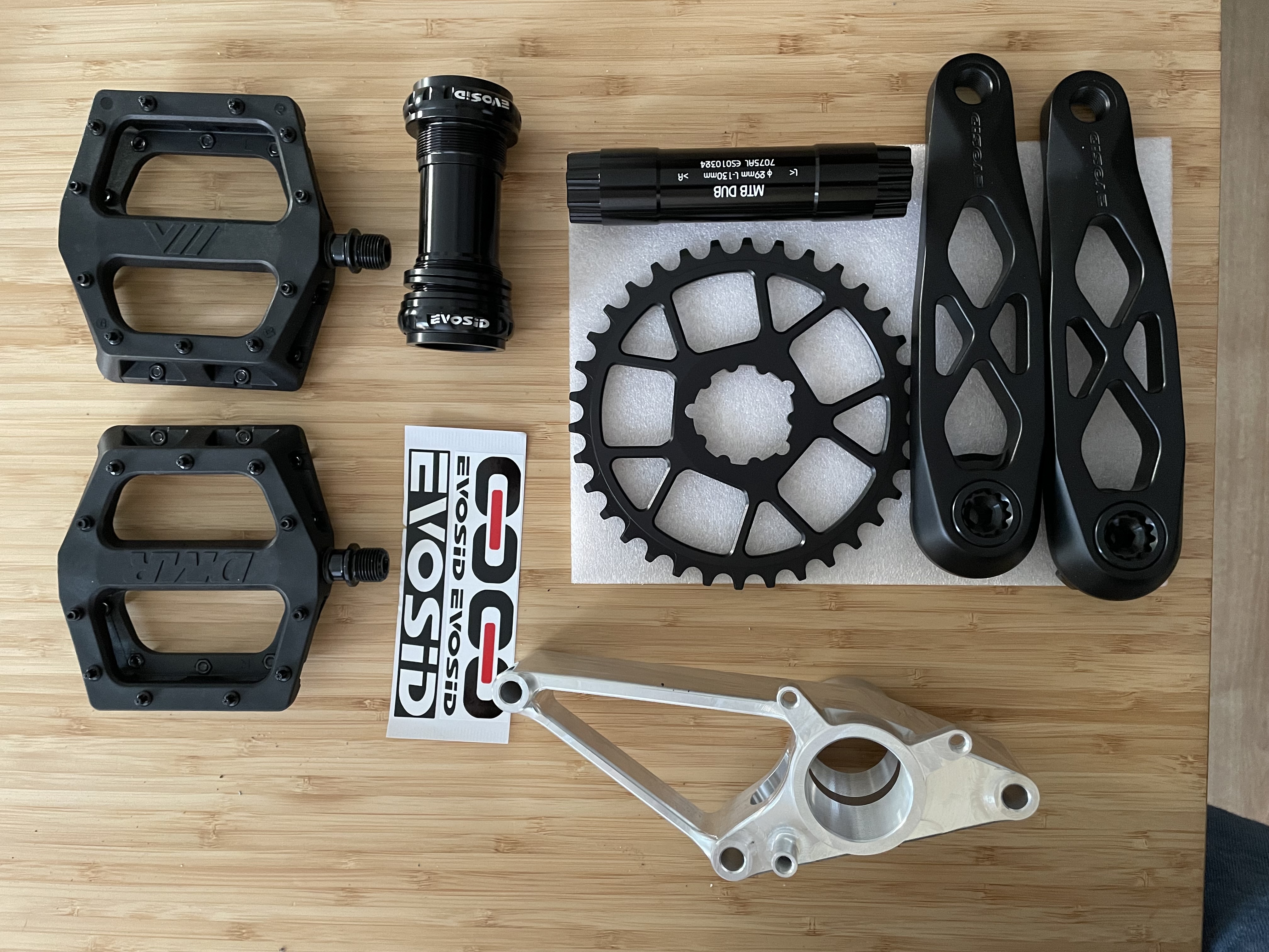

evosid crankset 165
34T chainring
dmr v11 pedals

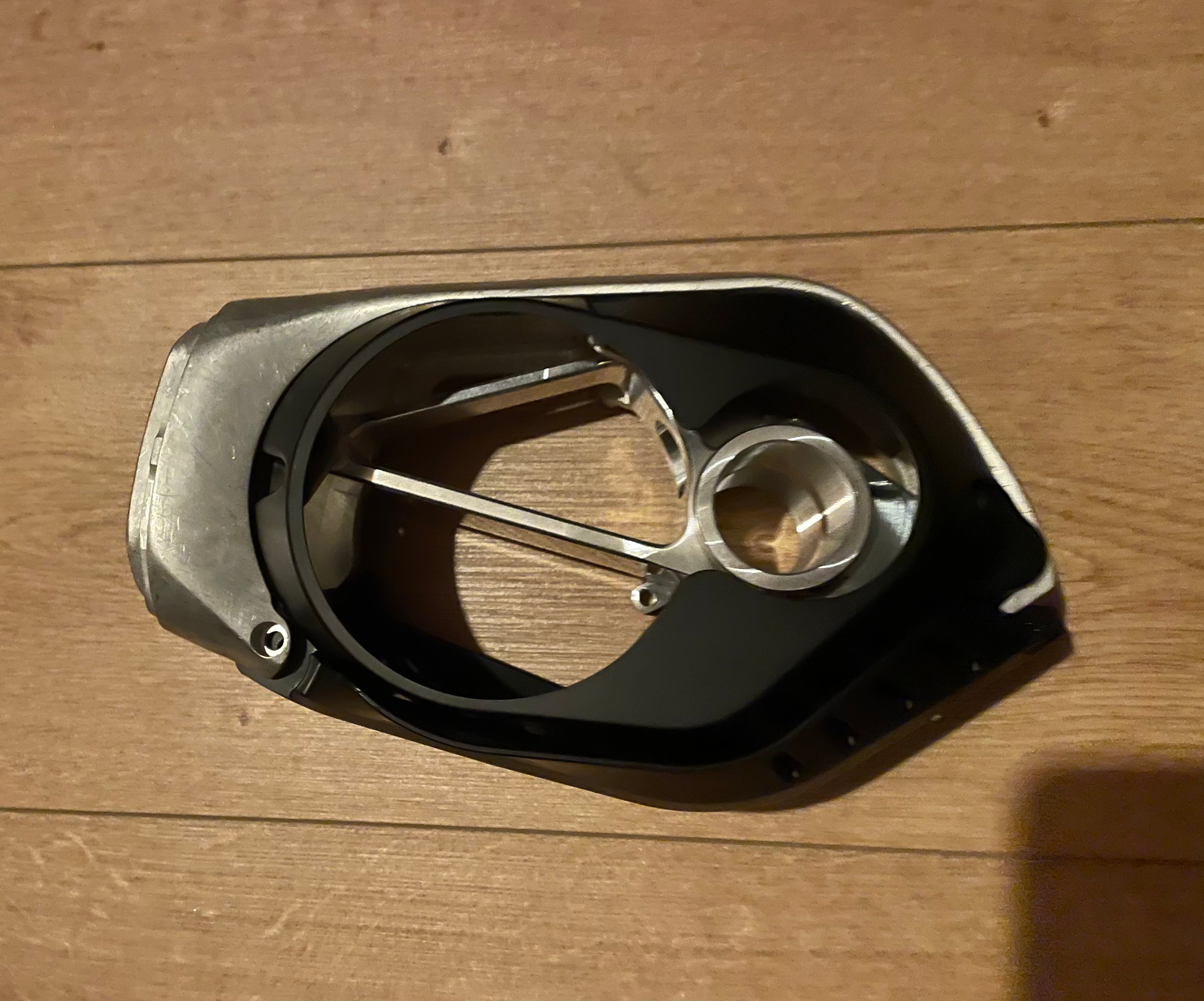

Hybridiser bb bracket 'motor mount'
seems to make sense for those days i just do uplifts in the Alps, it was cheap enough to try it anyways

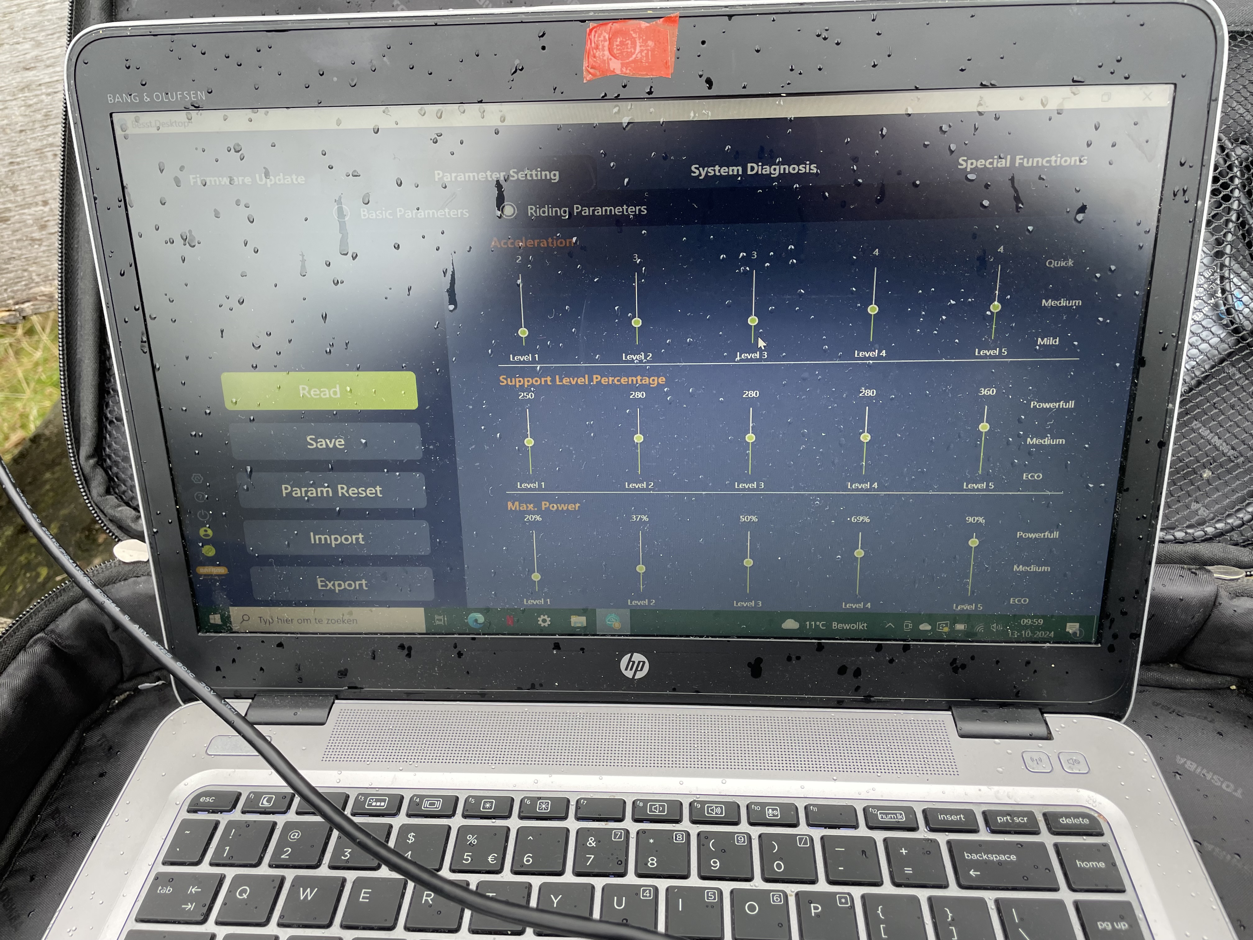

i wanted max travel because my other bike is an e10 with 180/170 but i made this a full coil build
the difference in travel would mean more sag in the longer travel wich means more pedals strikes perhaps.
also the longer version would be less effcient to pedal because of more movement ect
i run these settings to make the engine smooth and long range
the torque sensor sensitivity is rather low because i like to workout as well
if you would raise these levels the motor would help more but would feel less natural

Do you have a photo with these parts mounted on the bike?
kaaskopf
Oct 11, 2024
177
227
Berlin
nope not yet, maybe later time
its fits any bafang m510 motor mount but it will leave some gaps for dirt to get into the frame
so if you want to make it right you need to design some 3d printed parts to keep dirt out
this is what it looks like in a motormount;

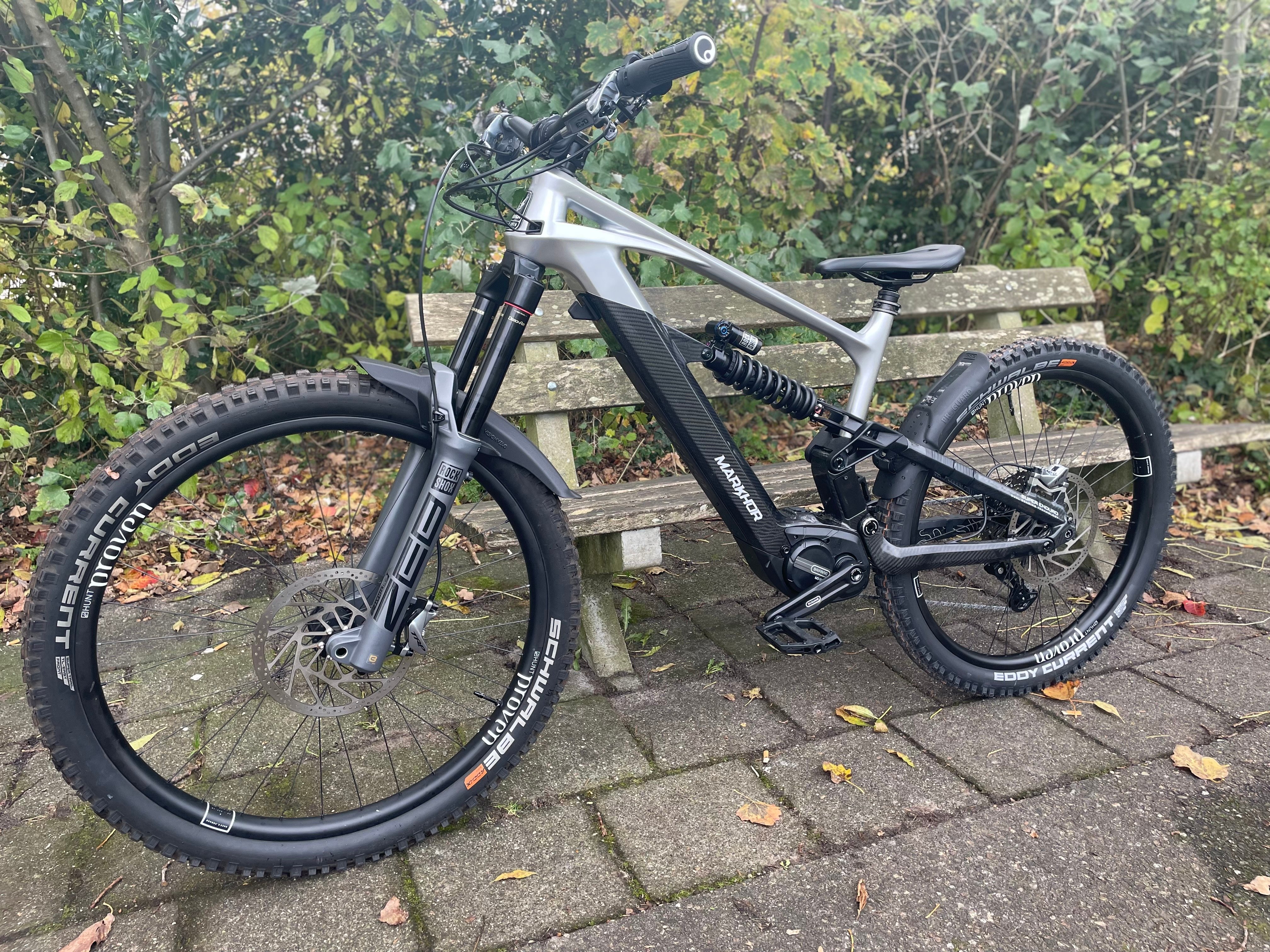

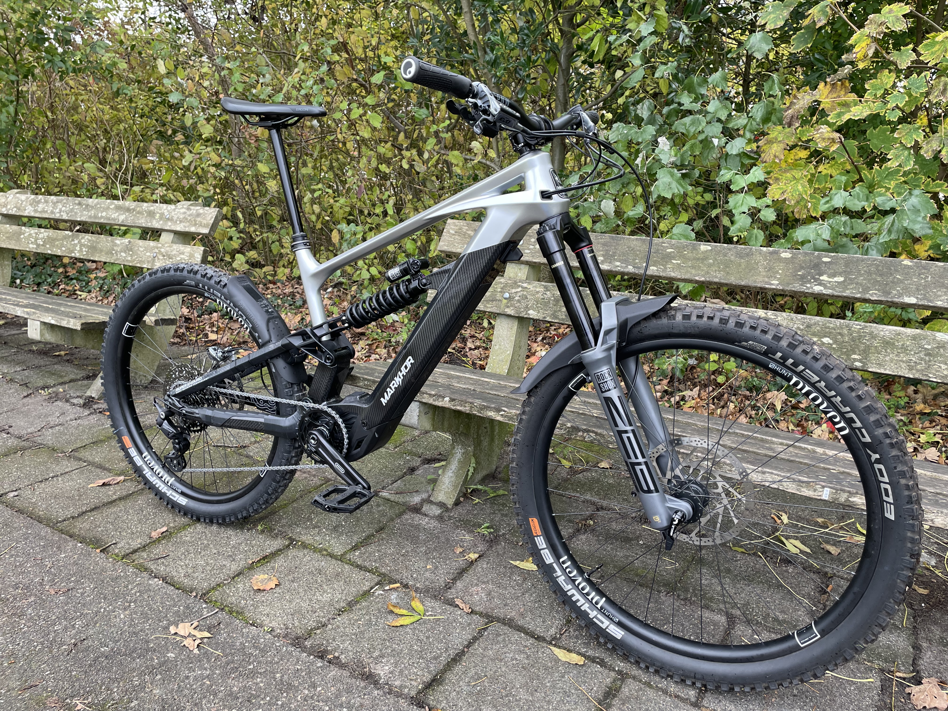

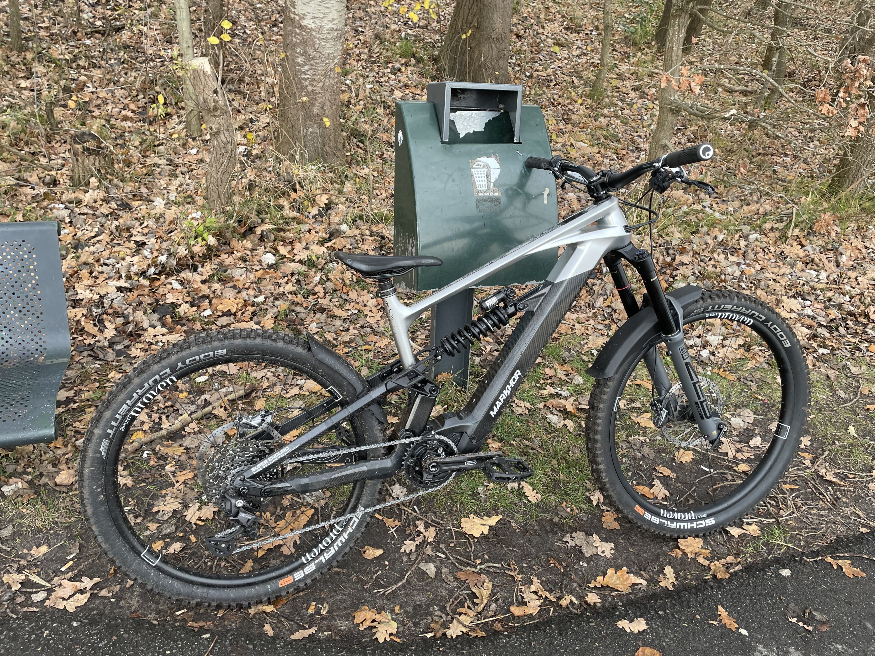

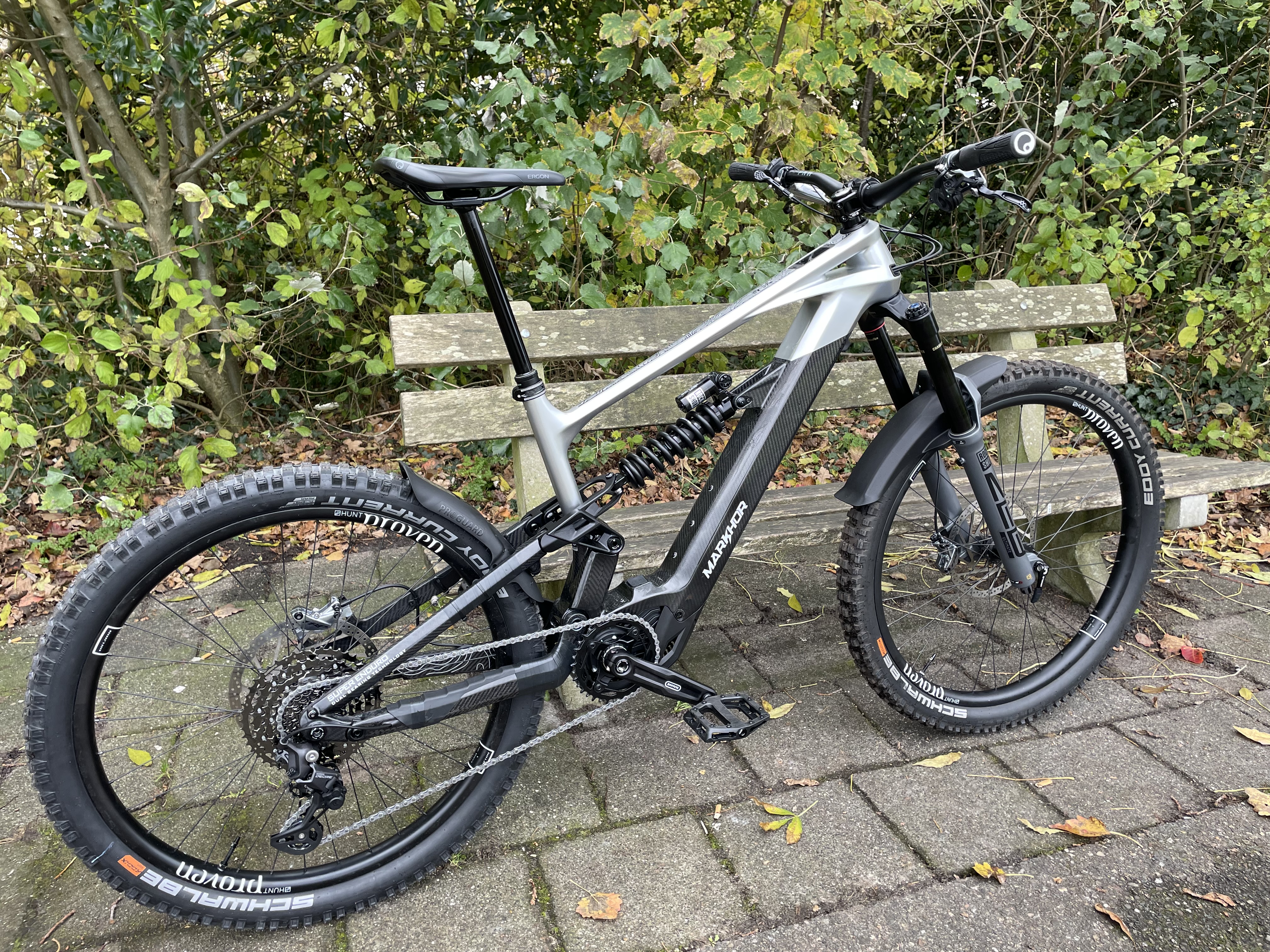

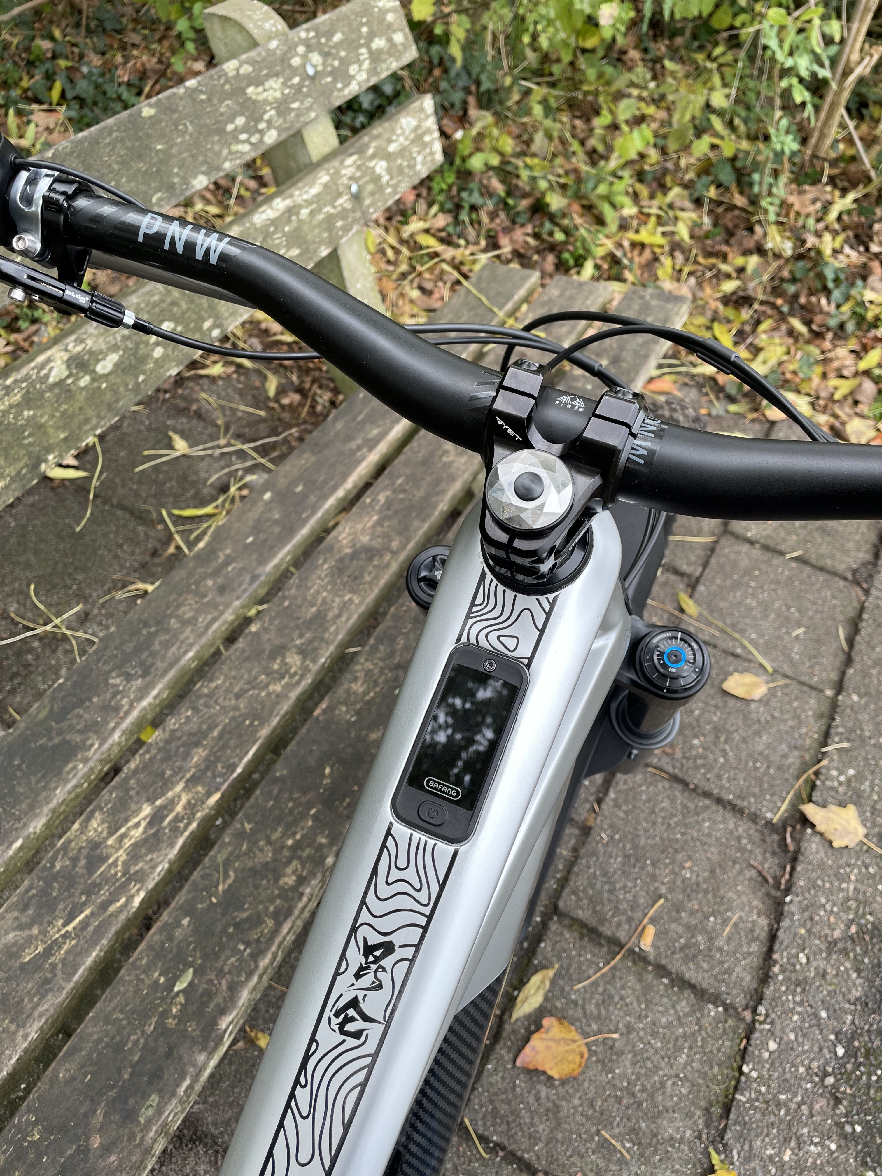

finaly a proper testride!
it rides amazing! full on DH bike on the steeps and rough
climbing is also very nice and stable. the steeper seatpost really helps alot
very responsive and allround well made bike.
i tried to think about a negative point and that would only be that there is no range extender yet! The bike itself is sublime
also this m510 fc2.1 does ride compleetly different from my older fc2.0 . feels like much more definition of torque sensor and in general feels better overal. it also came without speed limit 🔥
