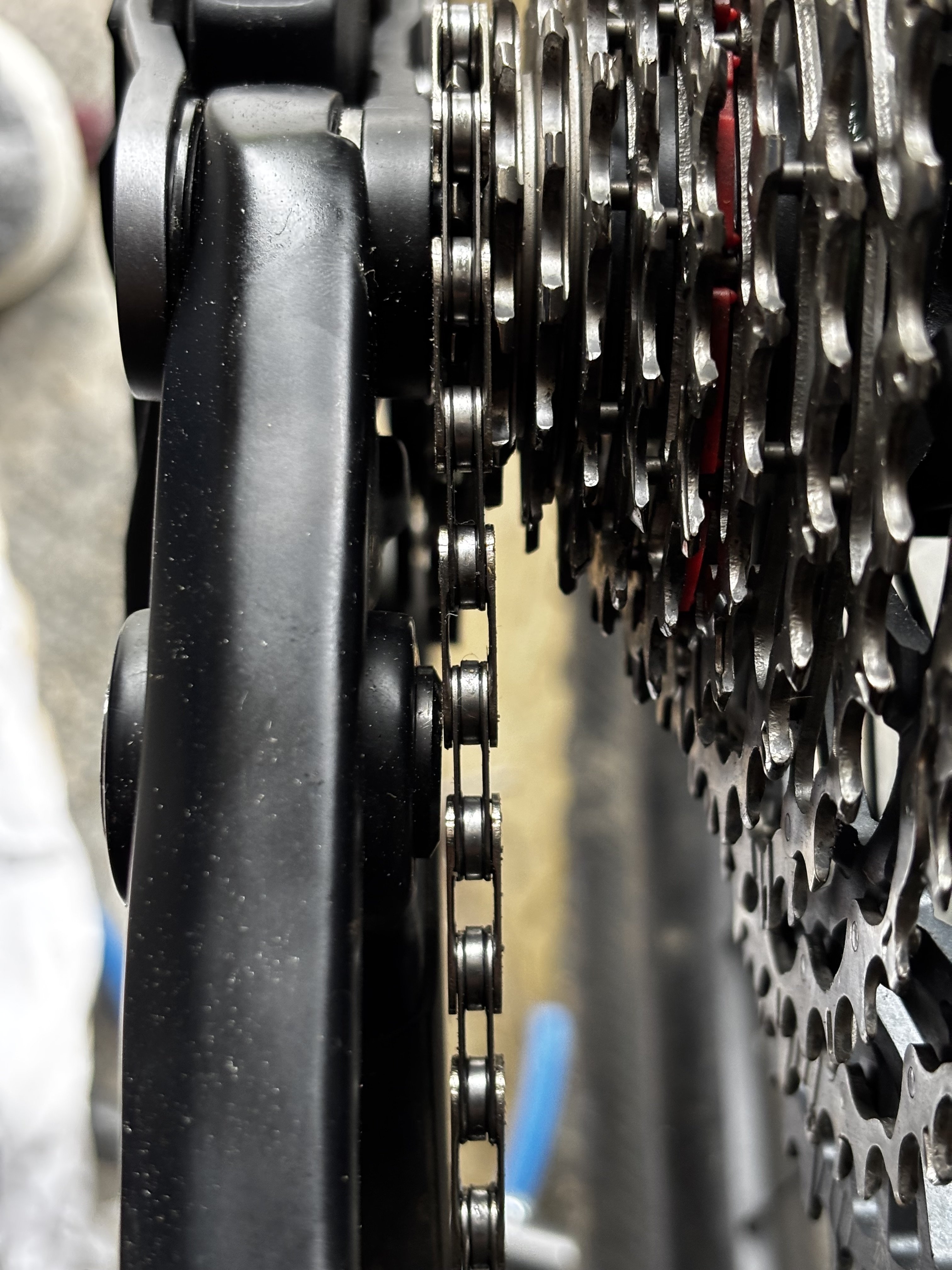

I’ve installed a t type gx on my lce930, and in 12th speed, it rubs against the rear pivot:

I would check make sure the cassette is seated properly.. no spacers behind it. I didn't have a problem with the UDH and a 12 sp cassette so it seems correct on the chainstay.
It looks like it’s properly installed, right torque, no spacer of course

This looks like cassette is too far out. From that angle I can see maybe 1 mm of the endcap between cassette and frame.
I’ve checked and the cassette is fully engaged… Jim is sending me a new bolt to solve the issue and I will try to change the chainring maybe to help as well
But it looks like the chain is touching the derraileur as well. It could also be freehub that is not all the way in.
You are totally right, the picture got me worried so I had to check this!
It looks like it's touching the derailleur but I guess it is the angle of the photo that causes that. In reality, the chain is clearly above the derailleur and there is a security margin :)
I will wait for the new bolts and see how this goes.

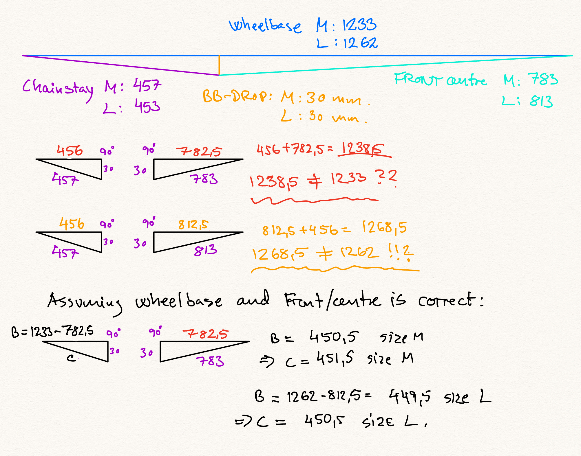

What am is missing here?!.. I have been looking at the geometry numbers and can't get the chainstay length to match with the other numbers!
It's been a while since i did trigonometry even it was part of my eductation..
I have been comparing chainstay, BB drop, wheelbase and Front/center. Too me it looks like at least one number can not be correct!
I hope it's the chainstay ;-)
Please enlighten me if I am doing something wrong in the calculations
Front center is probably wrong. It should be with 150mm fork but still offset can change and I have seen some strange A2C measurements in geometry charts.
On my bike, with 170mm fork and 51mm offset, I get 1280mm wheelbase, 457mm chainstay measured.
The relative long wheelbase is a good thing, very stable at speed.
Thanks for input. I am quite sure stability is good, but I guess it will be with the trade-off, that manualling and flicking the back end will require a lot more effort. There is not a lot of other bikes in this category that long. More like 440-450
