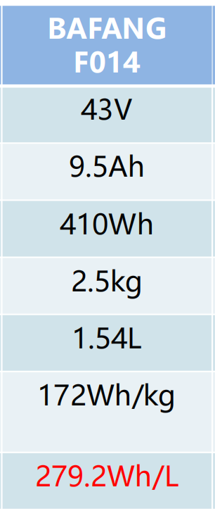

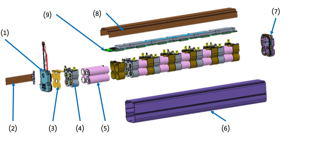

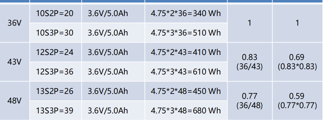

While it maybe possible to build a 48V battery to fit this frame it will take some time to configure the layout where as 36 & 43 volts is easy,. Are you thinking 39 18650 cells 3 x 13?
About the DIY battery, lots of peoples want the bigger battery, 720wh, 840wh, 960wh, the more the better,
but please note,
1. This is an electric assist bicycle, electric energy is only auxiliary and should not be the main force, Use your feet to move the pedals, not just sit there.
2. We talked with the bafang designers, they not suggest the bigger battery more than 500wh for M820 motor, That is, the full electric mode for two hours; high current output for a long time may cause the motor to overheat, which involves the effective conversion of energy of a motor, and they are still being resolved.

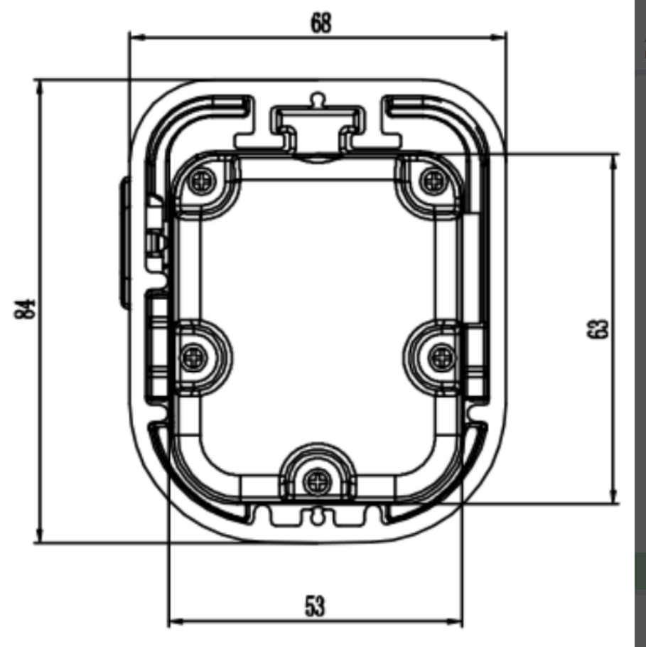

3. some info about BF F014, the infomations are old version, the newest version only change the battery mount.
View attachment 114234 View attachment 114235
Hi Jim
Do you have any updated info with drawing for the batteries avaliable from Bafang?
Thanks

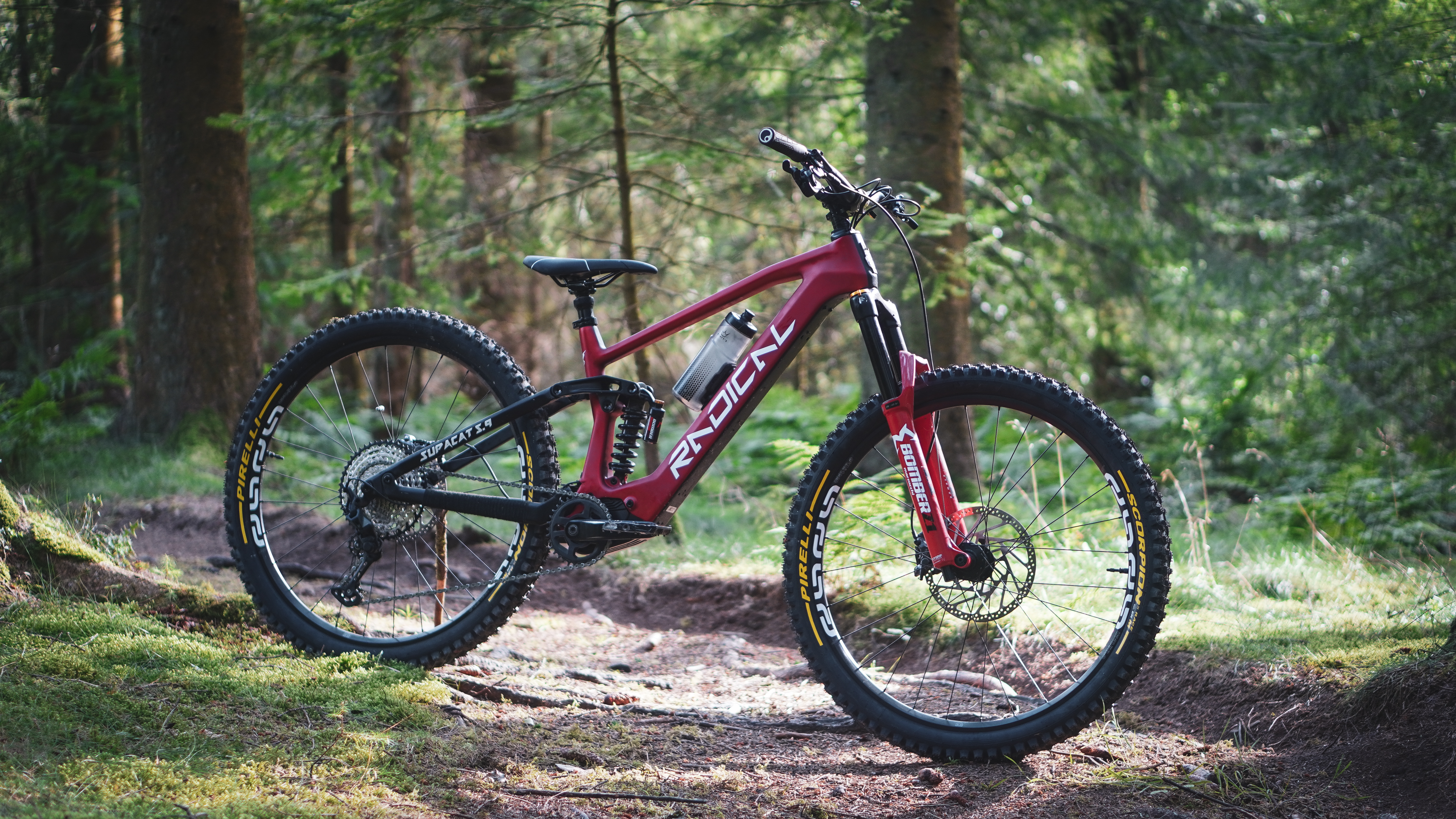

The frame has a progressive leverage ratio. We have ran a coil on our test frame (for around 12 months), and current demo. You won’t necessarily require a progressive coil due to the nature of the curve (we use a standard spring).
There is fair amount of compression especially in the early stroke (so bear that in mind for the old pedal bob), but it really holds the ground well and is super supple; and without a harsh bottom out. Just make sure you get the correct spring rate to your weight for the suspension design, that is key.
We will be uploading recommended spring rates on our website for coils. Just a bit of work to do on everything else yet….! View attachment 145917

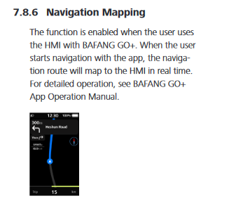

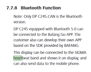

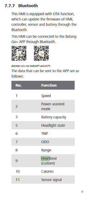

Actually, reading bafang documentation, I saw some diplays have mentions of "heartbeat". For example C245 ble 5.0 and 5.1 versions along with C010. Maybe someone with either display could confirm?
C245:
C010:
Edit:
C010 seems to also have some support for navigation

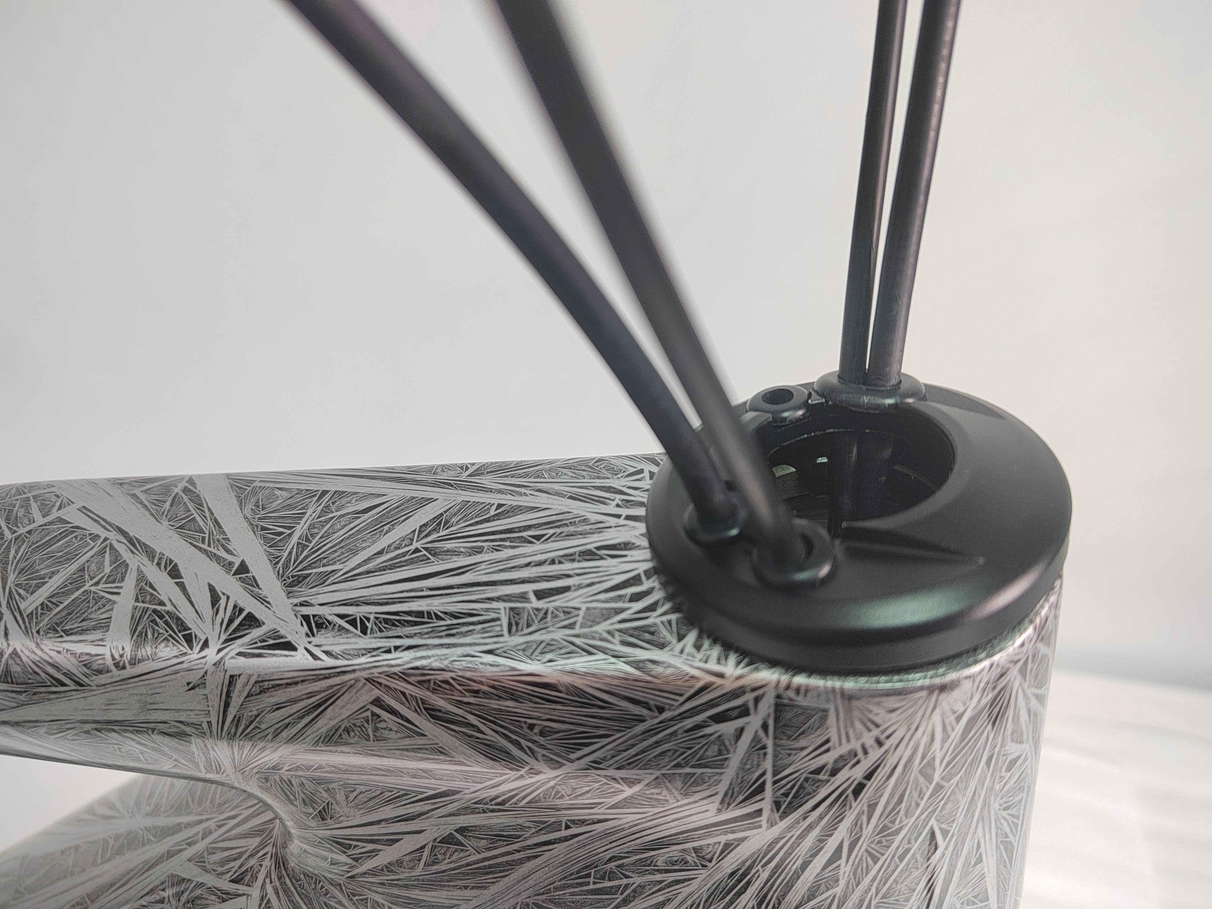

Sorry, I've been very busy recently, so I don't have time to reply to you, but I have been reading your comments and passing on your feedback to our designers.
Recently we have also made a new head set cover. The solution is the same as the S BOX cover. Please see the pictures I have on Google Photos.
The latest batch of frames shipped uses the latest covers.

In addition, if there is a strong requirement for the LCE930 and LCE971 to be routed outside the head tube, we can also help dig holes on the left and right sides, and each hole can pass two cables. However, the display thread is relatively thick, so it is recommended to pass it through the head set cover.
Generally, a $10 labor fee will be added. It is necessary to drill holes after the frame is raw finished but before painting. We have enhanced this location on all frames in case you need to make holes.

Hi Jim,
Do the pictures show the correct orientation? Cable exiting the back of headset?

Hi Jim,
Hi Bro,
We are just doing a trial installation to show off the new cover. You can choose its front and rear direction during actual installation, because the C-ring below is movable, and the corresponding cover can also be moved.
