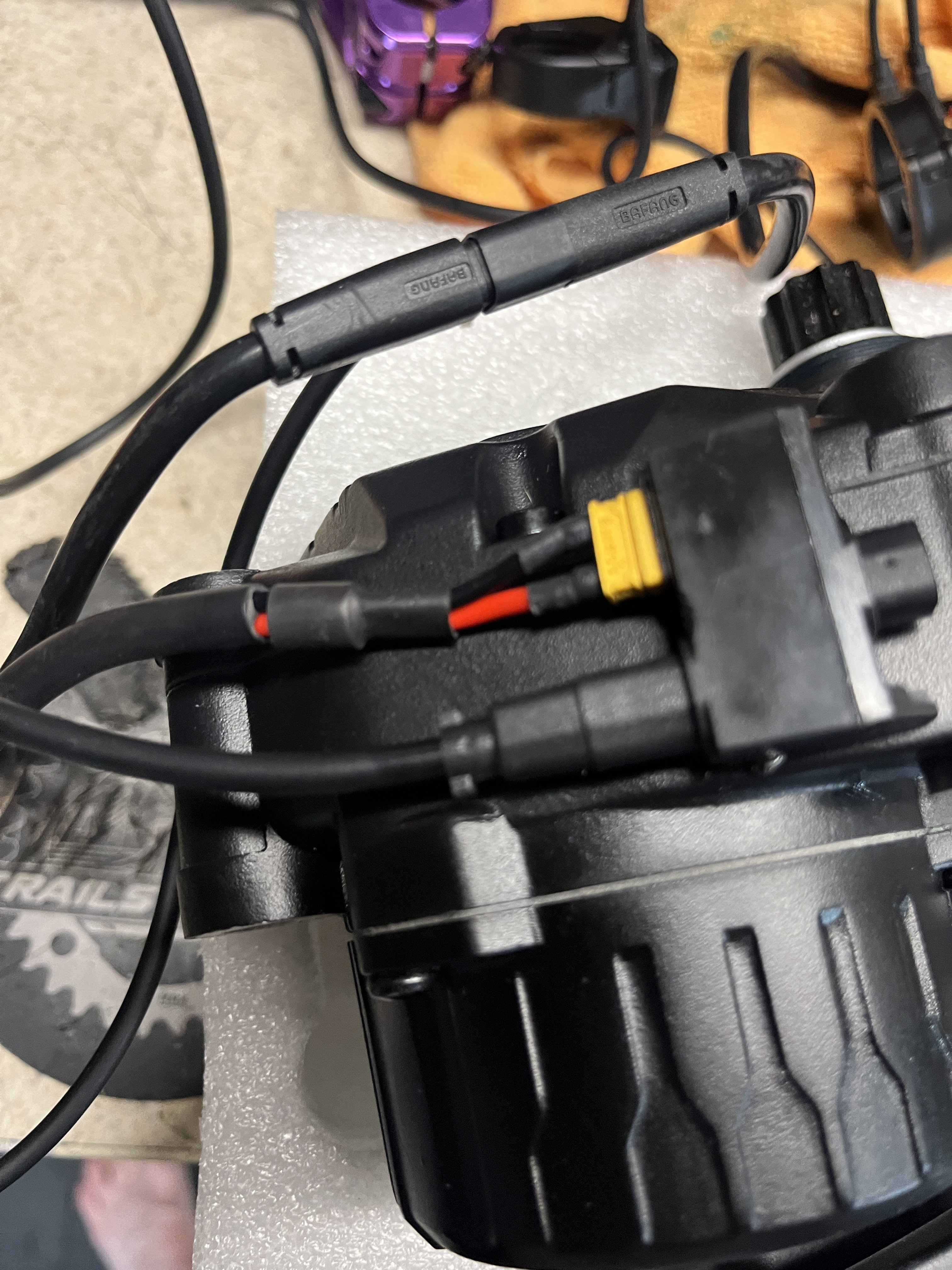

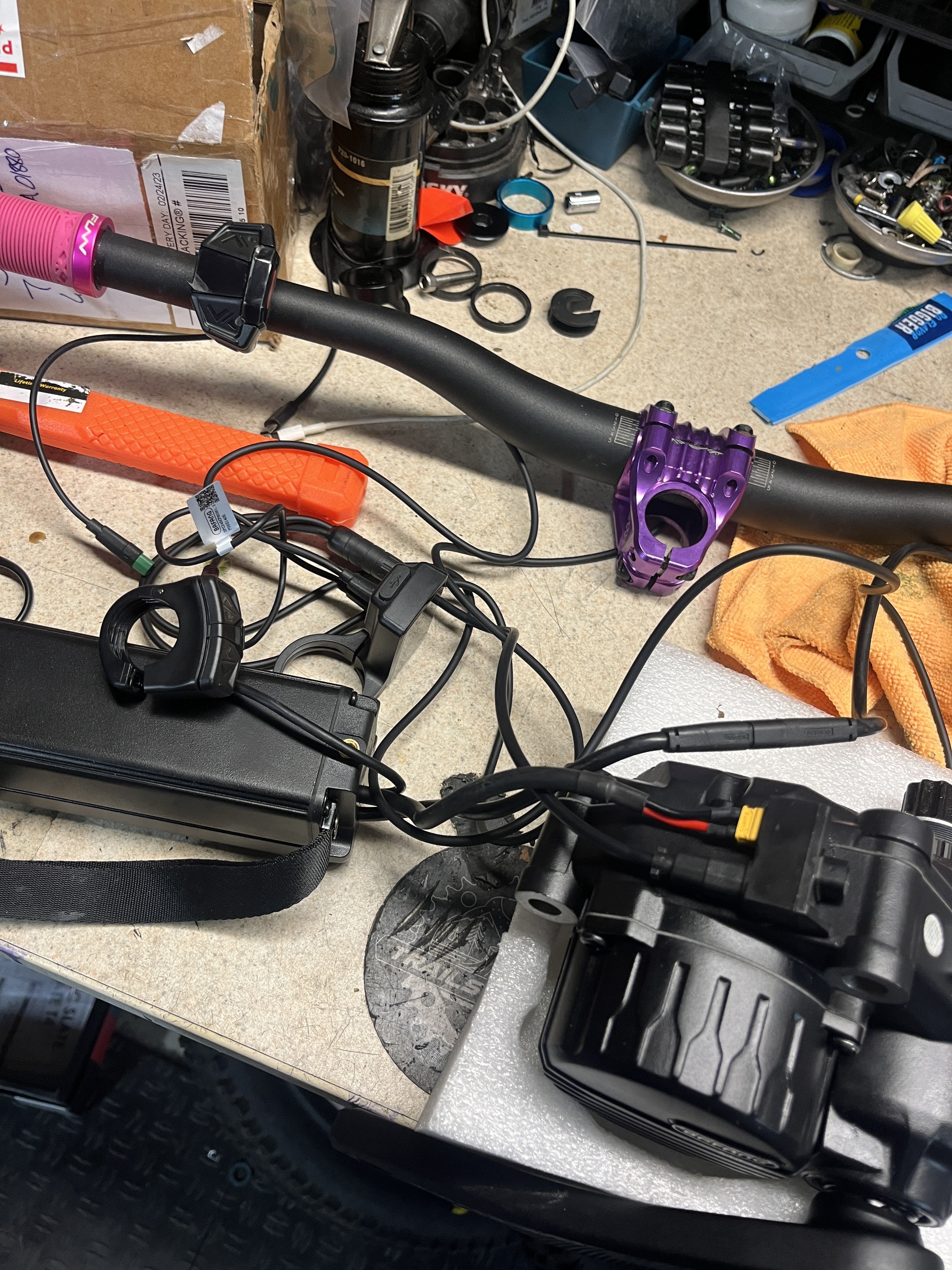

Can't seem to get power to my display. I have a second display and that won't power up either, so I don't think the issue is with the display. Battery is fully charged and I have a brand new main cables setup. What should I be doing to troubleshoot my issue? I don't want to install everything back into the frame until I know it's working. All cables are securely connected.
Thanks

Have you
a) Checked you have voltage at the motor
b) Connect the display you have mounted on the handle bars directly the cable going to the motor, hold the start switch under the the up / down toggles for a few seconds as it takes a while to start up.

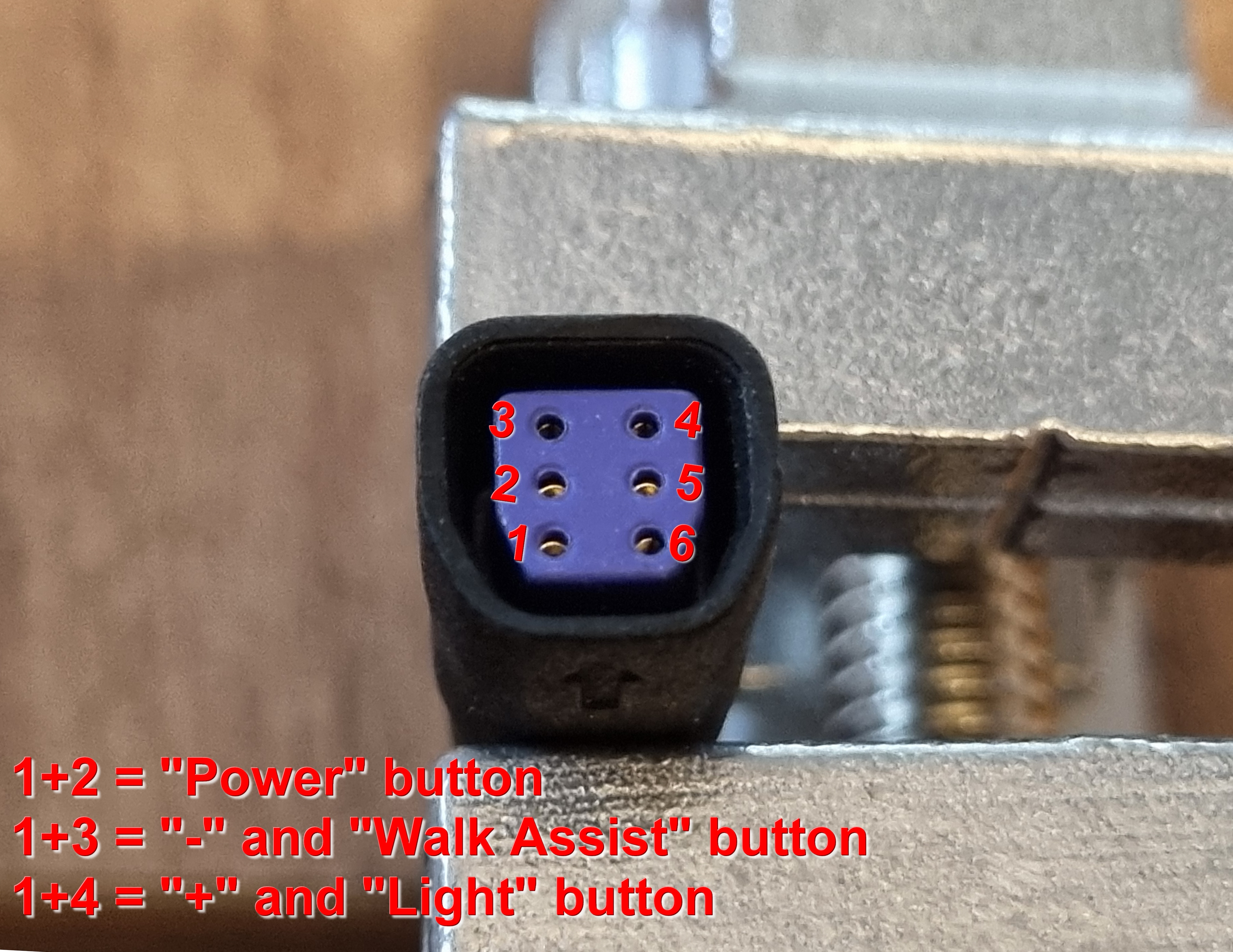

Disconnect the battery from the engine, reconnect it and then check if the display starts. If it starts the first time and then doesn't start the next time, the engine controller is most likely damaged.
===edit===
Also try disconnecting the buttons from the display and reconnecting it - does it start? try bending the pins in the plug. Try shorting the pins responsible for "POWER" directly at the display for 3 seconds.
If you have BESST TOOL, does it read the SN numbers of the controller and display?

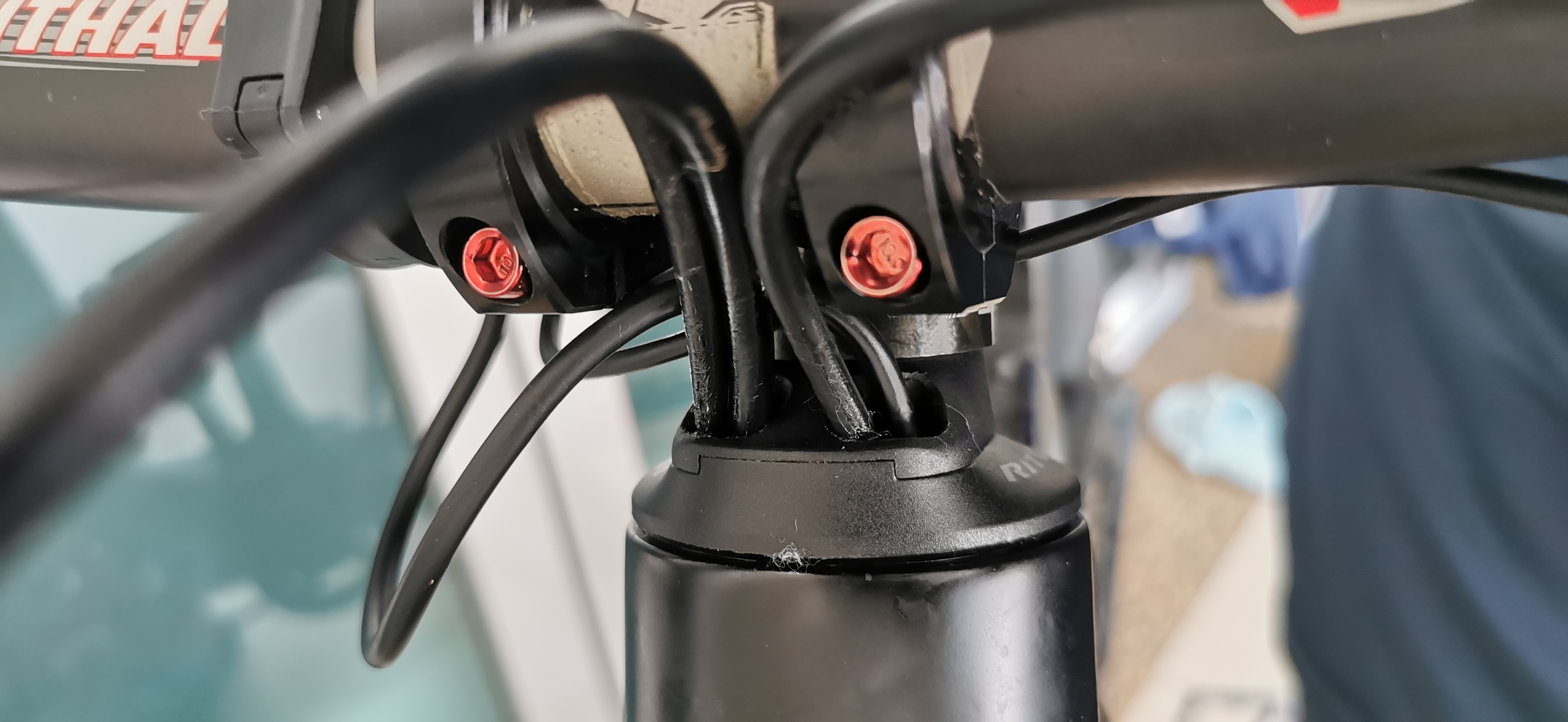

Anyone else very frustrated with the headset cable routing? I had a hell of a time getting all to fit (dropper, brake, electronics etc) and it seems to be chewing the hell out of the stuff that is routed in it. Does anyone have a step by step or instructions on the right way to do this? The opening in mine ends up being to one side....is this normal?
RobbyC
Aug 21, 2024
9
Malaysia

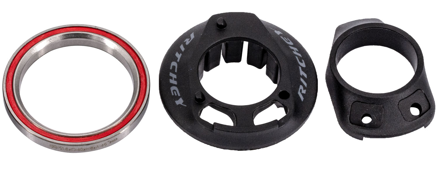

Yeah, my shifter housing got chewed up before I even finished setting up the bike, those integrated cable routing headset is such a pain to setup.
My advice, setup the dropper post first, hook it up with the lever and make sure it's working before inserting it into seat tube. I ran into some cable issue whereby the dropper post would inadvertently drops whenever I steer to one side, that was right after I mounted the motor and crank, and I have to redo all over again. Later on I discovered that cables need to have enough room to wiggle otherwise it would get yanked by the headset. Having said that, I have switched to Ritchey Upper Logic-E Comp headset, which I find it a little easier to setup.
One more tip to facilitate mounting the motor, you may ran into clearance issue when trying to mount up motor especially If the cables are too cluttered up. My trick was to group the cables into 2 bundles with string and hold them against the side wall to allow more room for the motor to slide in. Once the motor is lined up with the axles, I just undo and remove the strings
It was very frustrating. I haven't wanted to open mine up again to inspect the cables/wiring knowing how painful it could be to get it back together. Once the riding season is over I will though.
I filed down and smoothed out the square edges at the bottom of the headset where the cables enter to reduce the chance of damage, time will tell if it helped.
