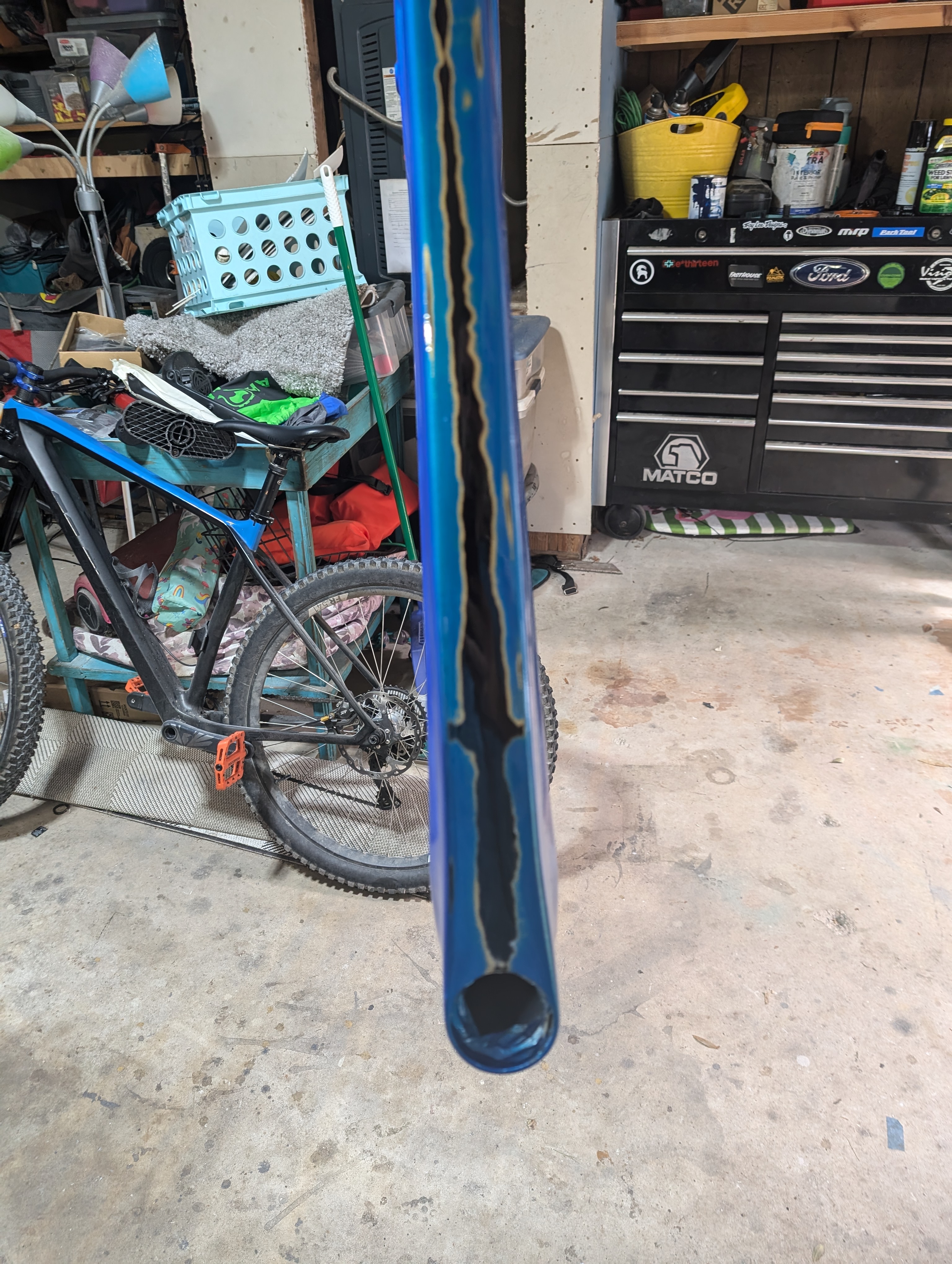

I am in the process of assembling the frame.. waiting on the battery still.
Overall quality is pretty good compared to other chiner frames I've worked on.
- Finish is good.
- It didn't take much sanding to get a good paint surface.
- Seat clamp actually works.
Only few negative things I've found.
- Suspension linkage seems to be cast and pretty heavy. I really don't mind and probably saves money.
- One of the chainstay bolts is a 5mm vs a 6mm.. Kinda weird
- The shifter cable routing is pretty bad. It hangs out off the bike pretty far. Def designed with wireless in mind.
- The headset is complete garbage. The bearings are the typical chiner one. The seals fall off if you touch them. It takes quit of bit of torque to remove all the play out of the headset.
- Replaced with ACB 4545 4252 SS - 1-1/2 inch stainless steel Angular Contact Headset Bearing (42mm x 52mm x 7mm; 45 x 45deg)
- I will upgrade the headset top cup at some point. Not many options out there yet.

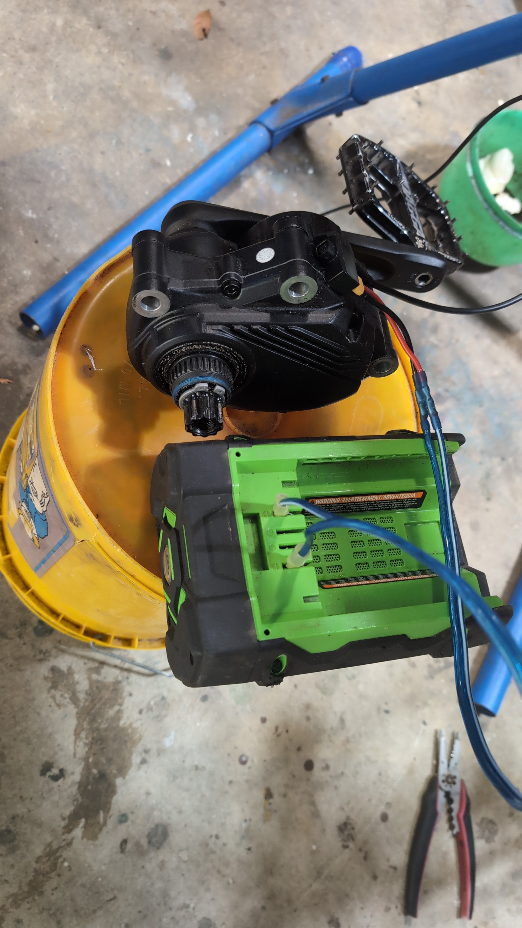

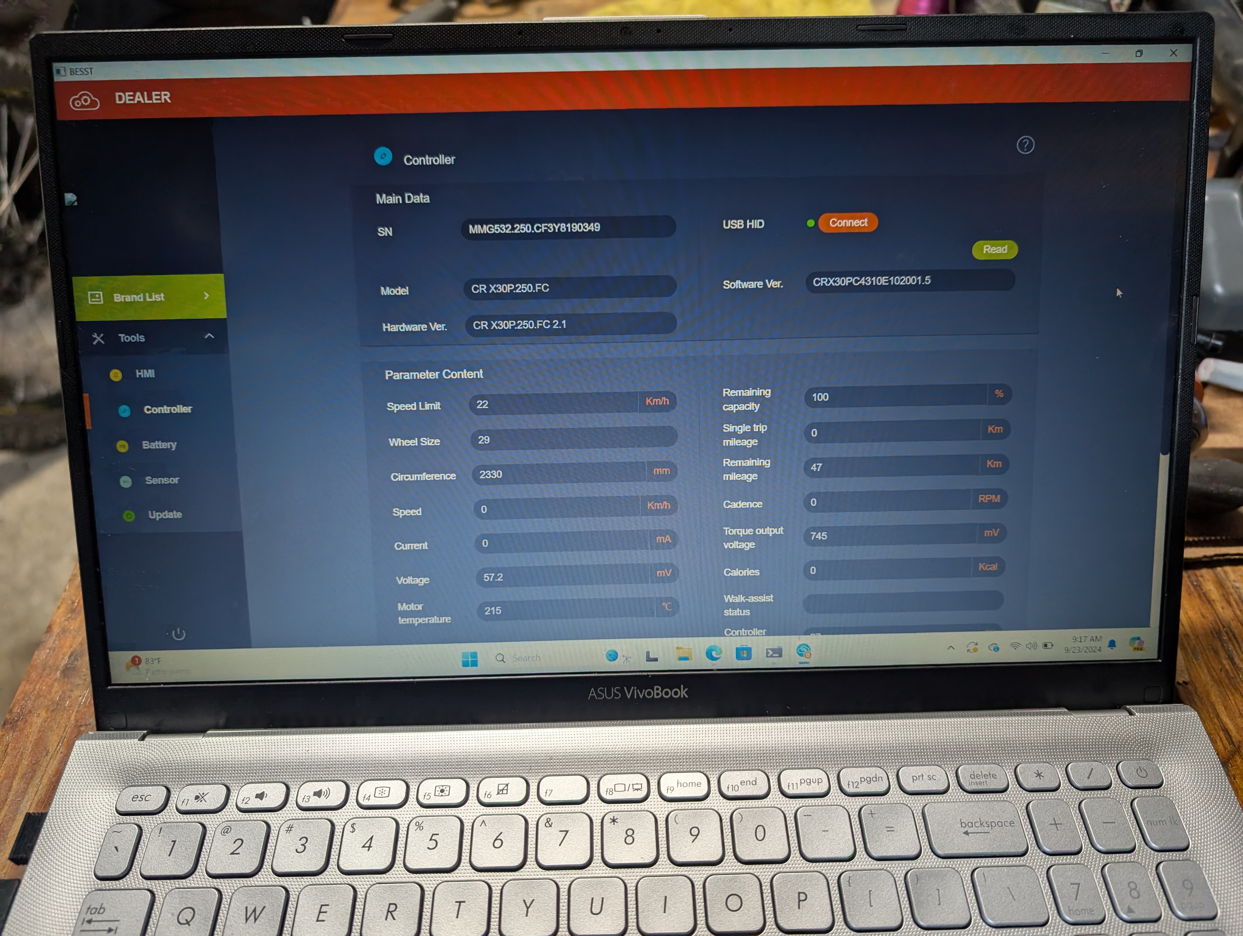

I know I read this somewhere, but I can't find it. I'm trying to write the speedlimit but it gives a prompt at the top.. can't change.. please set back.. doesn't write
If you mean that in Besst tool you are trying to change the speedlimit over 25km/h, you can't. You can download an old version of besst from github and use that, there are no restrictions in the old versions. It will prompt you to update to new version, so don't do that if you want to keep old version.
That's what I figured. I saw someone do it with ver .20.. so gonna try that. I just don't want to ghetto rig the motor to my golf cart battery again. Still waiting on the battery

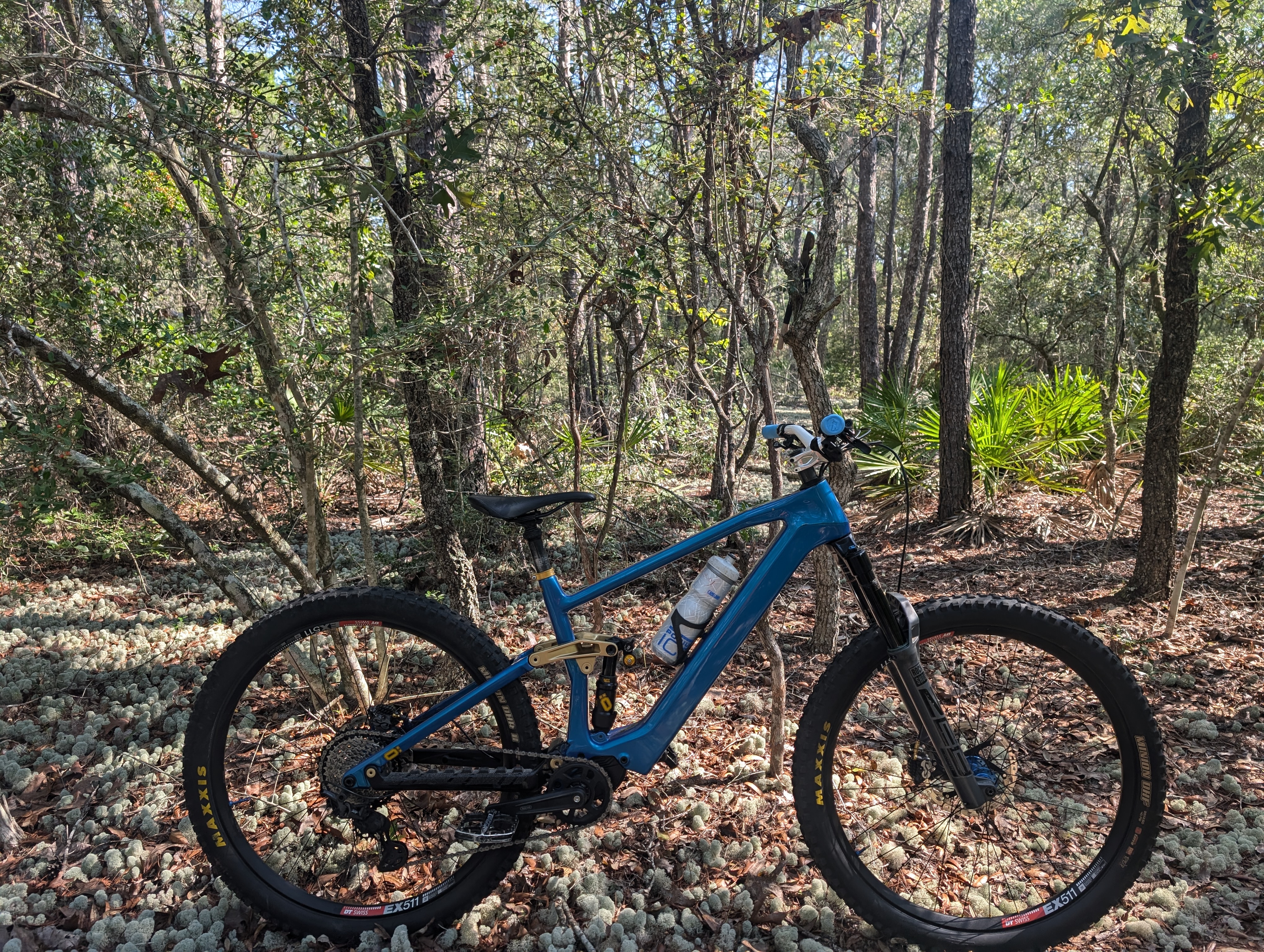

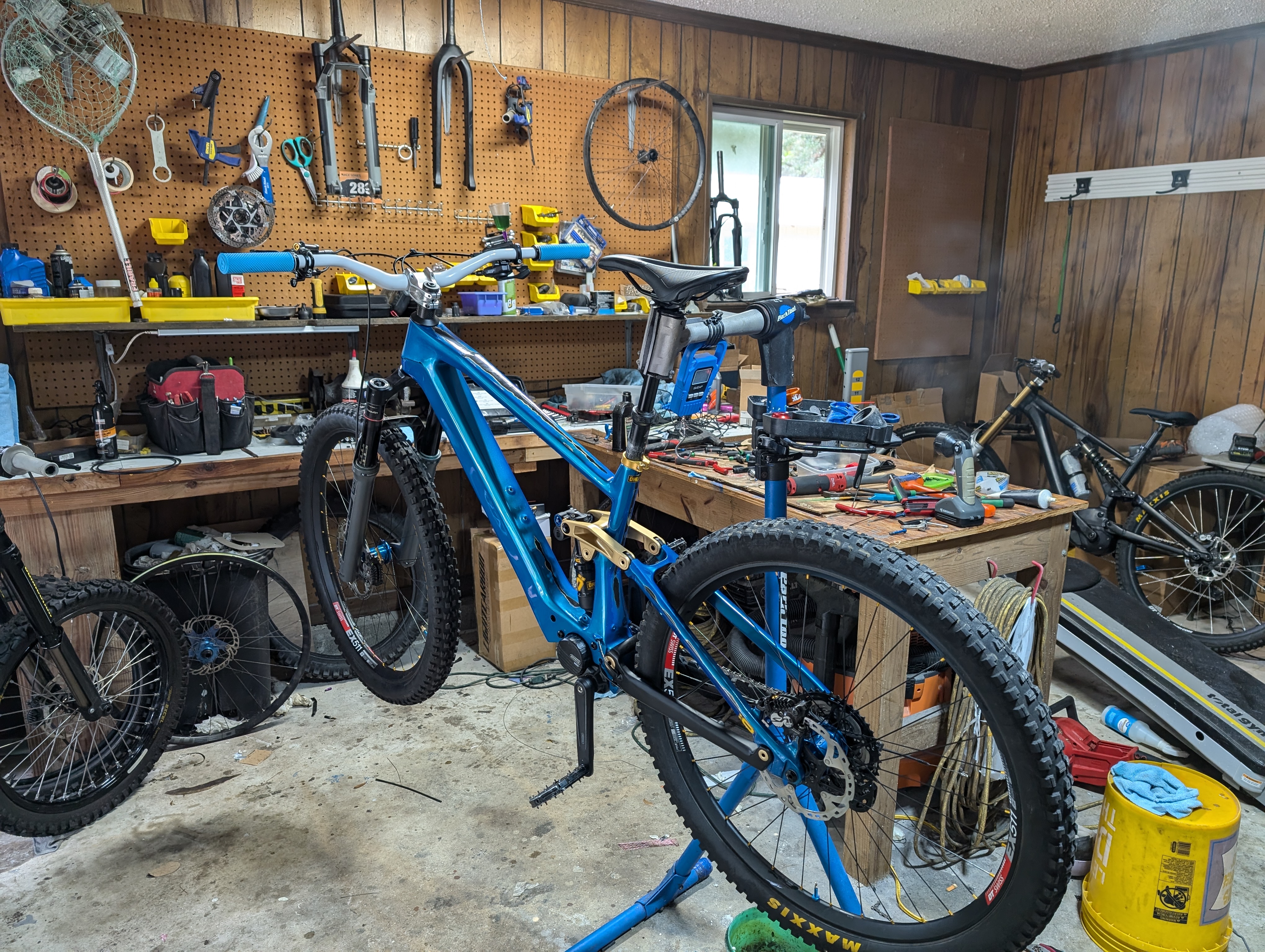

It's pretty much done. Been riding with no battery for a bit while I wait. 38lbs with no battery.
PXL_20240919_150349977.jpg PXL_20240828_210202224.MP.jpg PXL_20240828_210103416.jpg PXL_20240916_182856310.MP.jpg

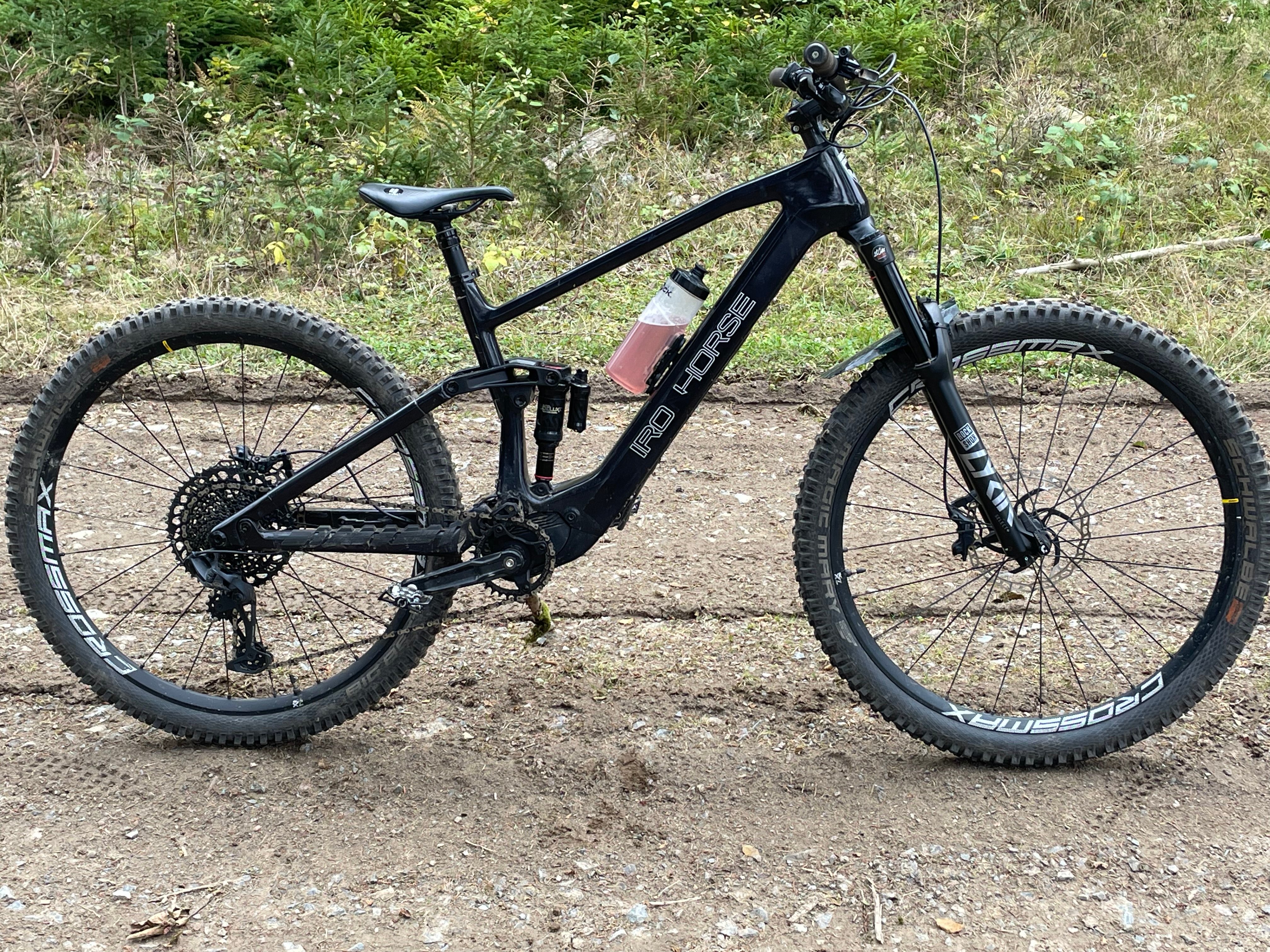

Hi
my feedback after removed my mullet wheel set
I put a crossmax xl 29" wheel set with schwalbe magic merry and big betty, I upgrade my 150mm fork to 160mm.
- 29" is faster than mullet on climbing or on downhill, I need to adapt my braling point on fast moment :)
- I have a better center position with 29"
- mullet turn more easier than 29", my head tube angle is less slacker now and I need time to find flow when I turn
In fact 29" is better, good balance to have good bike to climb and more racer bike on downhill
