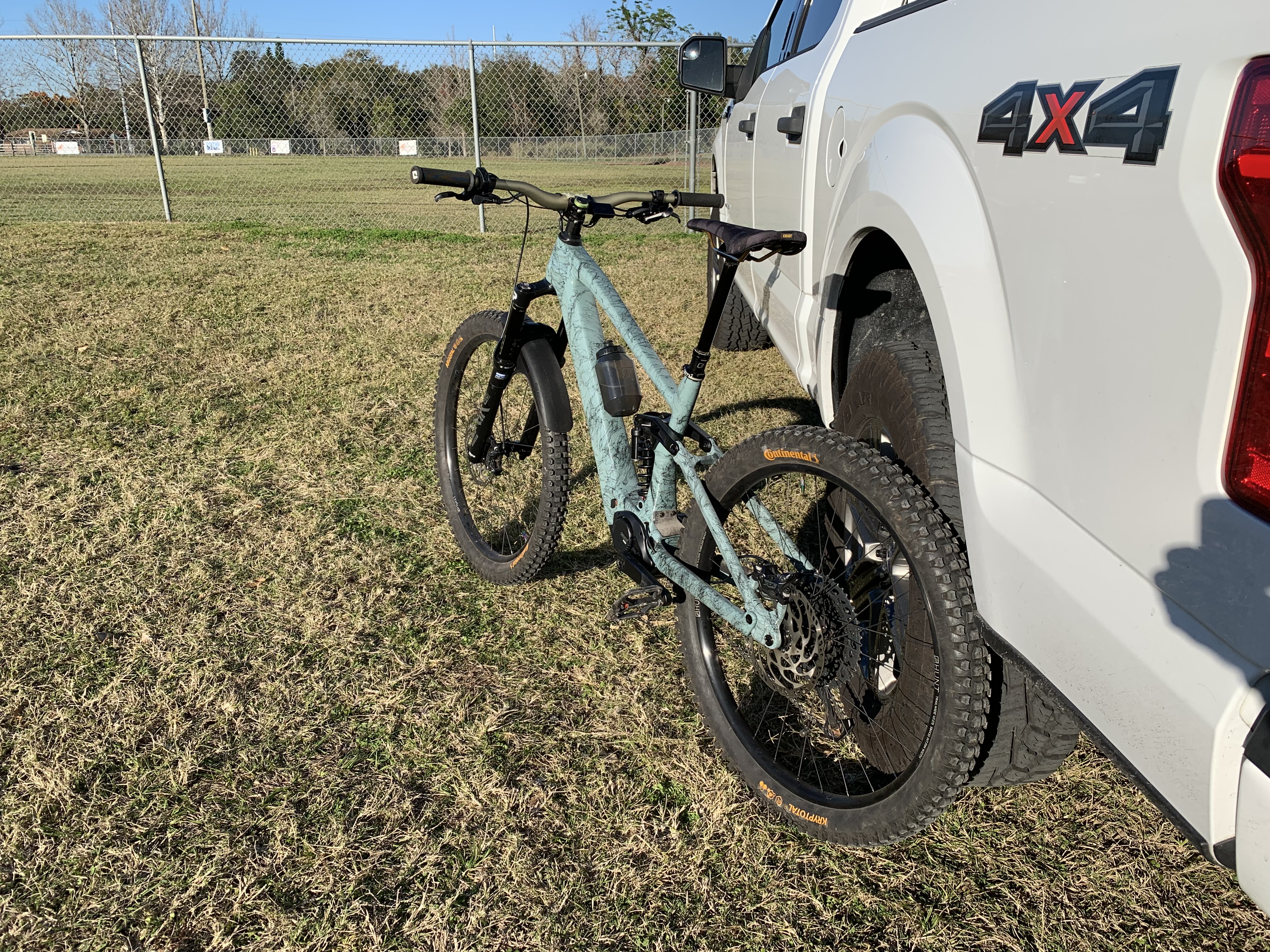

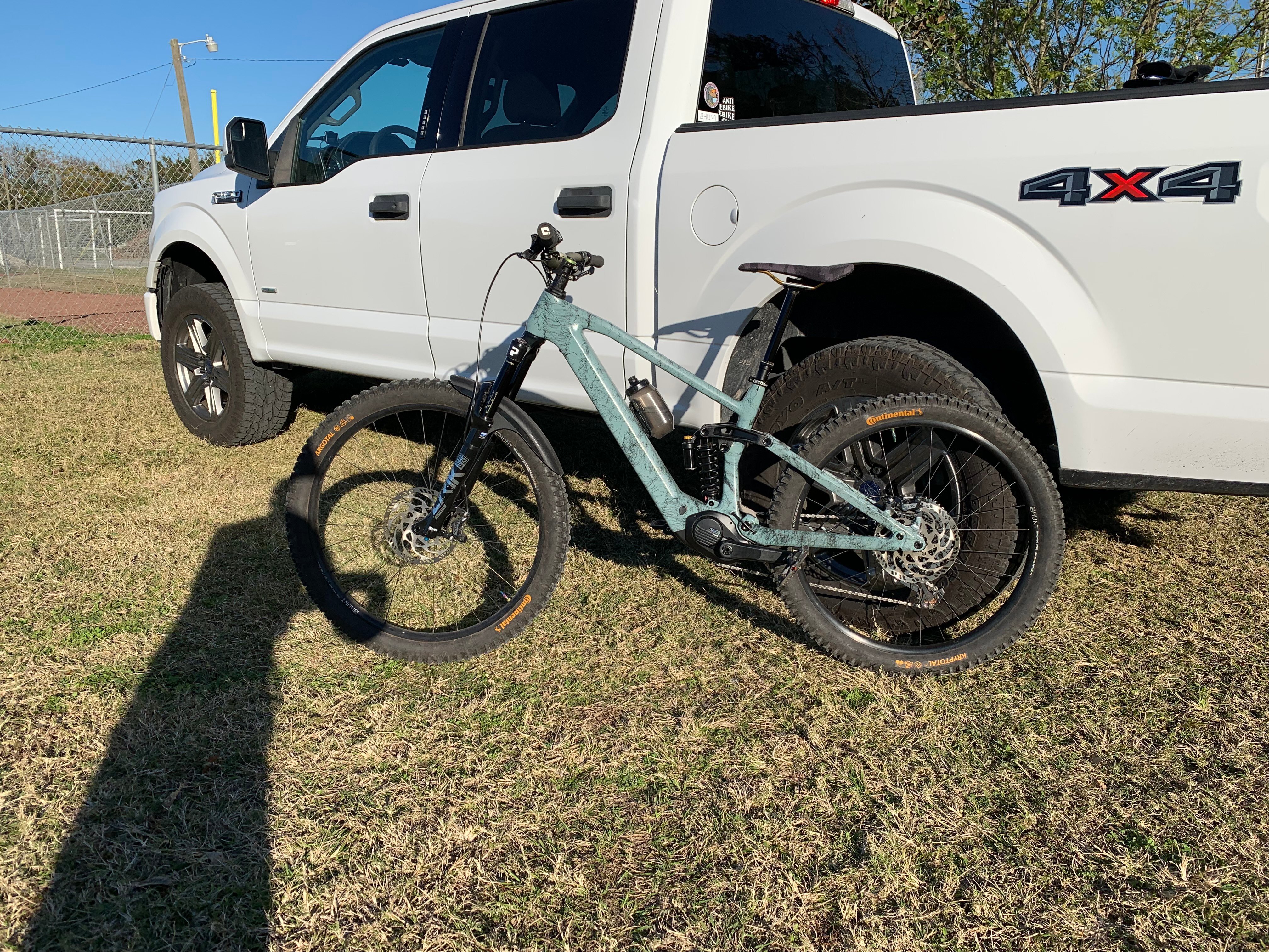

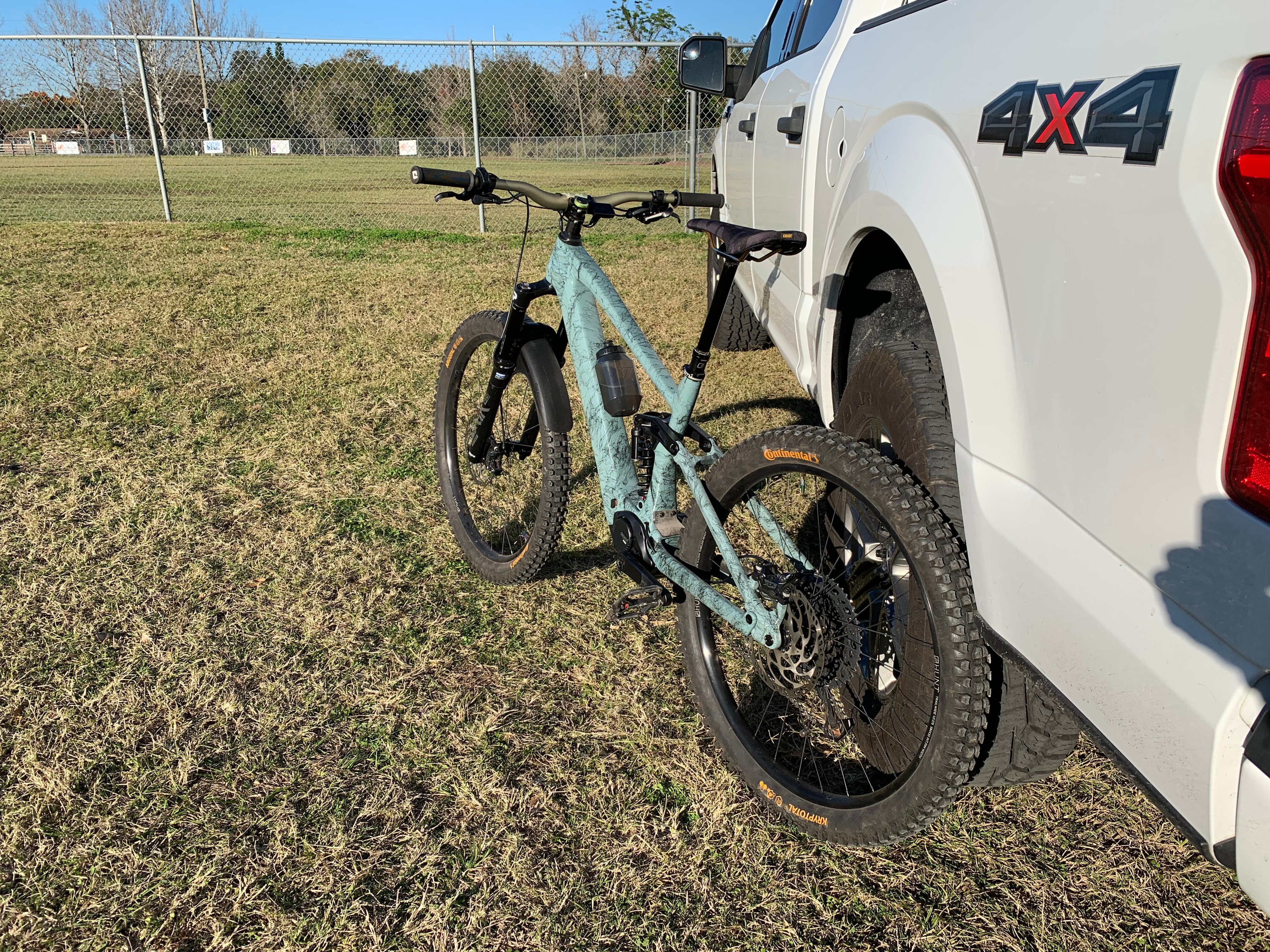

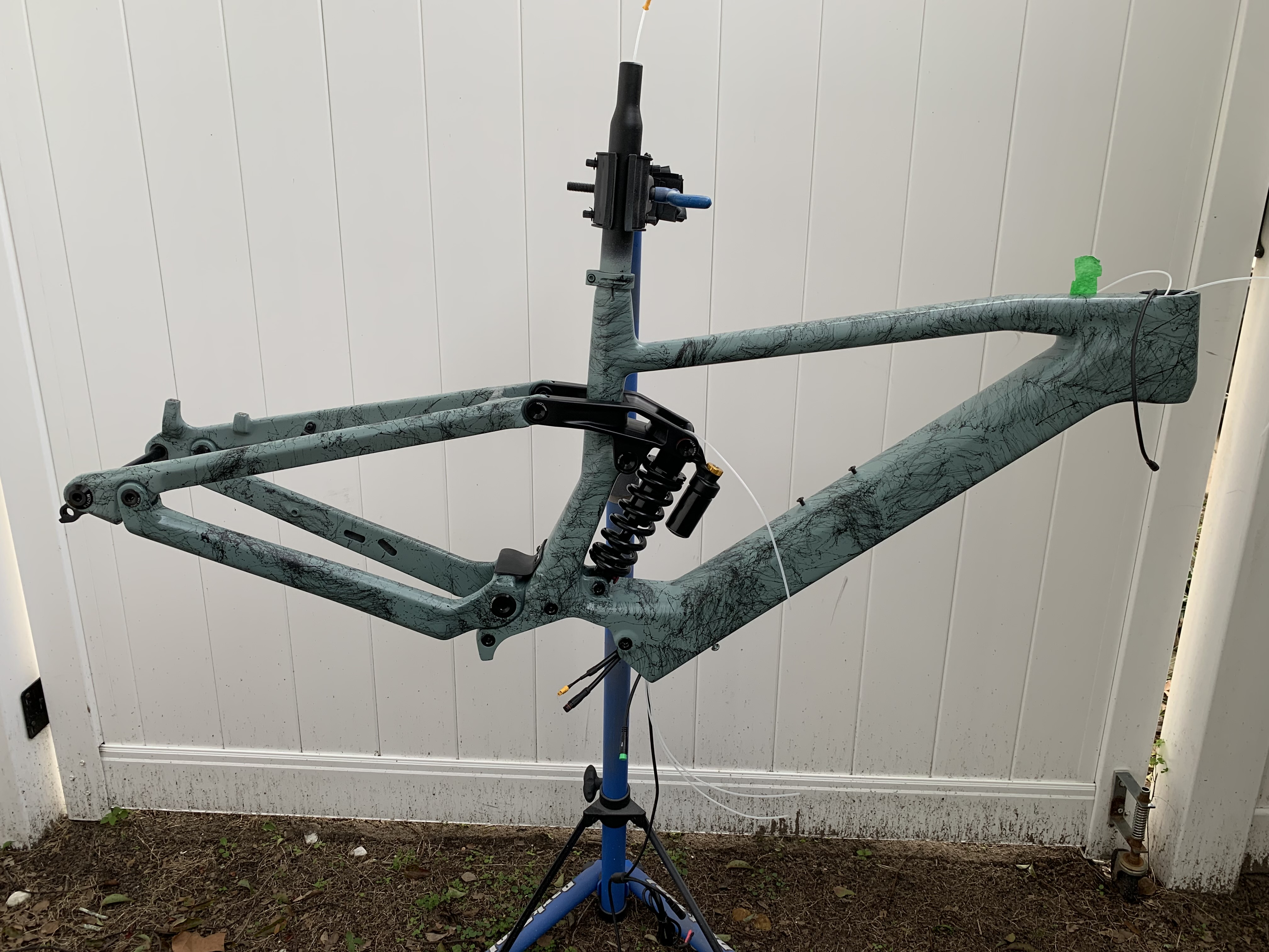

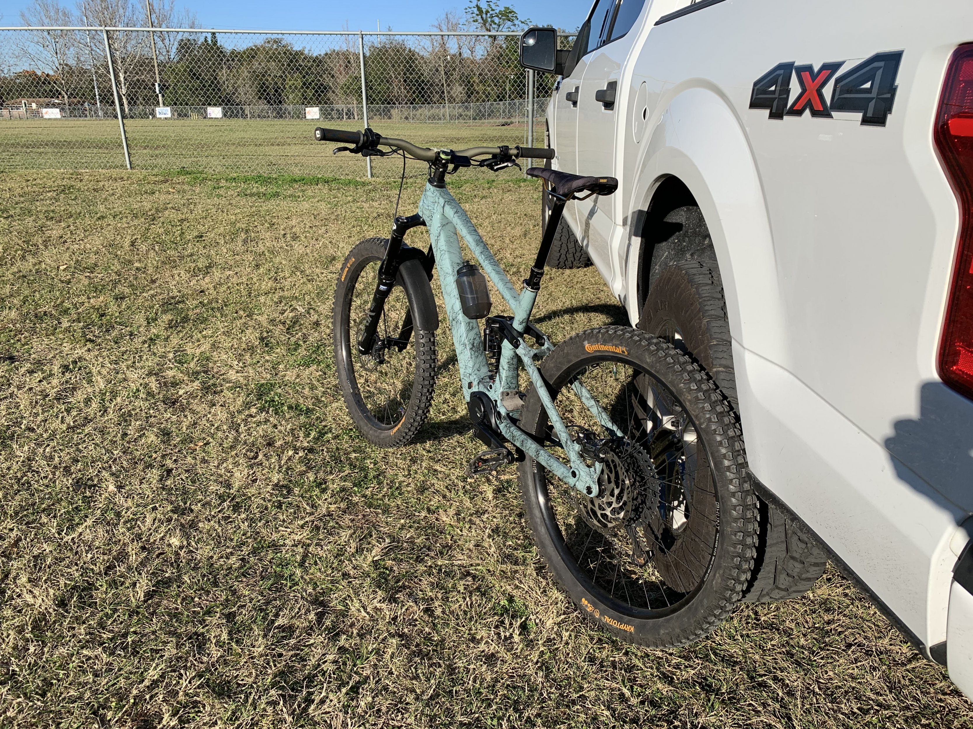

Finally built up/first ride photos. Had a great first ride, motor has some characteristics I need to get used to coming from an EP800 bike. That bike was about 53lbs, so this thing is a lot more manageable. Need to get a final weight still.

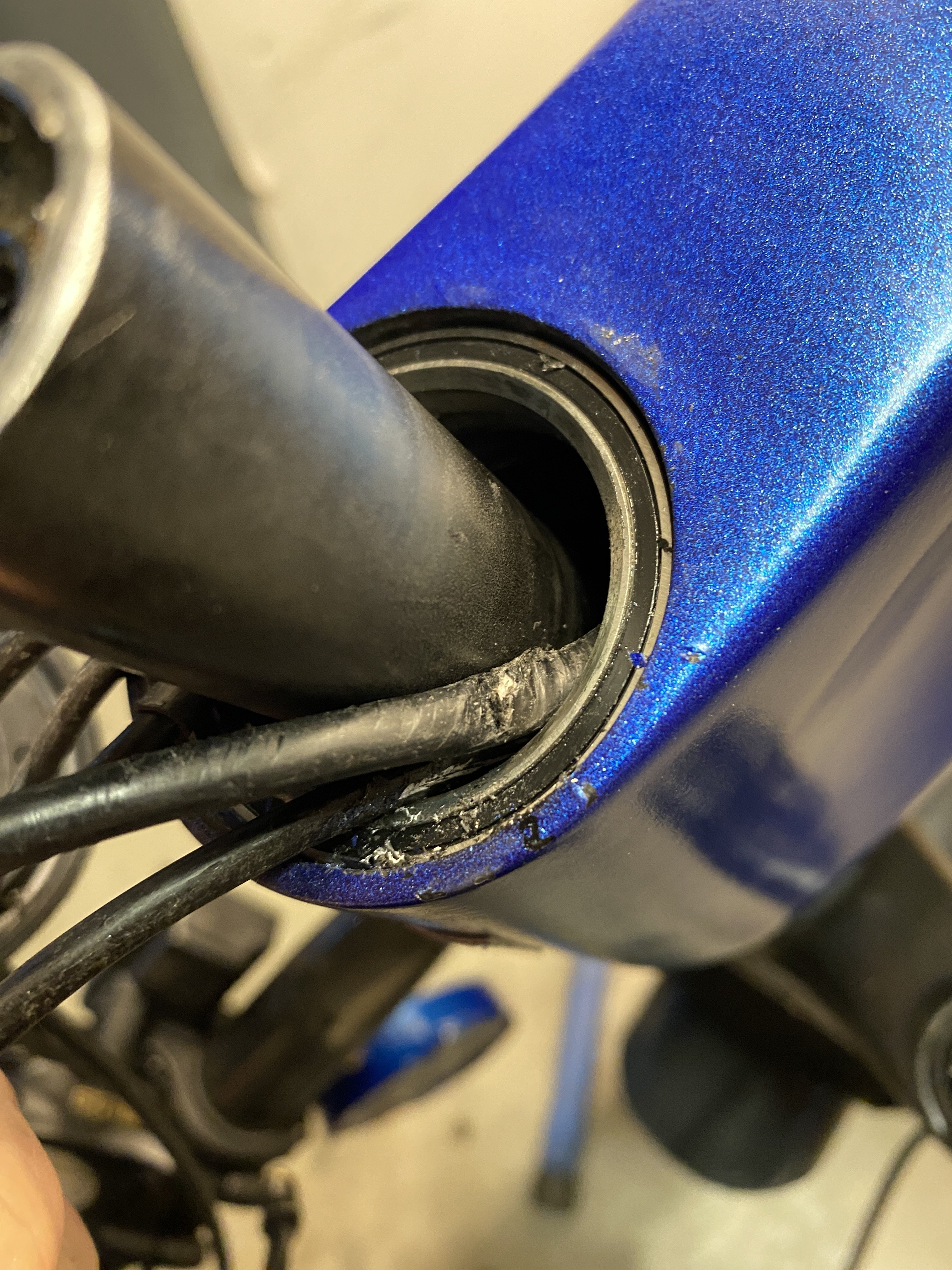

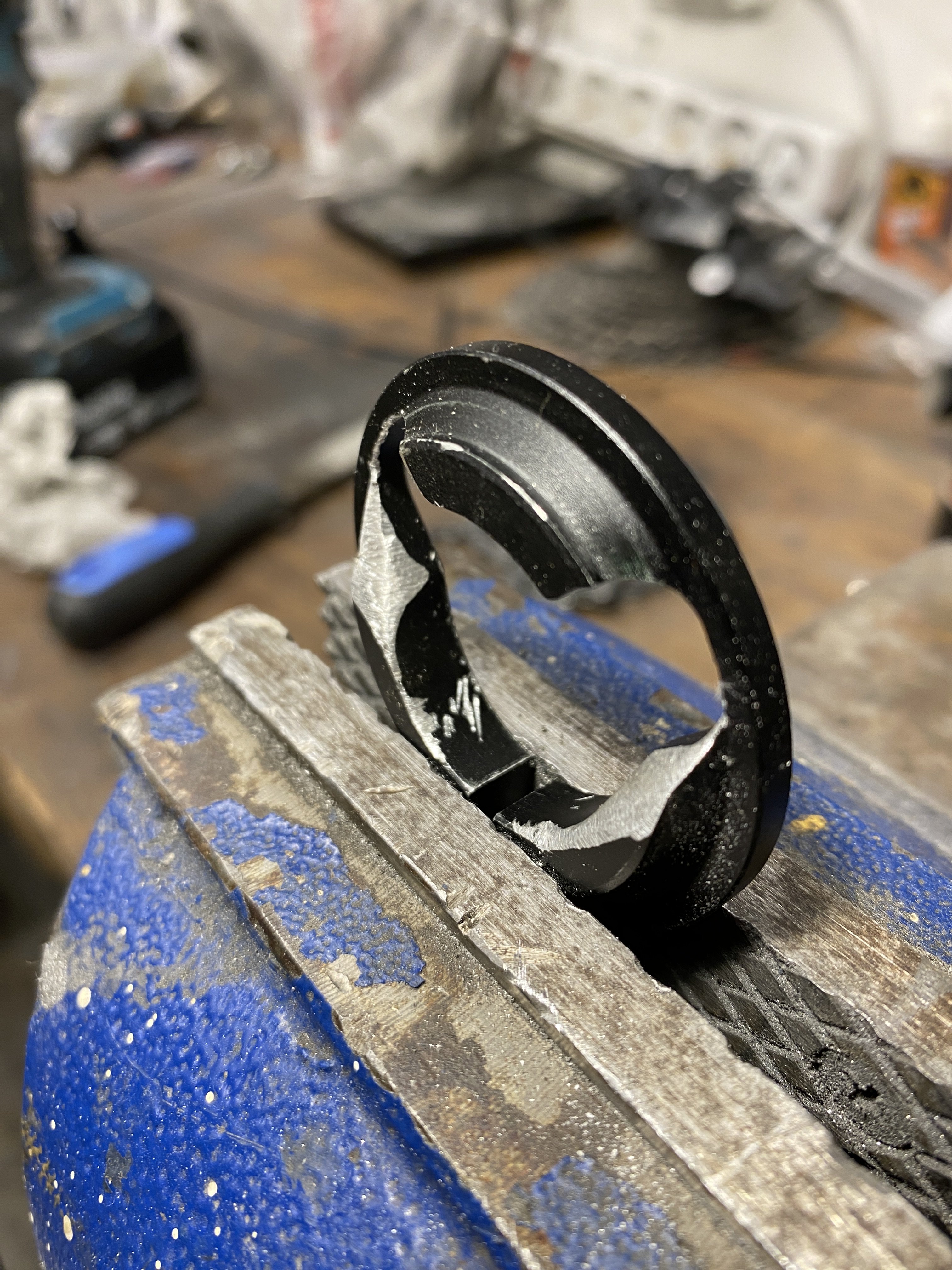

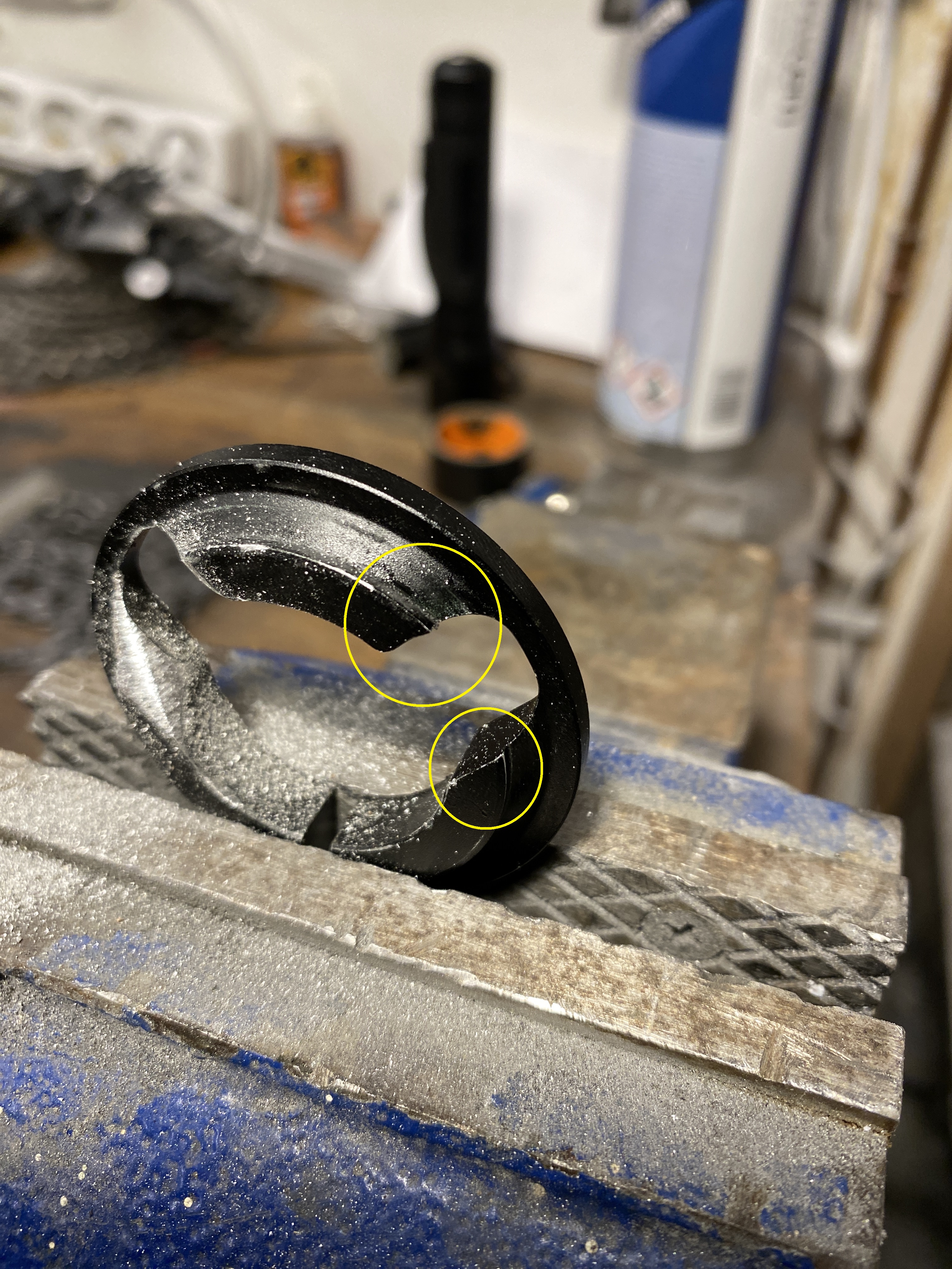

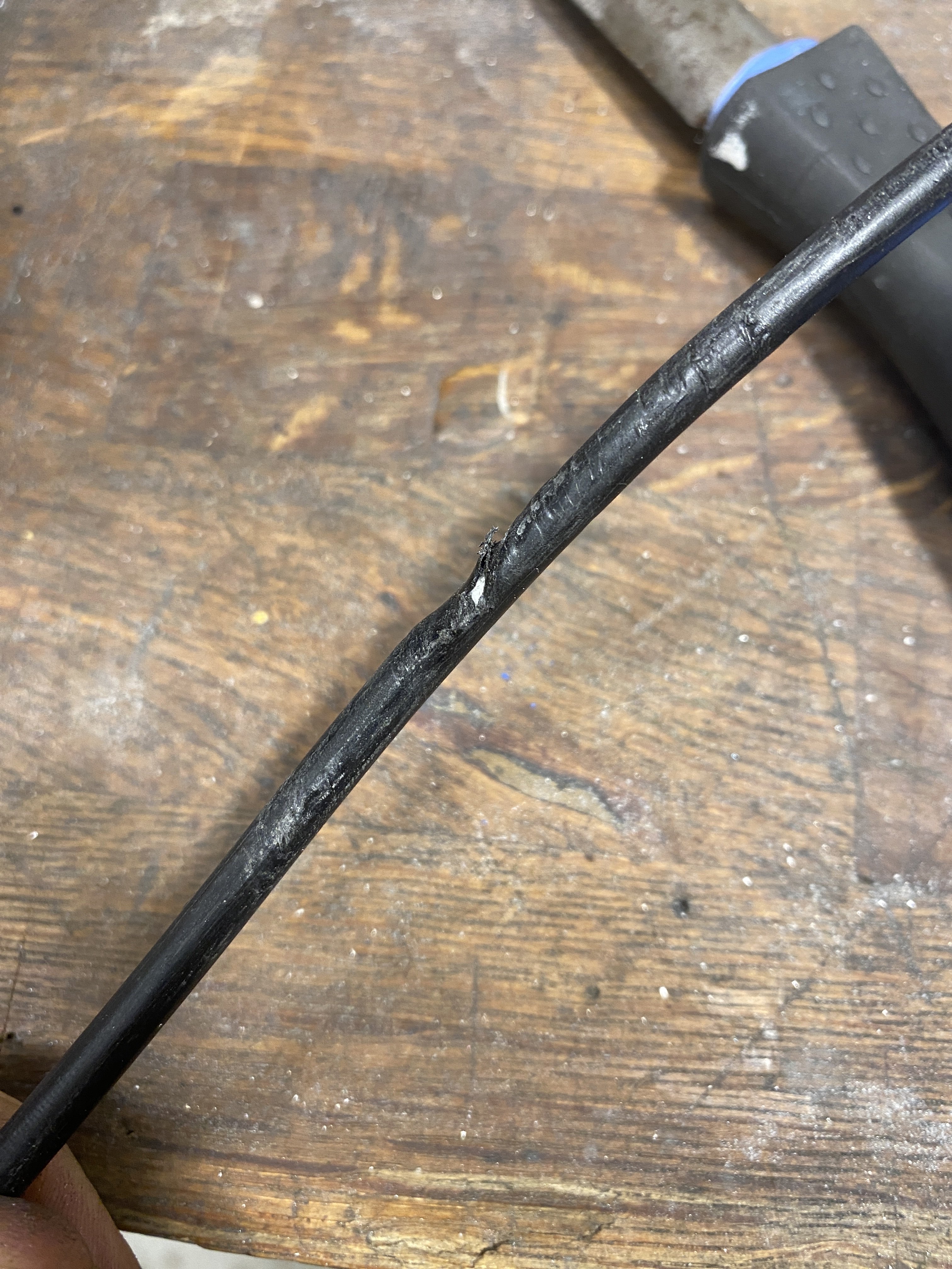

So while changing brakes I noticed what others have mentioned here also. The headset is wearing down the cables and hoses very quickly.
This is my brake hose:
So I should probably get a different model, but for now I sanded down the sharp edges and hope for the best:
Damn! You could probably also add some heat shrink to the cables/hoses near that location. I intend to pull mine apart to sort some routing issues I wasn't happy with. Good think on the clean up of the upper wedge.

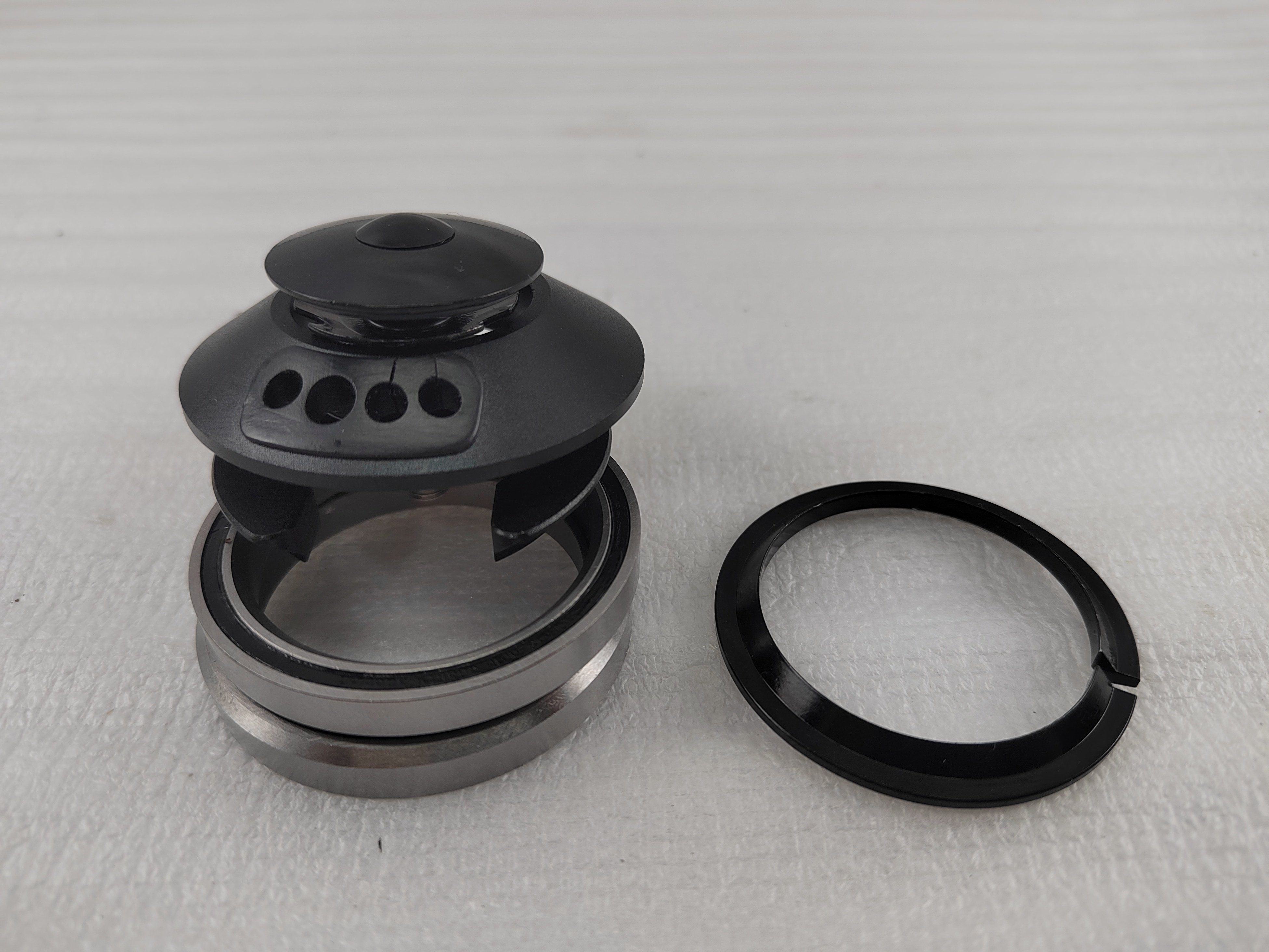

The headset is designed so you have cables straight through, but in reality they are at an angle leaning against the sharp edges. So when turning the handlebar it is chewing really bad into the cables.
sandnap
Dec 23, 2023
130
128
Herriman, UT USA
Thanks for the information and pictures. I will be taking measures to prevent this now too. A slice in a brake line wouldn't be fun 😬.
