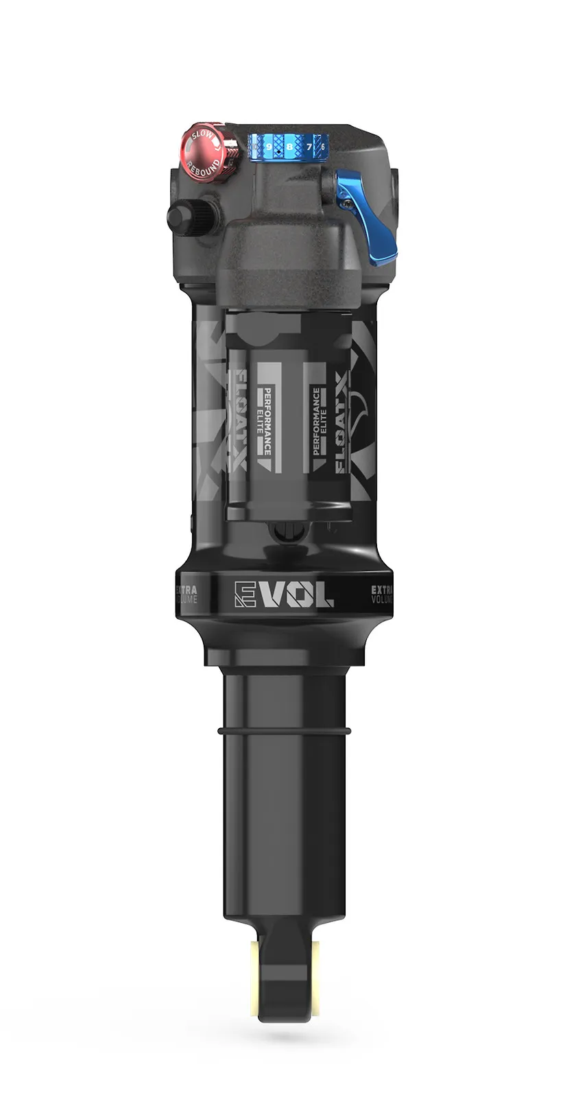

Hi all! I have an LCE930 frame on the way and have a 2023 Fox Float X Performance shock 185mm x 55mm. Will this work on this frame and if so will I need additional hardware? This will be the first shock that I have installed with the threaded mount holes on the shock body side.
The width at the upper mounts is 54mm and the depth of the threaded mount holes is 10mm. It doesn't have the bolts that were from the original bike.

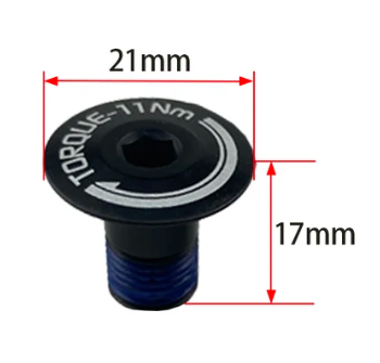

Based on the pivot bearing size (21x12x5) I am thinking that if the frame doesn't come with them I will need m10 pivot bolts that are 21x17 with a 2mm spacer as shown below.
Any guidance would be deeply appreciated! I look forward to the build which I will document carefully, post here, and upload to my YT channel.
the shock is fit for the frame, bolts for top and bottm on the frame, but you need get the bushing kits M8 x 22.2mm for bottom,
