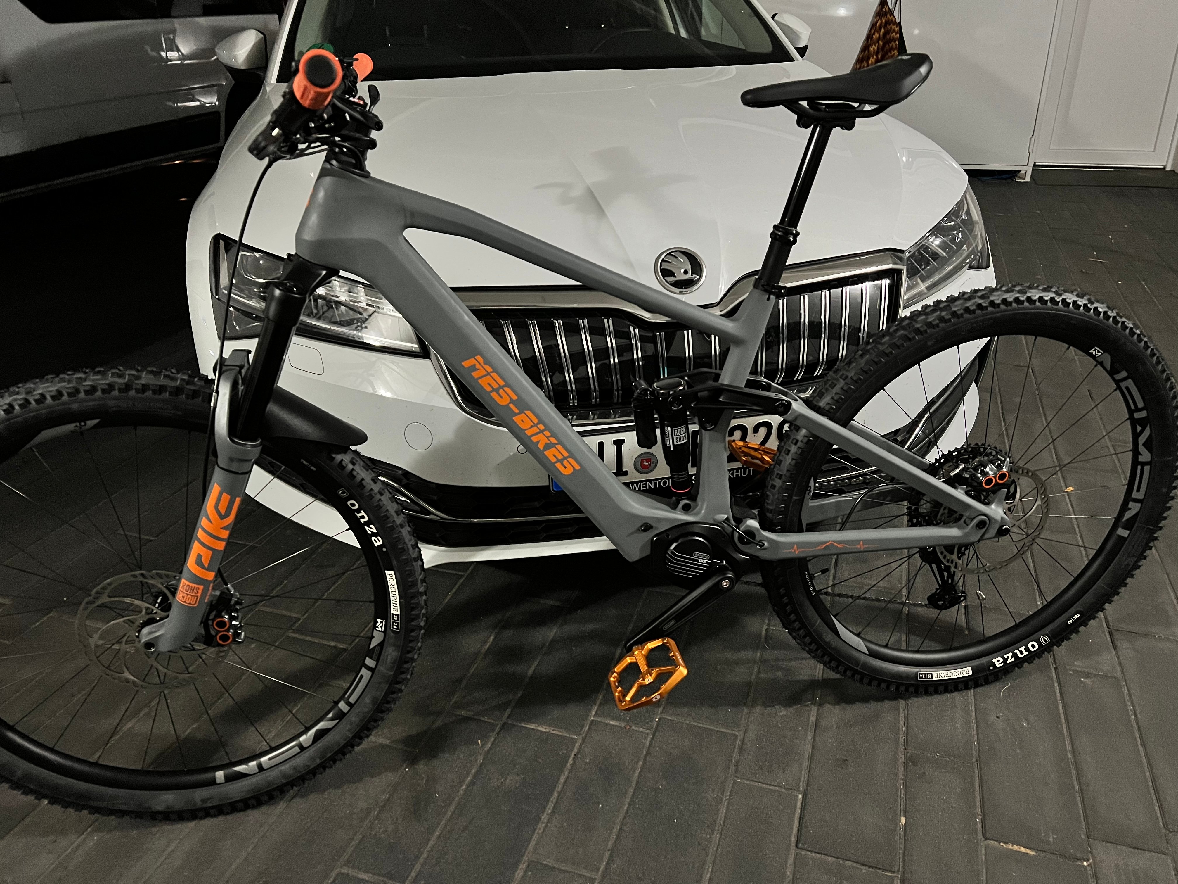

Finally got my battery and missing pieces from my original order and finished my bike this weekend. Lightcarbon wheels, 27.5/29. Specialized purgatory 2.3 tires. Manitou Mara inline shock and Mattoc pro fork. Hope Tech4 E4 brakes with 203mm Shimano MT900 rotors. She weighed in right at 18kg. I think I can decase the bafang battery and save around 0.5kg.. we'll see. Here she is!!
Went for a short 8 mile road ride today up the coast. Used all the modes. Consumed 27% battery. My thoughts... The bike feels plenty powerful. Almost like my specialized turbo levo, but sooooo much lighter! I really like the 245 color display, it's easy to use and easy to see, and just feels modern. The motor did get noticably warm after a decent climb in boost mode. It definitely rattles when not pedaling. The motor is louder than my levo, but not much louder (maybe 15% louder?). One thing I did not like, the motor keeps running when I stop pedaling. At times it does this for over a second. This feels dangerous... my levo definitely does not do this. Is there any way to change this?
Overall very happy with the bike. Can't wait to get out it on a trail!

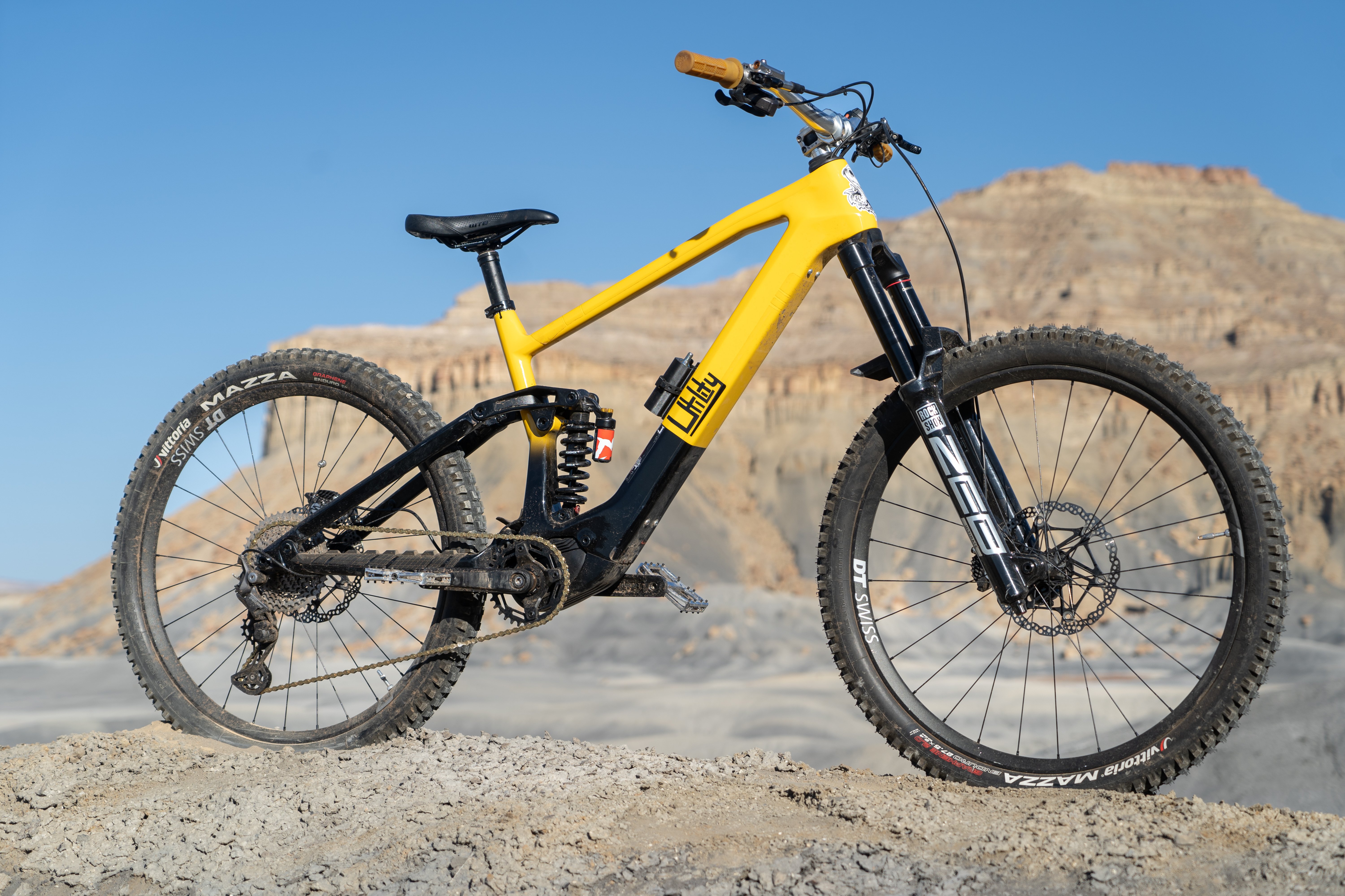

The bike is a dream, 27.5 front and back, 150/180 travel, 155mm cranks, 50mm rise bar, 10 speed (10-42). Moto-inspired Build.

Feels good with the coil, oversprung it a bit, around 25% sag. I'll give it a final weight soon, should be around 45lb. Was not weight-conscious with the build.

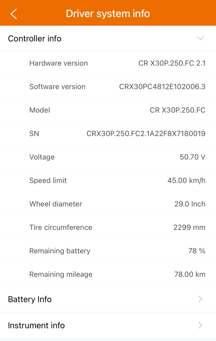

If you have good contact with bafang you should report to them that the GO+ app is "updating" all firmwares to 36V versions even if normally running 43V or 48V!
Bafang said:
M820 supports Bafang go+. It is a problem with the software version uploaded to the cloud by the Bafang go+ background. There is no bulk buyer feedback on this problem because they can have the newest version of software,
What is the hardware information and software information of your motor? tell me and I will send to bafang, they can upload a correct software to you alone.
I guess this is what you need.
