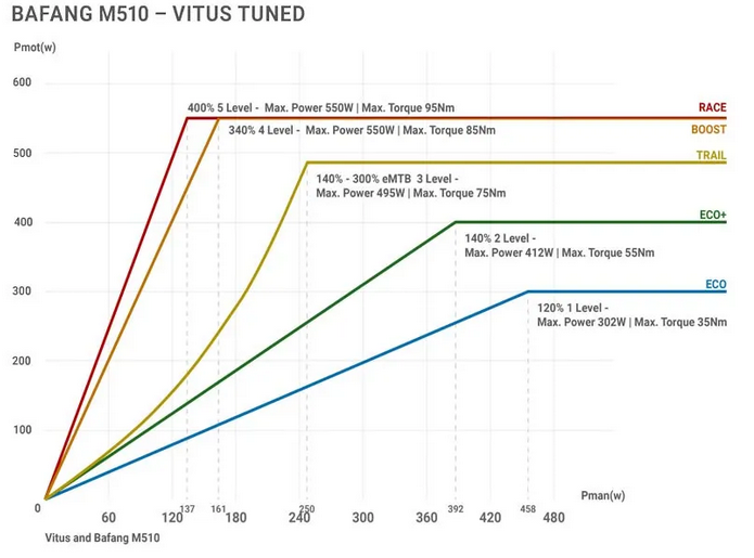

-ability to not only tune max current for each assist mode (in besst) but also how it is delivered.
For example, max current sets the max power(height of the curve), but it would be great, if we could also tune the slope of the curve:
But for now, my biggest complaints are the rattling and whiny noise going uphill.

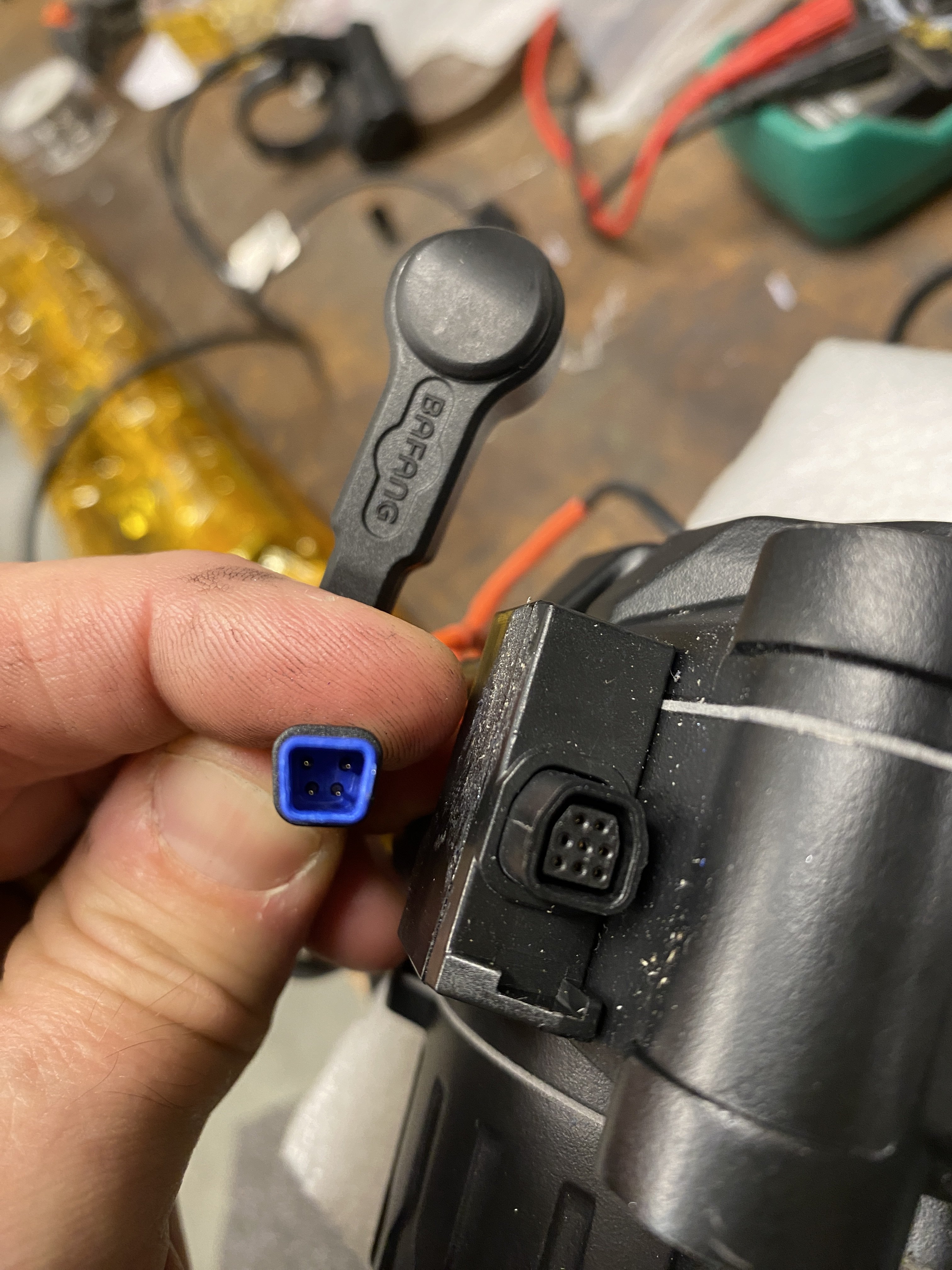

Hi again! I also bought from this seller. Now I tried to connect the motor, and everything seems fine but the speed sensor seems wrong. I got a four pin cable connection, but the motor has an eight pin connector for the speed sensor..
Can someone confirm what the correct speed sensor cable looks like?
There must still be an intermediate cable

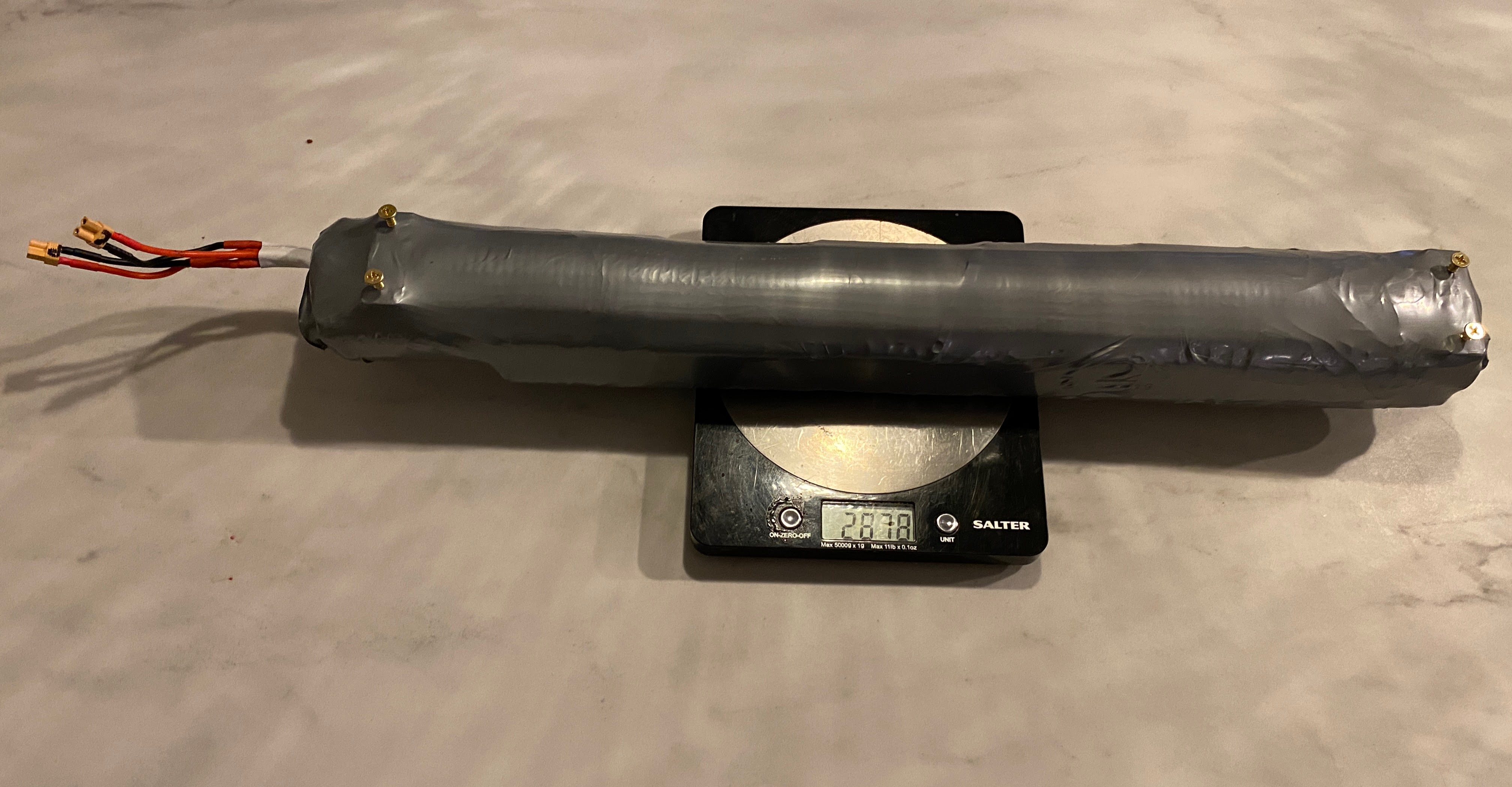

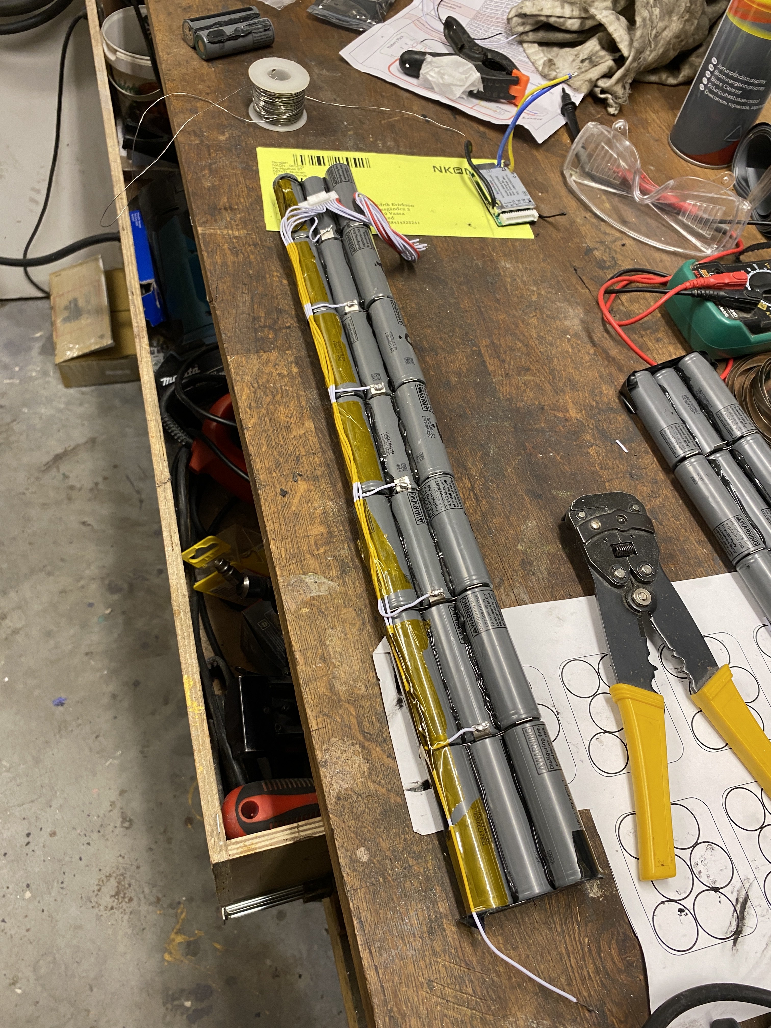

I finished the battery, 48V, 720Wh and 2878 gr according to my kitchen scale.
You make 48V battery, but if I am not wrong, the M820 engine comes as 36V or 43V with the LCE 930, right? Do you have your own BMS? How did you plan to connect it with 36/43V motor? Or it is enough to change the firmware to 48V? Thank you!

What material did you use to make the mounting plates?
I just cut out pieces from an old plastic cutting board. Then taped them to the batteries, put cellfoam between and finally shrinkwrap around it. I should have made them thinner because now I have very small space on top of the battery for cables.
The 43 V software only goes into surge protection at 55.9 V. So enough room for a 13S battery with 54.6 V end-of-charge voltage
I ordered motor-kit separetly, you can get it in either 36/43/48V from Risun Motor, price is now over 100€ higher! :oops:
I think you can flash any firmware with besst tool, motor is the same.
BMS is just standard 13S from aliexpress, BeMuchSafer

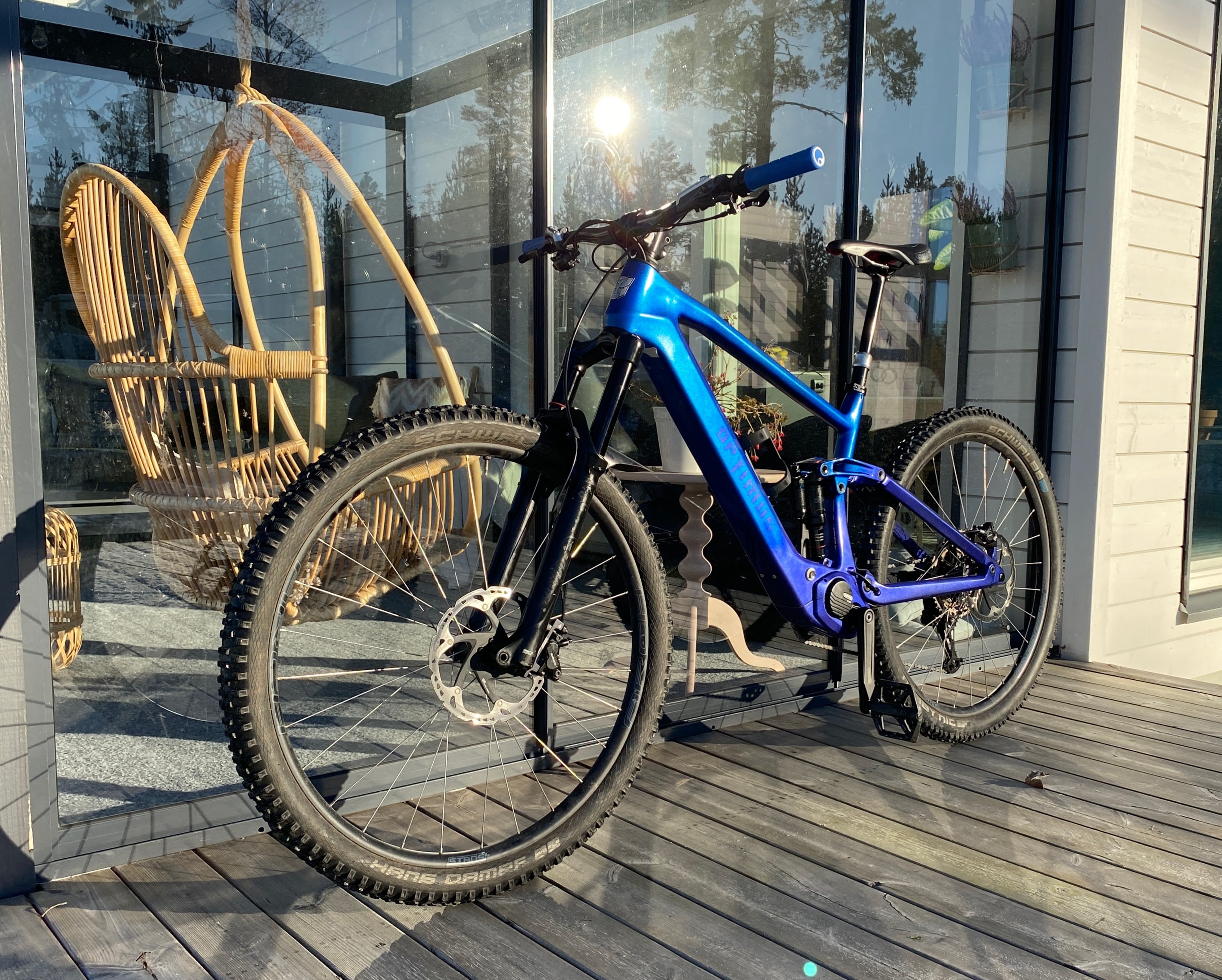

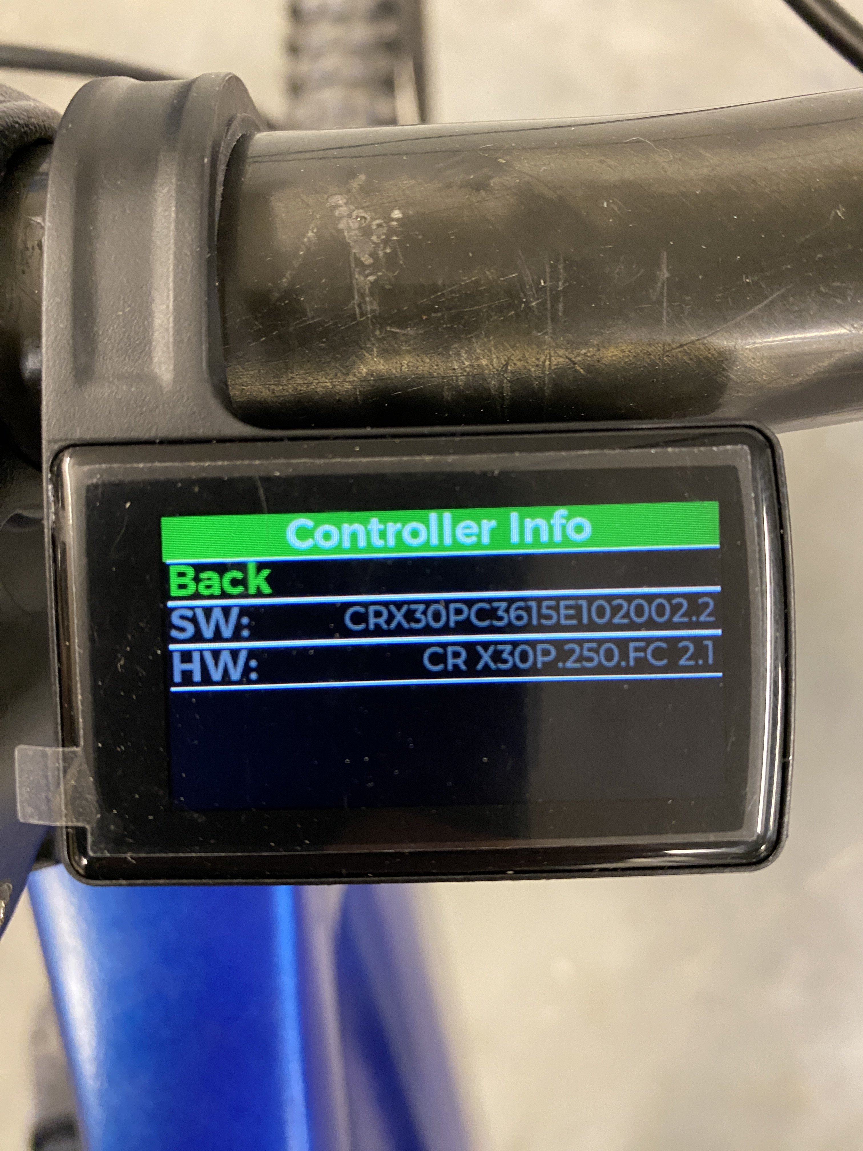

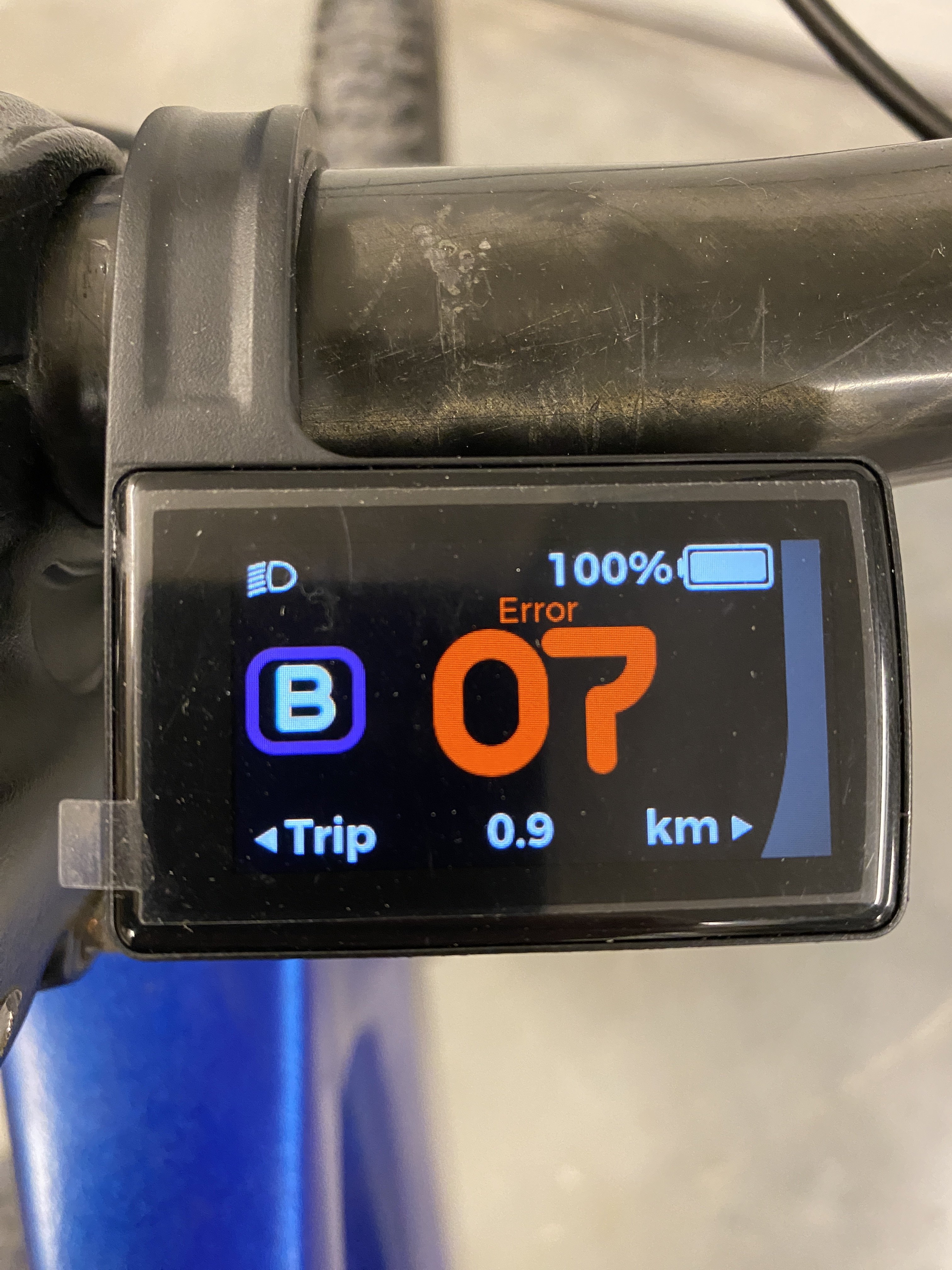

Finished my bike, but after charging got "error 07", overvolt. So it seems I got the 36V firmware version, motor seller promised to send me parts and show how to change it. I guess that means besst tool?! So more waiting for now! ☹️
Took a short ride and feels very much like analog bike, geometry is very good, not much resistant from motor. Can't wait to get motor running..
yep, you need besst tool, sorry for that
Maybe you can find a local on the forum with the tool ? Then, firmwares can easily be downloaded on the forum
Looks awesome. What was your final weight with that bigger battery? Love the color. Bummer about the 36v, seems that happened to several other people as well. Great job on custom battery!
use BESST tool change the motor to 43V
