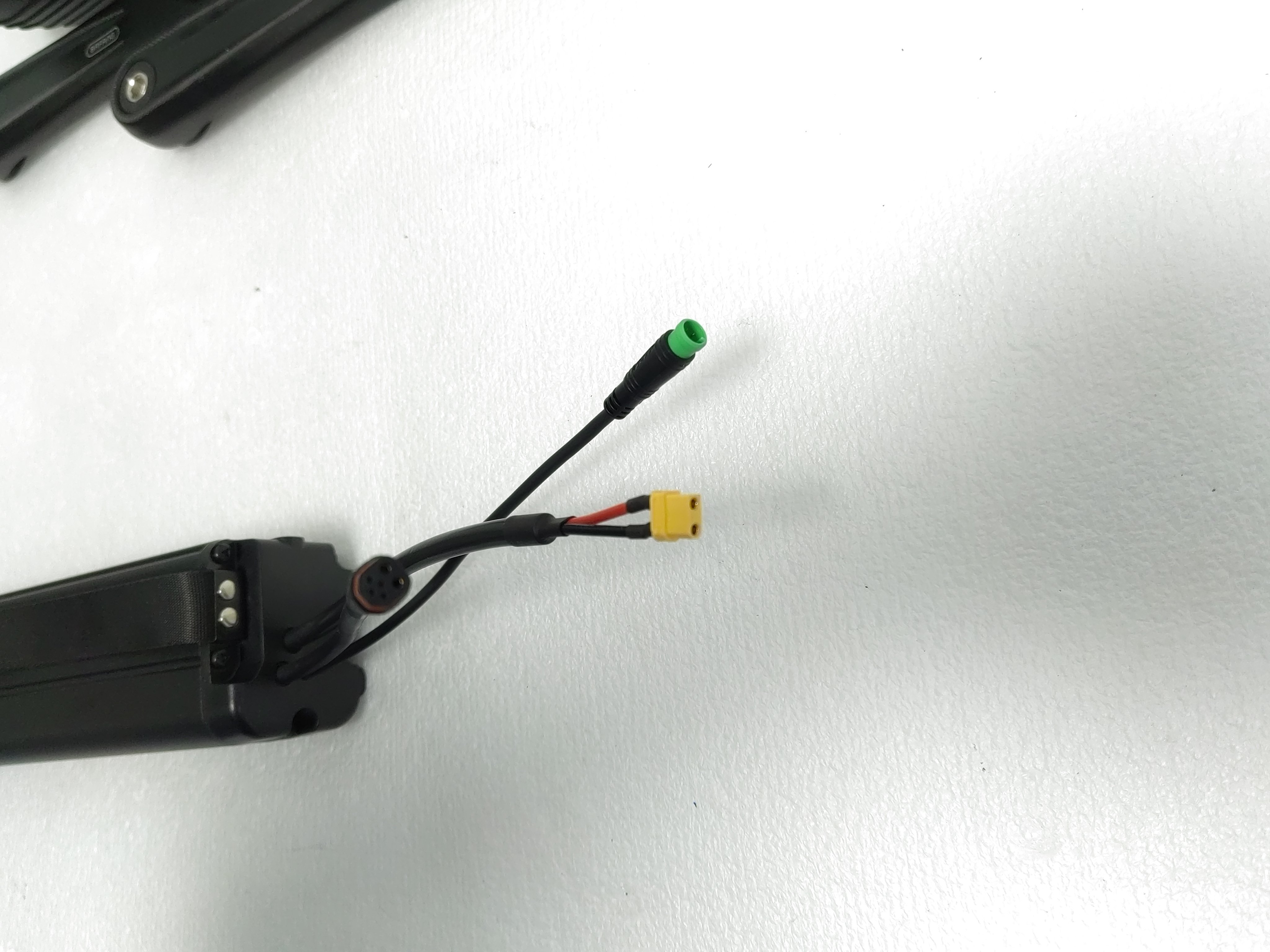

I have received battery and BESST tool but I have no idea how to make the BESST tool to work. I've tried connecting few cables but I have a read error on the BESST software.
I basically connected the battery to the motor, then the display to the motor and the BESST tool to the remaining plug available on the display cable (I think t'supposed to be used for battery communication, what did I do wrong ?
Use the BESST tool instead your dispaly, The BESST tool has four connectors, one of which can be connected to the green connector of EB BUS. then contact to computer

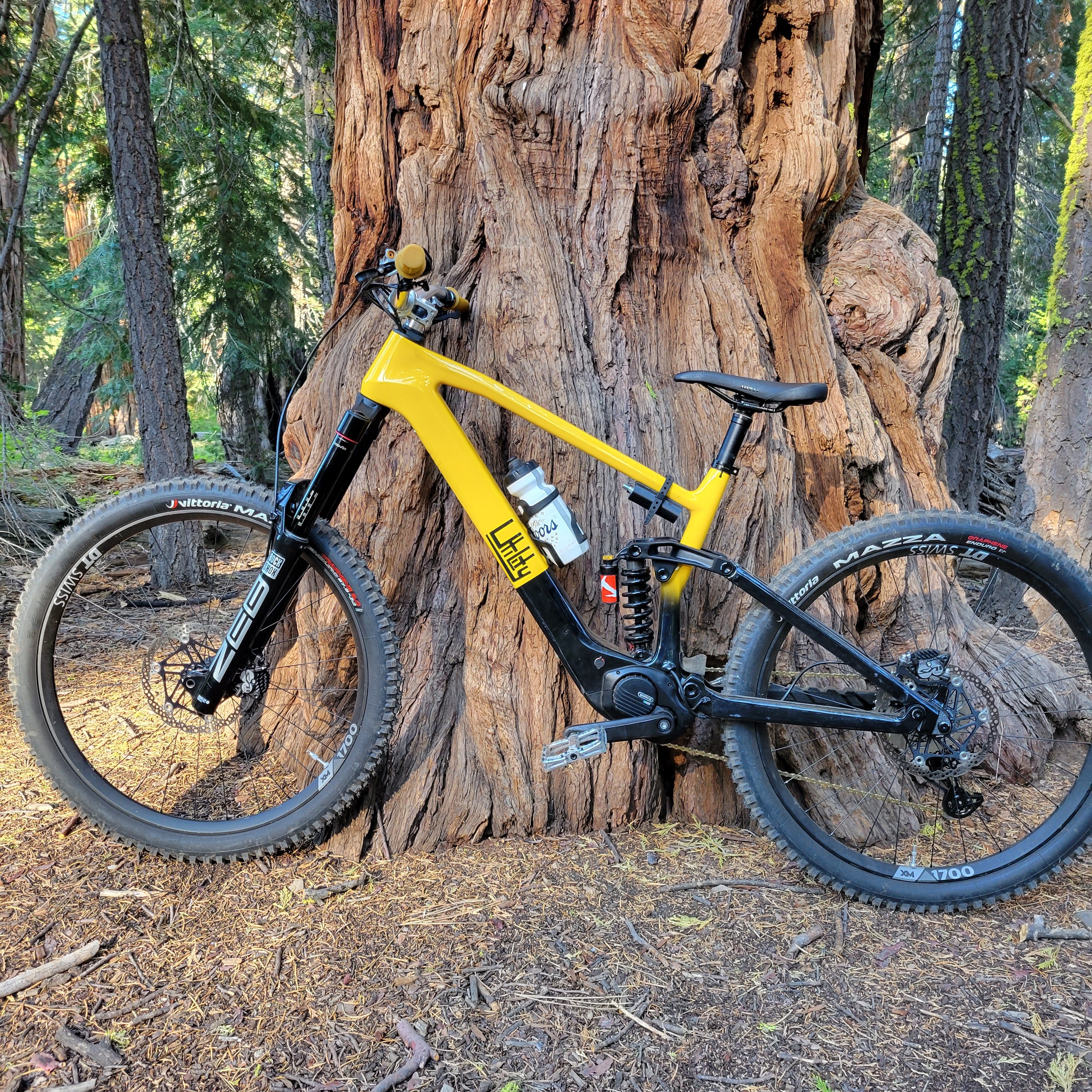

New frame and motors are a dream. Here is my build.

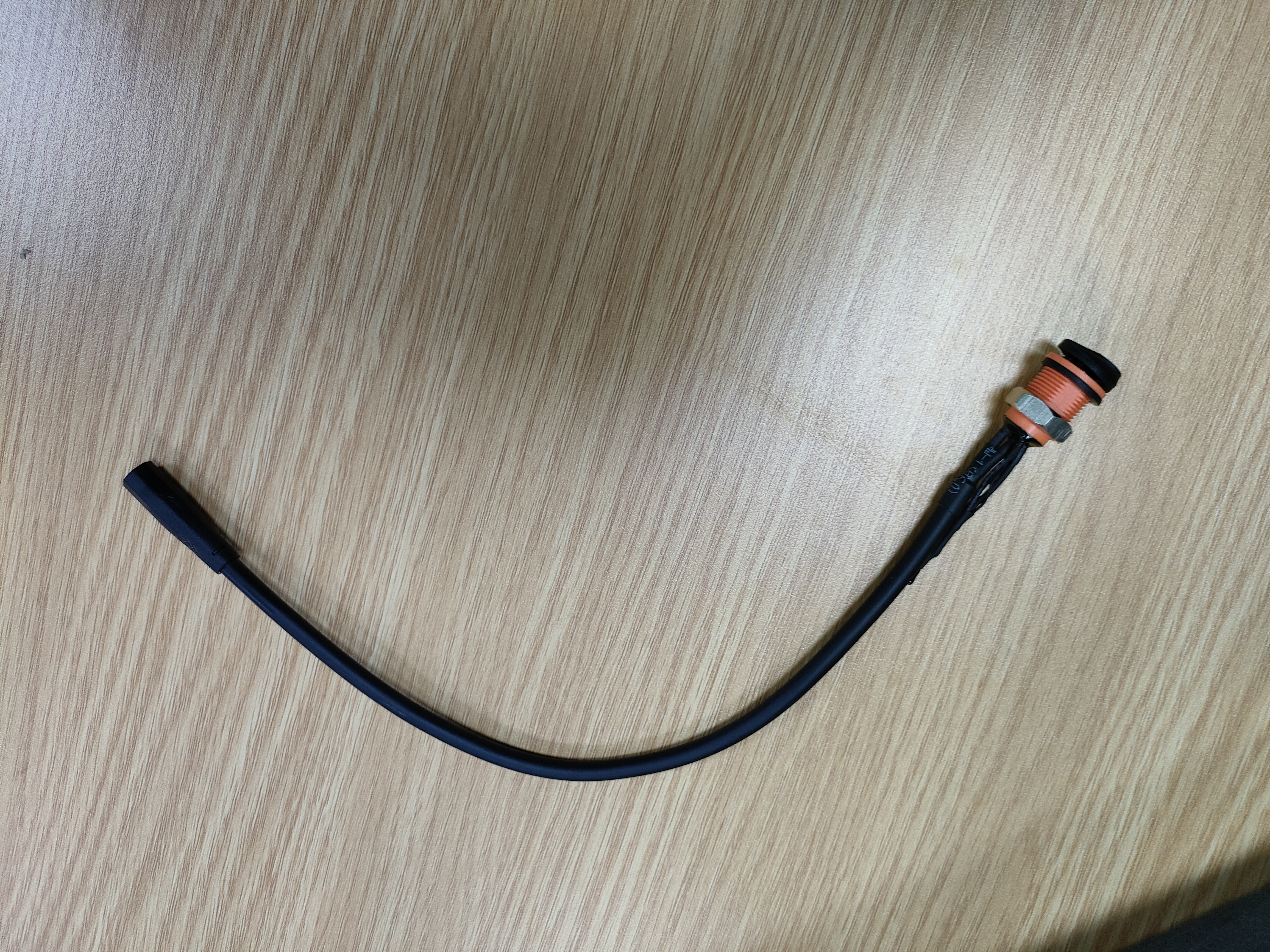

This is the one, if you need lights output:
And the one without:
edit: at least this is the one I ordered as 1T3.H and recieved the correct one. The picture does look different, than what I recieved. BMS connector is indeed green and circular, with 5 pins. In the above web page I don't find the exact one, according to the pictures.
Looking slick overall! What's your travel, 160/150? If so, could you over-stroke rear?
Also, good brake/rotor combo💪 (IMHO). I run Saints and Hope 220s for no-fade breaking!
Some sweet, black, Hope E-cranks are a nice and light aftermarket upgrade over stock. They're killer and half the price of 5Dev bling! I run mine at shortest possible (for Hope)...155mm to minimize pedal strikes!🤟
both cables are wrong, both are for M510/M560/M600, the cable for battery BT F014 have a roud greed port which conect to the green port on battery,

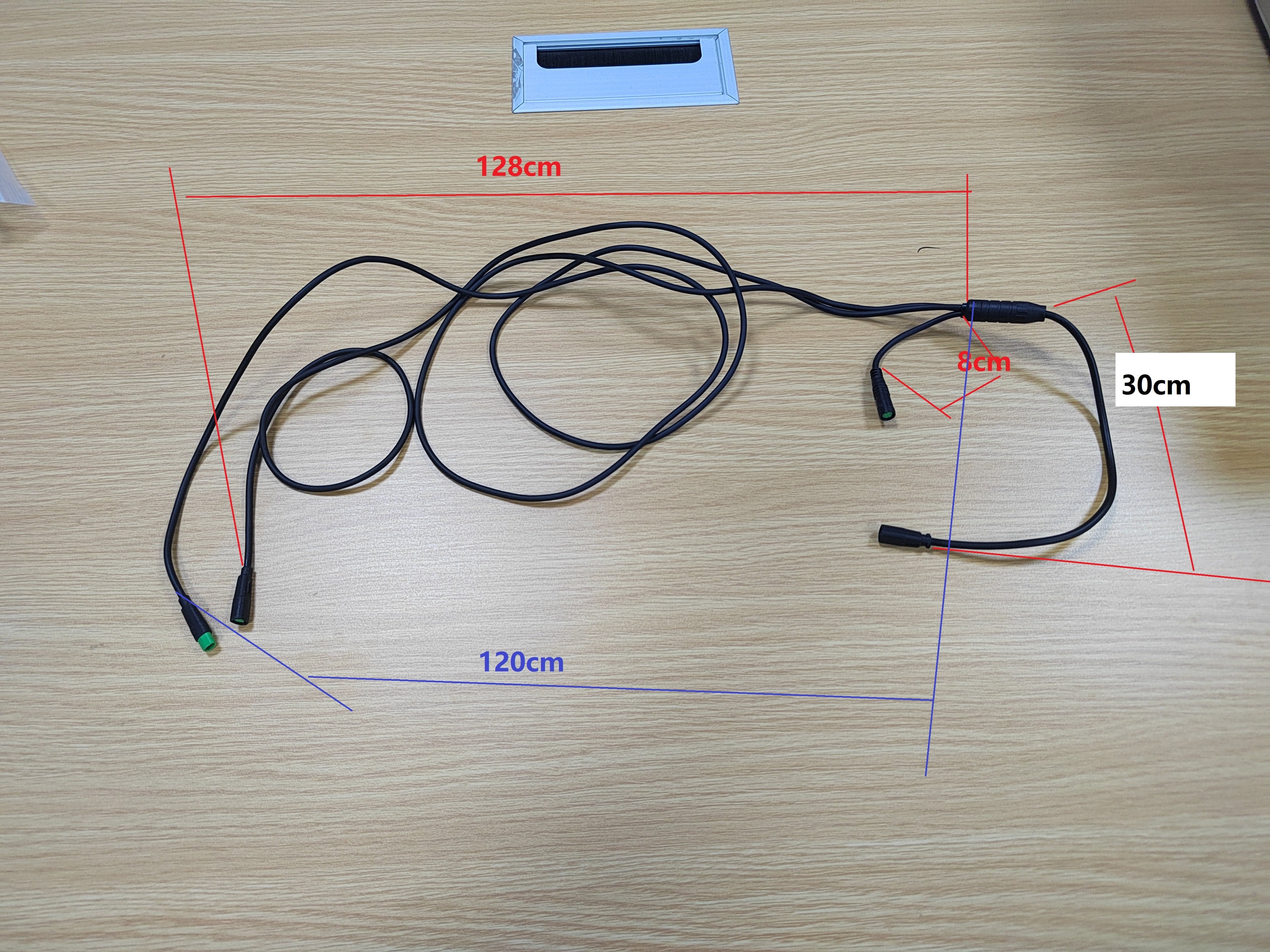

Does anyone know the part number for the correct cable? My vendor is really struggling to get me the right part.
Hi Kaylee,
I spoke to my supplier and they also have been in contact with Jim I believe. They had a reply from Bafang and it seems they have to order or make a custom order. They said it would take 15 days to get to them but the factories are currently all closed as there is an 8-day national holiday and then they would ship them once they have arrived to them. So I'm estimating 5 weeks probably which is disappointing. I asked Jim and they don't have any extra cables. I also asked and have been advised not to use the current cable as they can't guarantee that it won't cause damage to the system.
If anyone else has any contacts to vendors that have any in stock please let us know. Thanks!

Hi Kaylee,
Wow. Thanks for digging into this Toby! My vendor has been pretty unhelpful. They have told me they "will send", but zero additional information. Another 5 weeks after the battery was already late. Ugh. I'm really starting to regret going the DIY route.
It seems that at least a few people have the correct cables, maybe they can share the vendor that they used, but it seems as the system is new there isn't a surplus of these spare parts right now. I'm not sure if it's possible to purchase other Bafang cables and splice to make our own version while we wait?

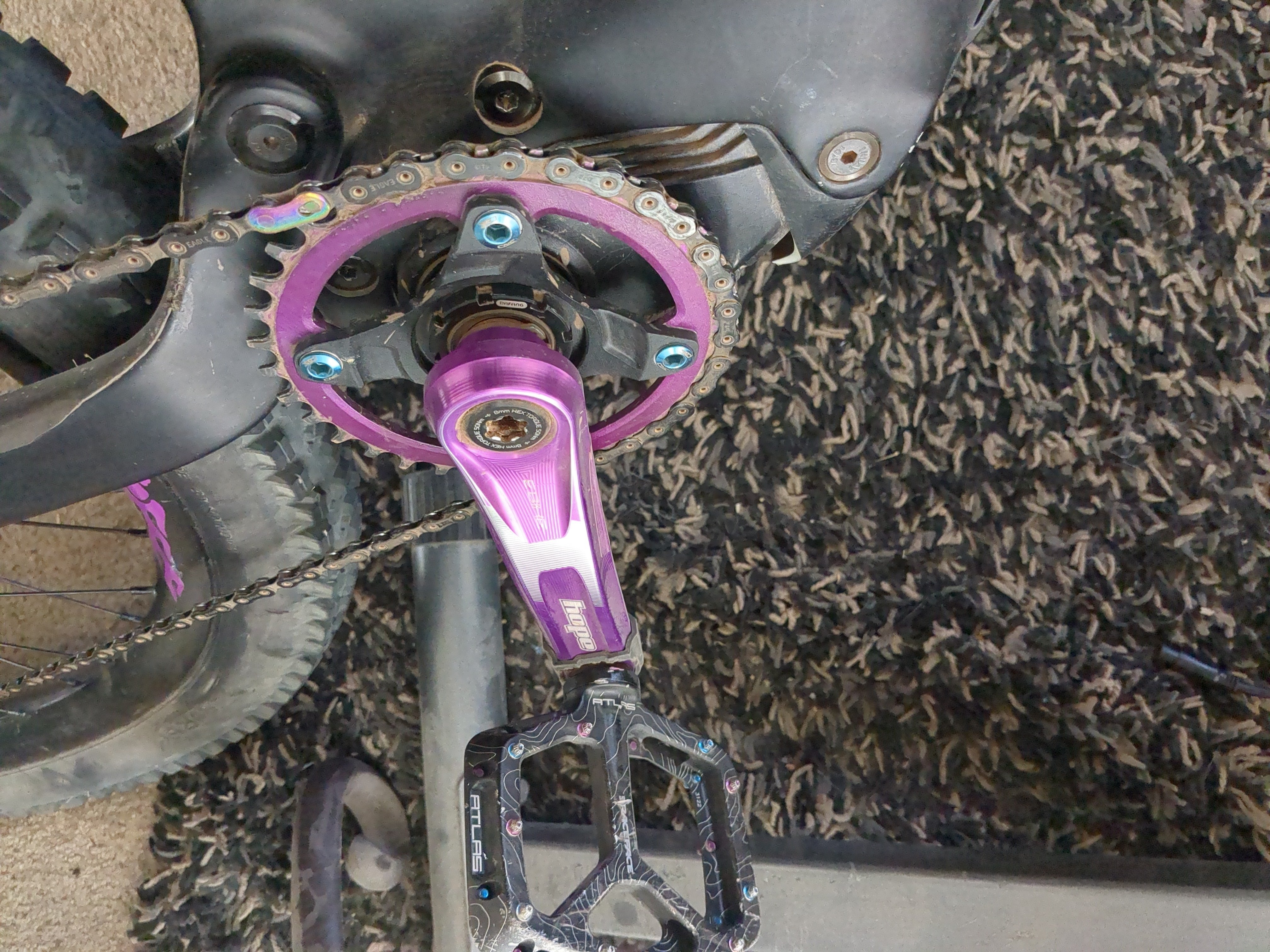

Will hope cranks fit on bafang motor?
