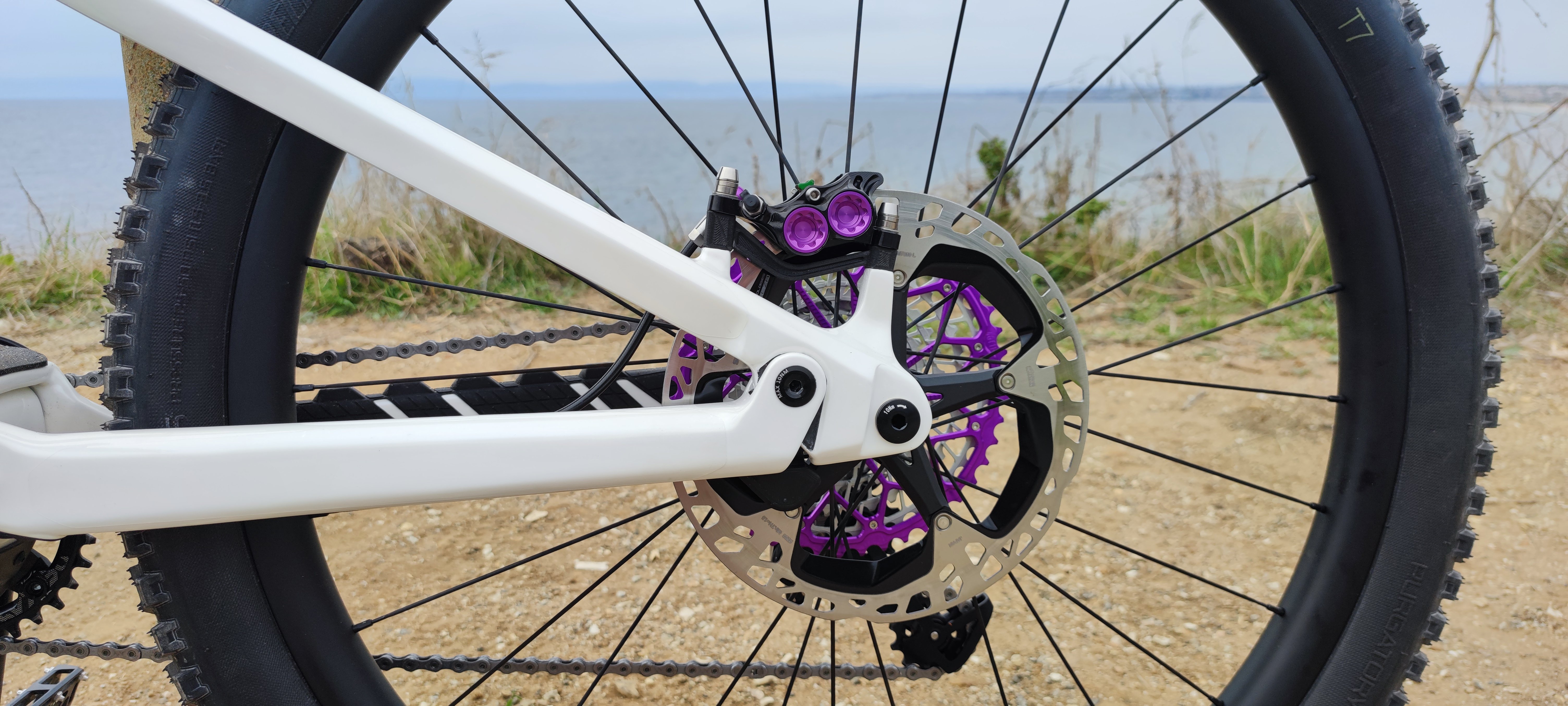

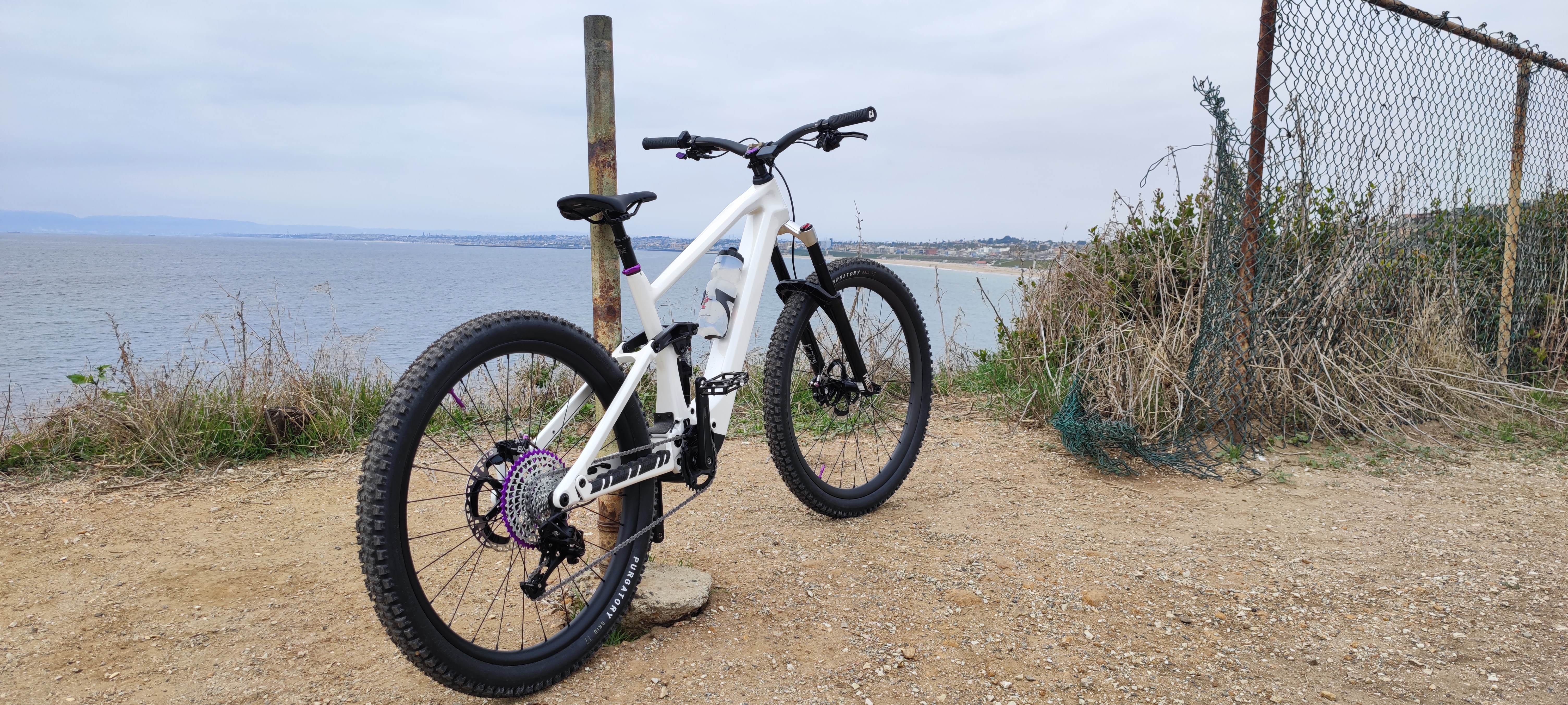

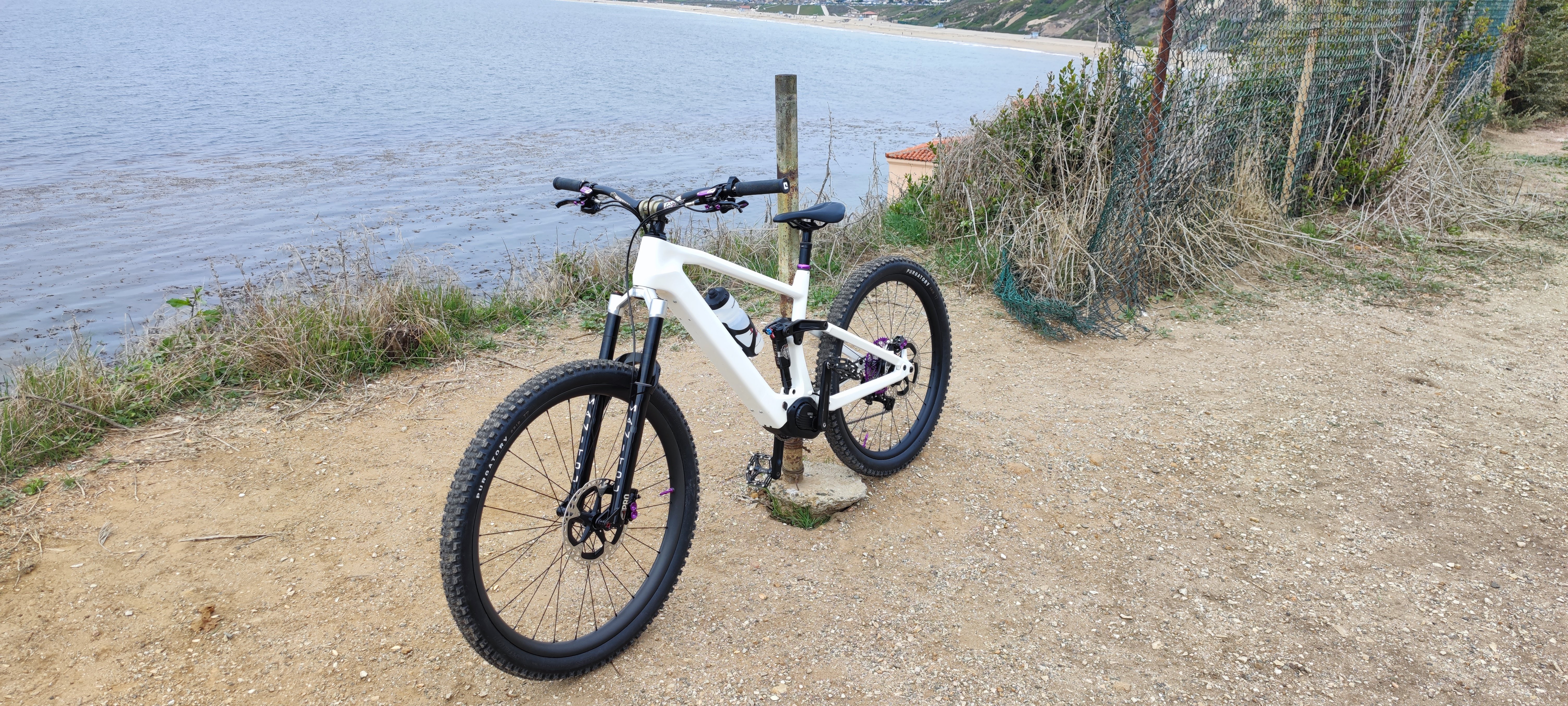

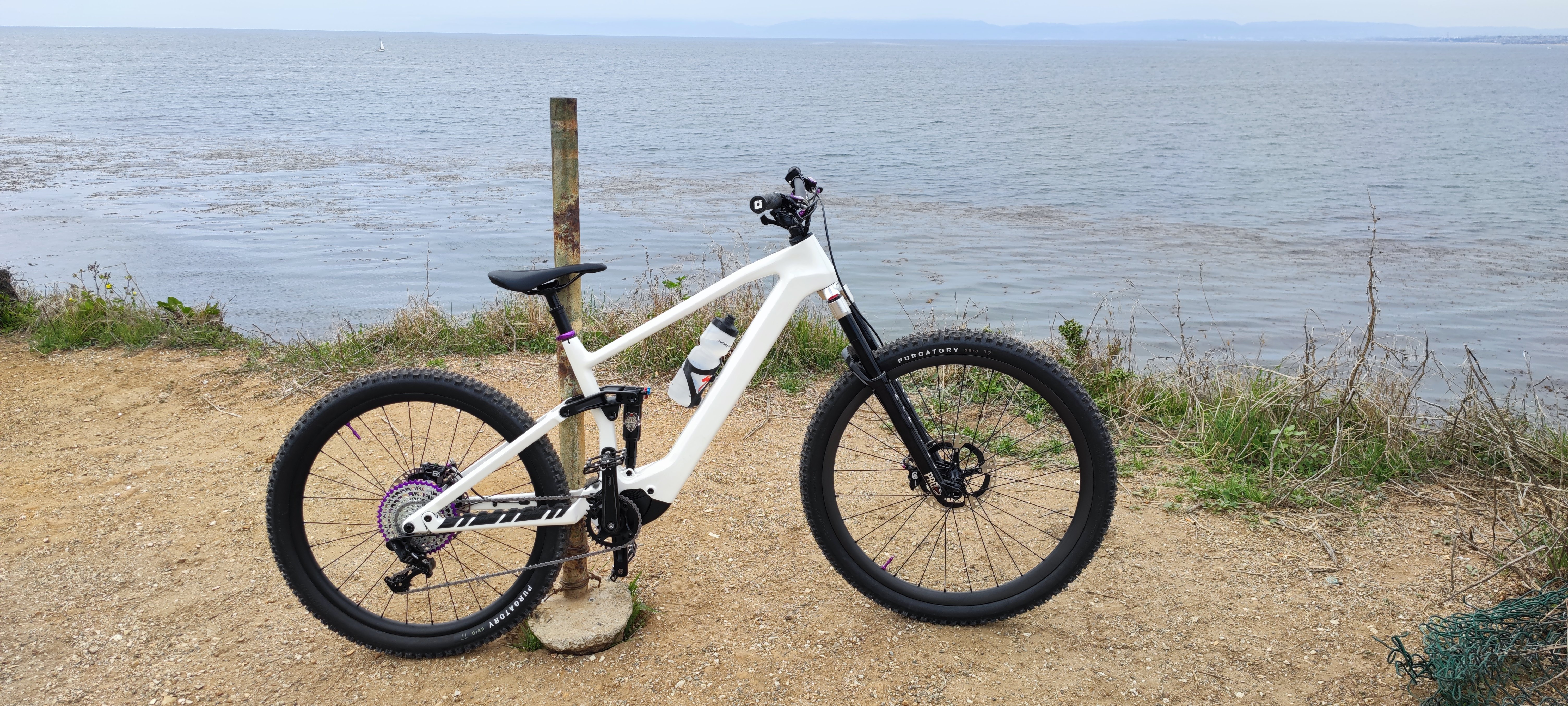

Finally got my battery and missing pieces from my original order and finished my bike this weekend. Lightcarbon wheels, 27.5/29. Specialized purgatory 2.3 tires. Manitou Mara inline shock and Mattoc pro fork. Hope Tech4 E4 brakes with 203mm Shimano MT900 rotors. She weighed in right at 18kg. I think I can decase the bafang battery and save around 0.5kg.. we'll see. Here she is!!
Went for a short 8 mile road ride today up the coast. Used all the modes. Consumed 27% battery. My thoughts... The bike feels plenty powerful. Almost like my specialized turbo levo, but sooooo much lighter! I really like the 245 color display, it's easy to use and easy to see, and just feels modern. The motor did get noticably warm after a decent climb in boost mode. It definitely rattles when not pedaling. The motor is louder than my levo, but not much louder (maybe 15% louder?). One thing I did not like, the motor keeps running when I stop pedaling. At times it does this for over a second. This feels dangerous... my levo definitely does not do this. Is there any way to change this?
Overall very happy with the bike. Can't wait to get out it on a trail!

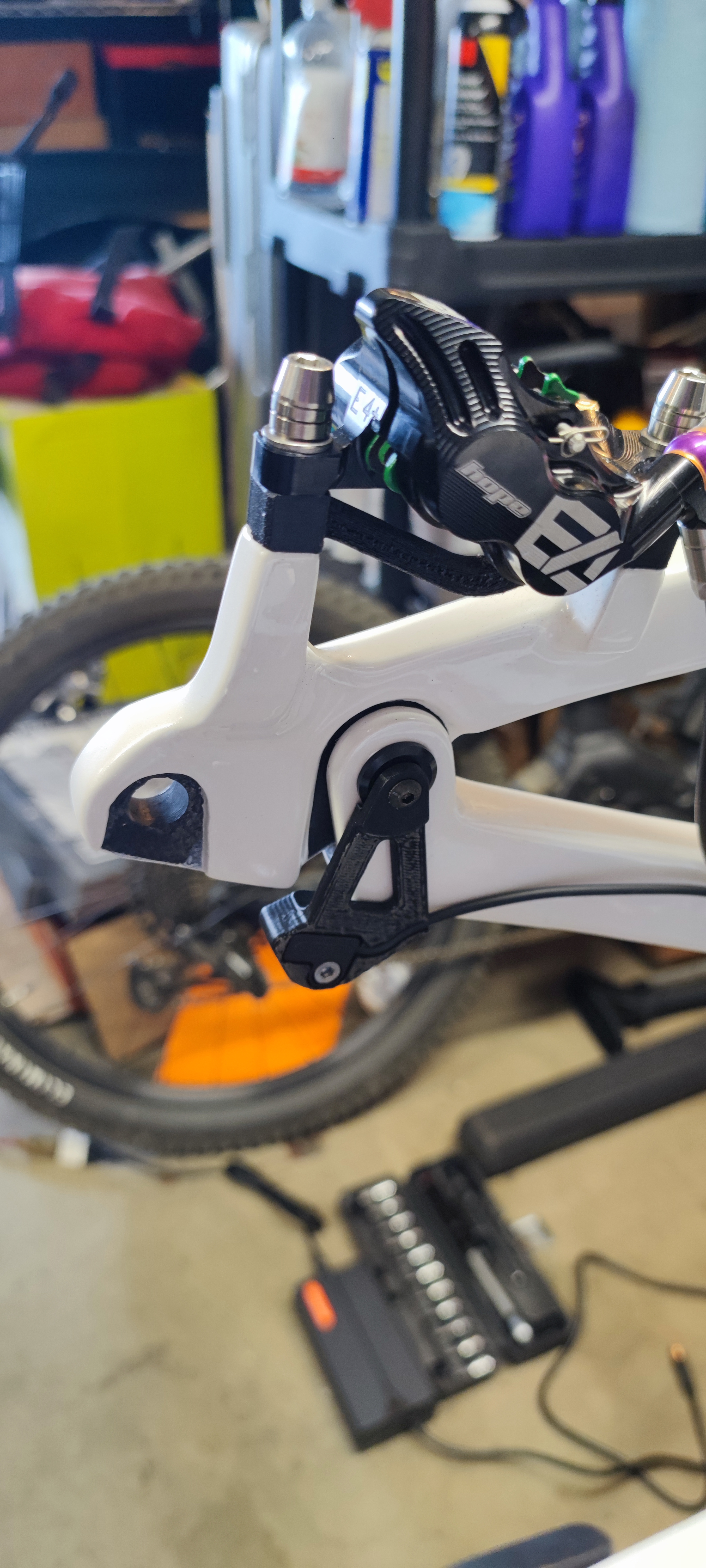

nice build man, also the same as what I was thinking - white frame and manitou suspension. the speed sensor bracket you have is sick!

Thanks! It's pearl white. Can't really see the pearl in the pictures, but it's stunning in person!
I see you're in California, if you're near LA, feel free to come check out the bike before you build yours!
