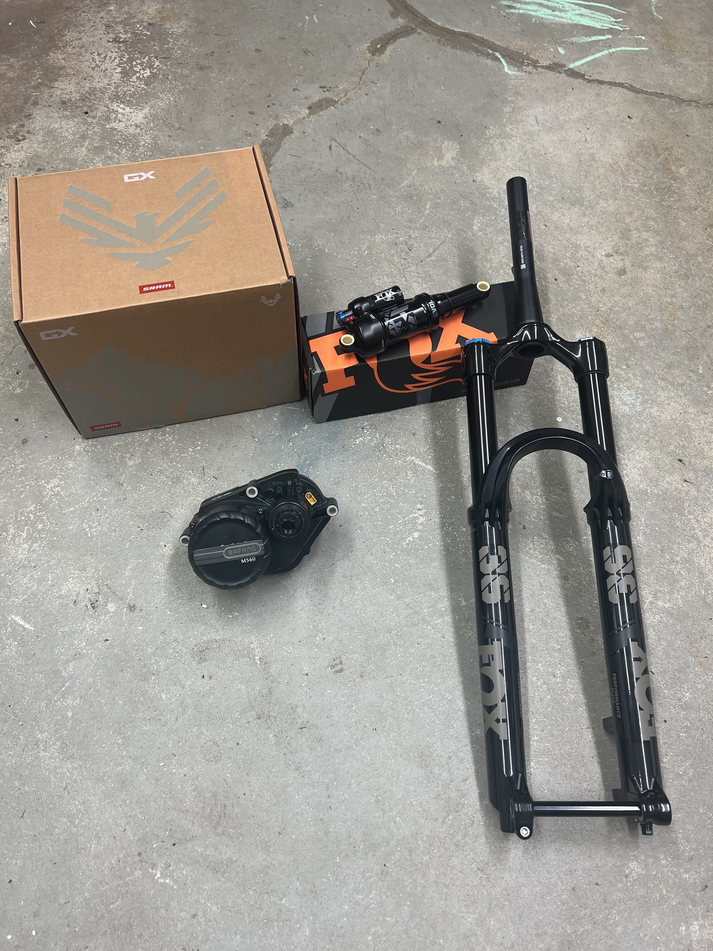

Some goodies are starting to arrive.

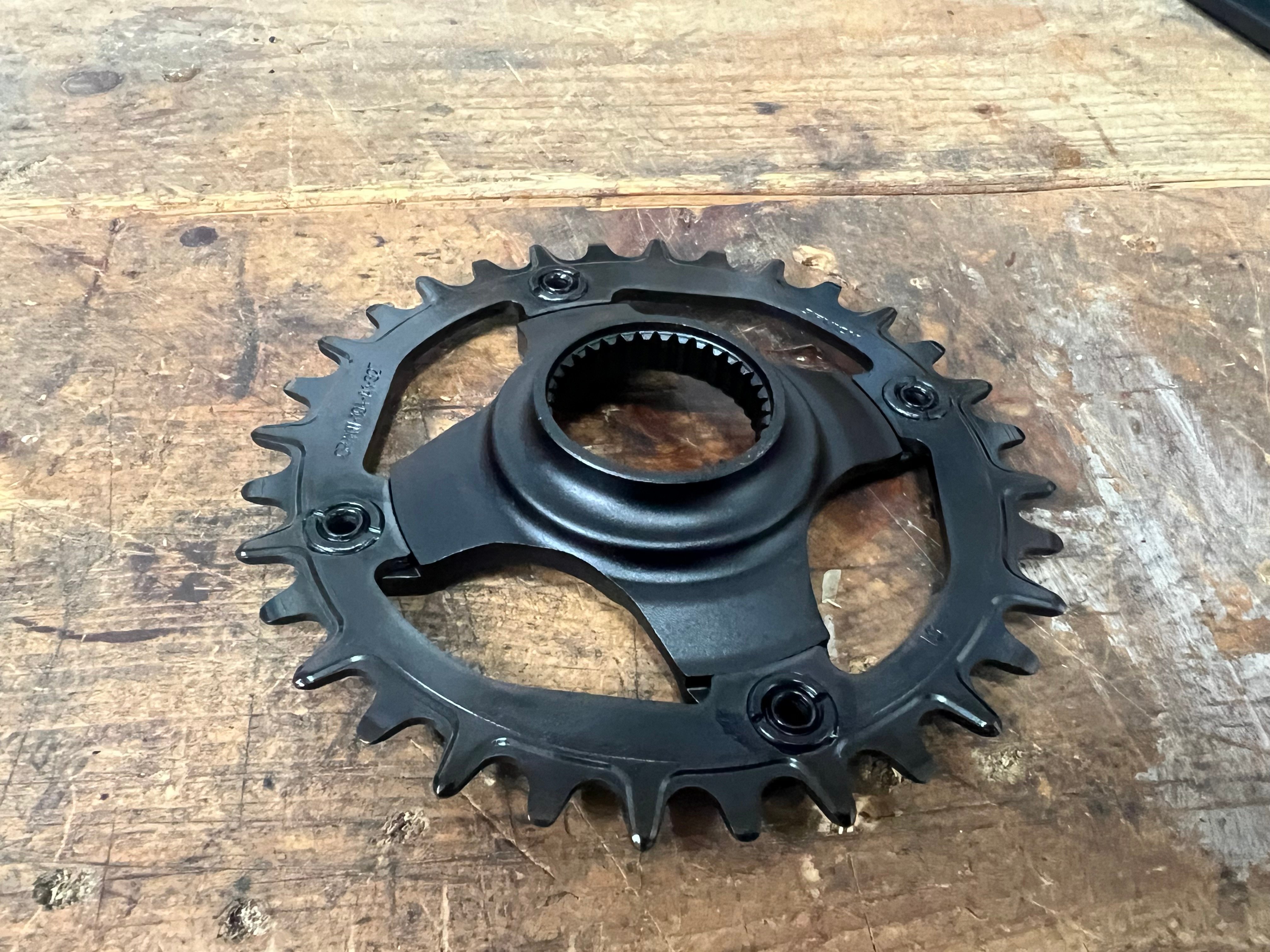

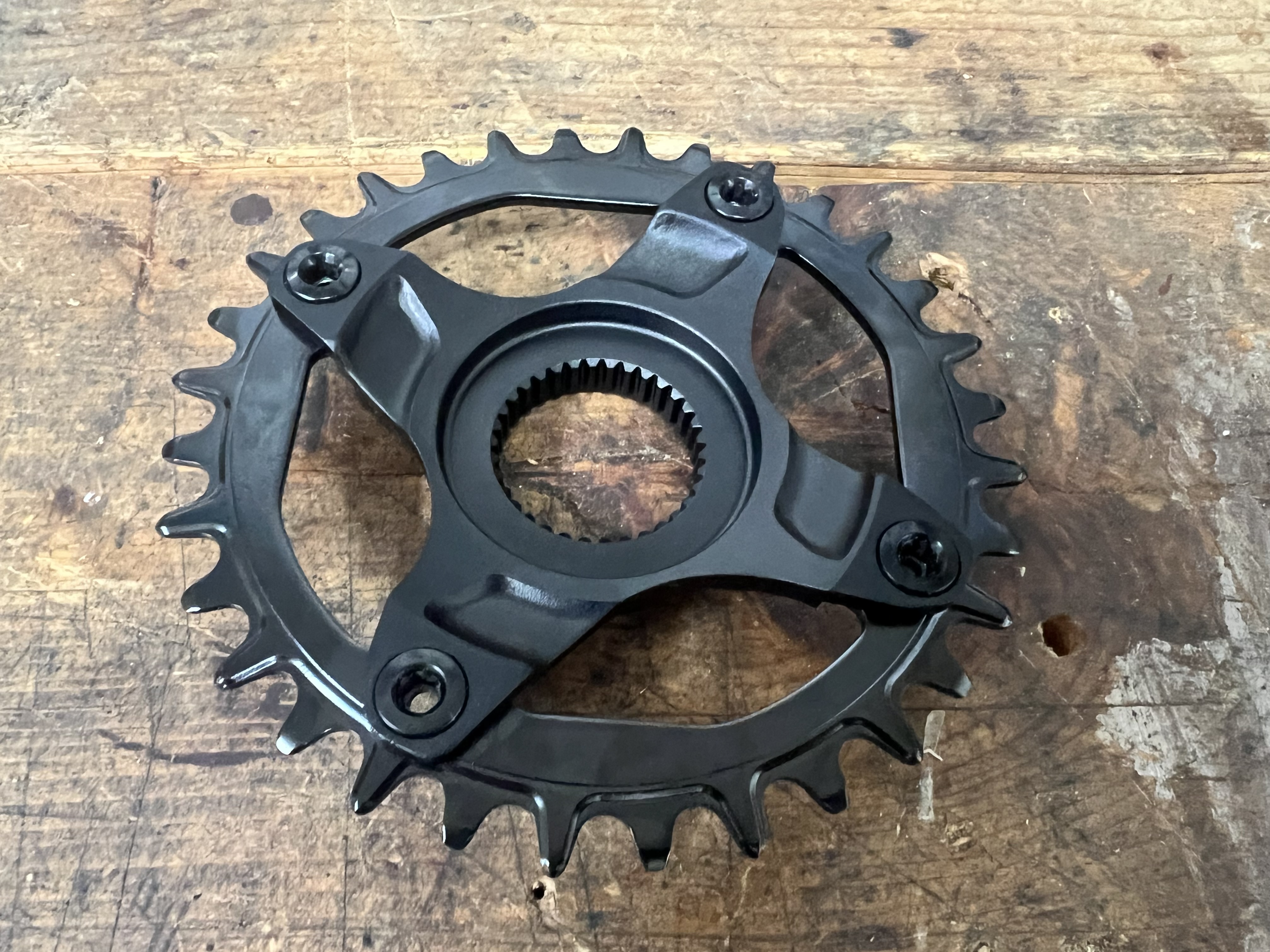

The chainring below that came with the motor is not compatible with a chain guide so I ordered another from GreenBikeKit that will hopefully be the correct one.
Still waiting on the battery, my big Jenson order with the smaller components, the wheels, and of course the frame from LightCarbon.

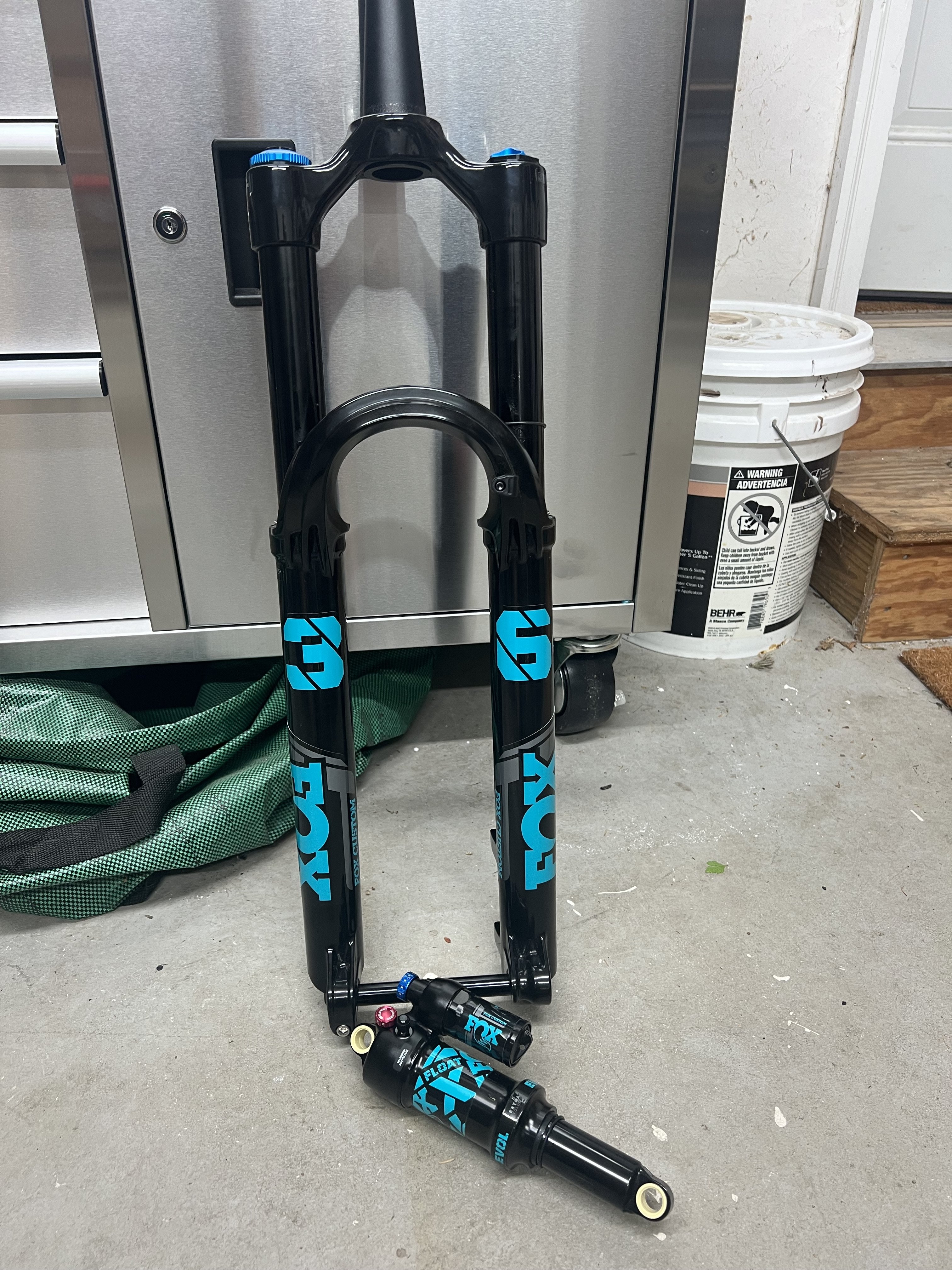

While I’m bored waiting for things to arrive I took some time to get my Fox decals installed, pretty happy with how it came out!

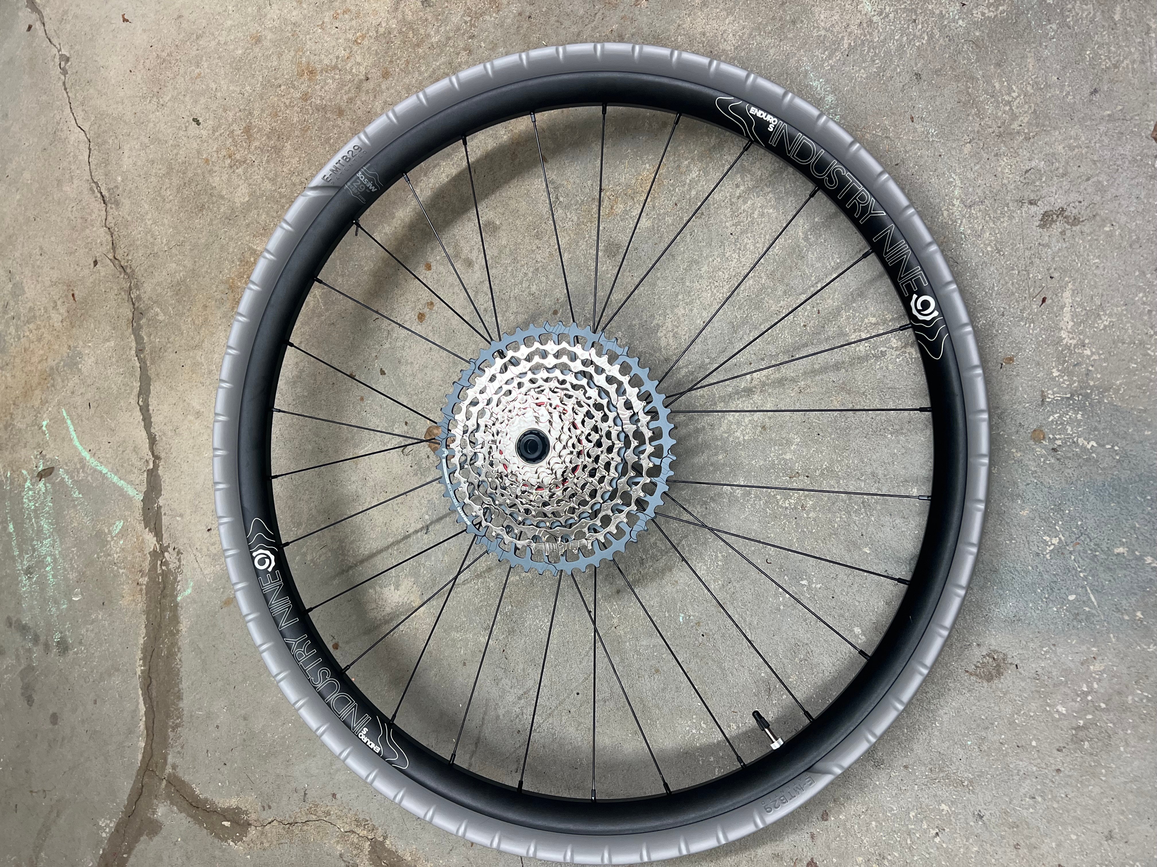

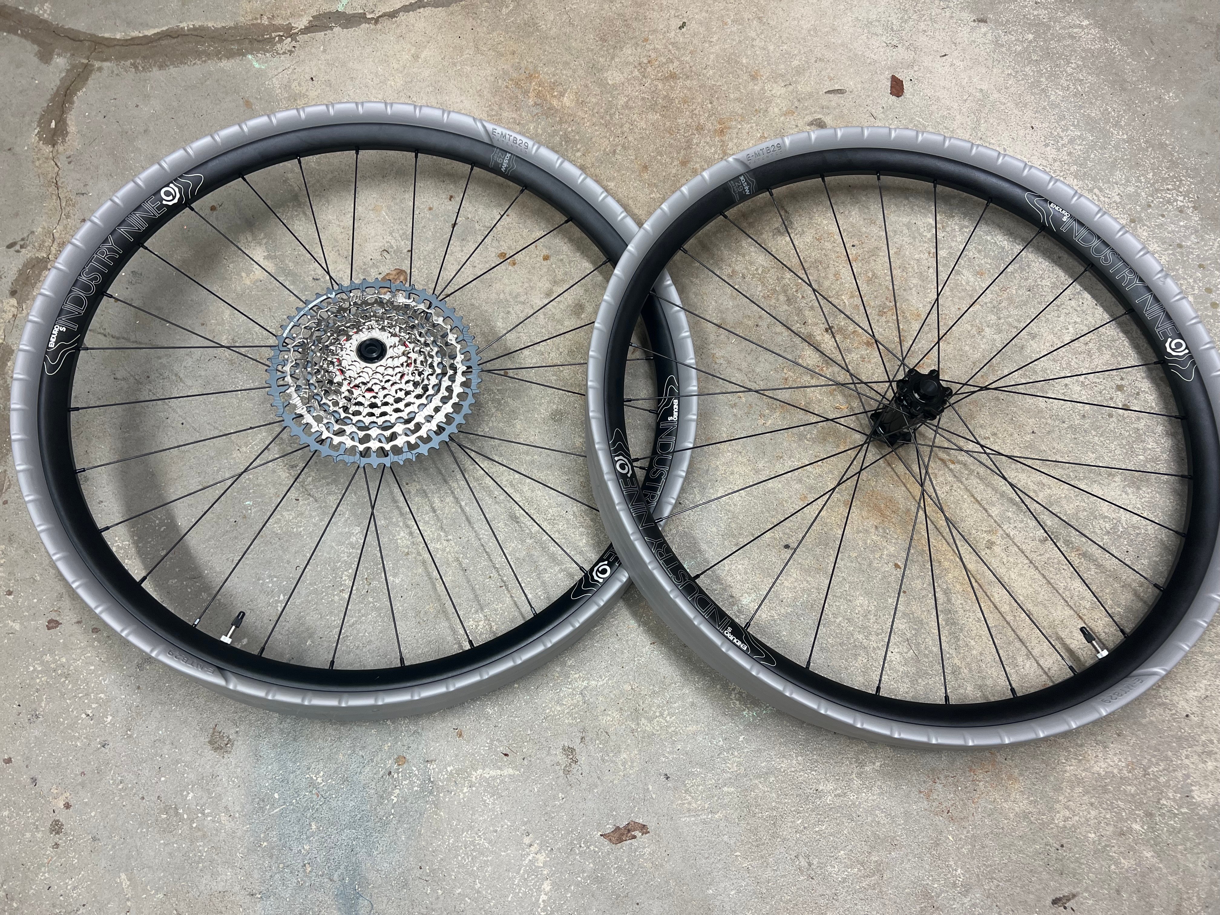

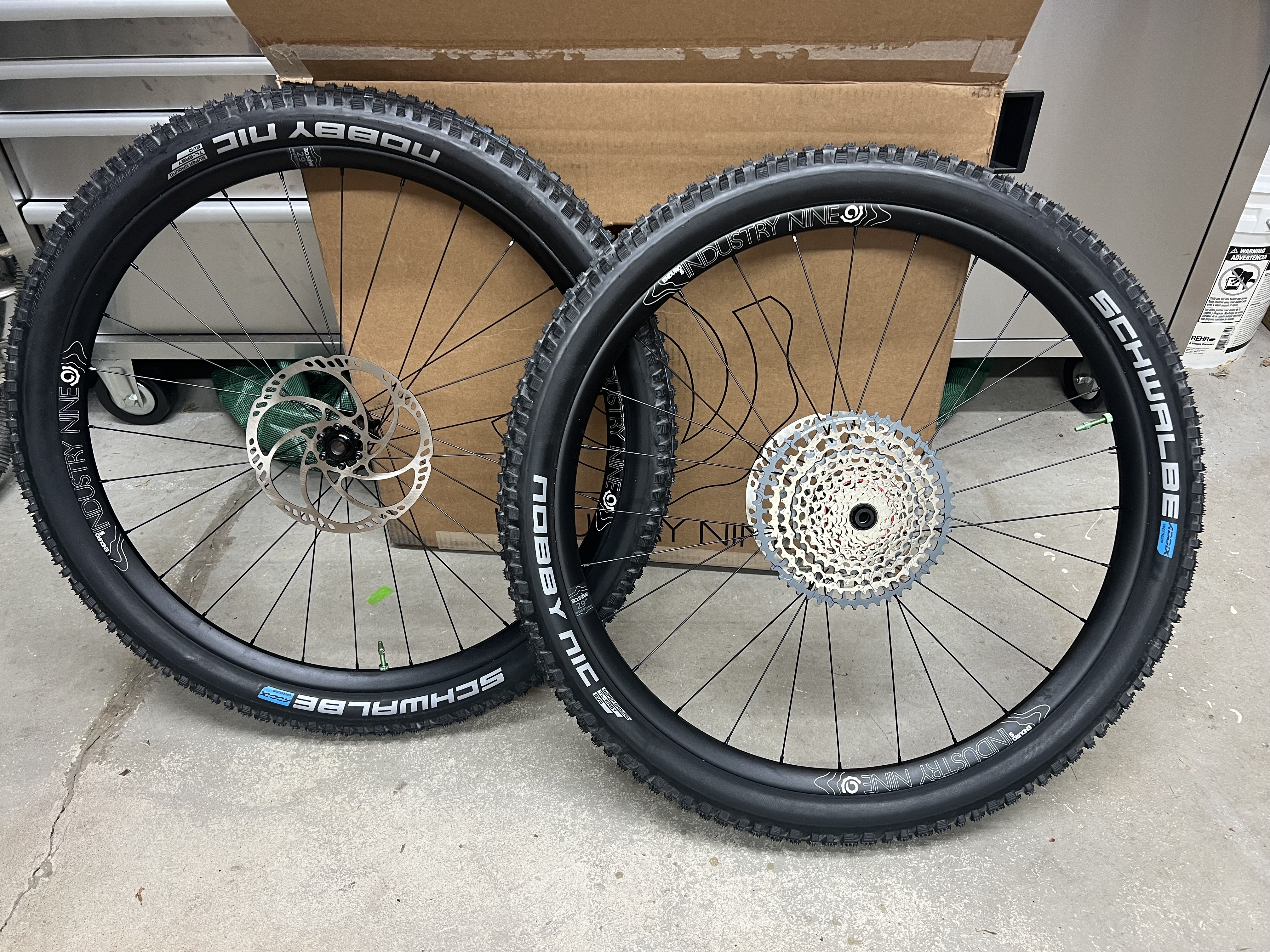

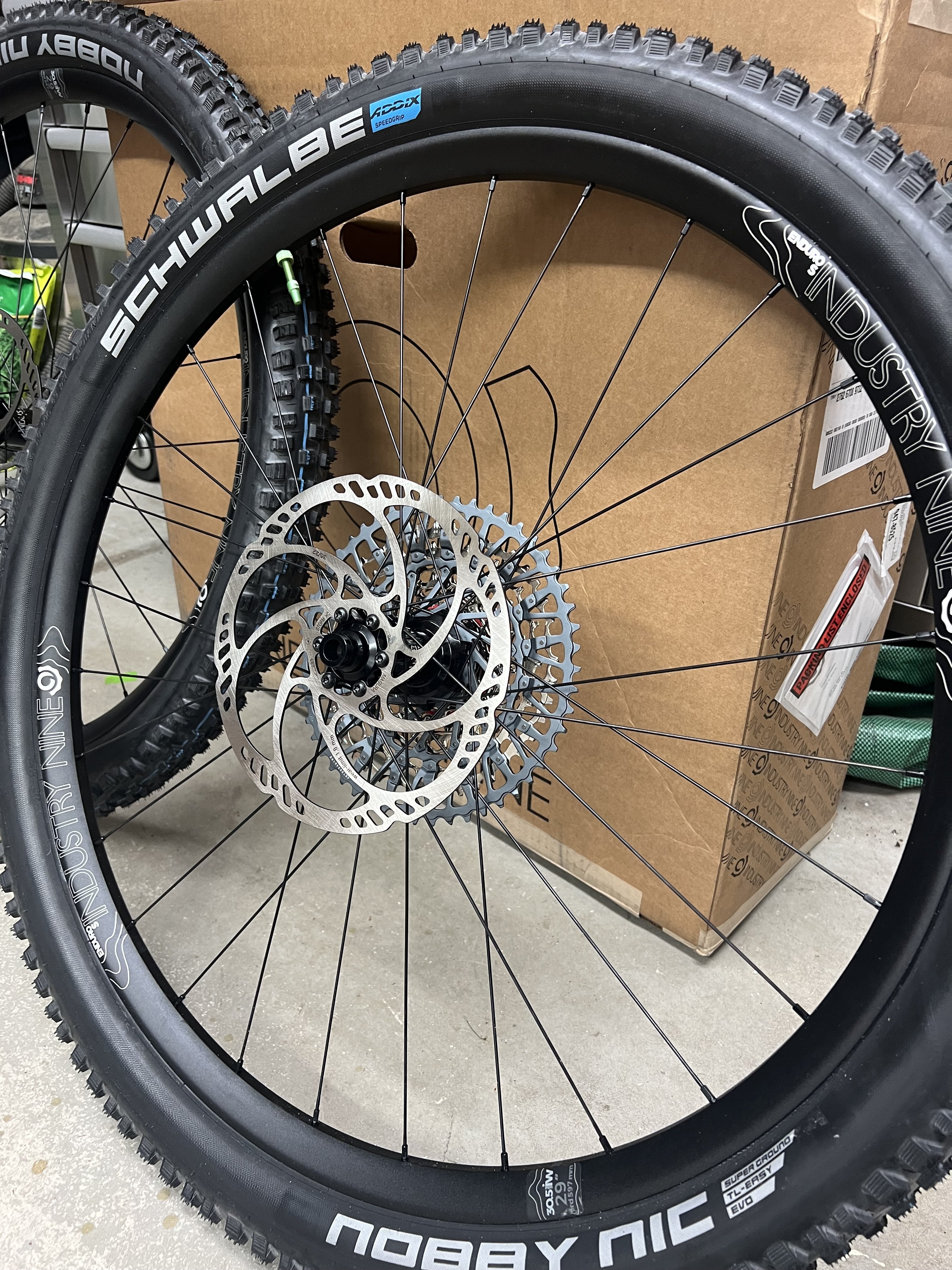

Finally got my wheels in so I could at least put something together. The tires were so unbelievably tight on the wheels I never would have stood a chance getting the CushCore inserts in there. After a few hours of fighting with all my strength, using copious amount of soapy water, and snapping numerous tire levers without getting remotely close to getting them on, the tires are mounted without the inserts…
Not sure what the deal is with these tires, but the bead just seems a few mm too small. It took every bit of strength just to get them on the wheel without the massive super stuff eMTB inserts from CushCore. They were tight enough that with the tire sitting down in the inner well of the rim, where it’s usually kind of loose sitting there, I couldn’t even turn the wheel inside the tire. I don’t know how anyone would have possibly gotten them seated with the inserts, watching videos of others doing it online they clearly had stretchier/bigger tires or smaller wheels than I do. I'm sure me buying the big eMTB rated ones made it even worse as well. I’m convinced if I had something with enough leverage to get it over the rim either the rim would have bent or the tire would have torn, it was just absurd. Maybe I'll give them a try on my next set of tires...

Finally got the proper chainring with room for the chain guide on it and my BESST Pro
In yesterday. Likely 2-3 more weeks before I see my frame though which is disappointing.

While I patiently wait (Another month!) for my frame I decided to give the CushCores a second attempt. Armed with 2 news set of extra strong tire levers, a new bottle of sealant, and some more knowledge after watching some more YouTube videos I was finally able to force them on.
I think the tires being more pliable after having been mounted for a while combined with a more liberal dowsing of the soap/water mixture finally let me actually maneuver them correctly and get them on there. I’m sure the next time will seem much easier now that I’ve been through it but that was not a fun process to say the least.

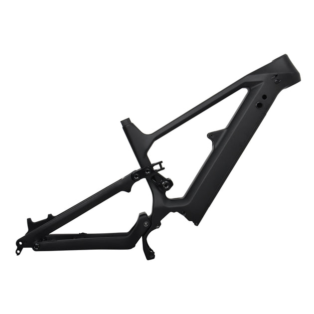

Still waiting for a frame… LightCarbon seems to be having endless issues with the rear triangle on this frame. After 3 redesigns and delays their latest attempt has failed within the first week for at least one customer that received it. I’ve now been told it’ll be at least another month for the new-new-new rear triangle to be completed, and who knows if it’ll be any better…
At this point I’ve contemplated just ditching the whole build and trying another frame, but the battery and some other components, like the rear shock were specifically chosen for this frame and there really aren’t that many great alternatives imo. The E82 is the only other frame I’d be interested in, and I hate the massive battery that fits the frame, more weight and capacity than I’d like.
This is looking like it’ll be close to 5 months from time of ordering. End of rant…

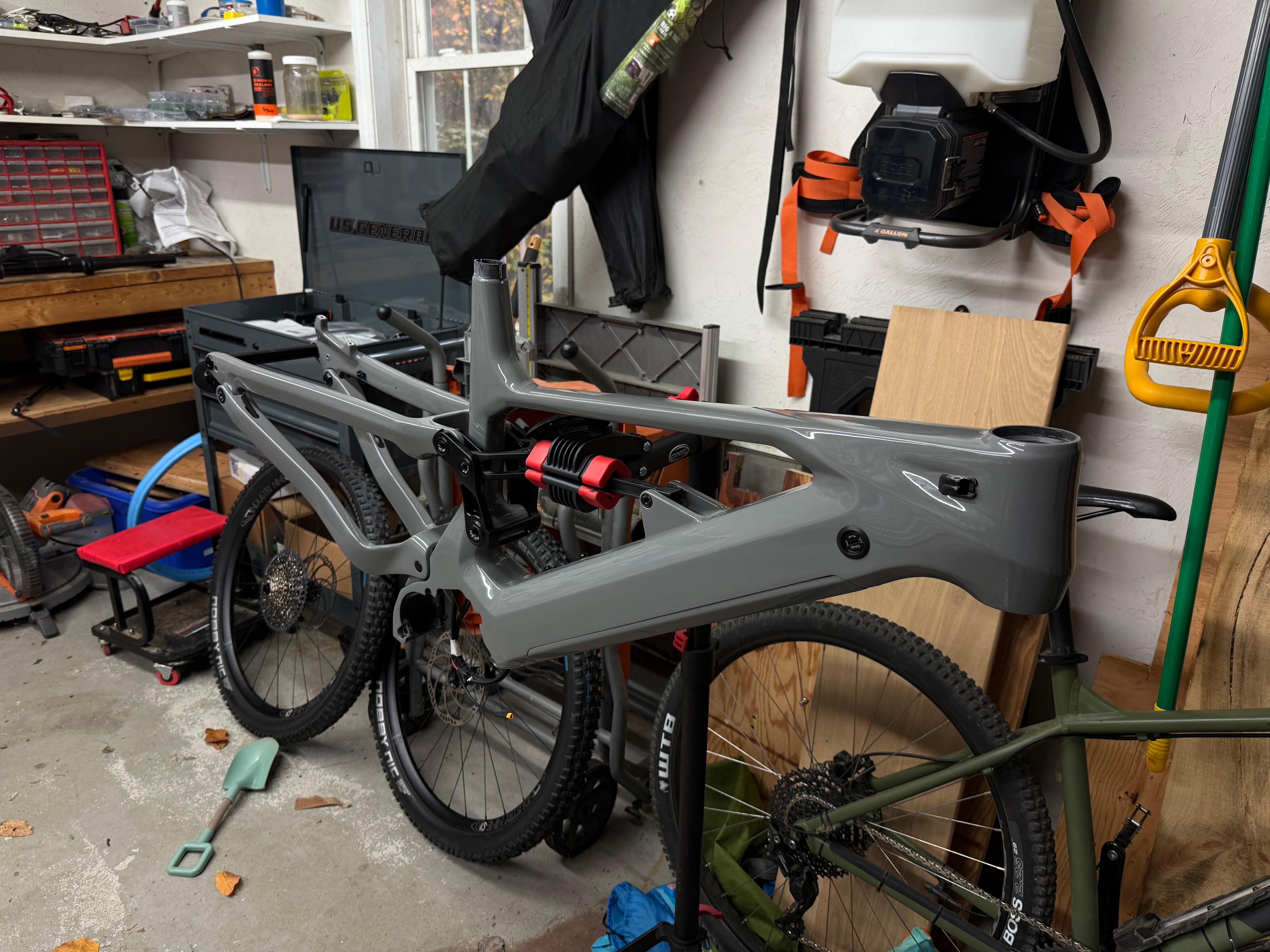

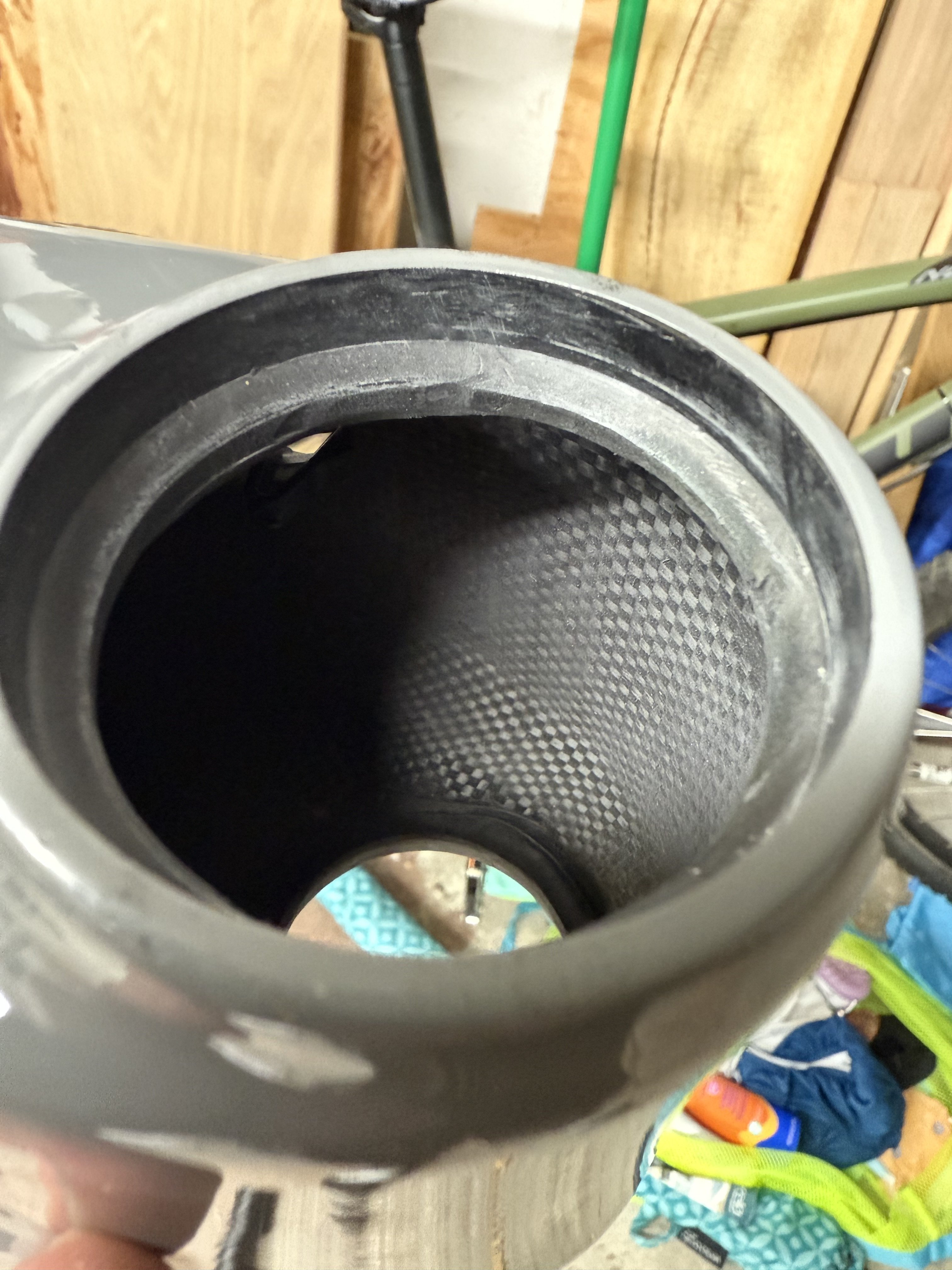

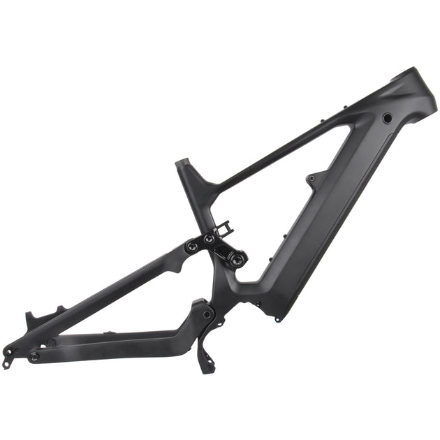

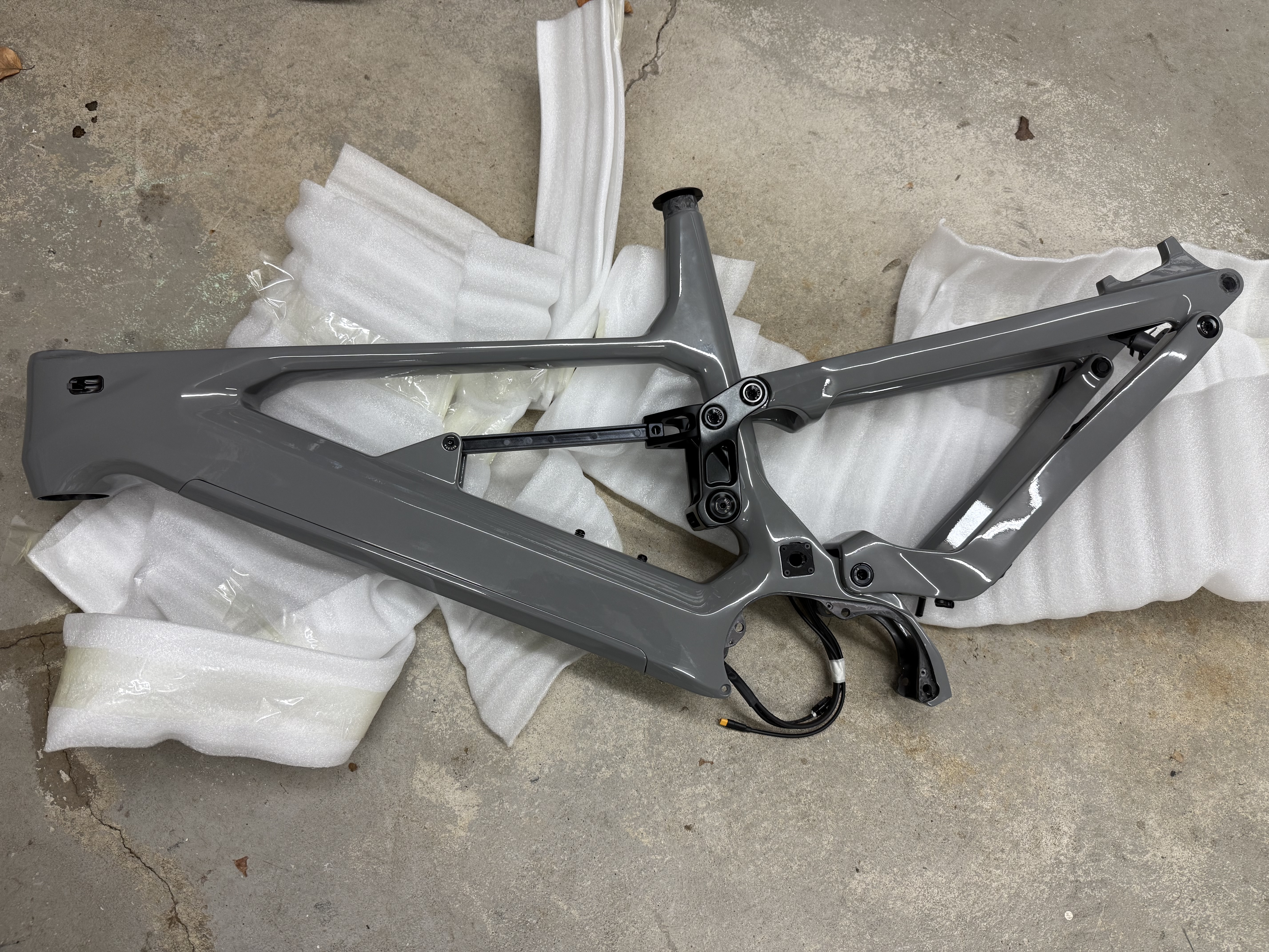

After 4.5 months I finally have a frame, albeit with the wrong rear triangle thanks to Dengfu’s poor Alibaba listings and ordering process. Now I get to wait another few weeks for that to be remade.
@LAnton I got 9.01 lbs for a weight as it was shipped. That was no headset or rear axle, just the plastic spacers still in there for the axle and shock. Battery cover and battery hardware installed as you see in the pics.
A few pics of the frame after unboxing:
img_0214-jpeg.148289
img_0219-jpeg.148291
img_0220-jpeg.148292
View attachment IMG_0214.jpeg View attachment IMG_0219.jpeg View attachment IMG_0220.jpeg
Did I understand correctly that the weight of the frame with the lid is 4 kg?
xtraman122
Mar 2, 2024
210
145
Almost 4.1, yes. Is that above or below what you were expecting? If the headset and rear axle were in that would have added a bit. Wasn’t sure if those were normally included in the weight of a frame or not. Assumed no so I did it without. It did still have the plastic pieces in place of the axle and shock but those should be minimal. It did have the battery receiver/receptacle with its wiring harness because that all came mounted in the frame.

Dengfu disappointed me. I asked the new manager questions. She told me that the frame 82 weighs 3.2 kg. I didn't believe her and I was right.
I’m willing to bet they do that weight without any of the wiring and battery hardware which has to be at least 300-500g and they probably use a size M not L like I have. I did a quick search and it was earlier reported as being 3500g and that was when they only offered size M so 3.2g seems very light.

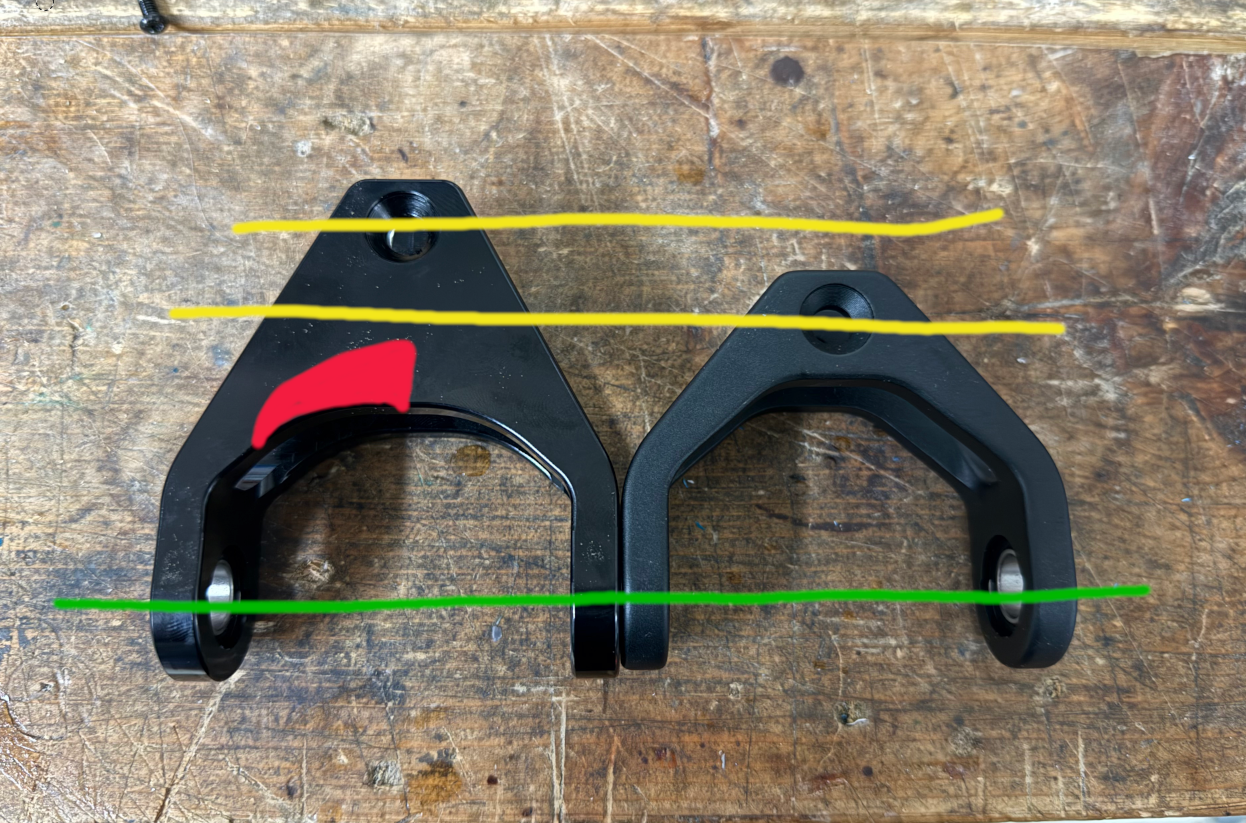

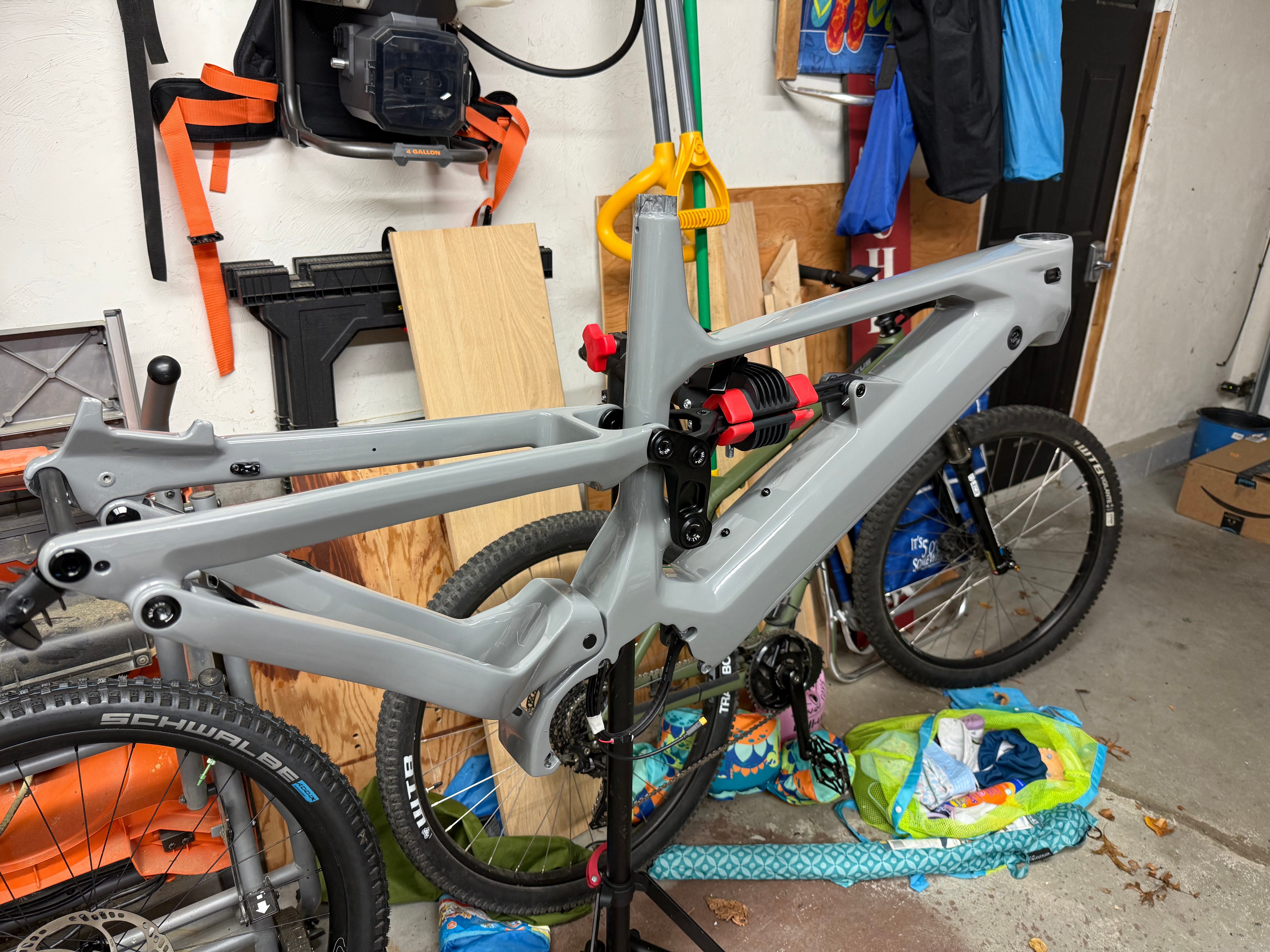

In today's edition of stupid things from Dengfu, I ran into issues trying to fit the bigger 70mm yoke for my 210 shock. The yoke on the right is the stock 50mm, and the one on the left is the 70mm; 20mm longer (Distance between the 2 yellow lines) to account for the difference in size between a 230 and 210mm shock. I had a 210x55mm shock so I went with the longer yoke to avoid buying another yoke when I switched frames.
The problem became the huge amount of extra metal between the opening on the yoke and the screw hole (Highlighted in red on one side to show it for example) for the shock to mount in, that material now hits the frame making this yoke completely unusable, I literally don't understand how this yoke is even compatible with the frame, I can't see how it would function. It was rubbing up against the frame from the length of the 210mm shock and I couldn't get the bolts in. So now I need to look into buying a new shock as using my 210mm shock with the 50mm yoke will completely mess up the geo and have the back sitting too low. If only I had a milling machine and could take a little of the material off it would seemingly work fine.
230 length shock wil not fit on E10 (max 216 with machined with "50 mm" link on your pics). If E82 can use 230 shock, normal that for use 210 you need the "70mm" (20mm more length). If you can't use it, may be you don't have E82 ?
E10
E82
xtraman122
Mar 2, 2024
210
145
The E82 was definitely intended to have a 230x60 with the normal yoke, and it looks like that would fit fine with the 50mm yoke. The issue is using the extended yoke with a shorter 210mm shock which not many people do from what I can tell.
What’s weird is they sell it as some commuter (“SUV”) config with a 210x50, so I’m trying to figure out how the heck that bike would work…
I definitely have an E82 because I have the massive 1008wh E82 battery and it fits the frame. I also only have the single hole on the side where the key goes.

Not being deterred by lack of a proper milling machine, I went rogue with the angle grinder and took about 5-6mm off of the yoke where it was hitting the frame as a Hail Mary to see if I could make it work, and it fits the 210 with the 70mm yoke fine now. I’ll clean up the ugly but and maybe paint the whole piece so it looks a little more presentable later.
