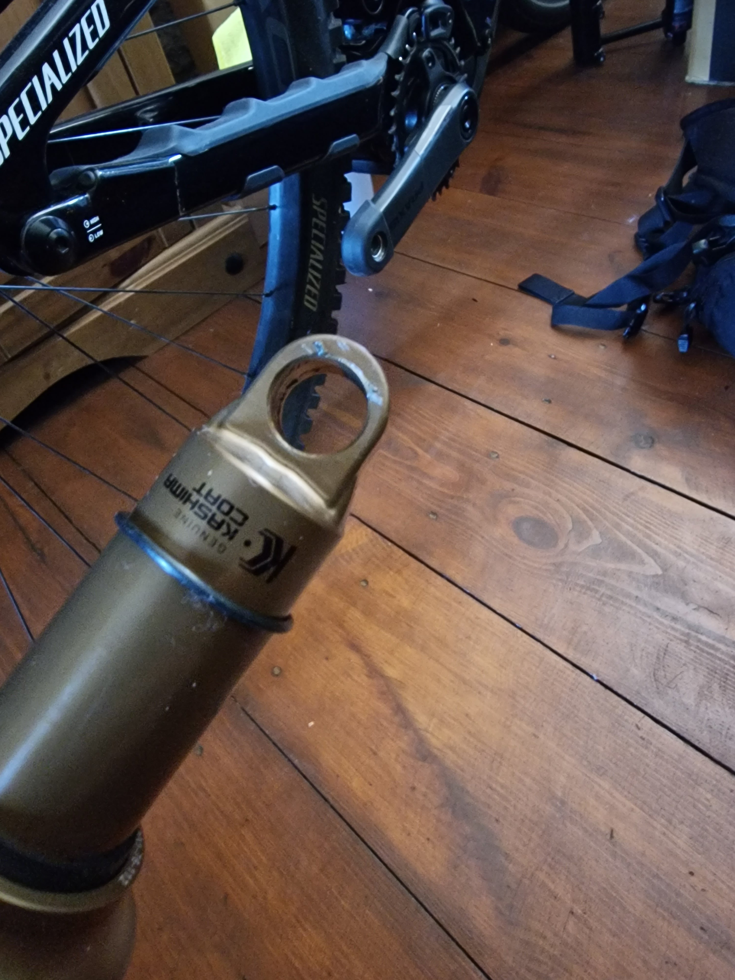

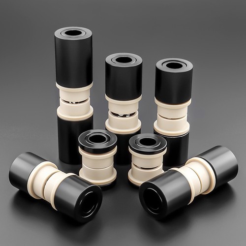

You can buy one of these from ebay but then you have to replace your DU bushing (read description from auction)
To do that you need the bushing tool to remove it from the shock eyelet
The top one you need 20mm width with 8mm inner diameter and the bottom one it has to be without DU bushing (see pic below)

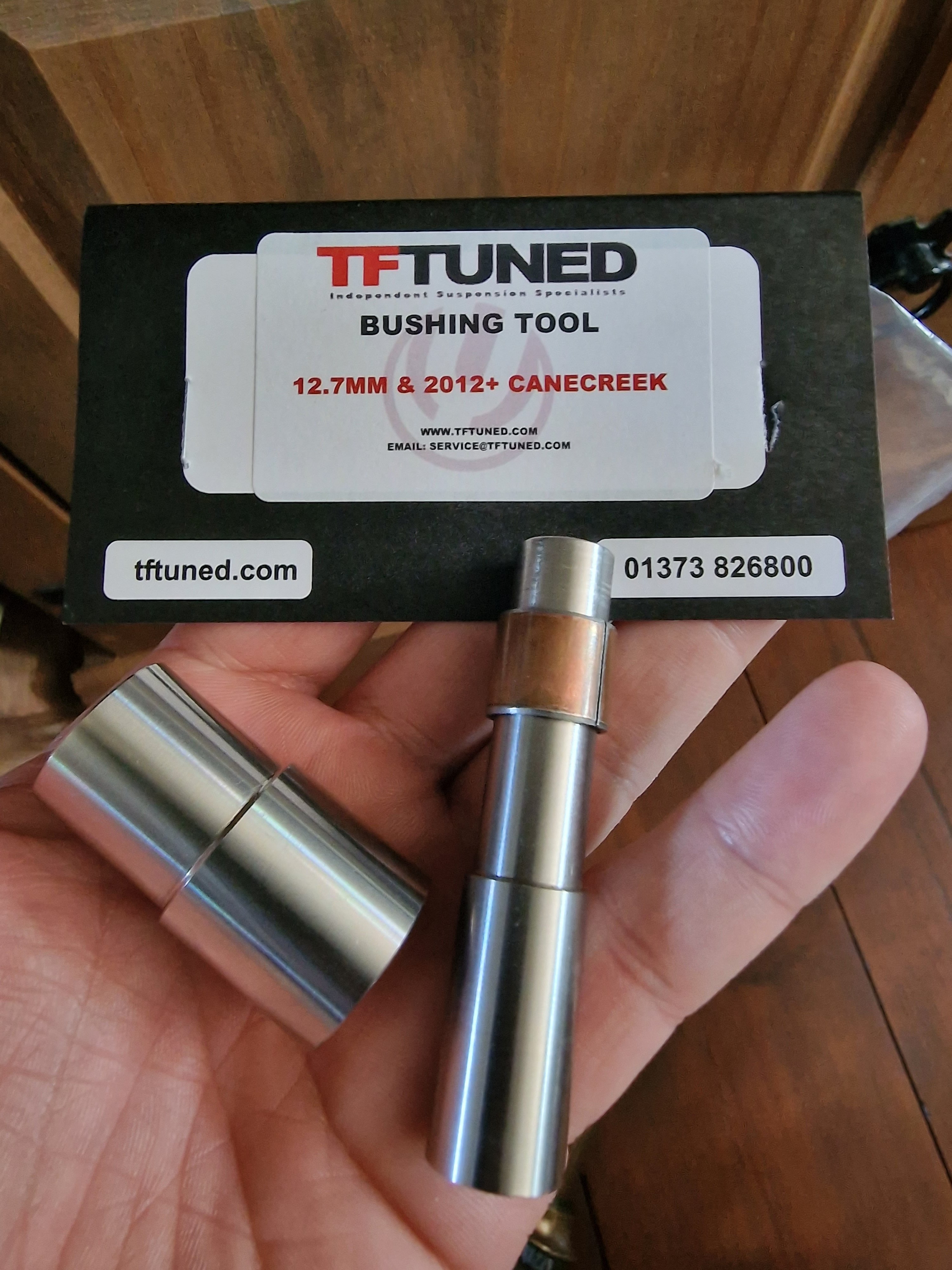

Here is the bushing tool from tf tuned
p3eps
Dec 14, 2019
1,987
2,410
