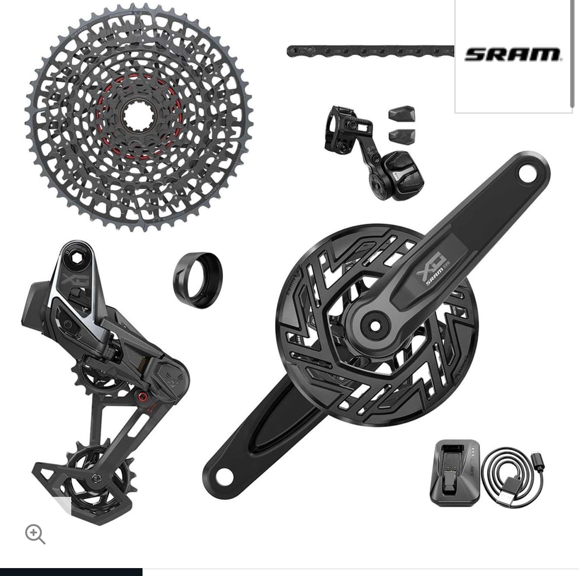

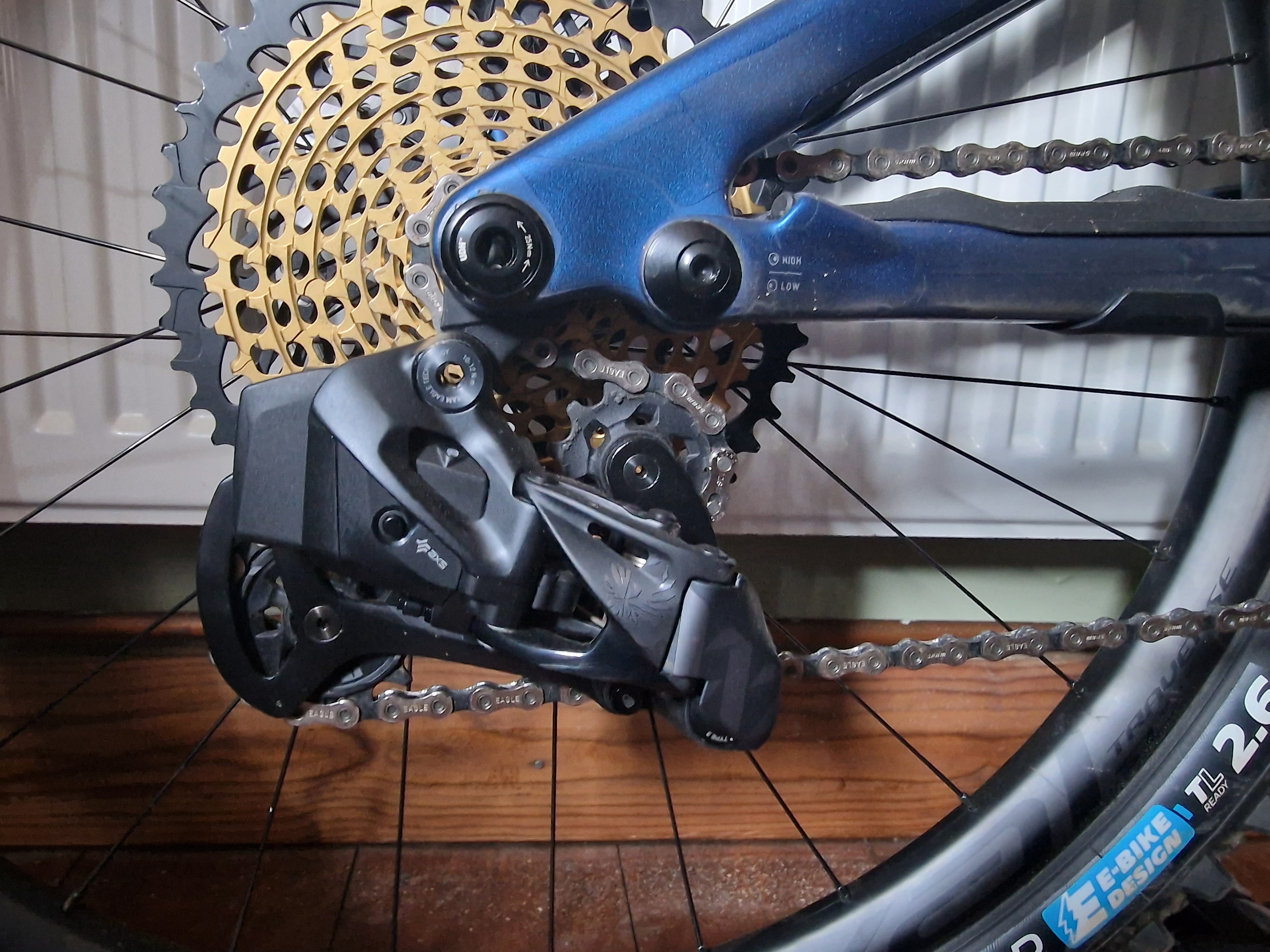

XO mech and cassette are identical to XX apart from the colour, available as a kit at slight discount here:
EDIT- Bosch version. Sell them crank arms and chainring? use existing. Or buy Mahle when they’re available.
I thought there was about 200g between them, and the X0 doesn’t have the cool jockey wheels that spin with sticks in them?!

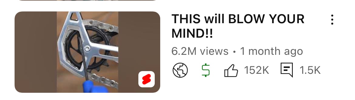

Weights are almost identical when I weighed them. X0 doesn’t do that magic wheel thingy tho!

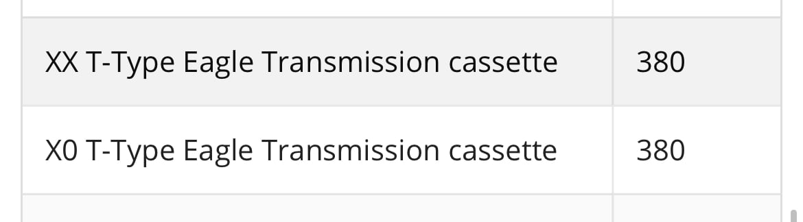

Derailleurs are basically the same otherwise. And the cassette is identical.

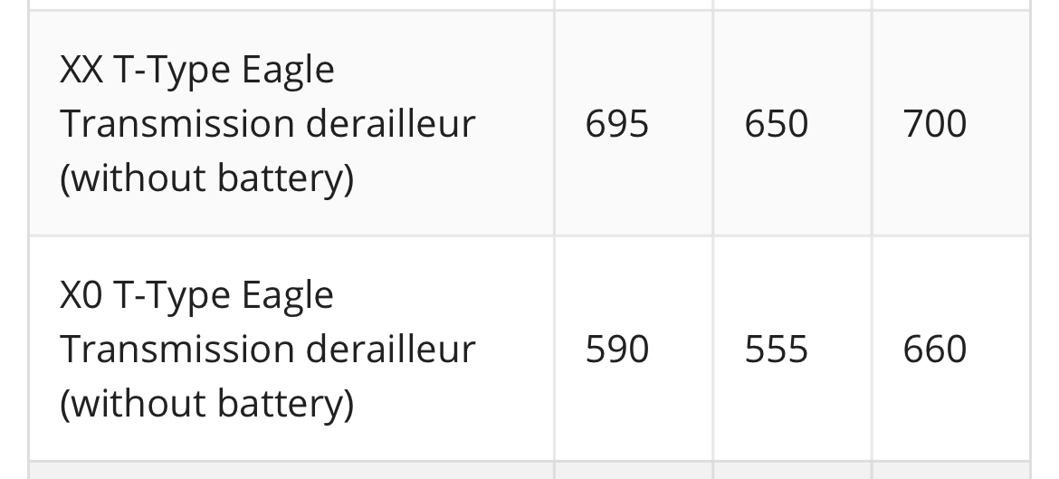

I fear you’re probably right about the discounts… wishful thinking!
It just irks me that they are selling a derailleur for £695 that doesn’t even include a battery… the price of early adoption I guess!
Cheaper to buy a kit. I sat and calculated all the bits individually on Thursday. A productive 30 mins at work 😂

X0 mech is actually lighter
FE93F5F4-2383-4ABF-84C3-B9A41A8E1749.jpeg 86C78A9A-8B99-471A-9410-2ED4853ADB57.jpeg

I put them side by side and there’s zero difference between them. All the parts are identical apart from the colours of both mech and cassette.
The only mechanical difference is X0 doesn’t have that magic wheel. But the X0 is 40g lighter as a result.
Even the X0 kit - mine actually came with the XX chainring, but in the photos they hide it with that horrible plastic cover. Not sure if they all come with the XX chainring but the Bosch one had XX chainring in the kit.
Pods are the same, chain is black and a different coating.
X0 is the sensible choice IMO.

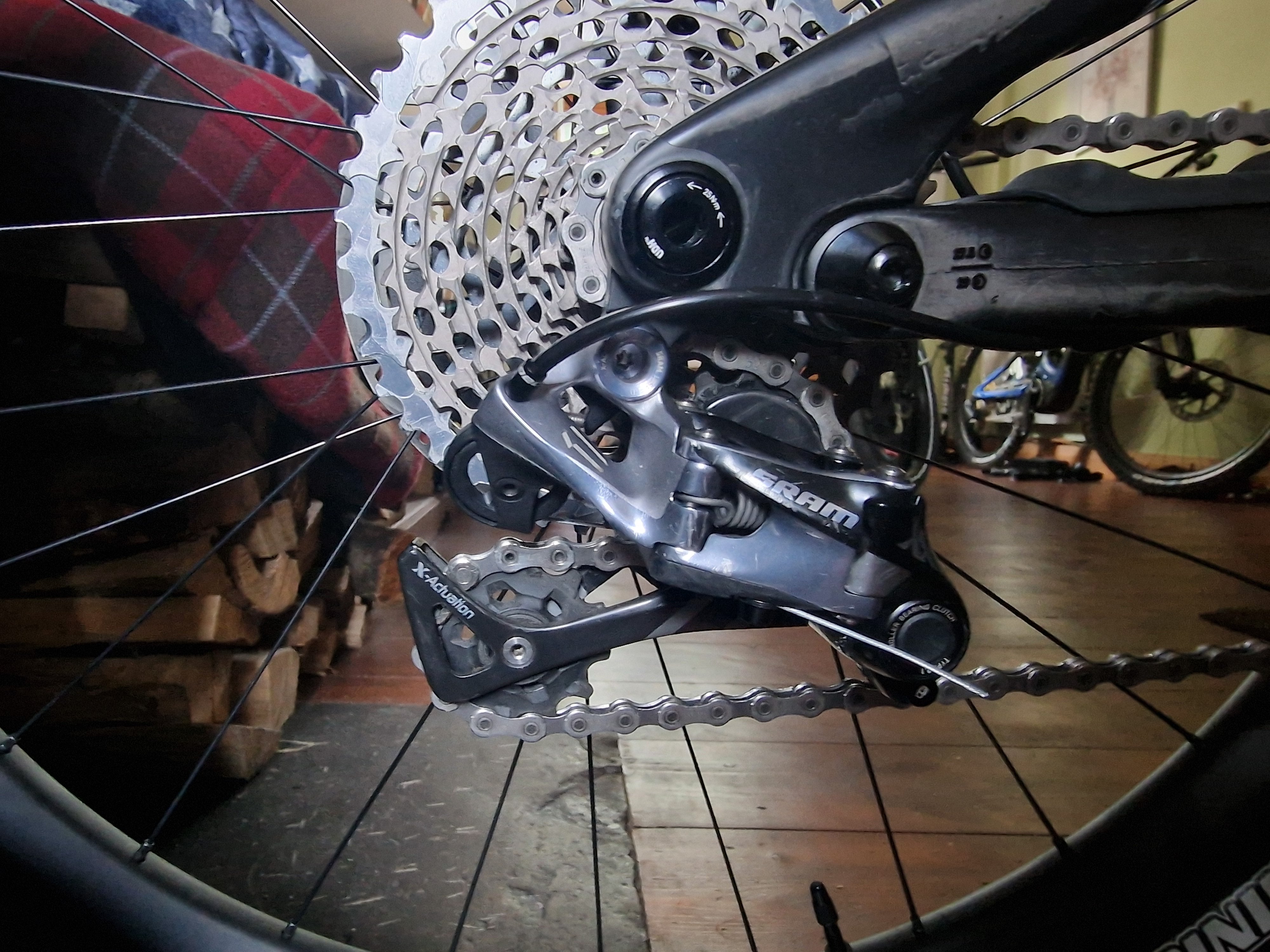

2 things… I still need to adjust the gears as they’re skipping a bit. Having come from an XL to an S4 (with a short chain stay) I guess I should be removing some links from the chain? How do I know how many?!

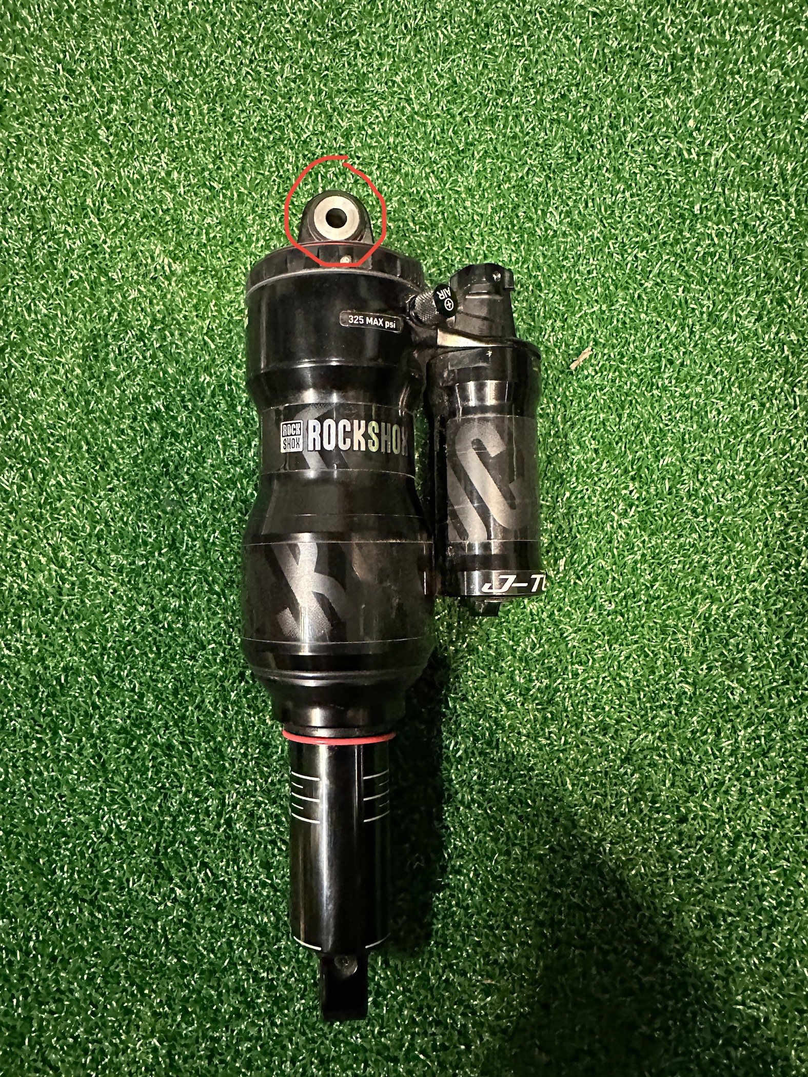

I went to put my Rockshox Super Deluxe in place of the Fox Float X… but the hole in the top of the Rockshox is too small for the bolt that came out.
Is there an easy way to fix this?
It seems like you need a new bushes with 8mm hole.
About the chain now
Shift to the smallest cog in your cassette and then when your chain is hanging you have to remove enough links to keep it slightly tensioned
Hope it helps
Thanks...
Do I just buy something like this and knock the existing one out? I wasn't sure if it'd have to go back somewhere to be modified?
I'll have a look at the chain length tonight. I'll need to take a heap of air out of the shock to get the sag for adjusting the B-gap!
