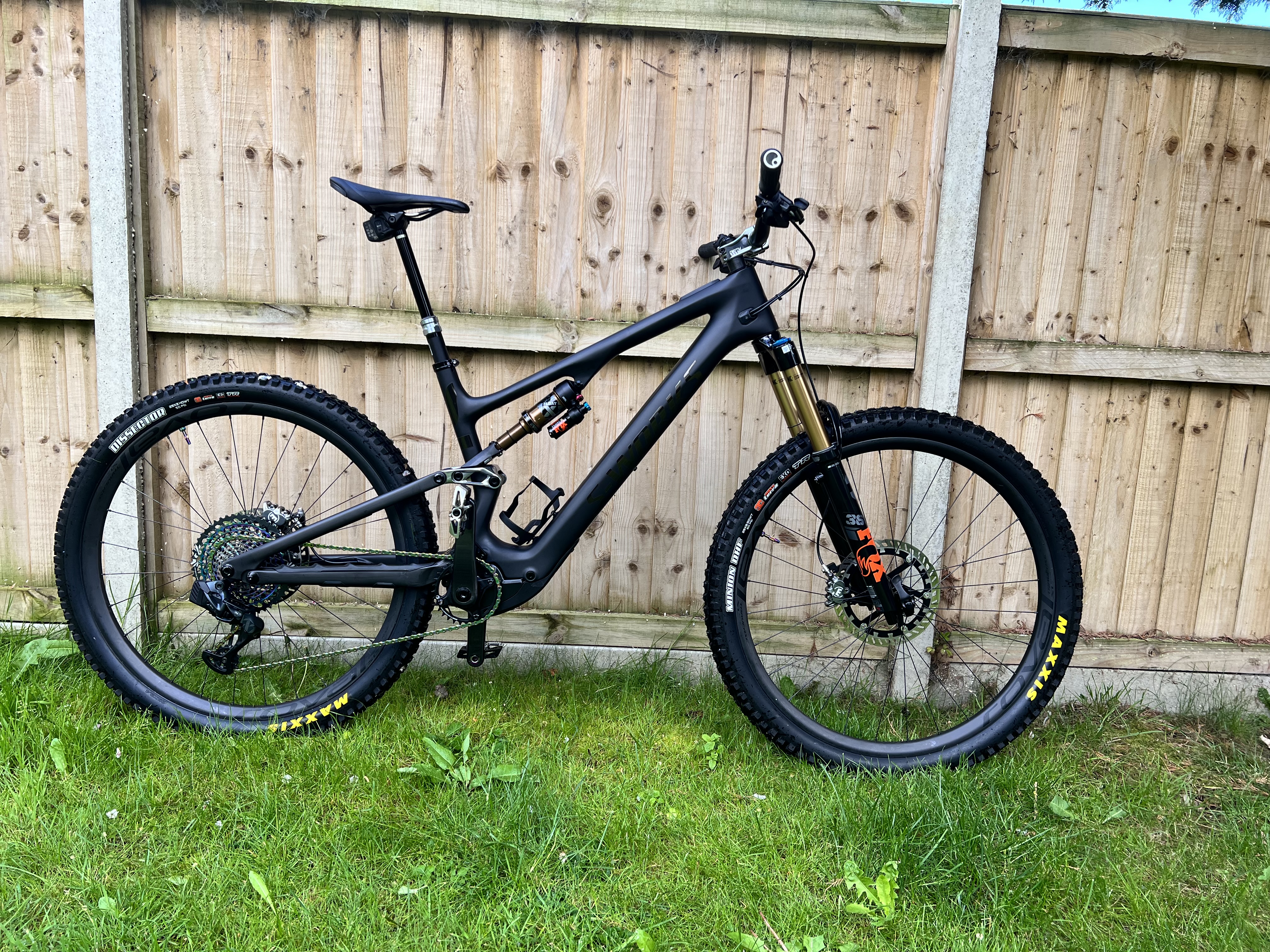

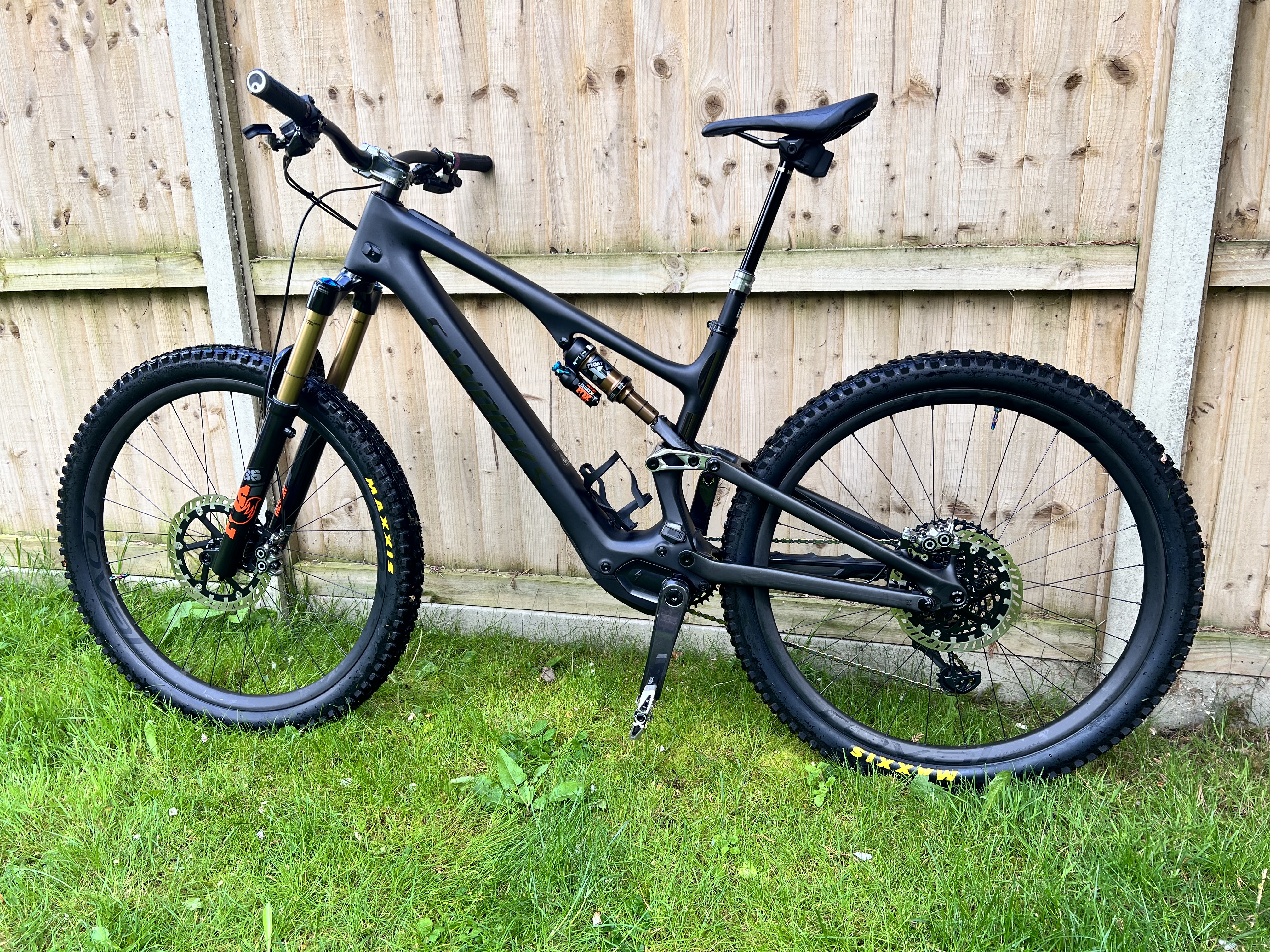

I’ve had a busy day so the frame has become a bike!
As mentioned above the chainring is backwards compatible with Eagle so I’ve re-used my XX1 AXS stuff off my Stumpy. Can’t quite get my head around the cost of the new T Type stuff, I’ll no doubt upgrade at some point but I think I’ll wait until I’ve worn out my XX1 cassette first!
I’ve only had a quick blast but the power seems massive to me (for my needs), I’ll definitely be dialling down the default 35/35 eco. I wanted one bike to replace my standard MTB and my EP8 EMTB, I think this has nailed the brief!
Re motor noise it seems pretty quiet to me, it’s like a slightly muted EP8 without the annoying rattle.
The only tricky bit of the build (other than bleeding an MT7… always fun!) was the chainring lock ring, I bought a Park tool BBT 79.3 socket but it only seems to grip the first few mm of the lock ring indents due to the spider design, I managed to do it up but perhaps there’s a better tool for this.
Looking forward to taking it out for a proper ride over the weekend!

Looks super.
Bleeding Maguras has caused me a lot of problems this week. Think I have finally cracked it now, key seems to be finishing with the pistons slightly out so you definitely get enough oil in, don't think the master cylinder copes well with having to give up too much of it's oil.

You’re talking total sense with the frame protection, think I’ll probably order it.
Looks awesome. I’ve just heard mine is at the main branch, so it should be at my local one tomorrow. It’s my wife’s 40th birthday tomorrow, but I’m hoping I can slip away for an hour to collect it!
I was away to order that Park Tool BBT-79 just now so I’d have it for the weekend. Is that not what I need after all? No point in spending £35 on something that only does a half job!
The Maguras are probably the bit I’m dreading most. I’m also not sure if I have enough slack on my current hoses to let me cut the rear and re-attach… as I made them about as short as could to keep them today on my current bike!

I think I messed up on the tool, I got the Park BBT 79.3 which has a much thicker wall, the Park BBT 79 looks lower profile in the wall of the socket so that should do the trick 👍🏻
