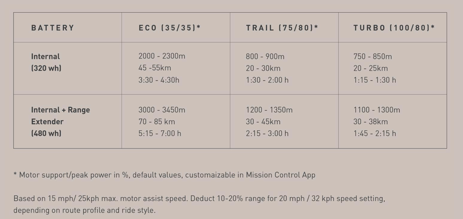

Haven't seen this here. Just for reference, no mention about rider weight.

I did a range test this morning and I’m a little surprised. I got 15.5 miles with 1600ft of climbing before the bike went dead. I’m thinking that I weigh at least 215 pounds with my gear & hydration pack. I had the power turned all the way up- 100/100. Im not gonna lie, I milked it a little. I think the reason might be that when the battery gets to 40% or so the bike starts to lose power and that last 40% goes a little further because the battery can’t discharge at a high enough rate anymore to power the bike 100%. It kills me that Specialized built the ultimate SL chassis and fitted it with a shit-burger of a battery.
Not so good news indeed, did you notice the loss of power during the last half of your battery ? @Desert_Turtle
Suns_PSD
Jul 12, 2022
593
513
Austin
I'm not judging, and you're a great contributor, but if you plan is to run is at 100/100, wouldn't you be better off with a FF e-bike? Or even the Relay since it has more 38% more battery capacity?
I have no practical e-bike experience, but I commonly hammer out 14-18 miles on very chunky terrain at around 6.5 mph average on my SJEvo; or 18-28 miles on still chunky but with less elevation at about 10.5 mph on my Spur. Neither are e-bikes.
I just assume that (approximately speaking), if the SL is '2x me' at it's max, well it's more typically 1.5x me since I average mid 100 watts for my pedal rides. As a result, I'd cover approximately 20-30% more miles as 50% more power does not equate to 50% more speed, in the same time period, with a 20-30% higher average speed. In reality the climbing speed is likely 50-80% faster where-as the technical bits are no different than a pedal bike.
For me, that's a real big ride getting in (for example) 22 miles of heavy chunk and steeps. Sound about right to you?

Maybe I am confused and I appreciate any clarification. In your post, you state the following, "I did 23 miles and covered 4180 of elevation". Was this particular ride using the internal battery and range extender, or just the internal battery?
