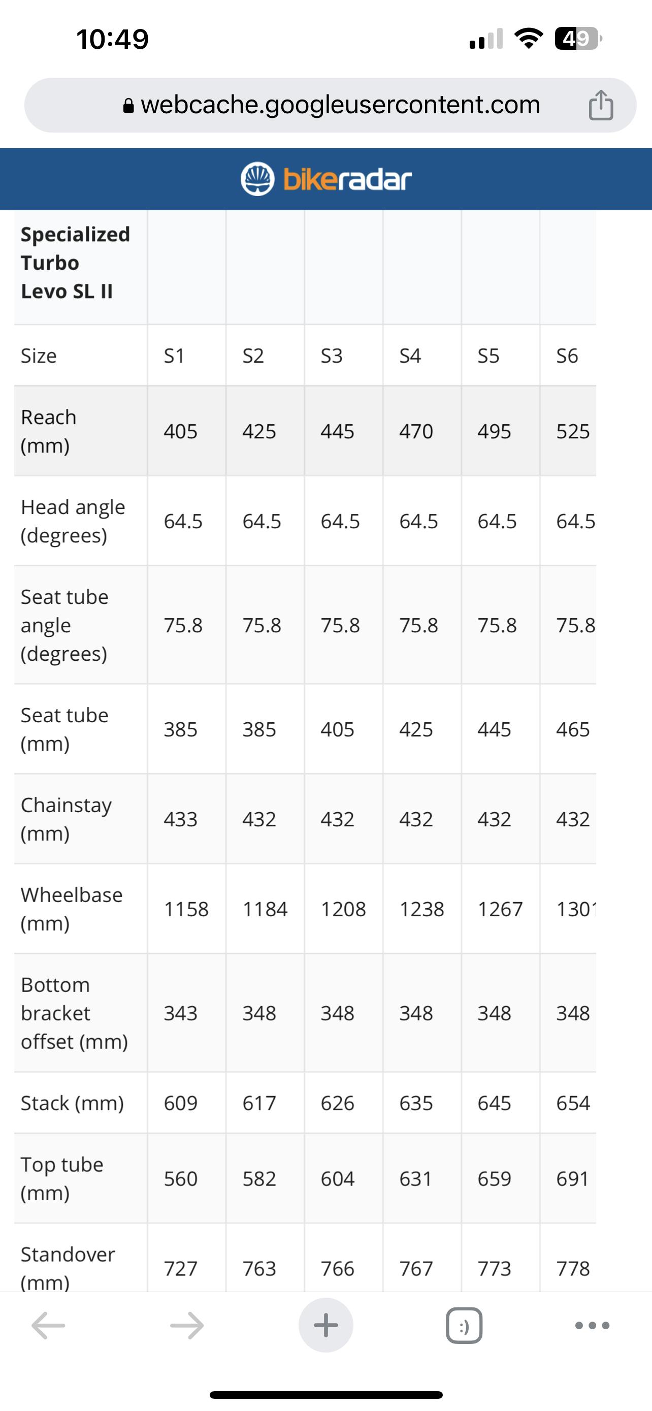

432mm chainstays… i wonder what pivot and superboost have to say about this.
liking the solid eSTA (can steepen by .5) and more conservative reach. always felt a little extra pressure on the hands on the levo 3 vs my levo 2. curious what stem length they’ll use on an s3.

Unless there are still mistakes, I do like the numbers, they suggest Specialized keeps to their usual focus on broad appeal. The bicycle is rather short-ish in reach, has more traditional seat position in back, but gets aggressive head angle and long (for trail bike) & plush suspension numbers.
That is much more attractive and easier to ride for majority of people than something like Pivot Shuttle SL. And it's also what Trek EXe TQ would be if it had bit more squish. It's also smart decision to not make niche bike even more niche (by giving it full EVO numbers and cannibalizing Kenevo SL, though I wonder if they regret having two SL bikes, I am happy they do though).

I wonder if this will steepen the head angle to 65+?
I saw a geo chart on bikeradar and my understanding is that you can change just the chainstay adjustment and when combined with a 29" rear wheel, geo is all exactly the same except for the longer CS length.
Unfortunately if you tried to combine the 29" CS position with say a 27.5" rear wheel to get the long CS length, you'd get a considerably slacker STA & lower BB height.
The SL also has a high/ low shock adjustment which steepens the sta/ hta around .5' and raises the BB height about 5mm independent of rear wheel.
Personally, I like full 29er. However I just built a new 27.5" rear wheel that I'm pretty determined to use on this build.
I do suspect that a new KSL will be released with similar updates next year that'll hit my personal targets a bit better. For me, I'm always on 150/160 bikes and it feels right for pedaling so I want the Enduro geo, on AM travel. But I'm probably an outlier in this regard.
