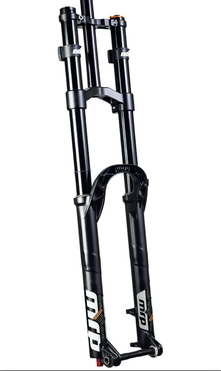

Am I the only one that dreams with brands manufacturing big coil spring forks again like MZ66 (38mm stanchions), Fox Van (36mm.), RS Totem (40mm.)??
Those masive stanchions would fit perfect with the Kenevo, new Commençal Meta Power and all long travel enduro E-bikes giving them, stiffnes, smoothness and less maintenance.
What do you think about that?

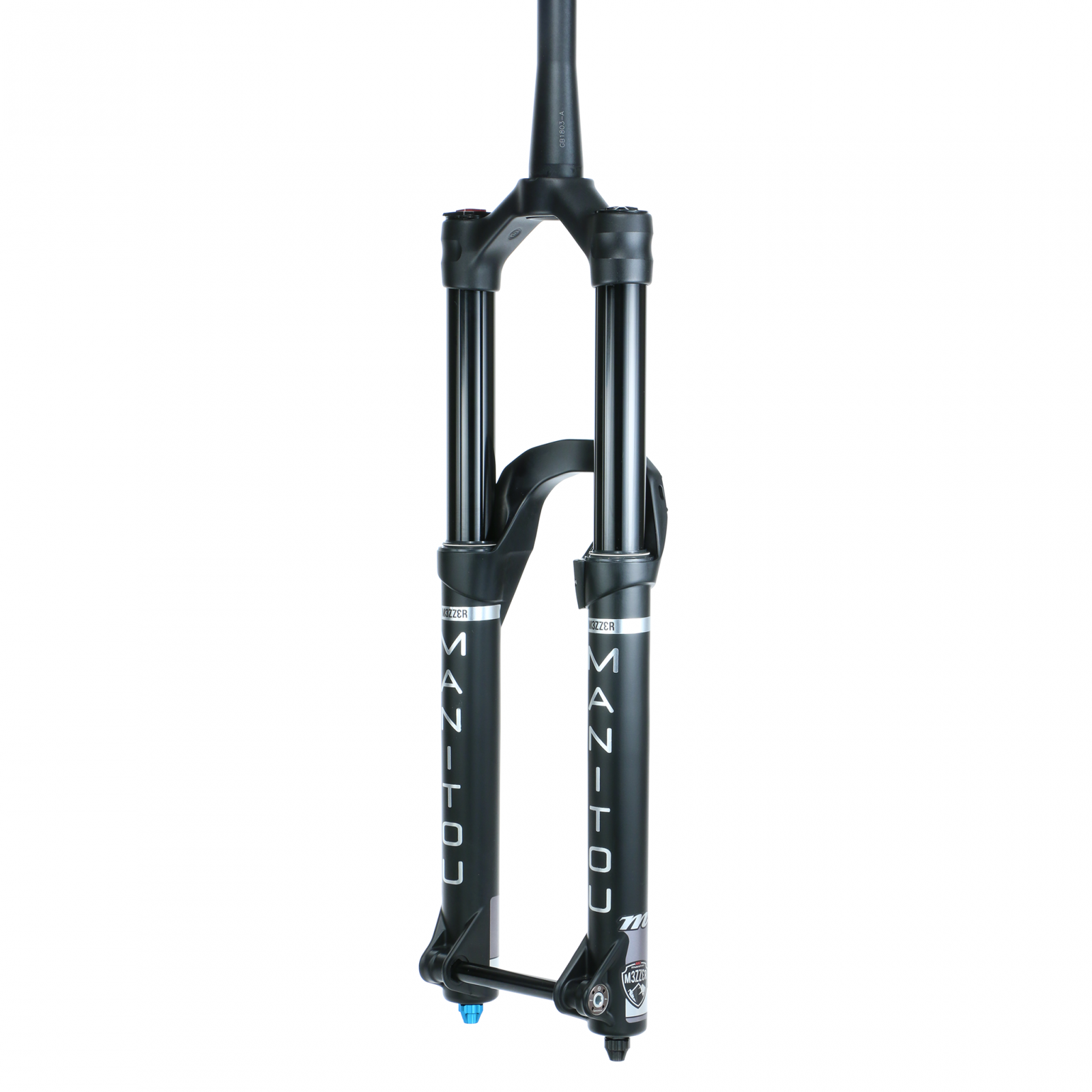

Nothing wrong with your analysis, but IMO they would have been better bringing out a larger diameter fork, say a 37, as for all intense and purposes the EBike fork is a burlier Fox 34. You are basically getting a 34 with thicker stanchions.
I ordered one of these for my Kenevo
It has 37mm stanchions

I still think that the MRP Bartlett, which is basically a dual crown Enduro fork in 170, 180, and 190mm travel options, would be a great choice for a heavy hitting EMTB.
I know Mojo Rising are working on a dual crown conversion kit for the Fox 36 too
