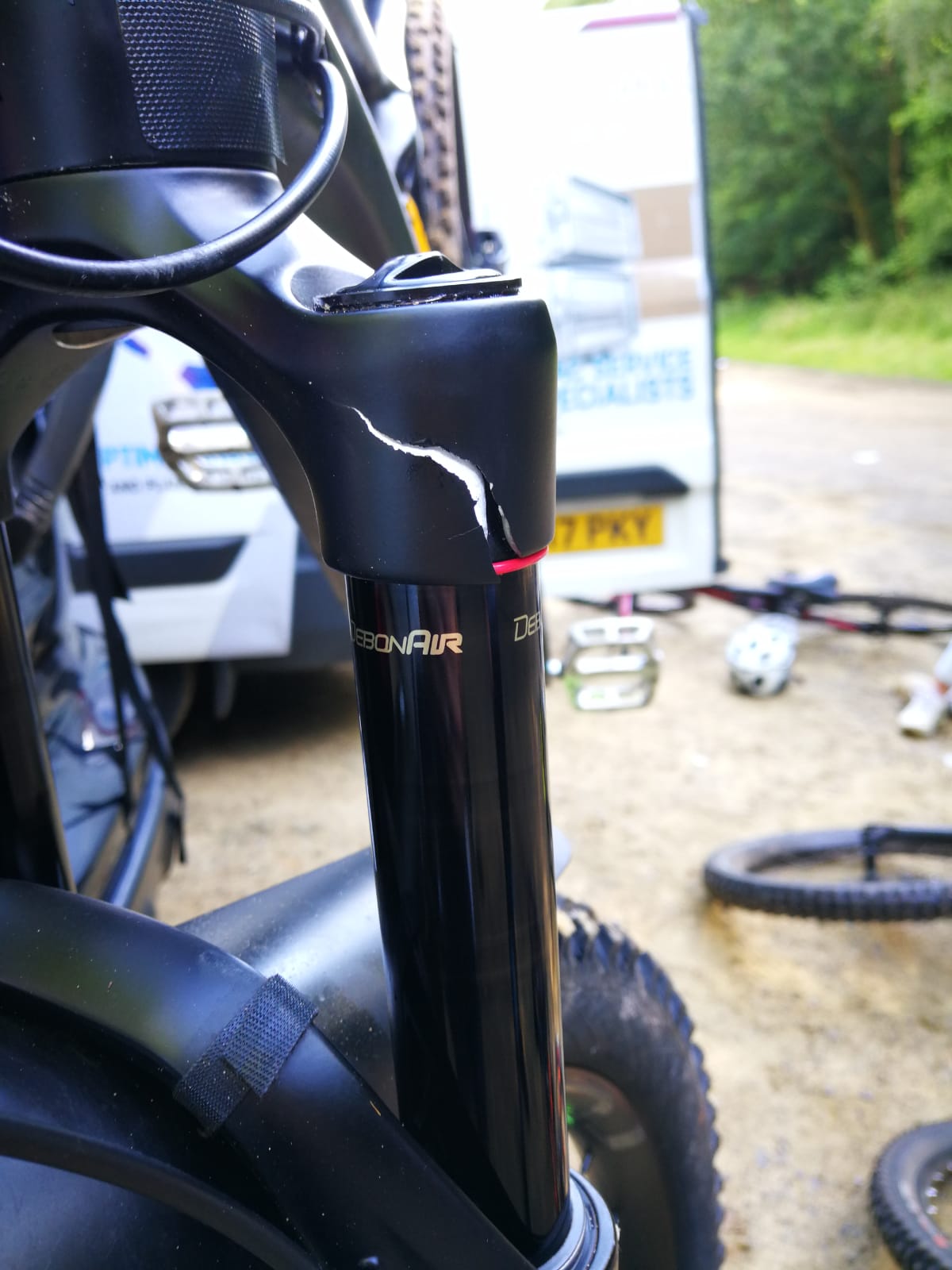

It’s a picture of a cracked eBike crown, that’s a pretty good case for having a stronger crown, no?
Clearly eBikes don’t need an eBike specific fork, but clearly more force is exerted through eBike frames and components, so there is a case for stronger/more durable components.
The likelihood is you’re not missing out on much, but there is still a fairly good case for having them.

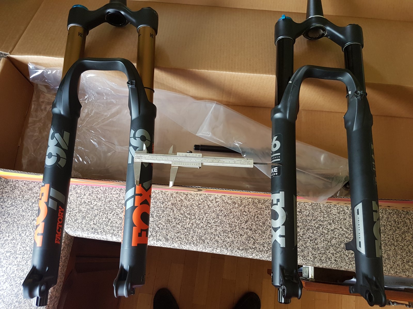

My new Fox 36 factory on the left, Fox 36 performance E-bike fork on right.
I have measured them up and externally I can not find a difference.
raine
May 9, 2019
398
325
SoCal, USA
View attachment 16785 My new Fox 36 factory on the left, Fox 36 performance E-bike fork on right.
LOL of course not - it's been said multiple times now in this thread (one of those times literally 2 posts before yours) that the E-bike fork has 36mm stanchions with thicker walls - so outside it's still going to be 36mm stanchion outer diameter with 36mm lowers.
Measure the inside stanchion opening and measure the damper diameter and it's different.
Why won't this thread die LOL

Ha ha ha well it should now, I have bit the bullet and bought a pair. Thanks for the input .

I am all for stronger more reliable, the forks I bent twisted on the arch or bridge connecting the lowers, I think that's a week spot. The non Ebike fork bridge is identical. The wall thickness of the stanchion are 1mm thicker and the only difference so use smaller internals. Imo that isnt enough to justify calling them a specific fork.

Yes stanchion wall 1mm thicker or 40 thousands of an inch in old money. I checked the crown and it looks the same. I am also a tight Welshman, it broke my heart paying £720 on Fox 36 float factory grip 2 forks. I honestly cant see how they can charge £1140 for a similar fork with an E-bike sticker on it. I will start another thread if I bend these ones lol.
