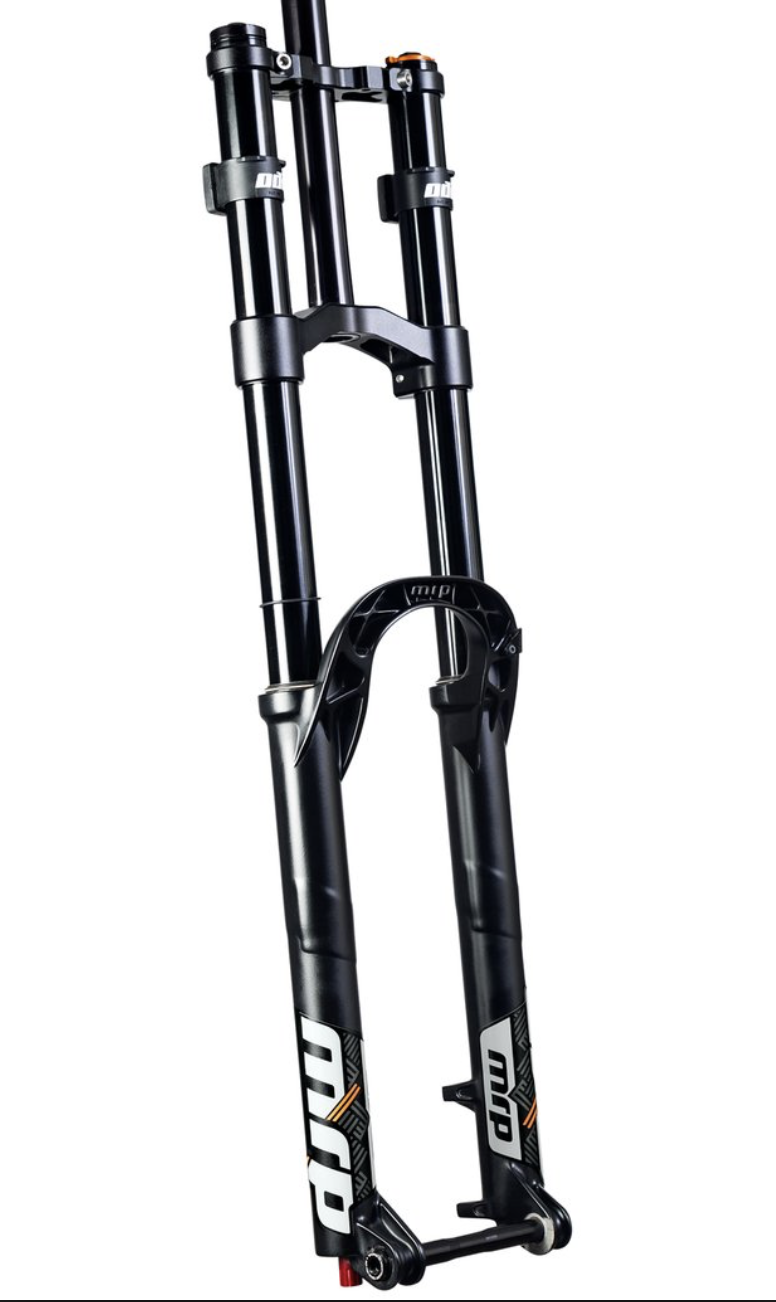

I still think that the MRP Bartlett, which is basically a dual crown Enduro fork in 170, 180, and 190mm travel options, would be a great choice for a heavy hitting EMTB.
I know Mojo Rising are working on a dual crown conversion kit for the Fox 36 too
