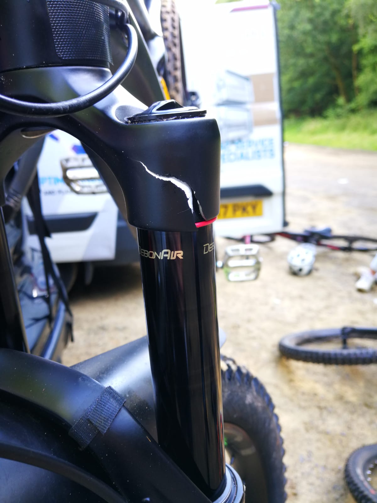

My friend sent me a picture of some Kenevo forks after a Surrey Hills session at the weekend... ?

That's nasty. If it wasnt damage from a crash, could he claim on warranty ?...... oh and the important question, Are they Ebike Optimized forks ?

It did make me chuckle seeing this after reading all the posts on how eBike specific forks are pointless.
It’s not from a crash. I know this guy likes big jumps and has the skill to match, so it’s not your average rider.
I think the Kenevo just has standard the Lyrik.
9,190
I think the could happen, and I have seen it happen, on any bike. All that says to me is put some dual crown forks on!

Lucky he spotted that before hitting another jump. It makes me think if your going to be doing jumps and DH then maybe you should go tripple clamp sooner than you would on a normal pedal bike. I certainly noticed way more flex on my old suntour forks than I have on a MTB before, I suppose another 10-20kg plus slack geometry of modern bikes.

For me its the crown rather than the stanchions that are the concern - my understanding of the fox ebike specific ones is that have thicker stanchions, but also a solid crown rather than a hollow one.
Fox e-bike specific forks have extra material in the fork crown and thicker stanchions. Also, the 36 e-bike fork uses a FOX 34 air spring, and the lower legs are the same as a regular FOX 34 fork. So basically the upper half is where there is a difference.
