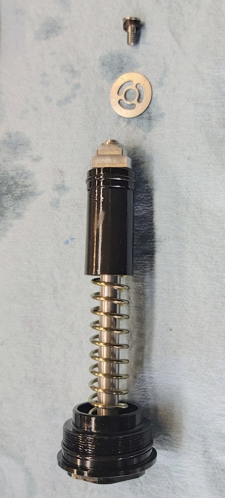

leftside
Mar 26, 2020
493
324
Vancouver
Sorry to raise an old thread from the dead, but I just wanted to share the internals of a Fox 36 ebike specific fork that I've broken. Would this also have happened with a "regular" fork with "regular 36 (and not 34) internals? I'm not sure to be honest.
I'm now looking for another fork whilst the warranty replacement is processed, and searched to find what differences there are between a "regular" fox fork and an "ebike specific" fork. I did find this thread to be useful - so thanks.
I'm pretty desperate to be up and running again, so will take whatever decent fork I can find - "regular" or "ebike specific". Think I might have found a "regular" Fox 38....
Does the Fox 38 now make this less of an argument? Even though I see they also have an "ebike specific" 38...

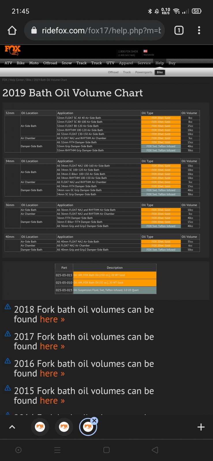

SEBA
Sep 11, 2019
364
137
French Provence High Alps
where to read oil quantities for an ebike fox 36 fork 2019 please ? to the 36 lines or the 34 lines ? I ask that because its confusing , ebike 36 fox is 34 inside from what I ve read here and here ...
