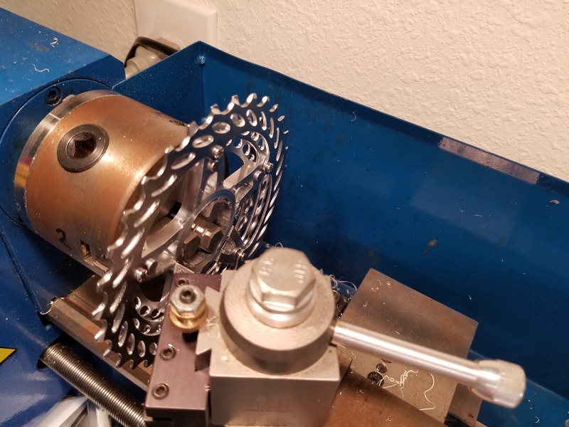

I bought the cassette not knowing there was a difference between MTB and Road, my old 9 speed MTB has had road cassettes for many years. When I went to put on the lock ring it was obvious it would not engage the threads, not even close. I measured 2 mm then found on the web that it was 1.85 mm.
The reason is because the smaller large cog of a road cassette may foul the spokes if it is too close to the hub, MTB cogs are usually large enough that this is not an issue. How small can we go? I don't know.
I chucked the spider portion in a lathe and turned off 1.85 mm to a bit more than the diameter of the freehub and assembled the cassette, it all fit this time. :)

Thx, so you remove material?

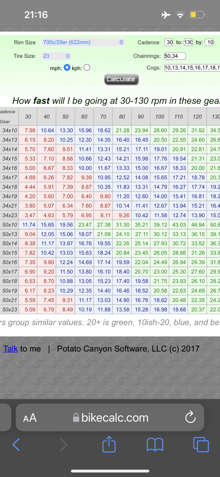

Ciao, actually i have 34 chainring and of course this affect all my 12 sprockets. I choose to get a bargain deal to get the focus thron 2 6.9 version second hand not only for the shimano drivetrain but for the better sospensions and brakes… I can say I found 12v on it for free and I found Xt derailleur works very nice… let’s start to think about 13 rear with 36 give you a slightly harder gear, but you have to look also which cadence you can mantein and which speed are you able to reach. Also your weight, your level of fitness and even smaller things like the measure of your cranks could give you differents results and sensations. I think this is the most beautiful part of cycling.

10x34 is a much higher gear than 13x36
11x36 is much closer. And unless you're very poor at spinning should allow you to reach around 30mph.

I know it Gary, the fact is I am able to push even more that 10x34… and When I’m not I’m searching for more close gear ratio in the last part of the cassette…. Which is the part I stay more, even on the hills.

singletrack is crazy😂never said i’m able to do it. I’m talking when I’m commuting to work on asphalt.
And with 90 rpm I reach only 24mph with 34x10.
When I started cycling with road frame I was much incline to spinning higher rpm but I learned how to control myself and stay on 90 wich is better in my opinion.
