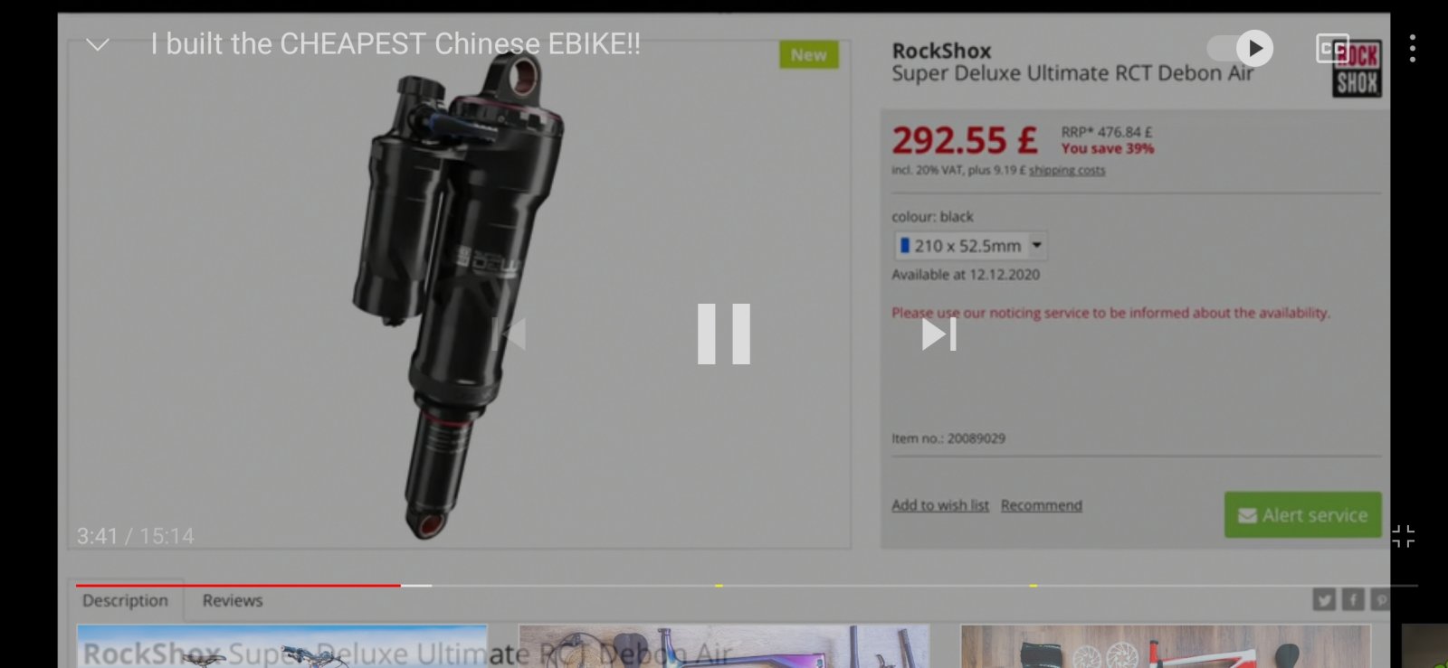

I did purchase the 210x55
So you'll have to take care next time with components that are integratedin your videos ??. Thanks Rob for your answer ?

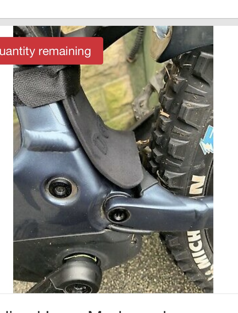

Cajos
Jan 20, 2021
9
12
Sweden
Hi. Would this dirt guard be a good idea for the e10 frame or is it not needed? This pic is from a levo. Do the e10 have the similar problem with dirt/snow/pebbles being trapped?

Waynemarlow
Dec 6, 2019
1,140
914
Bucks
As an alternative to the Levo style, I have been using a front mudguard set down between the rear triangle as most of us have been doing plus putting a small piece of foam in the gap between the rear triangle and the main frame, where there is any likelyhood of stones or mud getting into.
