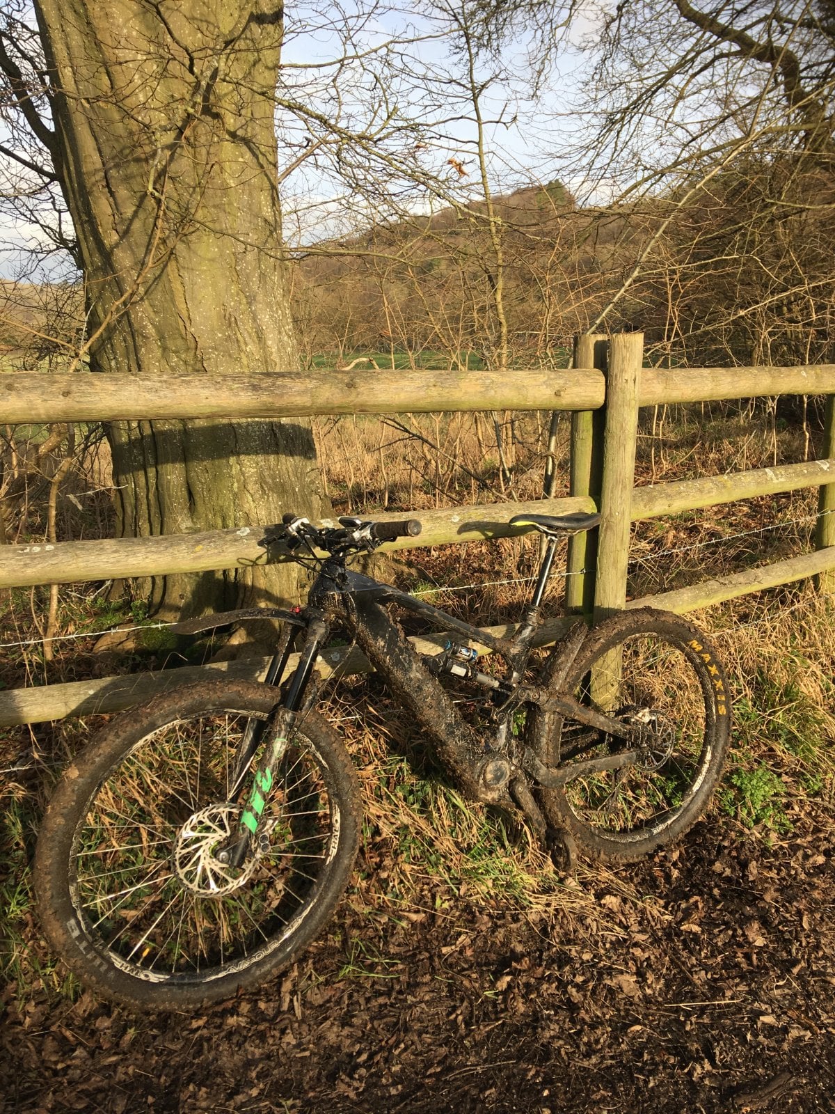

Muddy times for the E10

Cheers I have both sets of wheels so will see when it turns up how long have you had your frame have you had any problems?
I bought my frame in September, but I have only ridden it a handful of times. Its my first ever new frame in 35 years of mtb riding and this year with all the lockdowns, the foot traffic together on every path and trail with record rain and very little wind to dry, has meant every trail is a mudfest. My E10 has been parked up in favour of my converted Whyte, which has already endured 6 years of mudfest every winter and is now past any chance of winning a beauty contest shall we say, ready for the summer. Mud and hard slog in the wet, is extremely abrasive on new toys.
