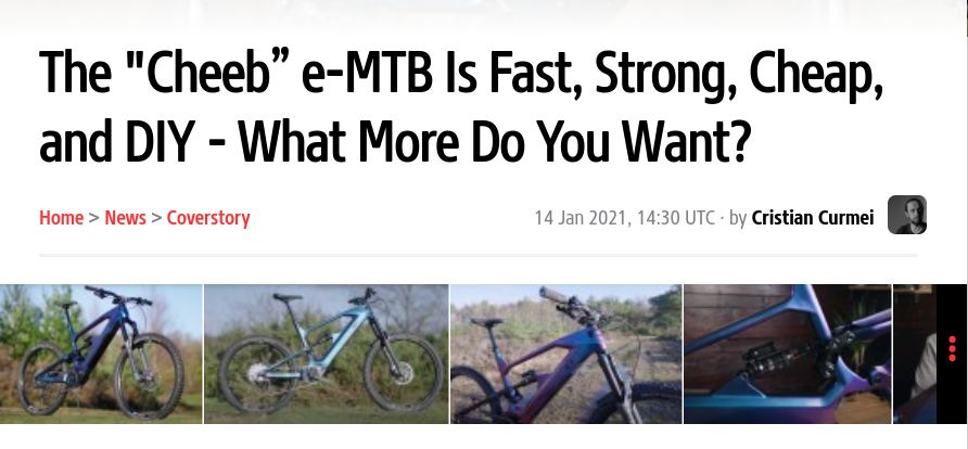

My subconcious is obviously way out there at the moment .. I read : Home > News > Coverstory
as Home > News > Controversy ..... :unsure: o_O:LOL:

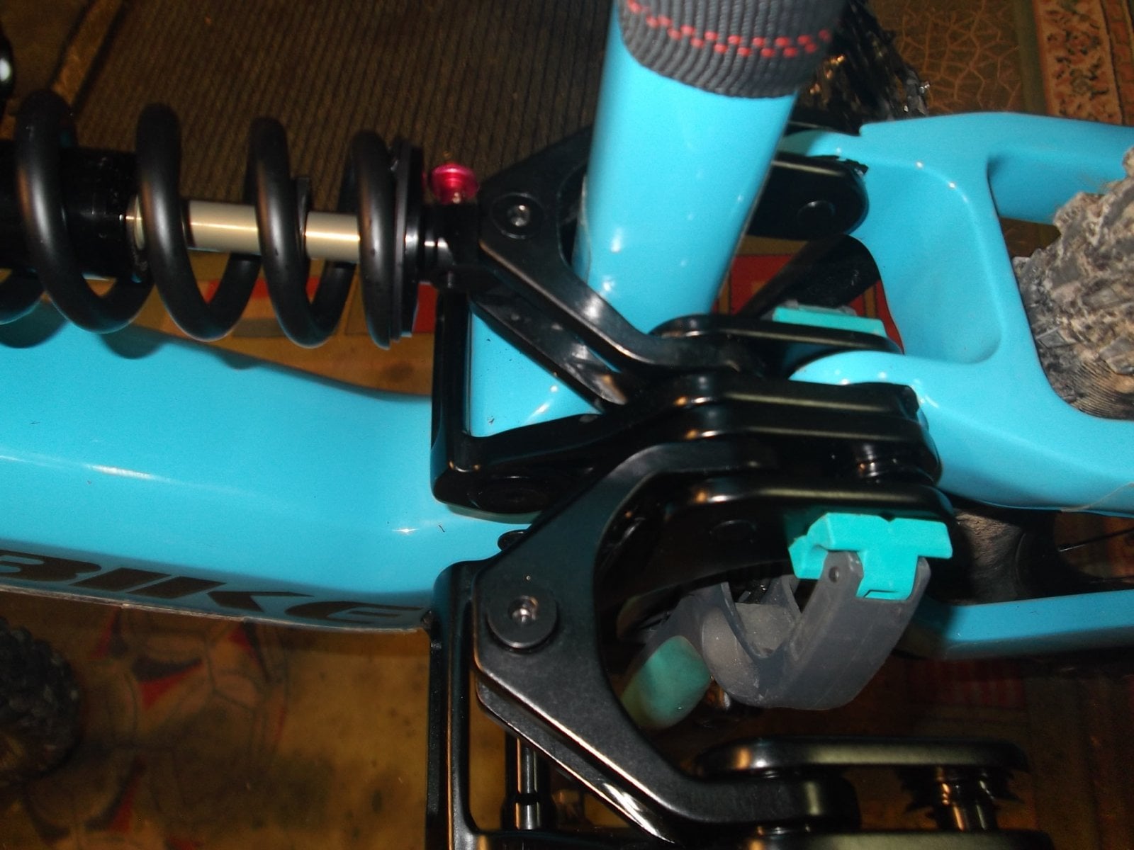

About the modification done on yoke to use 215x60:
original yoke width is 26.4mm. i have reduced mine to 22.5.
I have mounted 215x60, after: 1) calculation 2) test. I say "on my frame it is working". May be 216x63 also, but I don't guarantee it whitout testing. This frame is not a "piece of wood", i find it permissive and may be it have some flexibilty. It is the raison why i prefer to keeep safety margin of 5mm rather less. In any case i do not recommand to use 200x57 (may be it is these people who speak about broken frame ?)
Thanks for the information. Appreciate it
