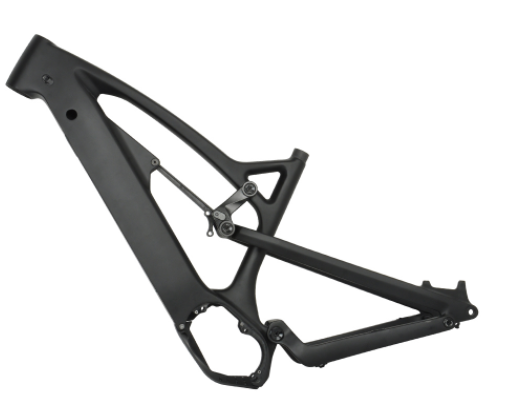

A 170mm dropper post will fit into a Medium frame.
Be aware that the frames come up on the large side, my medium fits in between the med and large Whyte frames I have.

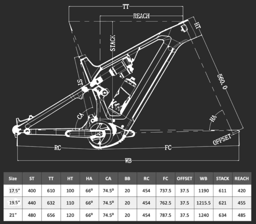

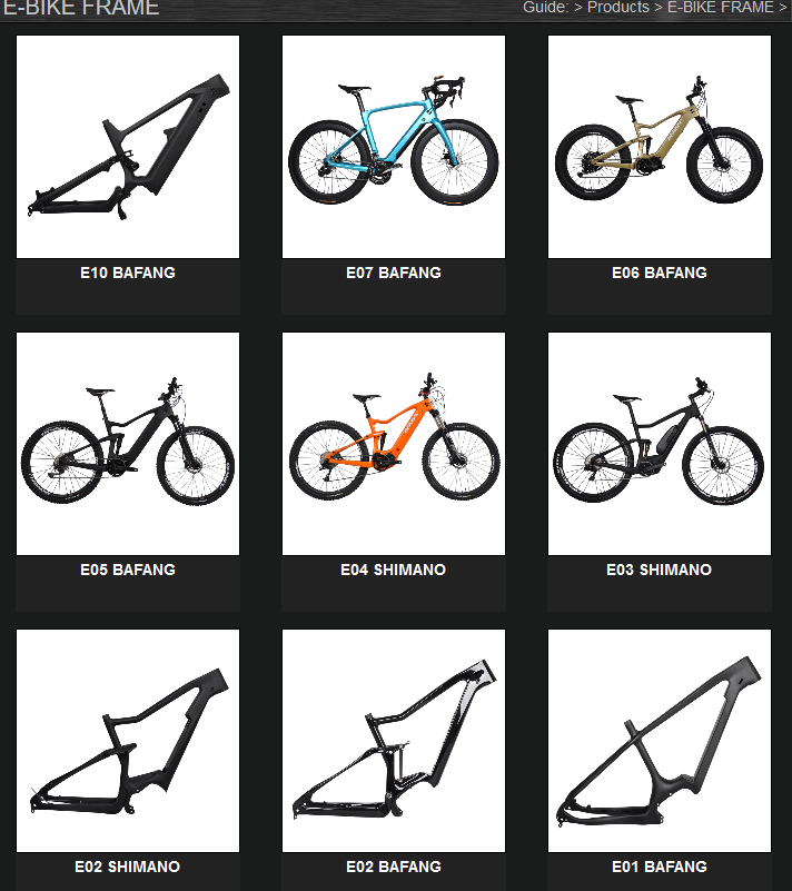

Yeah that is bizarre, the frame above the spec sheet is definitely a different rear suspension setup to the bike pictured. so I wonder what you get if you order one given they only have one model on offer so far.Interestingly, the TOSA website shows a different frame in the AM1.0 geometry specifications. It looks to be derived from a real 3D CAD model, which implies that Dengfu may be making another eMTB frame soon - slightly more trial orientated, but possibly not with the Bafang M 500/600 motor ?

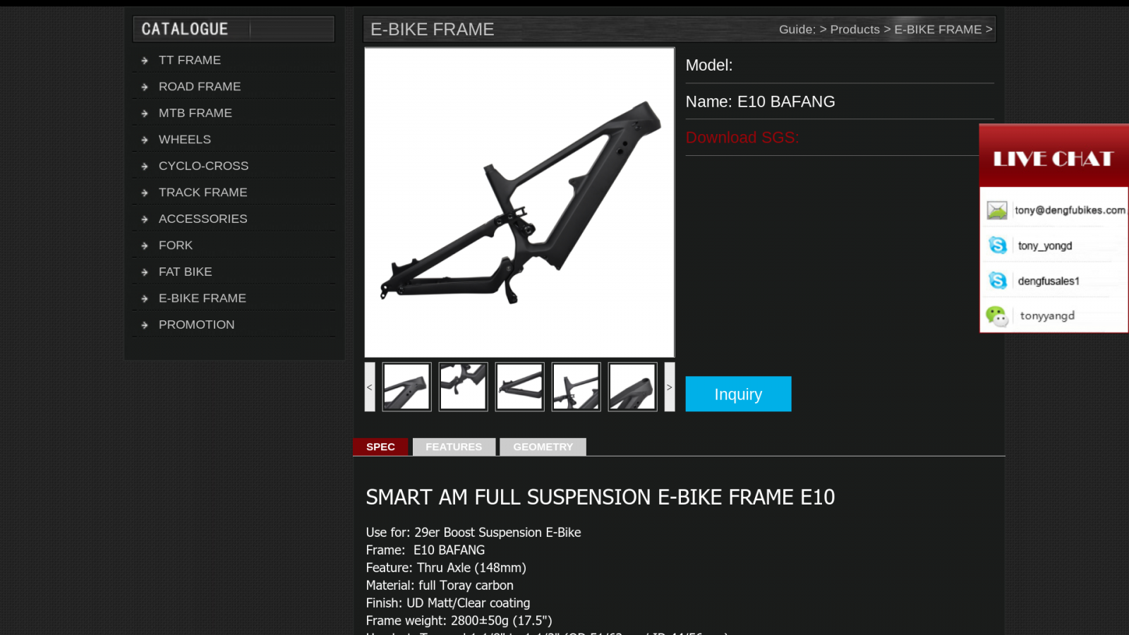

E10 BAFANG_dengfubikes 11
SMART AM FULL SUSPENSION E-BIKE FRAME E10 Use for: 29er Boost Suspension E-Bike Frame: E10 BAFANG Feature:Thru Axle (148mm) Material: full Toray carbon Finish: UD Matt/Clear coating Frame weight: 280050g (17.5) Headset:Tapered 1-1/8 to 1-1/2 (OD 51/62mm/ ID 44/56mm) Frame travel: 150mm Available...www.dengfubikes.com
Could just be a website error ... looks like it still exists .. unless you've pulled it temporarily due to Hancill fuelled global demand ..with me it still does not work. still hope they respond to my order ?
