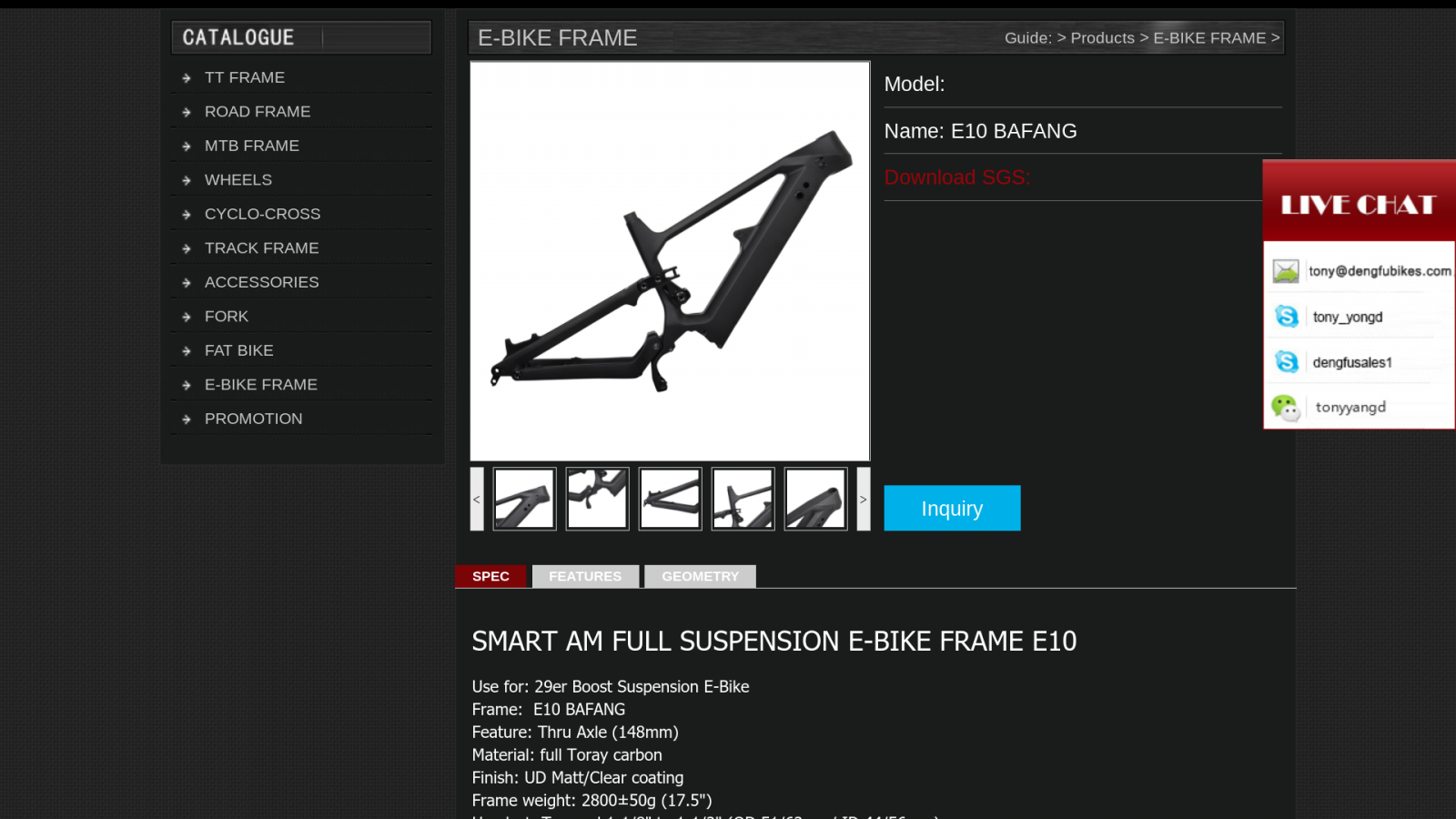

Could just be a website error ... looks like it still exists .. unless you've pulled it temporarily due to Hancill fuelled global demand ..
Just took this from the link I posted ...
I wait anxiously for their answer. would like to have something to use my spare parts on

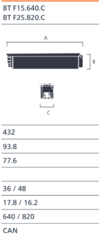

I have a question about the battery.
On the website from Dengfu they say it is a Dengfu battery :
What are the dimensions of the battery ?
Can it be compared with the Bafang 820Wh battery or is it totally different ?
it’s totally specific to the shape of the e10 frame. Don’t have measurements to hand, but I doubt any other battery will fit as the shape is unique.
