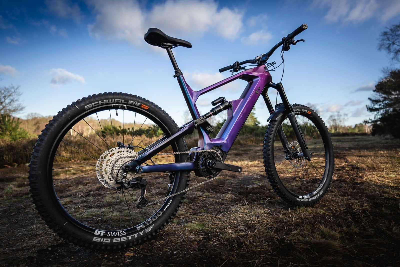

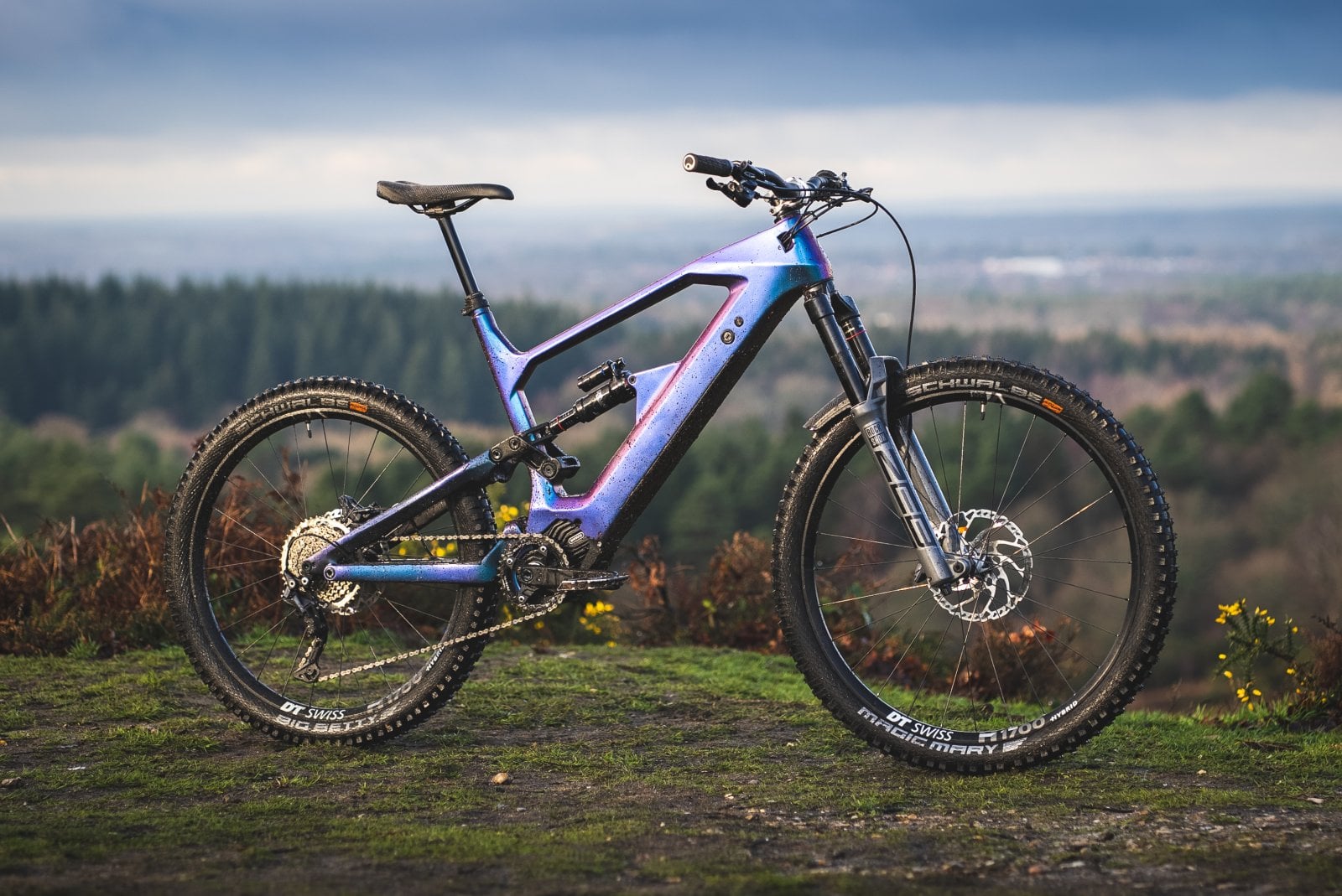

Another quick ride today. Only 15 mins, nothing technical.

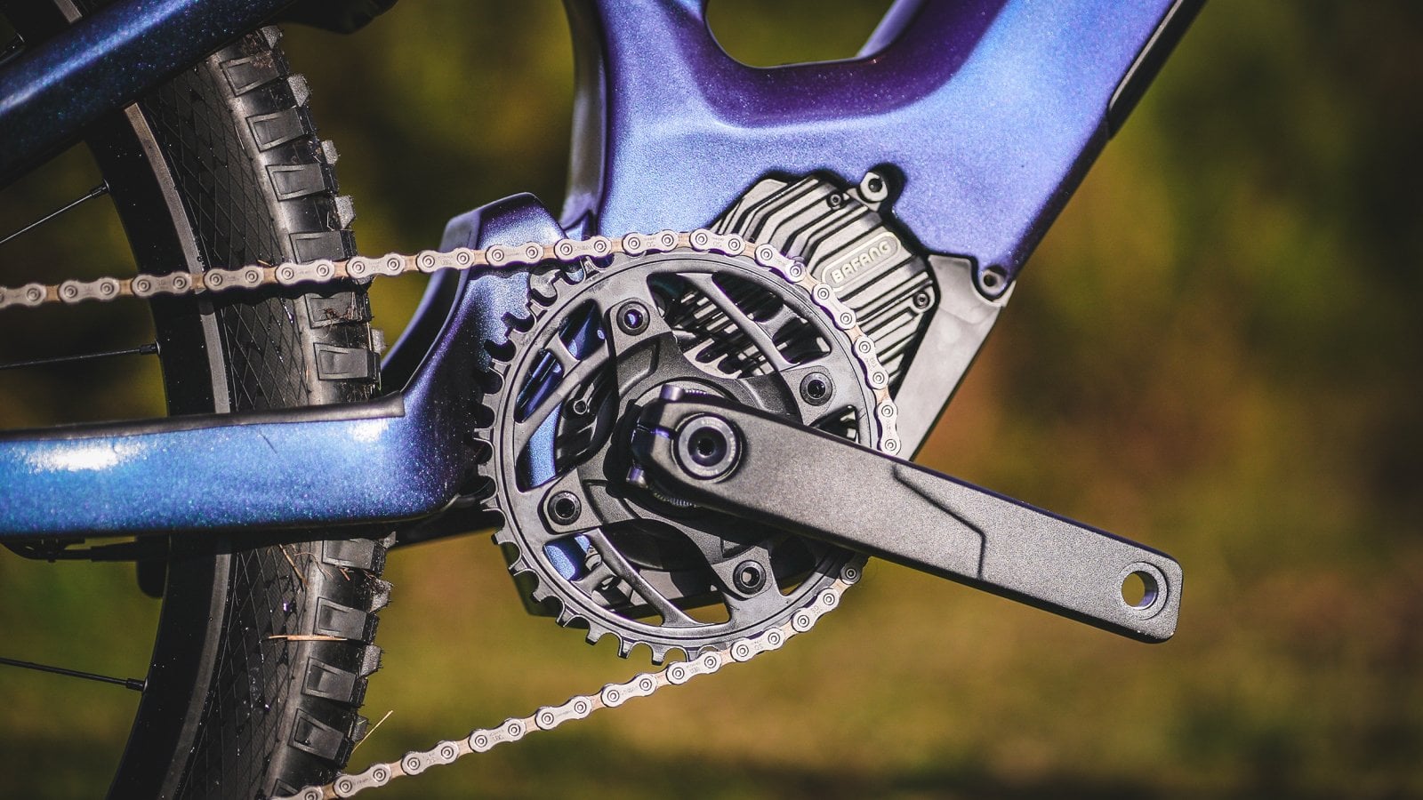

Bafang M500 Motor
So far its pretty impressive:
  • Motor is smooth and progressive in delivering the power, pretty instantly engaging and assisting
  • Seems like there's not as much 'instant kick' power as Bosch, takes a couple of revolutions to really punch, perhaps having a more natural feeling
  • Once you get going it feels like a nice chunk of power, between 5-15 mph it really pulls
  • Very very quiet on load under full power. Not tested on rough stuff yet to see what its like under coasting / unloaded noise
  • Instant engagement from the motor / zero crank play before engagement

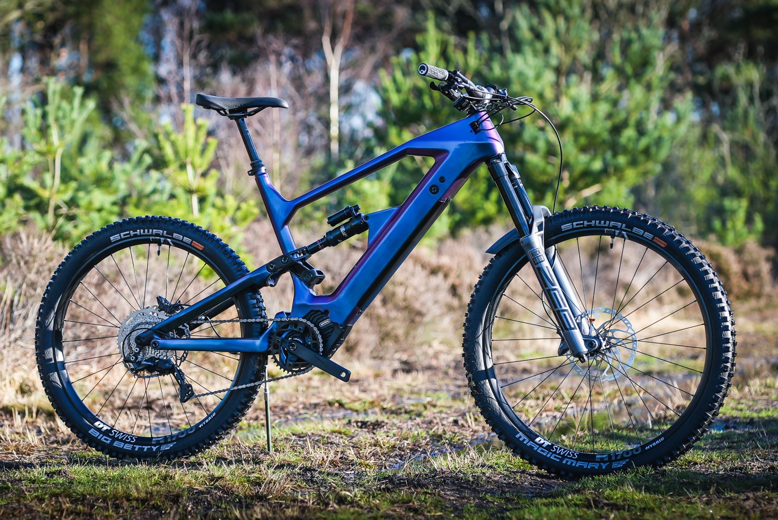

Dengfu E10 Frame
Feels pretty good so far but early days. At the moment I'm just making sure it is set up correctly rather than focussing on performance aspect. With the 170mm travel / 155mm rear its super plush as you'd expect.
Again, frame is totally silent, no creaks, knocking or noises. I already added some really thin (1mm) 3M rubber tape on each side of the battery compartment to reduce any battery rattles, as well as on the underside of the battery cover itself. I also filled some parts of the frame with bubble wrap to reduce any cable slap inside.
Some Stats / Geometry on my setup
  • 505mm Reach
  • 63.8 degree head angle with the RockShox 170mm Zeb
  • 29er front, 27.5 rear
  • 455mm chain stay
  • 348mm BB height
  • 24.5KG
Got to say so far I'm pretty impressed. Although I have only been riding around paved stuff. But I have a feeling it's going to be a proper capable enduro ebike.

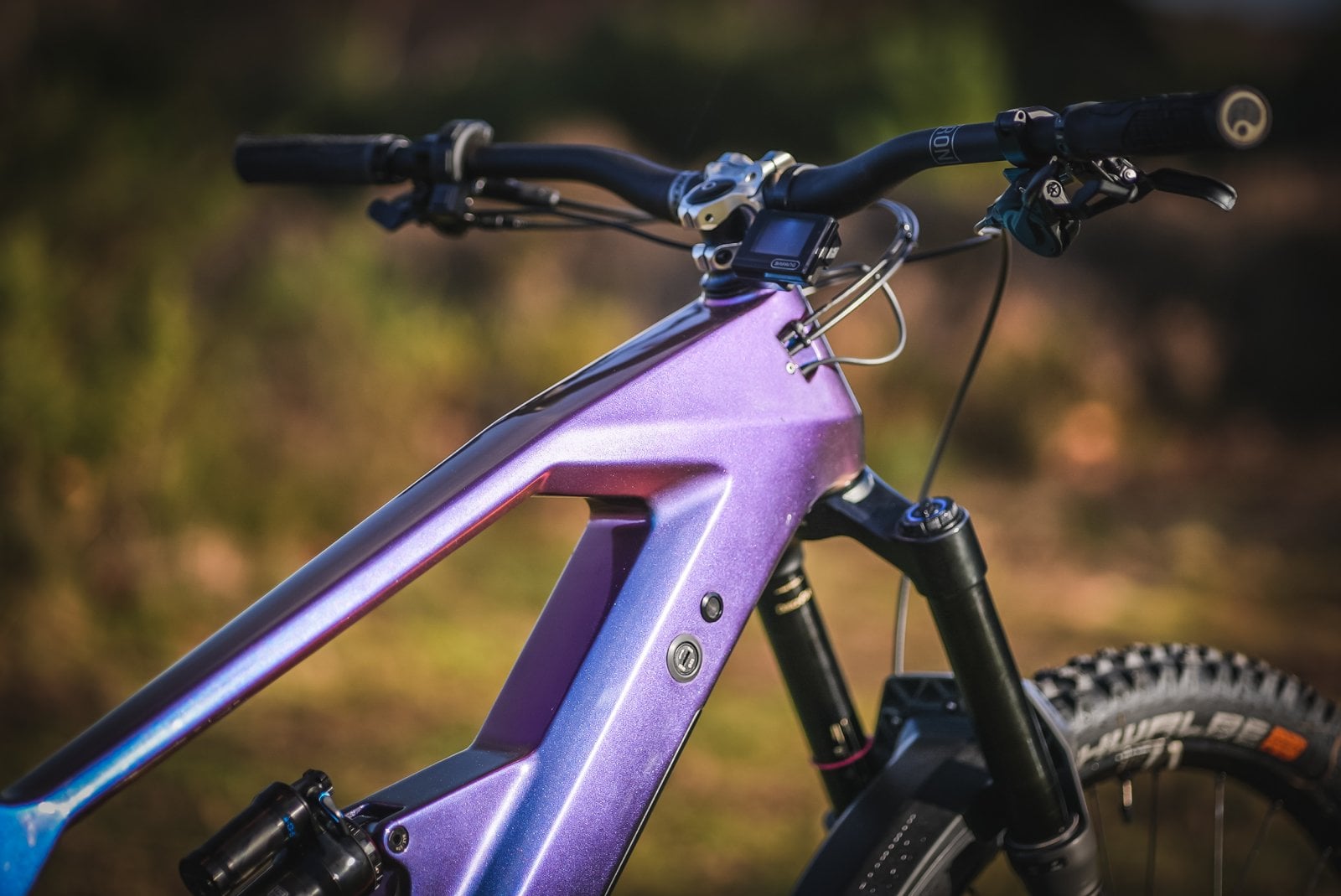

Things to do:
  • Fix display to the 35mm bar. Bafang display is setup for a 31.8mm bar, clamp is too small
  • Get a longer cable between the remote control and display. Its too short
  • Find 2x bolts to fix the bash guard
  • Sort out chain length. 116 link chain seems to short (I think its a 40t chain ring)
  • Try with 29er wheels front and rear and 160mm fork, offset bushings in the RockShox Super Deluxe to drop BB
  • Ride some actual trails
