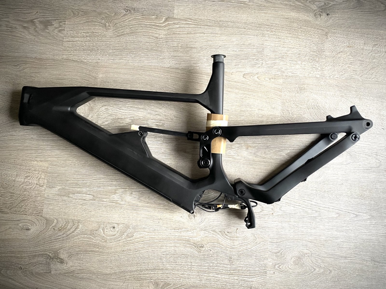

So, the CHEEB frame has just cleared U.K. customs. It should be with me in the next few days.

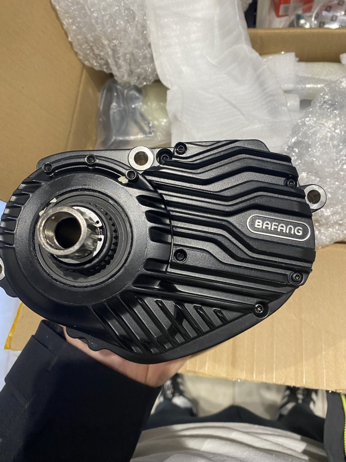

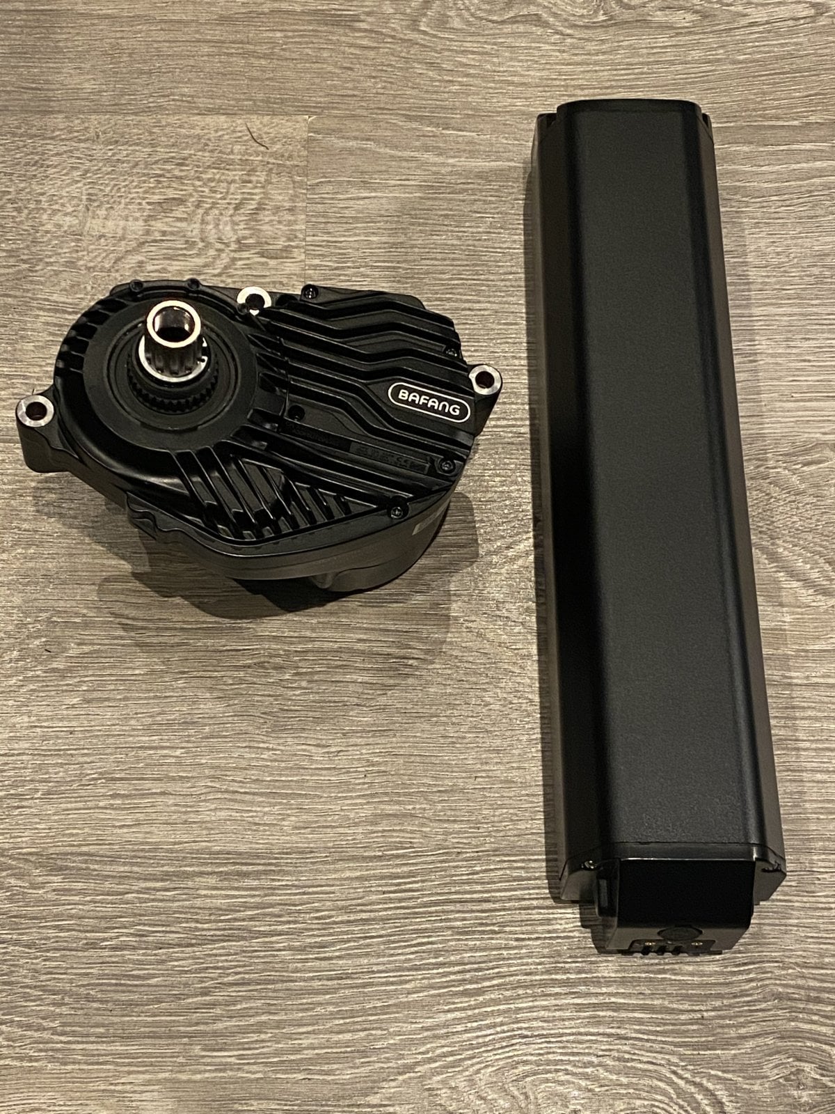

Motor and battery arrived a few weeks ago. Bafang M500, 95nm, 48v system with EU 250w rating. Battery is a 840Wh huge in tube battery.
View attachment 46798 View attachment 46799

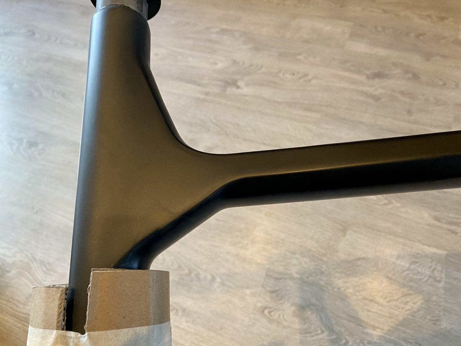

Frame:
Full Carbon frame set with fairly (by China frame standards) modern geometry.
I ordered the XL, 510mm in reach. HA is 66 degree but I will run bigger fork and mullet, so likely end up around 64.5 ish.

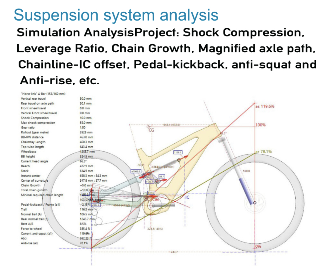

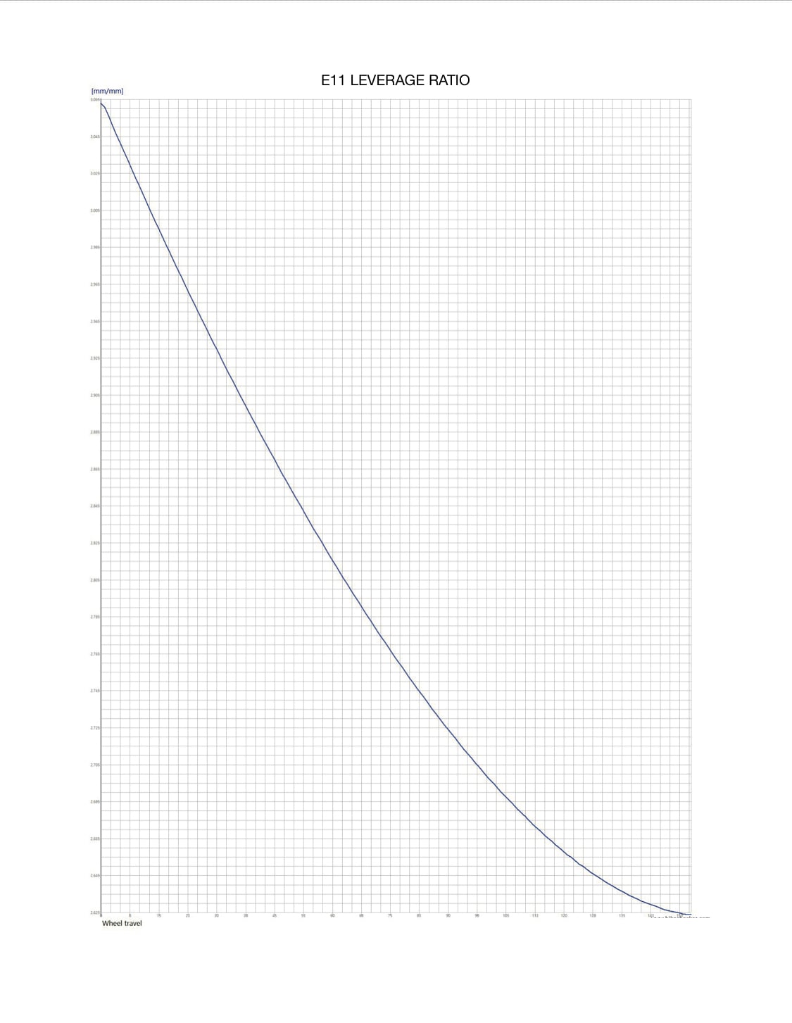

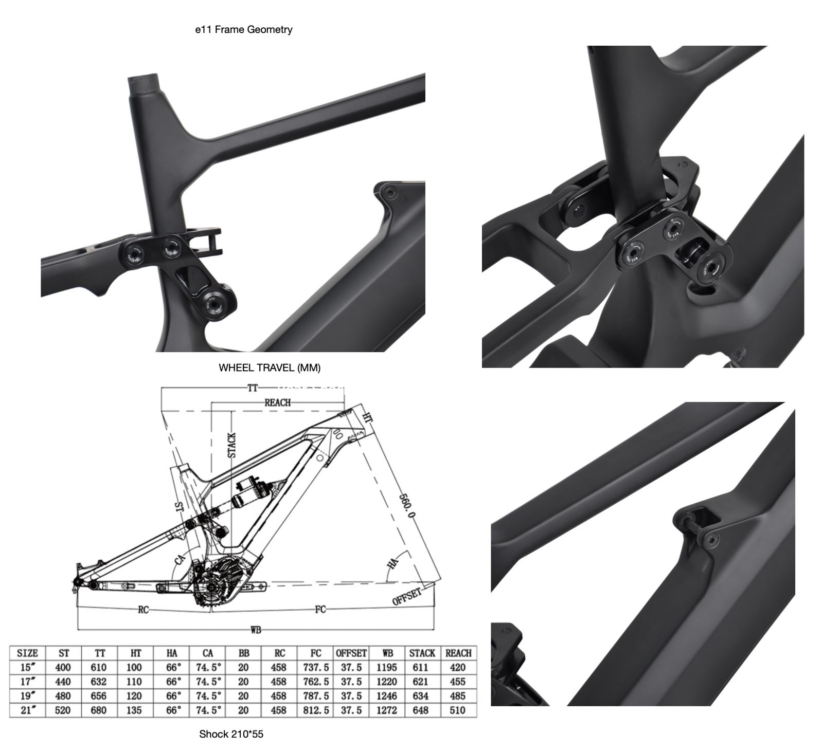

The frame is from Dengfu. They even supply full leverage curve, anti squat, pedal kickback etc graphs and figures! No idea of accuracy, but at least they are included
Frame is called the Dengfu E10 and here is the link. For some reason its labelled as E11 on the charts, but the Dengfu E10 is the actual product.

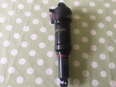

It’ll have a RockShox Zeb, Super Deluxe ultimate, DT Swiss H1700 wheelset, Shimano 10 speed drivetrain, and yes, it all comes in at less than £4000 for a full carbon ebike with proper components.

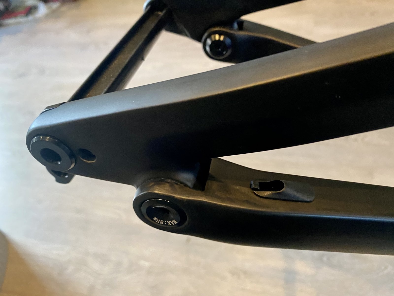

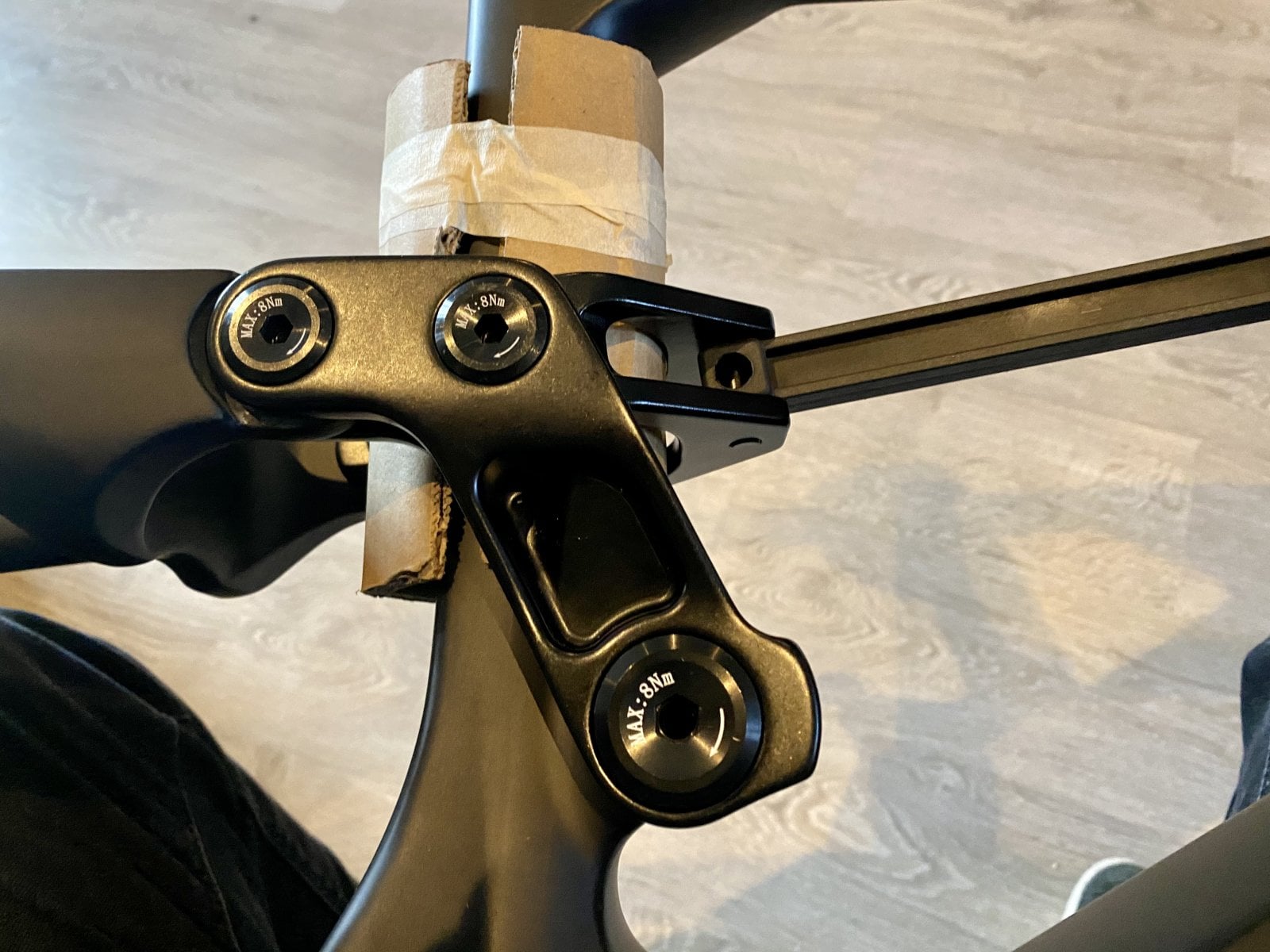

You’ll need some shock hardware. The size is as follows
16.5mm x 8mm linkage
32mm x 8mm frame mount
I got mine from @Offset
you can find it here - Shock Bushings | Dengfu E10 Bafang
www.offsetbushings.com
£24

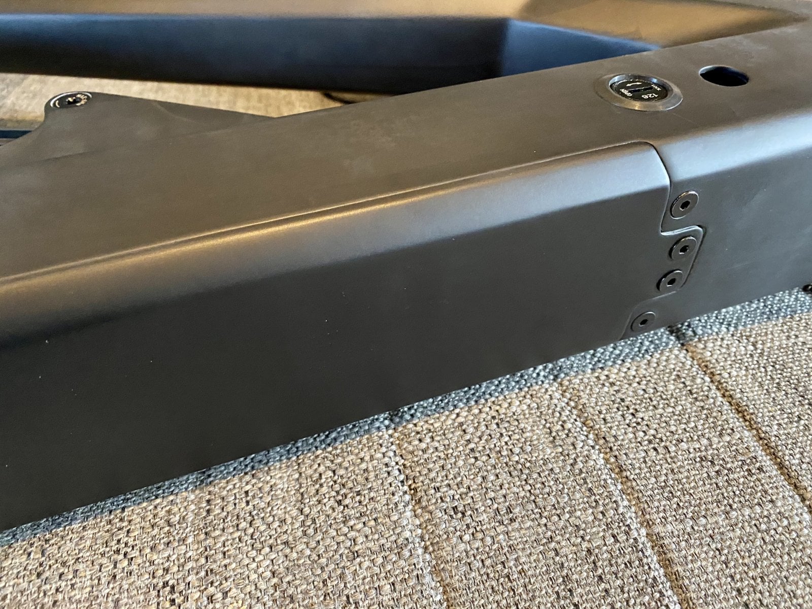

Frame has arrived and so far it seems great. Finish is good quality, cable runs seem decent. Includes headset bearings, seat tube clamp, steerer tube expanding head doctor thing (bit like Hope's version), battery release key, wheel axle, bottom battery cover that can be removed with hex keys (x4 bolts).

Does anyone know why Rob purchased the Rock Shox in 210x52,5mm and not the 210 x 55 mm? On the webside of dengfu the Rear Shock is 210x55mm. So what size would be good for the dengfu e10 frame?

We've had a few orders for shock bushings for the E10, so I've just made a specific product for the bike on our site.
If you need shock bushings / hardware for the E10 you can find it here - Shock Bushings | Dengfu E10 Bafang
If you want offset bushings then it's just a case of noting the frame / shock models when ordering this Offset Bushings - Pair
Cheers guys!
Jeron @ Offset Bushings
Do the shock bushings work for a RockShox 210x55 mm and also for the 210 x 52,5 mm? Or should I need offset bushings if I go for the 210 x 52,5 mm?
