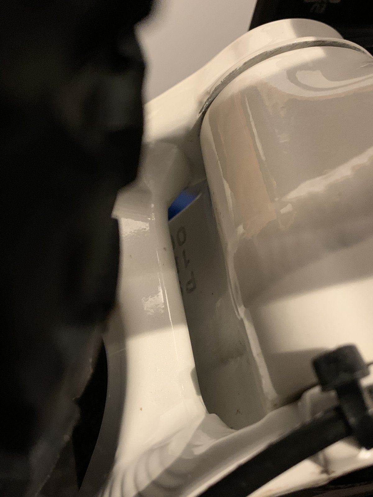

There are some stamped numbers in a couple of places I can find:
On the back of the motor mount and inside the chainstay

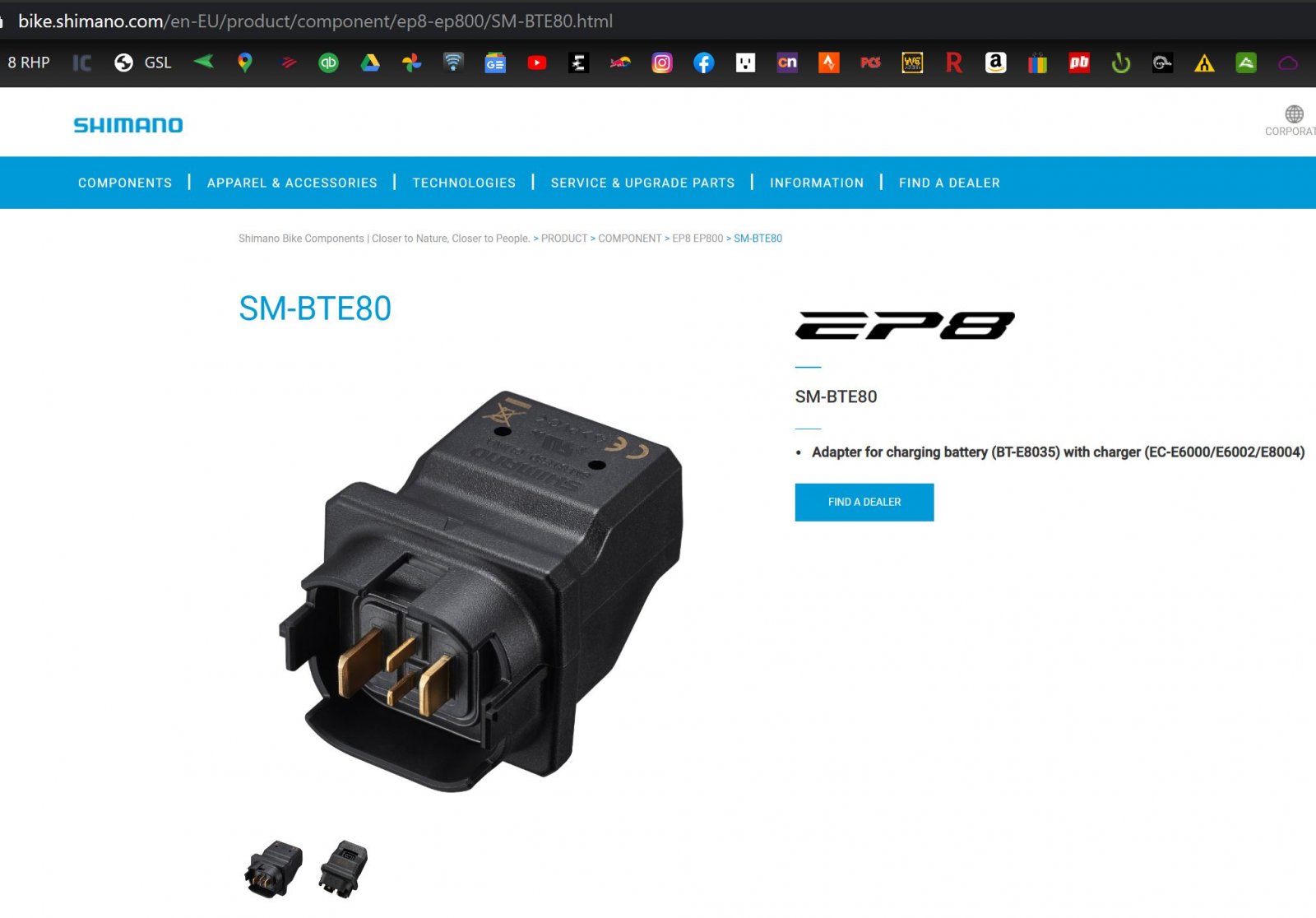

The adapter to charge the battery off the bike is not included, you need to buy it separate.

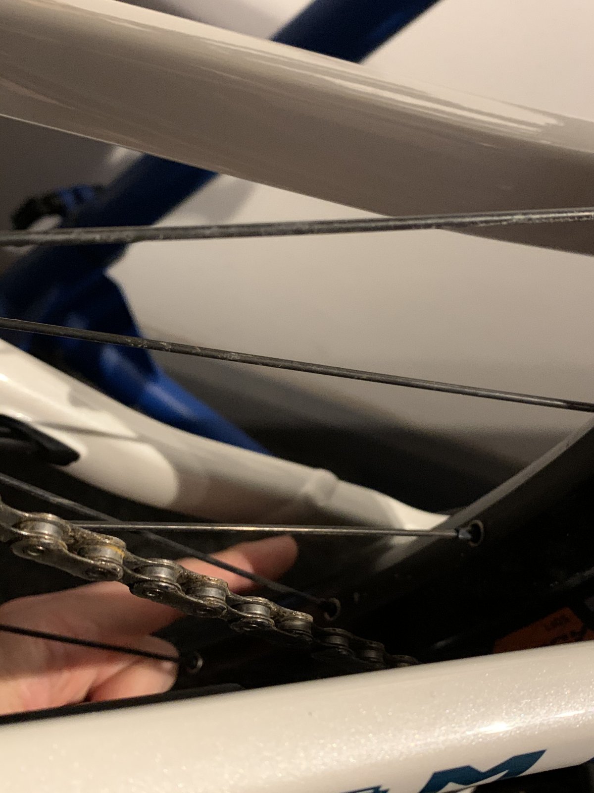

Hi mates! Rear wheel spokes on my 2021 meta essential came completely loose from Commencal
What is the spoke tension for the DT swiss Hybrid 552/ sapim strong 2,3/2,0mm? I'm not able to find this info
Ps: 100kg rider on top of the bike
Thanks!
rb.
Apr 27, 2020
388
262
San Jose, usa
Thanks!
I don’t think there is a “spec” for spoke tension. Most important thing is to get them even and the wheel true. Park Tool has a wheel builder app on their website that can help you out if you have the proper tools.

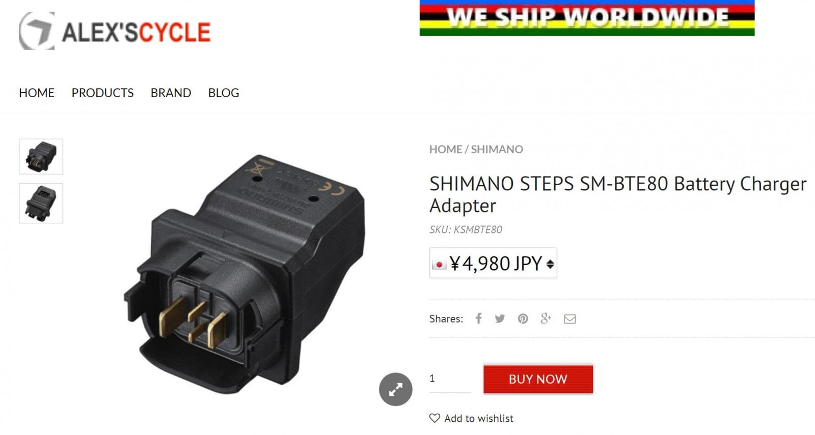

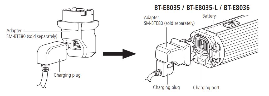

found a source for the EP8 off-bike battery charging adapter:
note for lithium battery longevity it's best not to charge or store in very cold or hot temps aka your garage!
here
note url says BTE60 which doesn't fit, but item pic & label is BTE80
ordered! ¥6,520 JPY = ~$62 USD with shipping

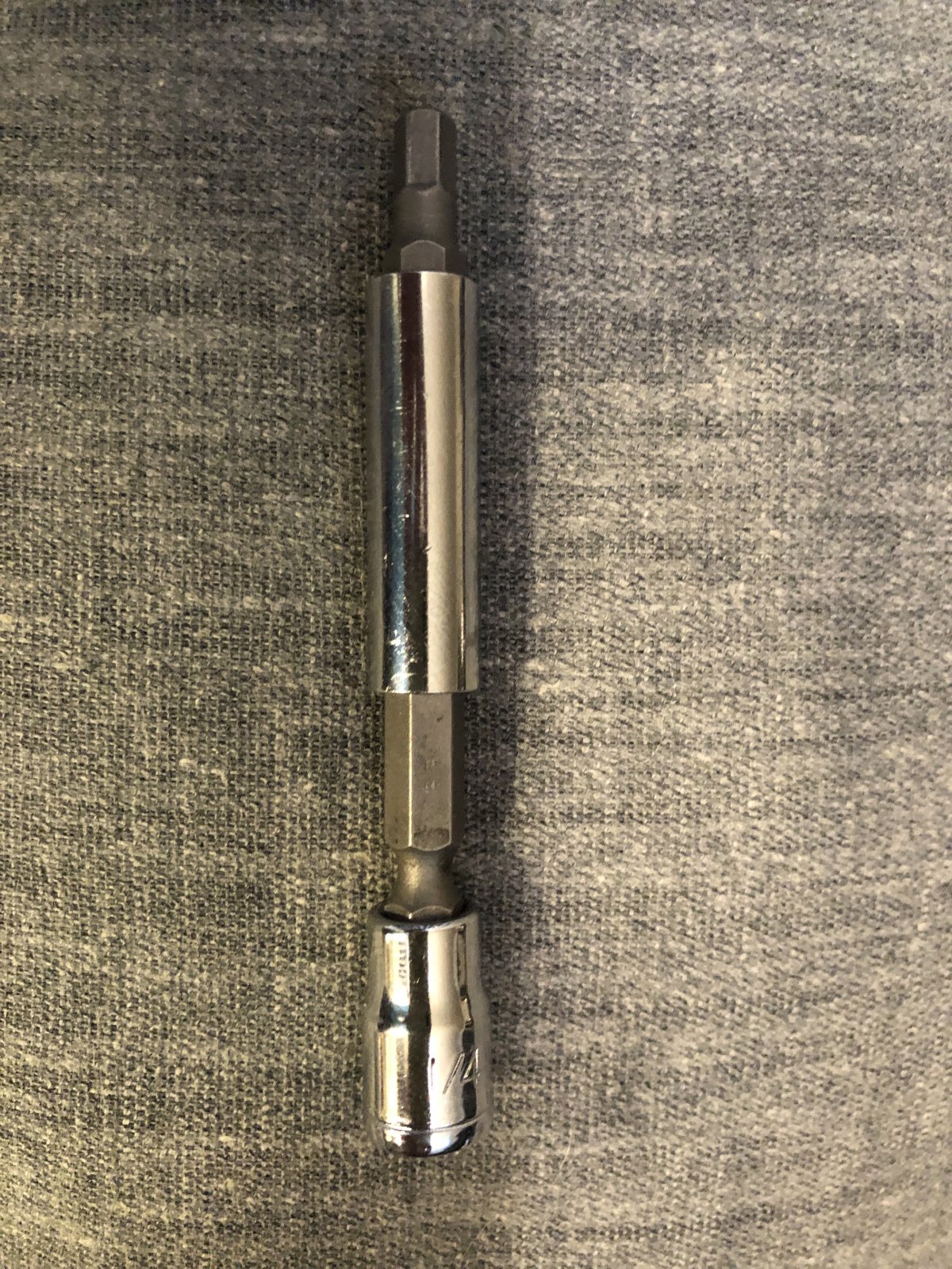

Got the same mail, but how am i supposed to tighten the inner screw at the chainring? My torque wrench cant fit in it doesnt work with an extend either! What kind of tool do you use? Tomorrow is maiden ride and i dont wanna fck up my ankle as @ShaneBean did it! looks painfull dude!
