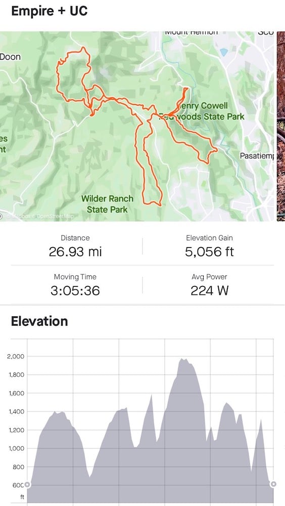

Went for a longer ride today - all in Trail mode (except couple short bursts of Boost). 27 miles and 5k elevation, had 1 bar left at the end. Did not feel I was working much harder in Trail mode than in Boost. Shimano's claim "Set it and forget it" for new Trail mode seems to be mostly true.
Another testament to motor quietness on climbs - had few people surprised that I was coming up behind them: "didn't even hear you" (y)
On other hand found a weak spot: on flatter trails where you need to pedal to keep the speed, hitting 20mph wall was super annoying, especially when pedaling into the jumps. I wish the limit was closer to 25mph.

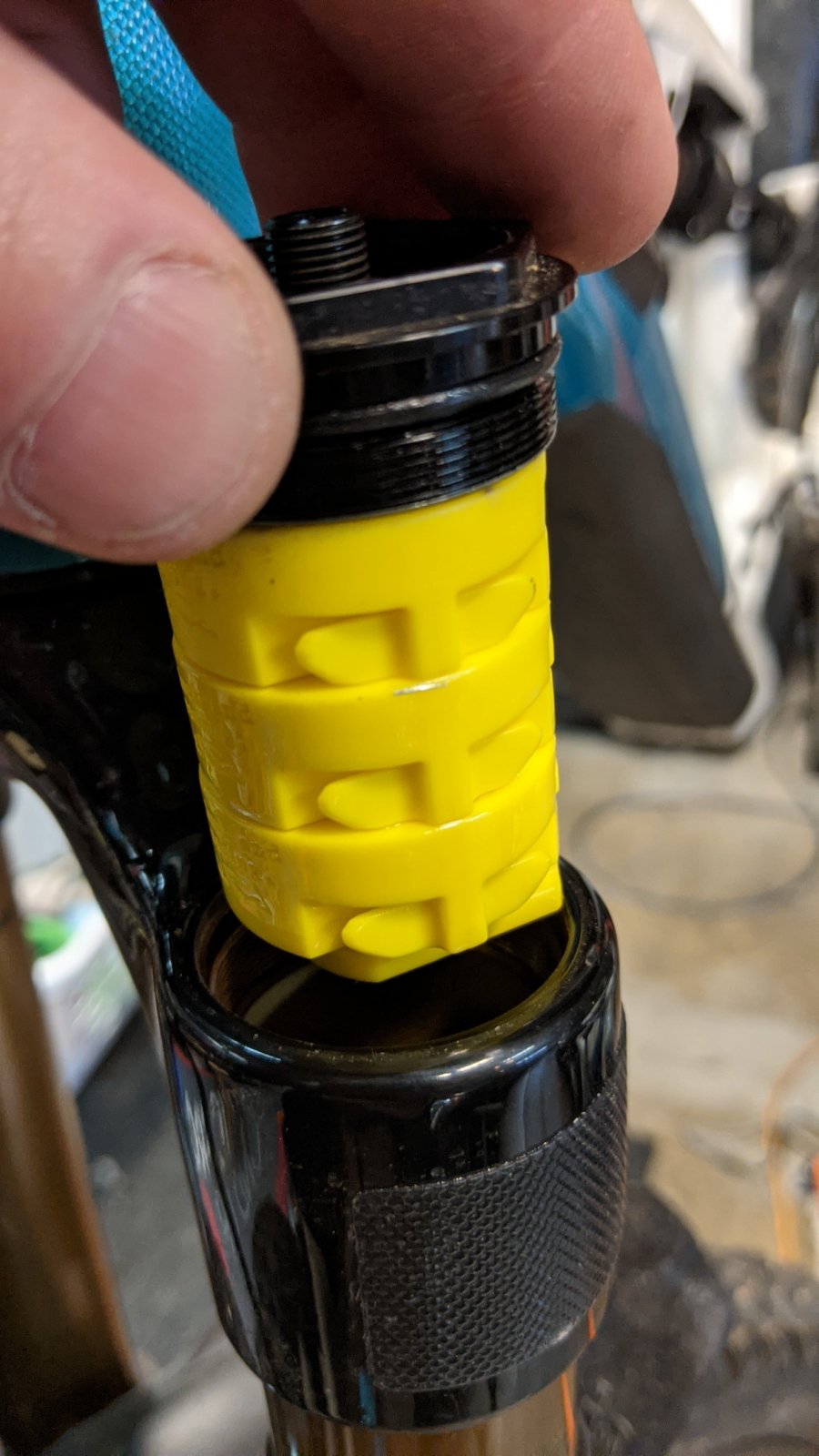

fox 38 volume spacer situation. 3 in my size L signature.
depressurize left leg, 32mm socket to remove stanchion cap & they're attached to the cap itself.

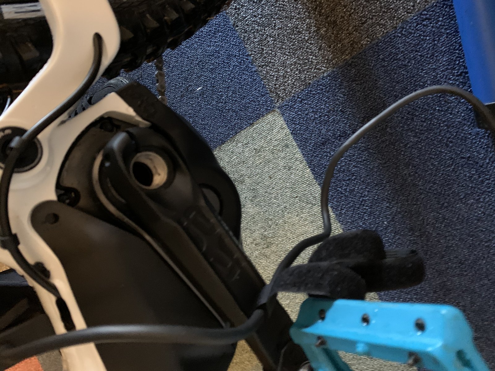

First ride today, bike is amazing. This is my first ebike and the distance covered and number of climbs I did was simply astonishing!
The left hand crank arm bolt seems to have fallen off which is annoying, clearly not done up tight by the factory.
Please can someone with the same bike take a picture of their left hand crank arm so I can see what the bolt should look like, cheers!
noblige
Aug 30, 2020
69
63
California
It's same on both sides. Reach out E*13 - I had spacers between cranks and BB missing on my Meta Trail, they shipped me replacement for free.

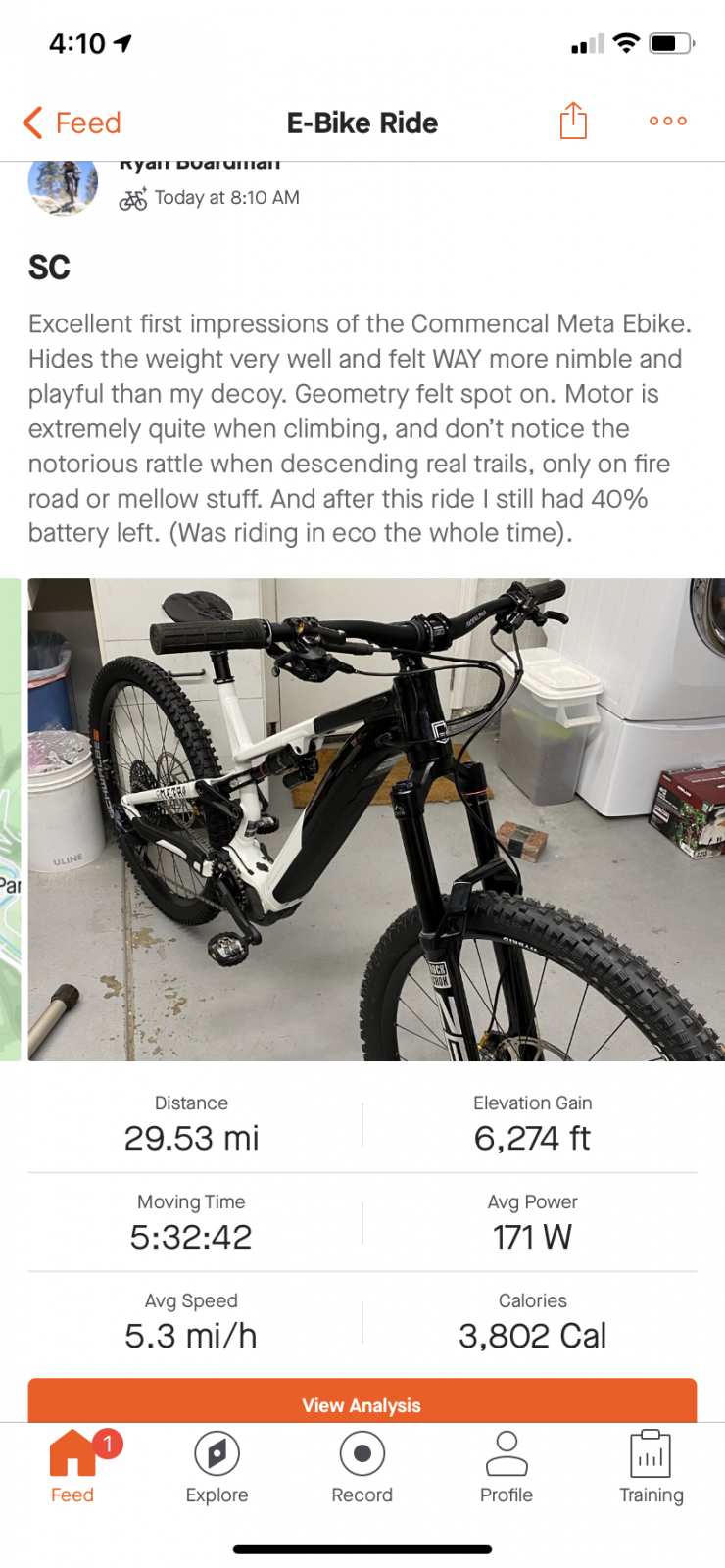

First ride today and was pleasantly surprised by everything. He is a little ride review, and the motor efficiency was amazing riding at normal bike speeds. My decoy with 540wh and e8000 would not have been able to do this full ride unless I REALLY conserved, and I still had 40% left on the Meta!
