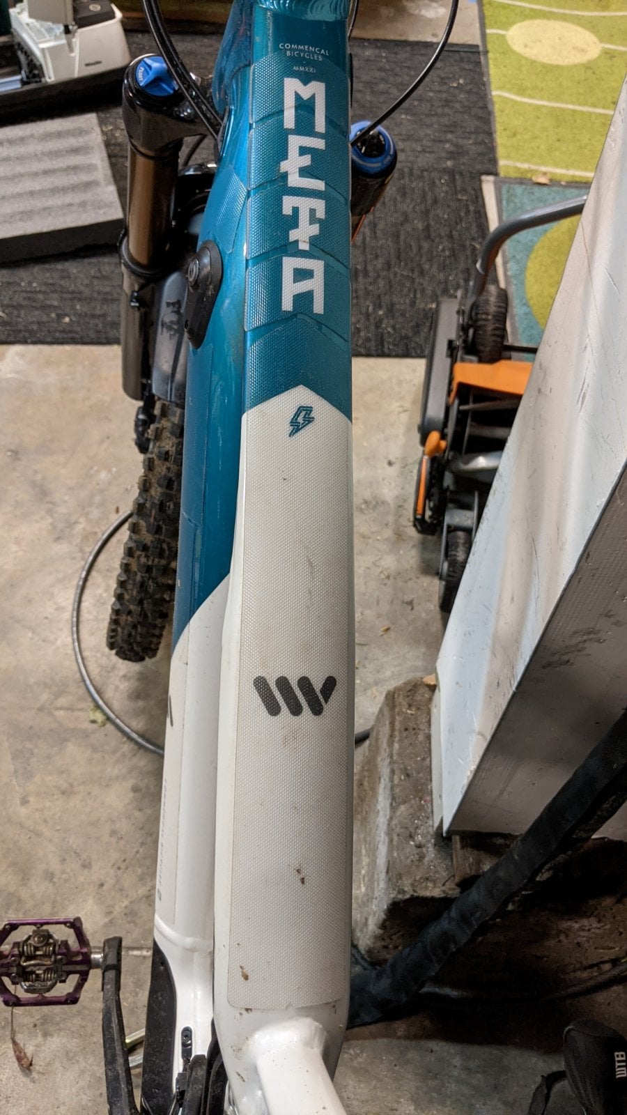

size L signature, Halloween is over so I peeled off the orange fox float x2 & fox 38 decals which imo looks way better.
I have a 34" inseam & ~80mm of seatpost base showing, I think I'll want a longer dropper than the 175mm oem as I'm still teetering a bit on full down mode, haven't trail tested yet. fox has a 200mm transfer dropper now which has a 320mm max insertion vs frame size L max of 280mm, so you'd have 40mm of base showing which would work for me. oneup or PNW might be even better ie could get them even lower without hitting max insertion limit, I haven't researched yet.
I recommend a few crash/brush tragedy mods, especially ziptie the rear brake disc magnet sensor wire to left chainstay to reduce the chance it gets snagged on a branch or such.
similar for the exposed wire between the display & downtube entry point, trying to minimize the chance it gets snagged & torn.
I usually slit/wrap/ziptie a piece of vinyl tubing around the short section of rear derailleur cable housing too which often gets abused.

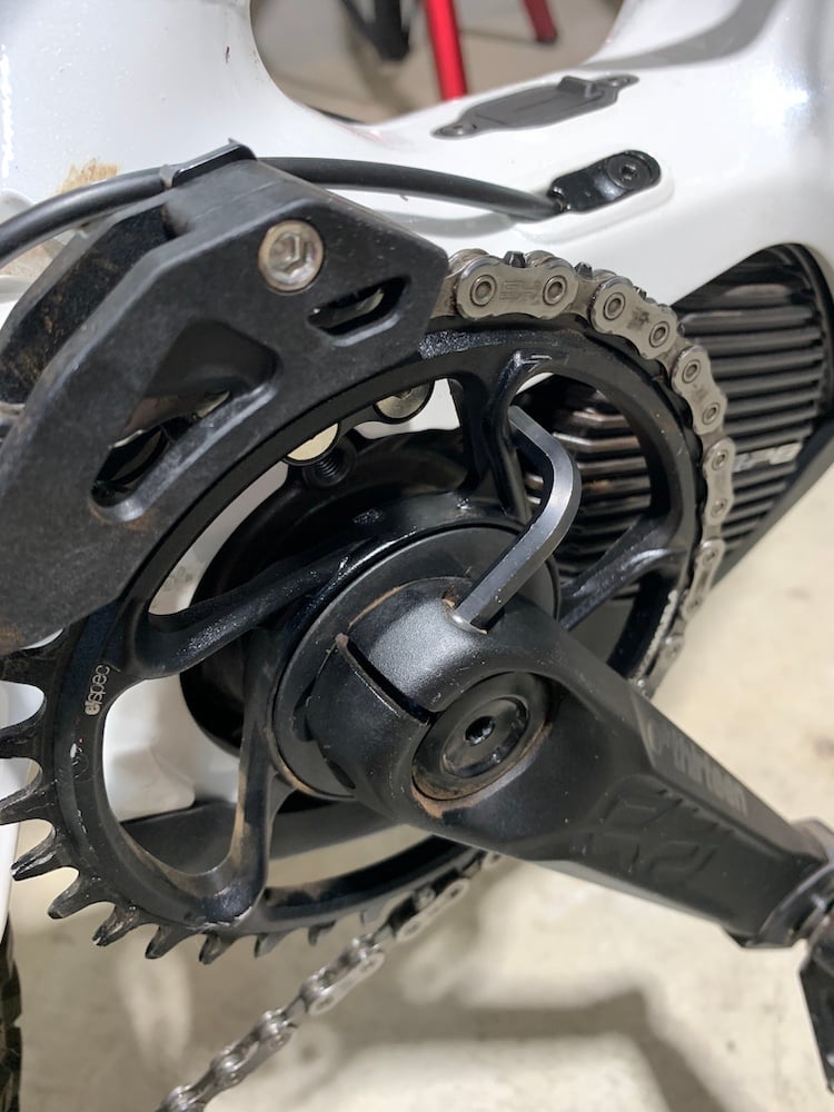

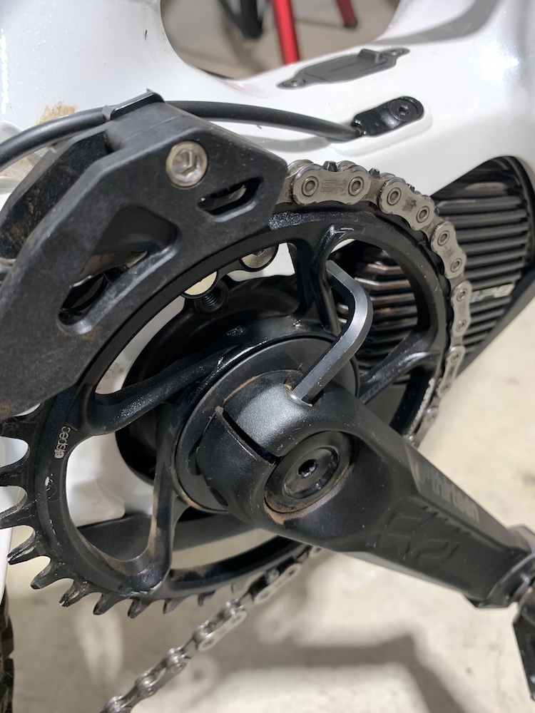

Yeah lubing the chain is tricky at first. There are some devices you can stick between crankarm and chain, so if you spin the crankarms backwards, they also turn the chainring.
Far easier: Shift in your lowest gear (largest cog) and apply the lube while you slowly move the bike backwards (or move it back and forth, so you don't have to walk).

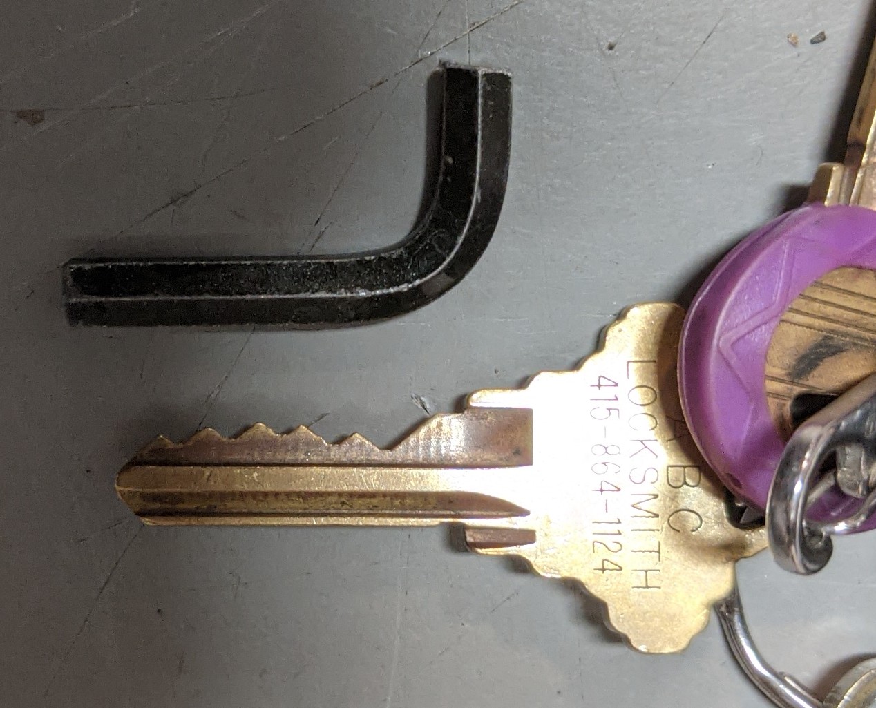

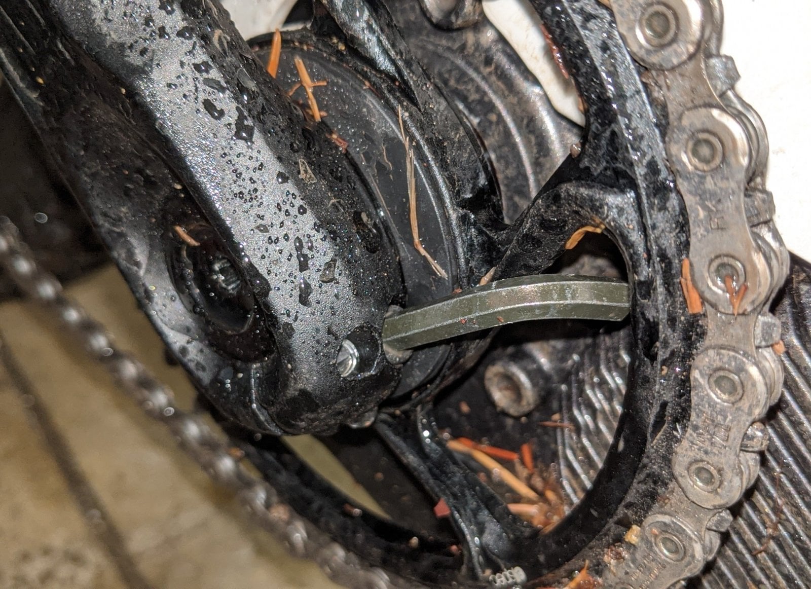

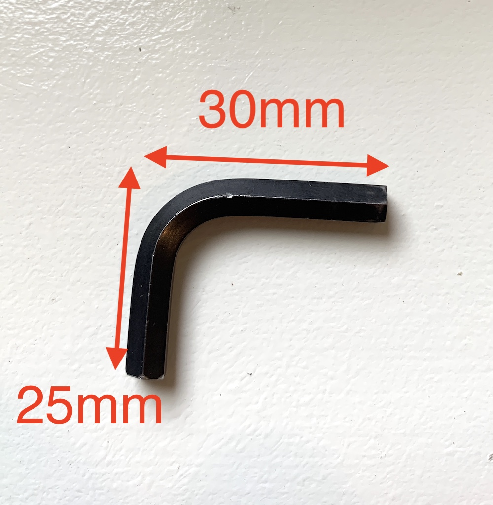

$0 chain jammer: 5mm allen key cut to catch the chainring when it's placed in the crankarm fastening bolt head. just don't forget to take it out!
shenchman
Aug 22, 2020
56
41
California
Love it. Making one now. Does it clear chain guide?
if you cut it short enough.
it gets a bit tight to pull out since it's wedged against the chainring, I usually have to use pliers. wrapping it in red tape isn't a bad idea to encourage removal before riding.

I see... I just took the chain off the ring, and it does not rattle when you bounce the bike. There's still clunk when you really smack it.
How do you guys lube the chain then, as spinning cranks backward does not move the chain? :unsure:
On my other bike I have a scorpion bike stand that I can easily toss the bike on to lube the chain. But this one the cranks have that end cap on them so it won’t work.
Will try the allen key trick if I have a spare one to cut.
Here is a good option, but won’t work on our stock chainrings.
