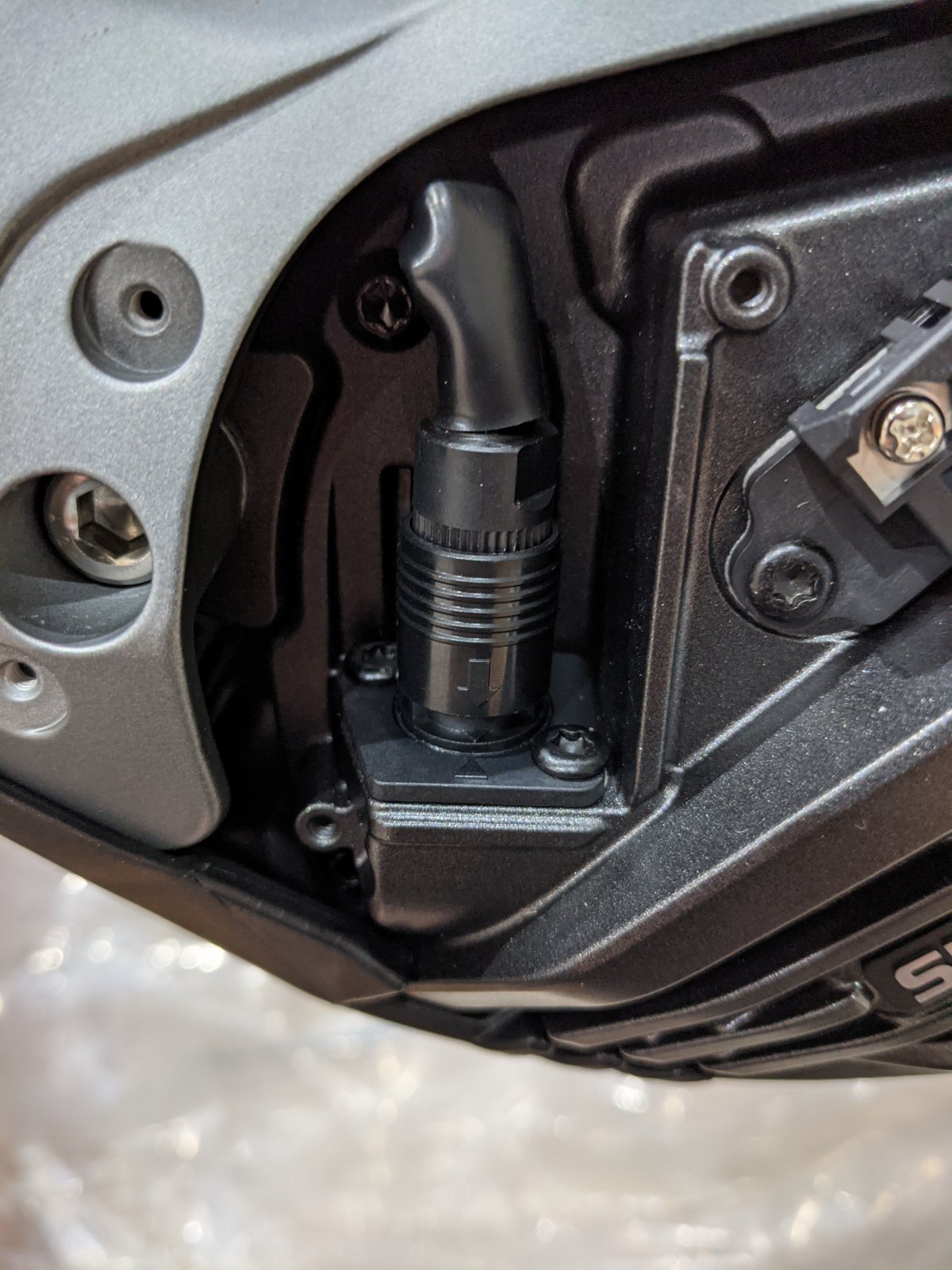

Rookie Q but the main plug connector from battery to motor... Is it just a push fit or should I be expecting to hear a 'click' if I pushed hard enough? Just doesn't feel very secure??
I had to push it properly, but you can push it till the bottom. It will not click, or at least not in my case (y). I used a tool to push it down. But any kind of object you can use.
Yeah it fits a spanner so used that to push down best I could?? see how it goes! Thanks for getting back to me ??
I’m not sure it will click, but it does lock into place. May need to get a bit more slack from the cable so it can easily go all the way down.

No click when I put mine on.
Mine clicked eventually. I had to put my finger round the back of the cable and pull towards me a little whilst pushing the plug down. The push down connection has a small locking mechanism which triggers to prevent the plug coning out.

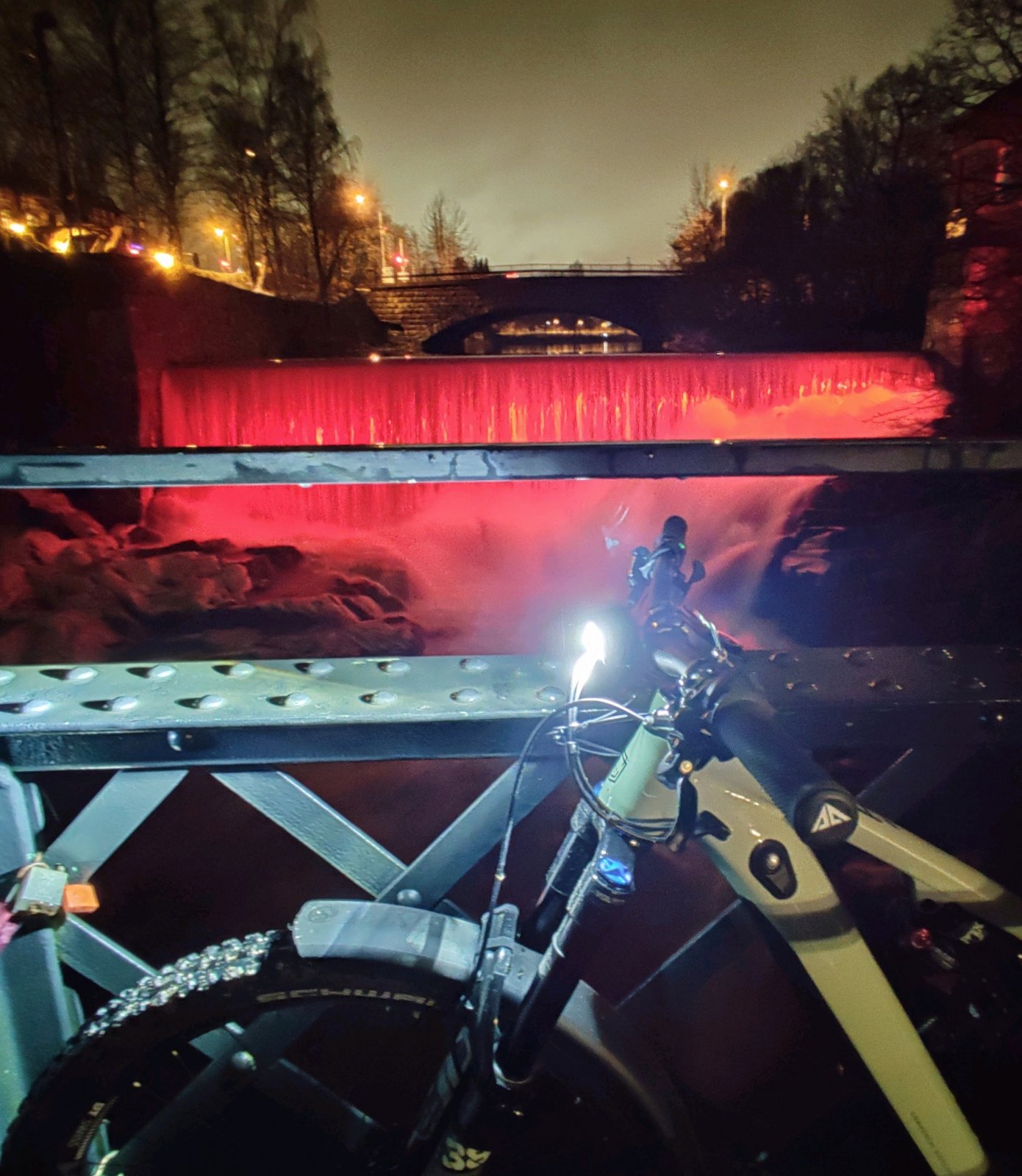

Anyone installed bike battery operated lights to their EP8 yet? I read somewhere that you had to activate the light power outlet from the motor through E-Tube, but I can't find any option in the app. There is a "lights" option in SC-EM800 display, but it just beeps and goes nowhere perhaps because I don't have a light or wiring installed yet. Thinking about hooking up my Essential with a Lupine SL X or SF torch to brighten the day. From what I've researched the cable might be a bitch to wiggle through the frame and possibly requires a partial motor removal.
VX10
Nov 5, 2020
Helsinki, Finland
Well ok, I bought a Lupine SL SF bike battery operated light for the bike and finally got it working. The EP8 motor or Shimano has turned the light power output _off_ by default and I had to take the bike to a friendly neighborhood bike service and get it done. They lacked some new (well Di2 old) adapter and cables for the connection and I had to wait another week. The procedure itself is easy and quick I should guess. They just hook the bike up to a PC and Shimano configures the light power output _on_ through remote access on their software.The lamp reserves some amount of power from the battery, so in case you run dry you'll see yourself home. I'm not sure how I feel about it but let's say it's ~5% (120 mins of 16W) and not such a deal breaker. The lamp itself is stellar.
E-Tube Project does not have the light output configuration anymore for the EP8 (firmware 4.1.1). Some hacker software might have or atleast STUnlocker has the option, but the EP8 firmware version is not compatible and the light option does not save.

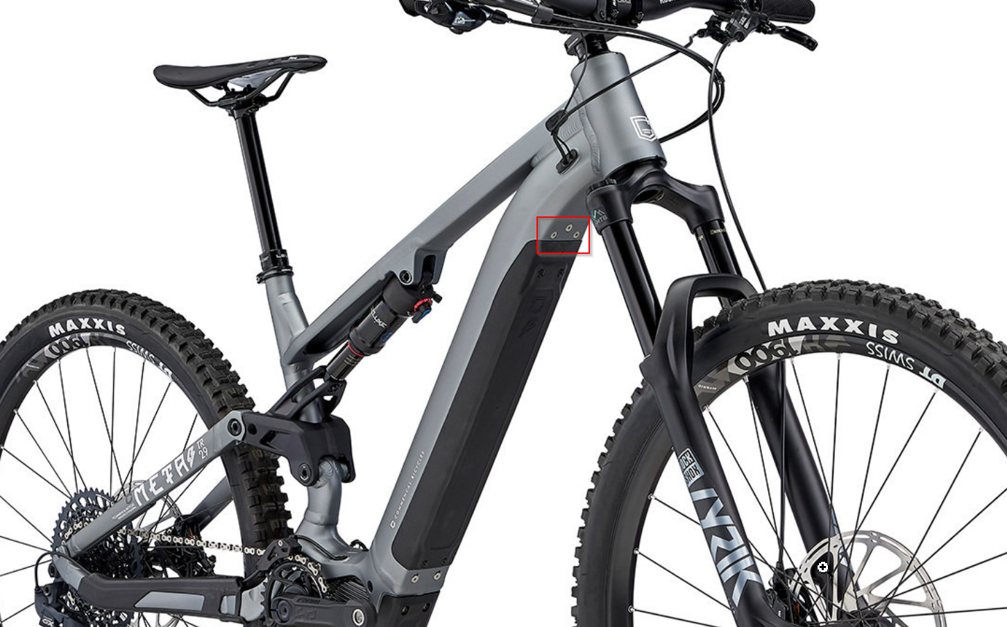

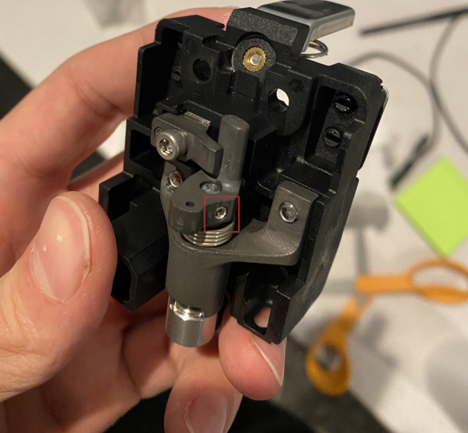

Guys, question. I've been this weekend through mud and rain on my Meta Power Team 29'er. After coming home and washing the bike (not with a power pressure), but with a bit of water and Muc-Off. When I tried charging the bike a couple of hours later, the light on the charger was blinking. So obviously I wanted to take the battery off and charge it off the bike. I found that my battery is stuck and I have no idea how to take it off. I took off the plastic guard, and even with the sticker, following the exact steps(4mm Hex in the right direction) I wasn't able to take the battery off. I remembered that when the LBS changed my brakes, they told me the battery is stuck. Is there any way in which I can remove the battery to figure out why it is stuck? Tried to call Commencal today, but I think they were closed due to a Bank Holiday in Andorra (Shrove Monday Google says).

I'm sorry - I don't know how to free the stuck battery. Might recommend making sure charge port on bike is fully dry - might be cause of blinking charger. Same thing happened when charging wife's Canyon (same Shimano port/charger).

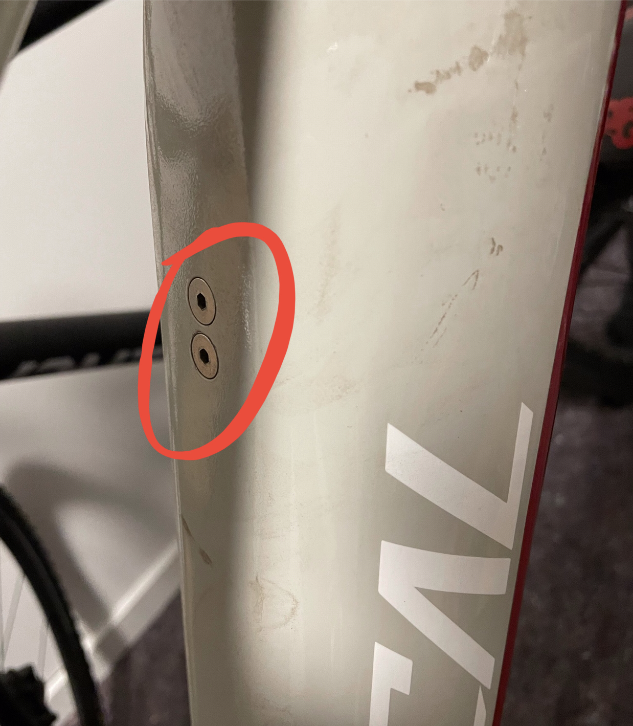

No worries, it’s a pretty simple operation.
On the top of the downtube you will find the two screws which holds the upper battery mount. Removing these two will disengage the battery. In case i doesn’t fall out you may want to remove the plastic battery cover which is screwed on to the battery in order to be able to get a screwdriver or the like in to push away the mount.
By the way - the Shimano charge port sucks - the construction is not well thought through on a mountainbike who often have dirt and mud splashed all over.

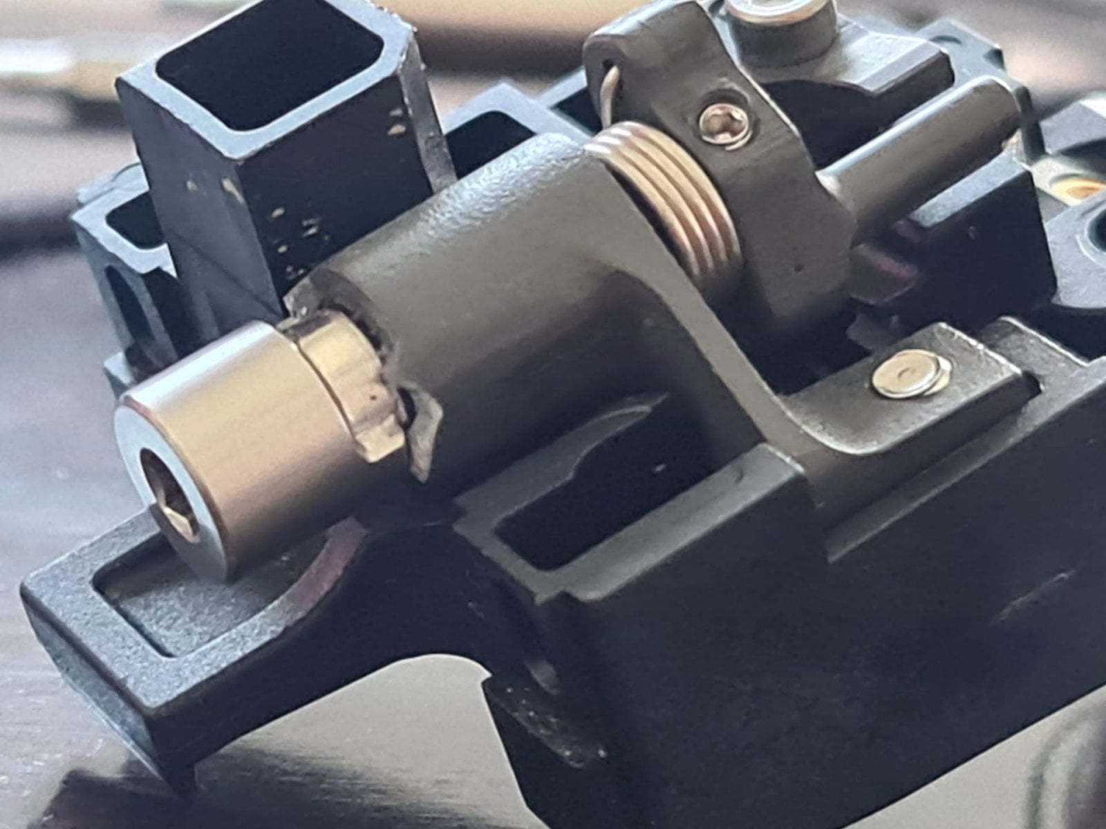

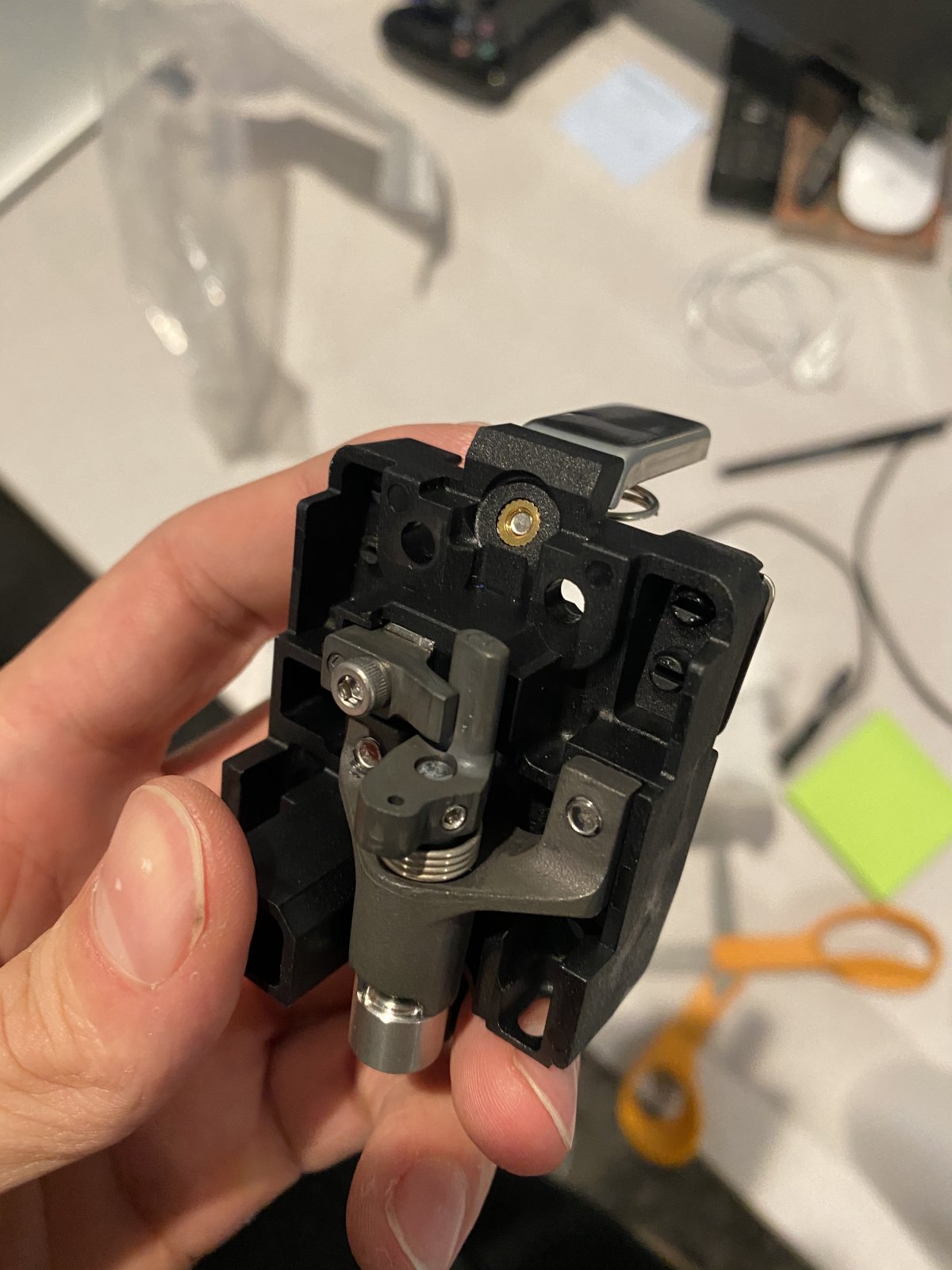

Update*
After having an amazing call with Commencal Tech Team, I was able to remove the battery and understand exactly what was broken :). I didn't have the same issue as the User RB had. For me, the same part is broken, but in a different place. Making it impossible to remove the battery the "regular" way. Commencal gave me also this website, where you can find all the bikes and exploded views. COMMENCAL TECH
My bike is a bit different than the one mentioned above by Trial-Niels. I don't have the screws on the top part of the tube. We have 3 screws near the battery which need to be removed. Only after this, I was able to remove the battery. And yes, the charging port could have used a rubber O-Ring to keep water out :D Wouldn't have been rocket science to add one, perhaps I will make one for myself.
I will keep you guys updated on the status.

Update*

Update*

It appears that in your case it should be the same. I would, however, also take off the start/stop button before removing these 3 screws. When you mount it back it makes it just a bit easier if that button is taken off.
From your words, it would appear that you have the same issue as the guy that started this thread. In my case what happened is the following. The screw as can be seen below was not turned fully in. Making the big thing turn around without any resistance. Therefore, my plastic broke as can be seen in my first picture. Commencal is discussing with Shimano Europe how to solve this issue.
Also, in my case. With the website I linked above. I was able to determine that I missed the external charger adapter for my bike. Commencal Customer Support has been amazing and has shipped this part to me together with some amazing stickers. Can't fault their Customer Service. I can only speak highly of them! Amazing actually. I have had mutliple direct sales brand "higer end" bikes. None of them had the same Customer Support which I had untill now! Good game Commencal (rock)
