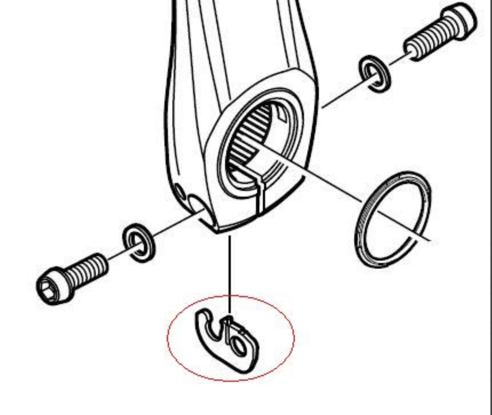

About my crank arm just falling off mid jump. Get some loctite on your crank arm locking cap. Talked to commencal today and apparently they don't have any extra crank arms or caps, or any small parts really.
robat
Nov 12, 2020
32
11
Afaik (from the E8000) the cap is just to lightly pressurise the crankarm (just like a stemcap) before you secure the arm with the 2 hex screws (where it's super important to tighten them evenly).

So to be clear, the caps have little if anything to do with actually holding the cranks on correct? It the hex bolts job to do that.
Yes and know, simply put the alloy caps done up tight will probably stop you having an o shit moment, but they are not how the cranks are secured.
Nahh the hex bolts tighten the crank onto the spline, this prevents the crank arm from wearing out the splines on the crank arm and shafts. The caps keep the arm from sliding off. Note everyone who mentions the crank falling off mentions the cap went first. That thread turns into a pissing contest on page two lmao.
robat
Nov 12, 2020
32
11
The crankarm will fall off if the 2 hex bolts are not tighten up evenly. The plug on the spindle will not hold the crank, since it's just a piece of plastic. There are also some alloy caps you can buy, maybe they will hold the arm a little longer...
But just tight the bolts properly and you won't have any trouble.
My bike comes with alu caps, even with retightening the hex bolts It's been an issue with shimano ebikes. Still coming off, overall concensus from what I've read is get an alu cap if you have plastic caps. Loctite the two hex bolts and the threaded alu cap.

When you lock the crankarm hex bolts, make shure that you don't just turn one until it reaches the right torque and then the other. Turn one until you feel some resistance, than the other.
Than apply recommended torque to the first, than second.
Repeat last step at least 2-3 times, since when you tighten one, it will slightly loosen the other.
I don't had to use additional loctite on my E8000, but it's not a bad idea.

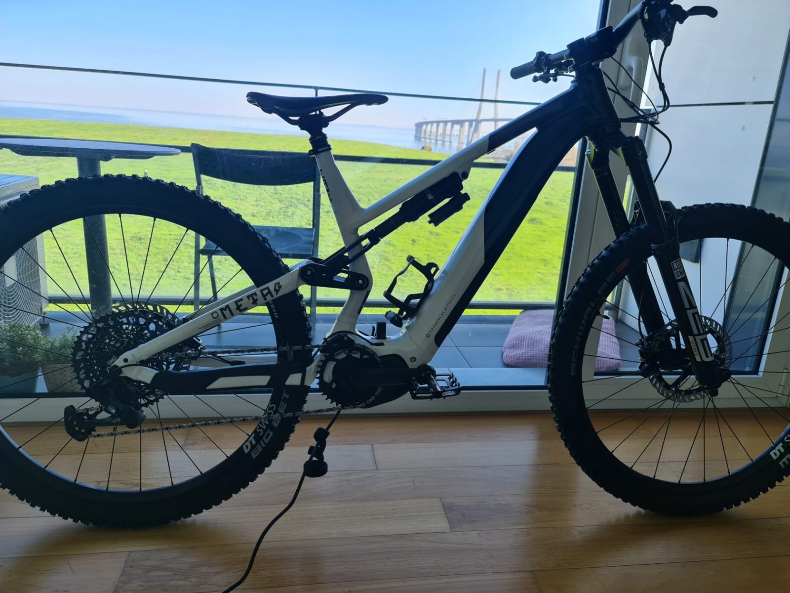

(The first pic of the bike build-up with the different discs in 220, Magura. I will post some pics when the bike is complete)
However, personally, my brand new Teams edition is now at my LBS to do some changes and check all parts. I only changed the discs and made the wheels tubeless. They will change the brakes, handlebar, and stem and check if all oils are on the correct level, and do the torque :D
