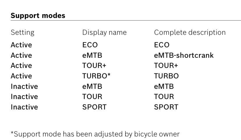

If you have a service report on your app it will show you which modes are on your motor. This was mine last summer. I wasn’t aware new modes can be added. Just thought they could be turned on/off. I’ve got a 22 stereo 140.

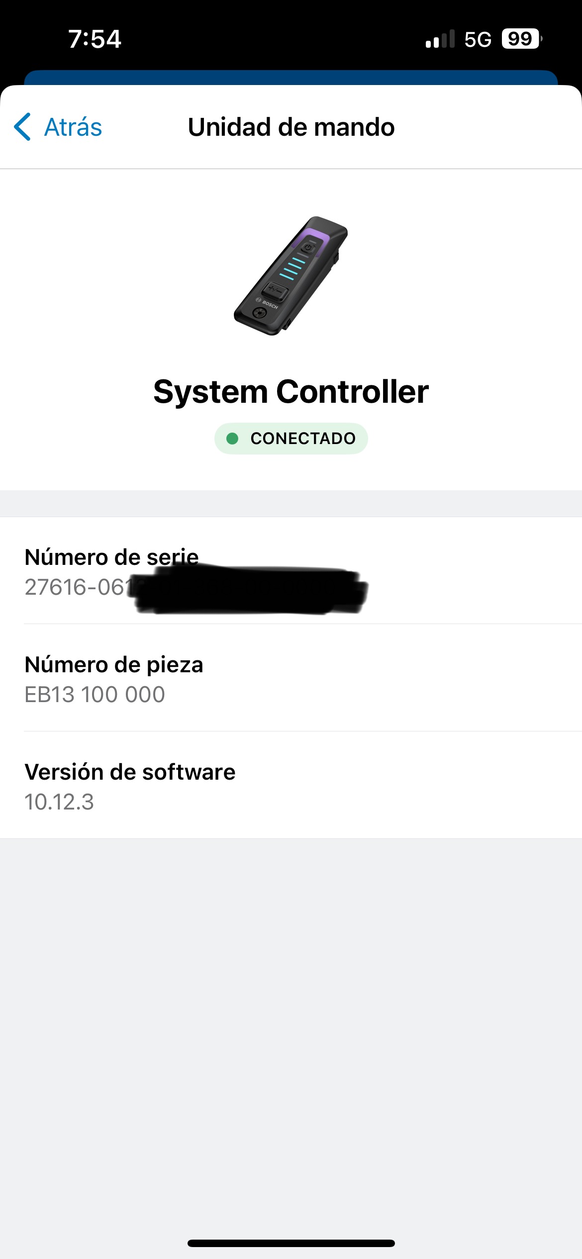

Older LED Remotes will first need a firmware update. Without that even the dealer can’t see and install Auto mode. Some dealers don’t know this.
To be more specific: In order to get Auto mode installed you first need your bike controller (LED Remote or Purion 200 or System Controller) updated to FW version 10.12.3
I have this firmware on my led control on my Orbea Wild and can not see Sport mode or more than Bosch 4 Factory modes.
